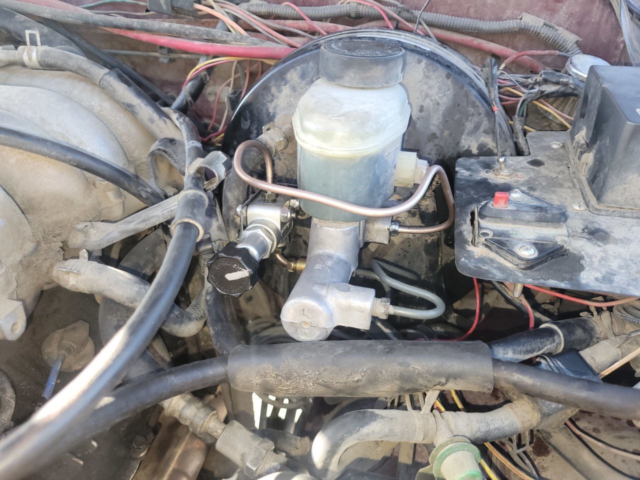

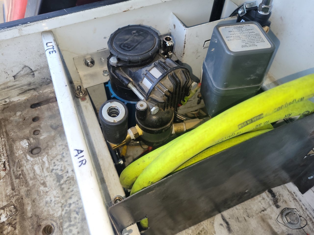

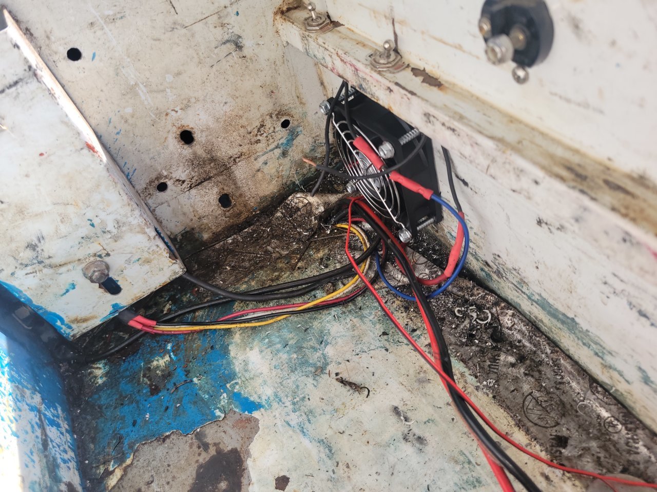

    Cooling fans are installed for both compressors.
    Made partitions to keep things off the compressor, and give me a place for the hose and inflator, where they aren't always getting buried.
    Finished the LSPV delete with the Wilwood Manual Proportioning Valve.
