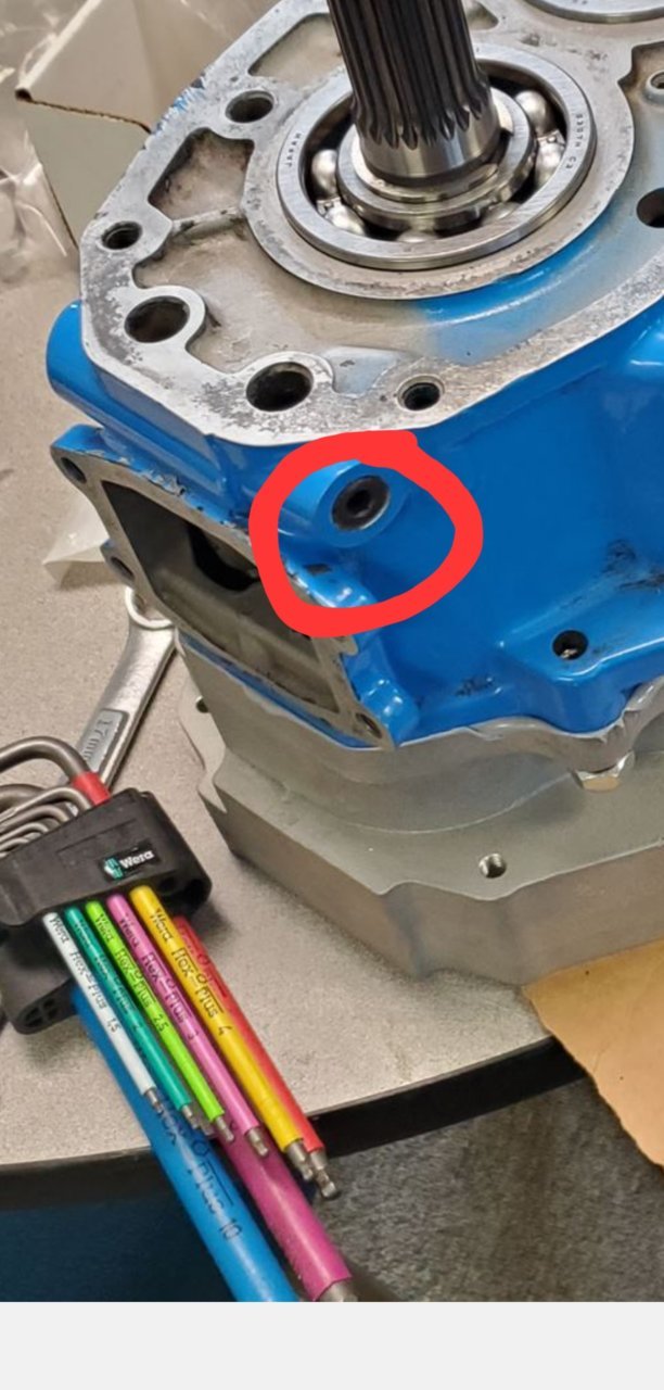

    Ok... so, does that mean I have to remove the cases? I didn't ever have this front case open. So, no idea where any of that shit is.
  5. Jul 7, 2023 at 7:19 PM
    #1445
    betterbuckleup
    betterbuckleup Well-Known Member
    Jun 26, 2017
    #222483
    4,795
    Ian
    Concord, CA
    2000 Tacoma SC 2.7 4x4 5spd

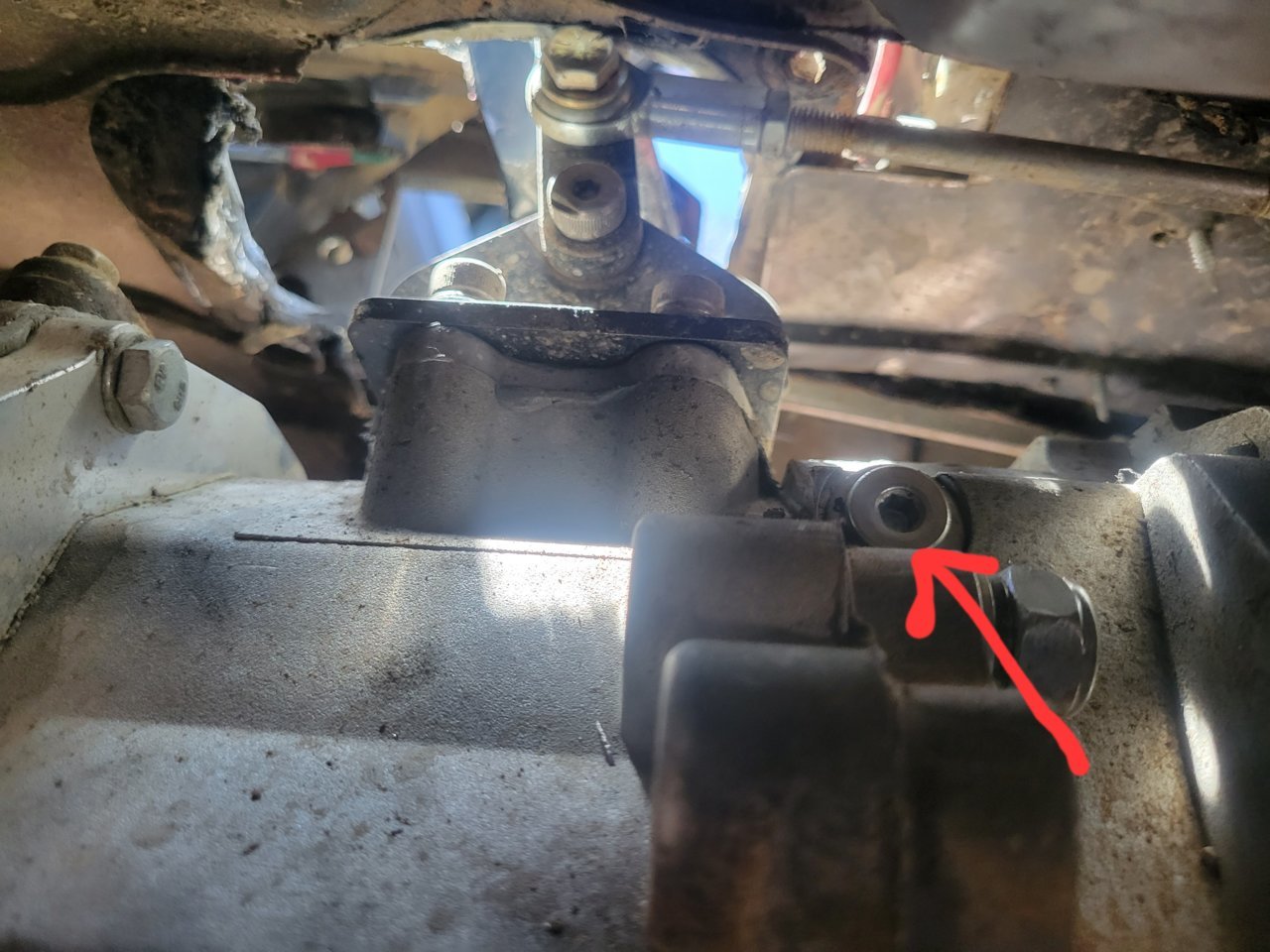

    I'll try and find some pictures, but it was tricky to access on mine with the cases installed. Your body lift will probably help though.
    It's at the top on either side of where the shift base mounts.
    Make sure you don't lose the ball when you pull the plug and spring out

    So, just pull that plug and the spring and ball is behind that?
    Is it spring then ball, or ball then spring (if you remember) just so I know what to expect.
  8. Jul 7, 2023 at 8:56 PM
    #1448
    02hilux
    02hilux What do you mean there’s no road, I’m here
    Sep 14, 2016
    #197244
    6,305
    Planet: EARTH
    Ball go in first than spring. Bolt is used to tighten/push the spring against the detent ball.

    Easy peasy... sounds like I just need to not get buzzed, and don't drop the Adam's apple.
    I'm assuming I want to do this with the shifter removed.

    Ok, I think I did this right.
    The plug shown is actually the plug on the passenger side, that's in front of the shifter. There is nothing behind that plug. I put a magnet almost 2 inches into that hole and there's nothing in there.
    I decided to look on the other (driver) side. There is a plug on that side, behind the shifter. There was a spring in there. So, I replaced that spring with the Marlin spring. The Marlin spring was about 3/16 longer and stiffer.

    Yup you should be good to go now. The shifter should be noticeably stiffer to get in and out of gear
