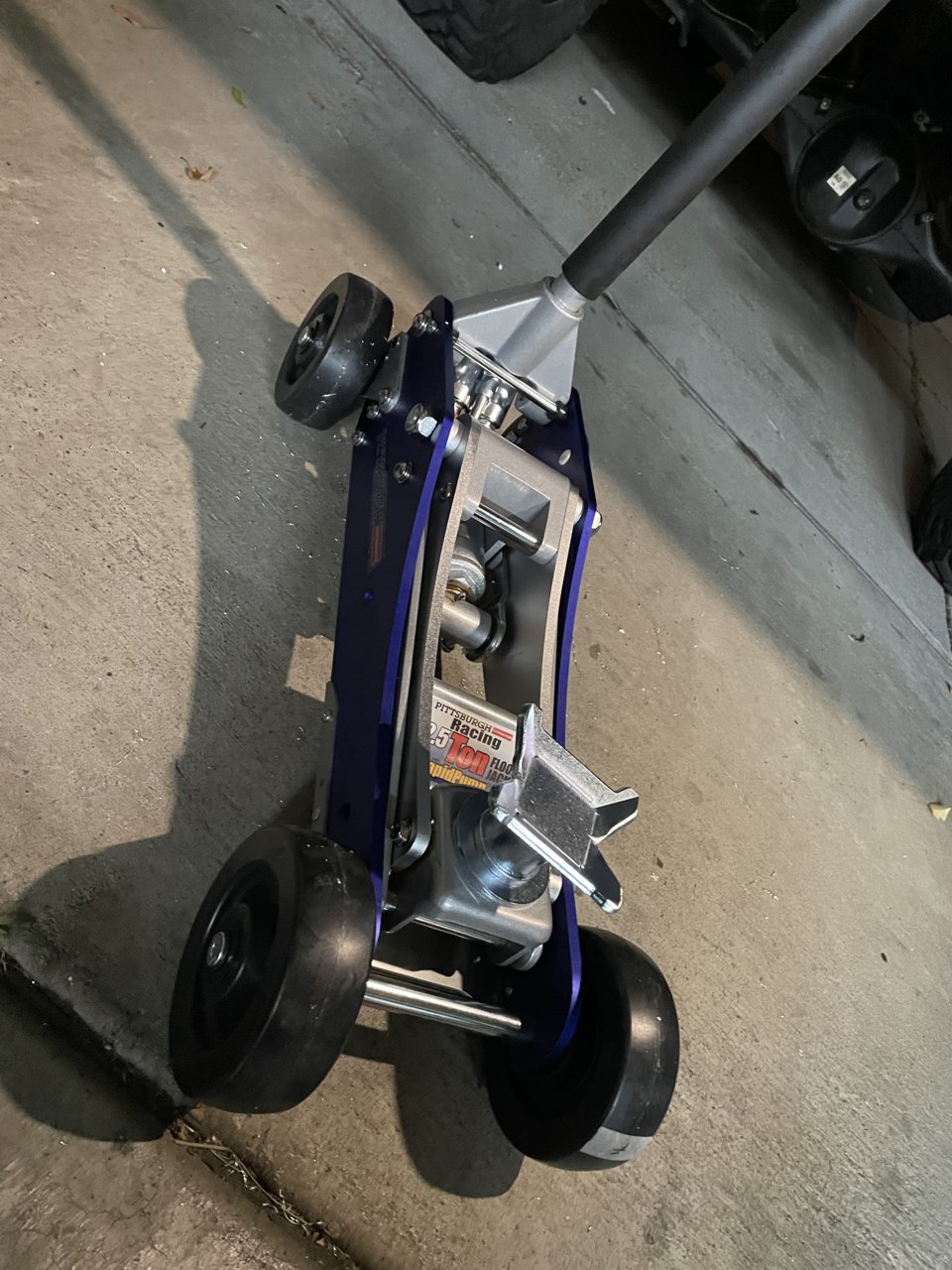

    Aaaaand...

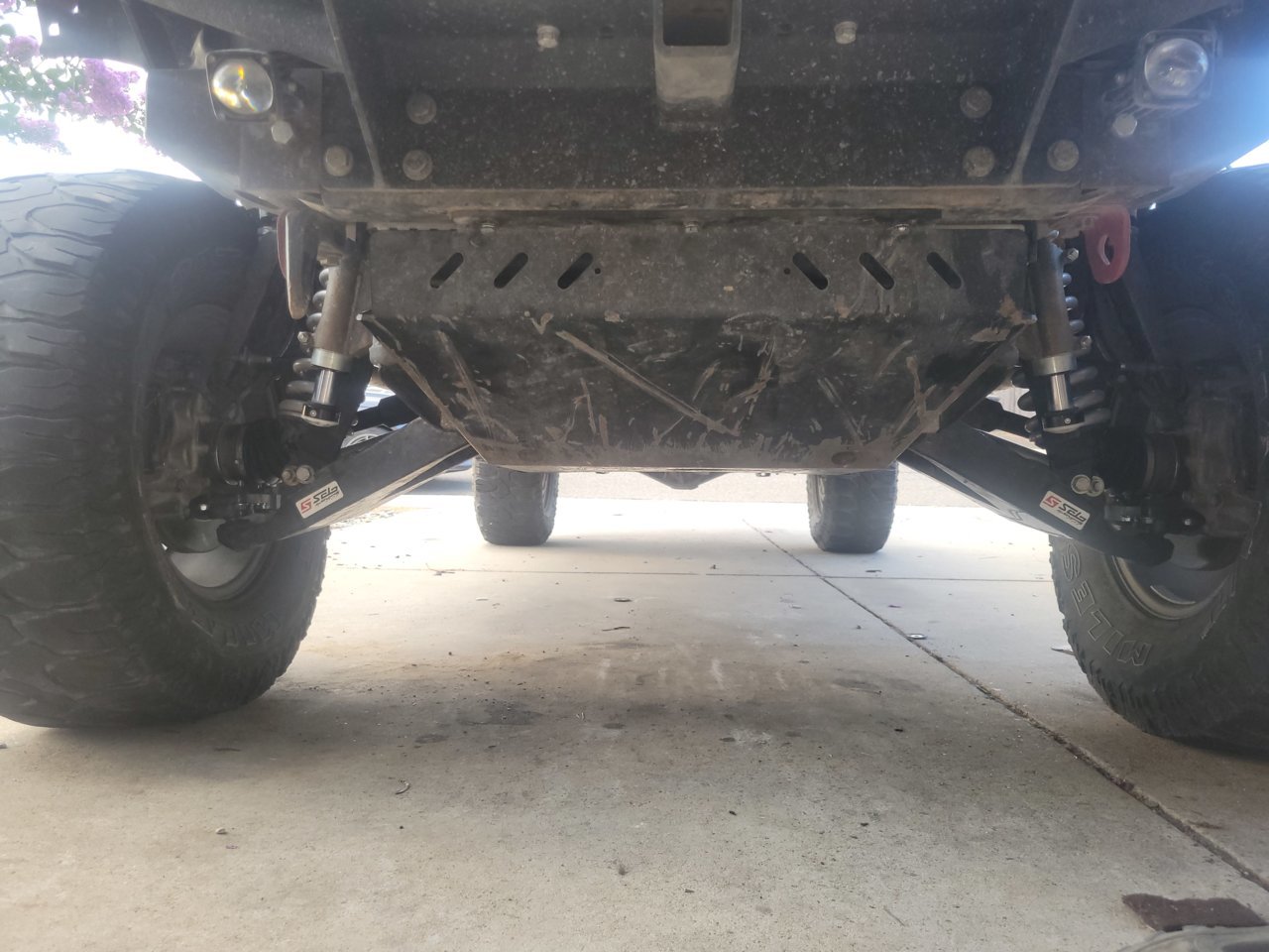

    Skids are back on.
    Now to get it slogged and a couple new tires this week and she should be gtg.

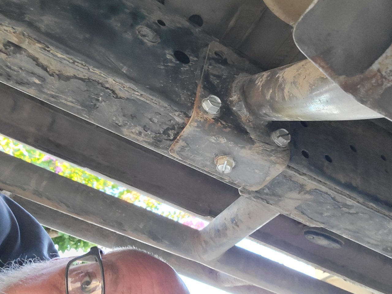

    How did you bolt your rear skid cross member? I see one on the bottom is that a through bolt?

    essjay
    essjay Part-Time Lurker
    Nov 29, 2018
    #274276
    3,259
    Concord, CA
    2011 Tacoma SR5 (V6/AC/4WD)
    I DIYed mine using parts from Pro Eagle and McMaster-Carr.

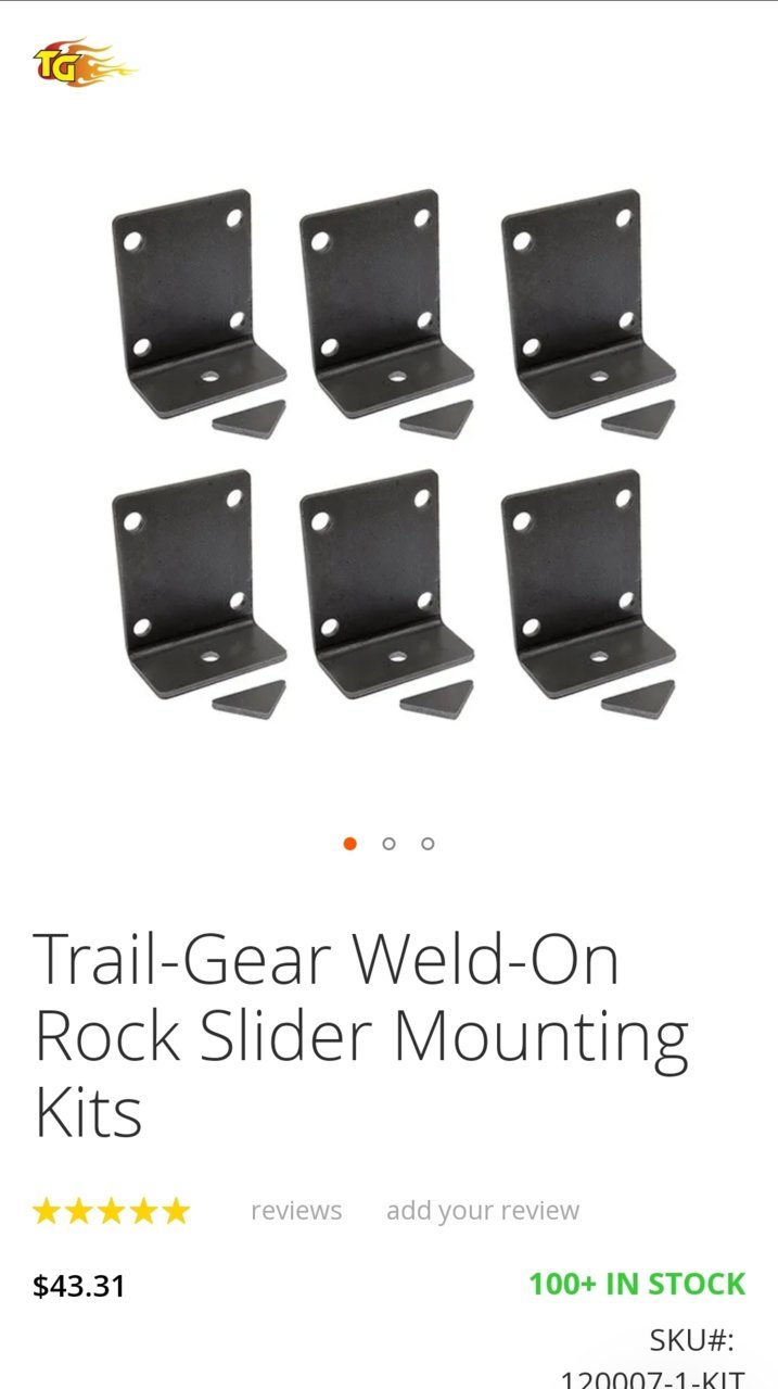

    I used one of these on either end of the crossmember.

    And you ran riv nuts?

    Looks like self tappers

    No, I ran the self tapping bolts that came with my All Pro sliders (for if you want them bolted instead of welded).

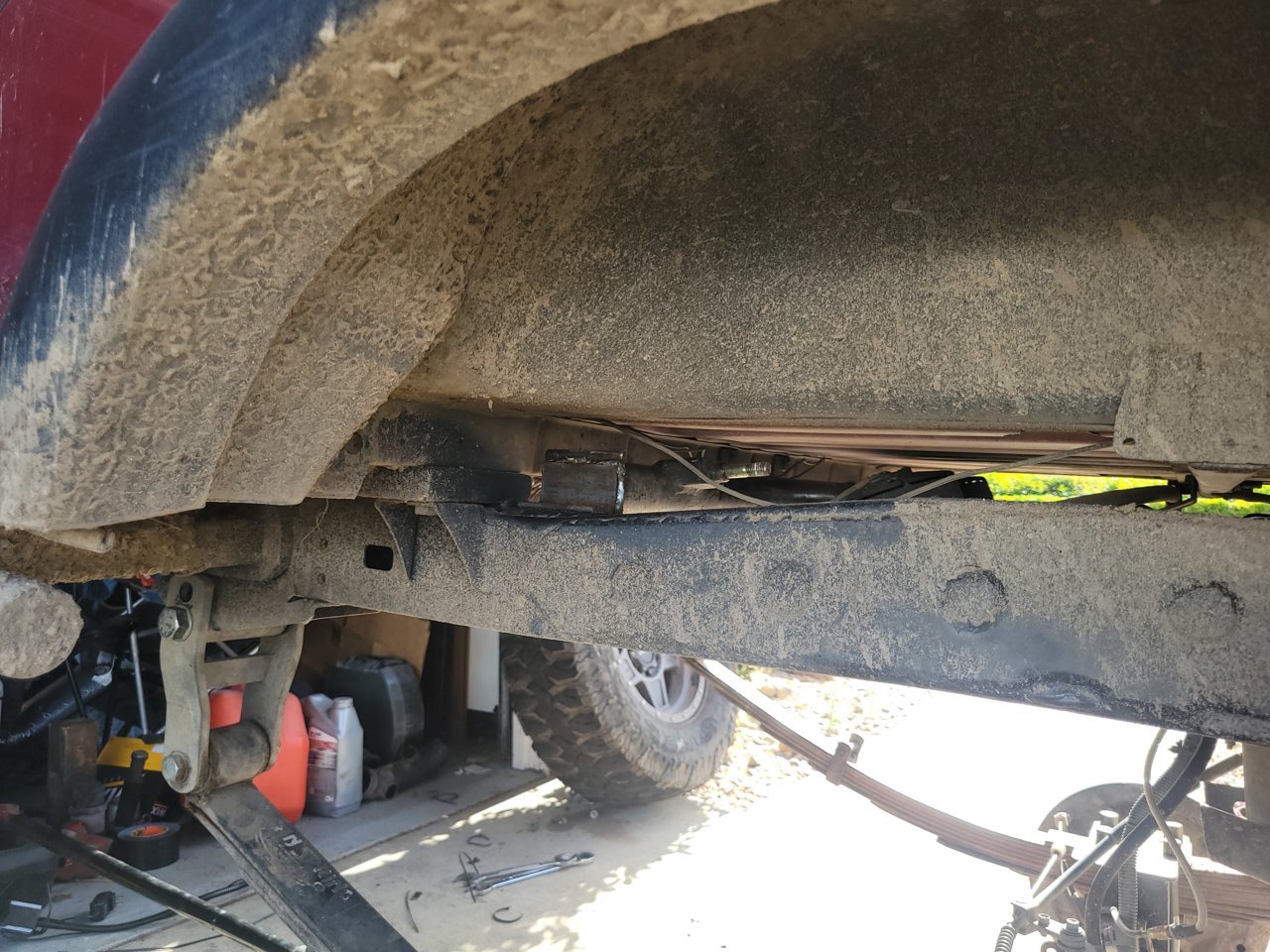

    Never ends does it?

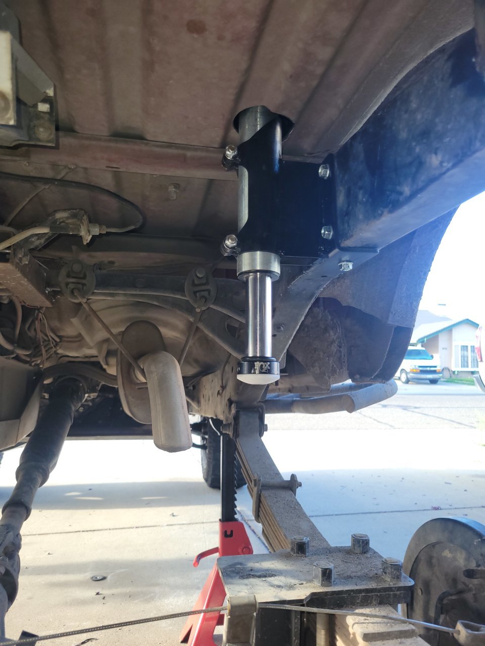

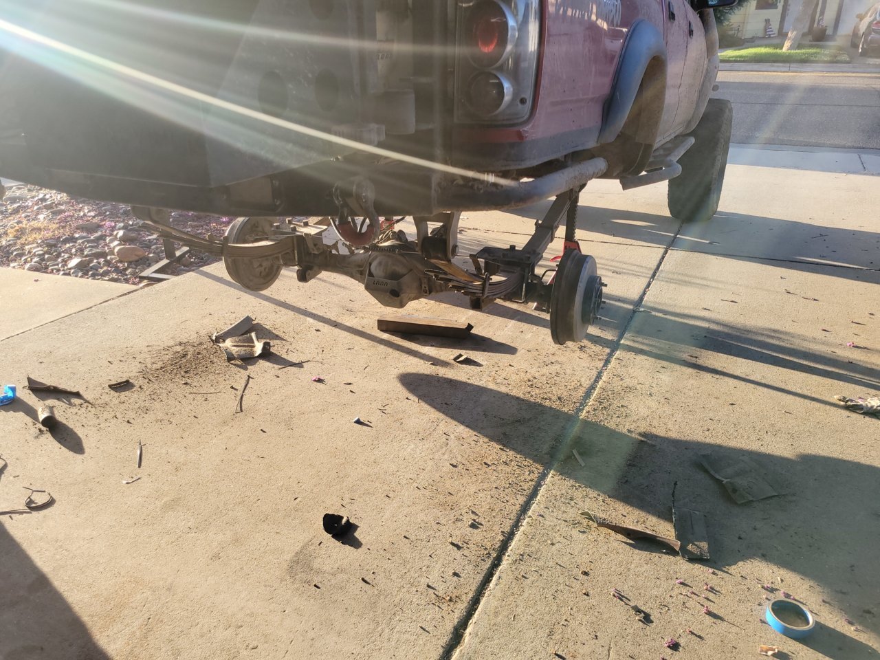

    Decided I wanted to change up the ride height in back, and get a little better position on the shocks. With the 1 inch body lift, it gave me more room to move the rear shocks up. So I raised them about 2 inches. (stuffing them up as close to the bed as I could get.
    With that, the bumps needed to go up. Upon inspecting the bump shafts, I had about 3/4 more bump travel, so I moved those up about 2.5 inch.
    Had to cut in to the bed to get them to fit.
    With that, I lowered the rear back down an inch.
    With the additional up travel, I trimmed som stuff off the rear corner of the wheel well.

    While working on the shocks, I discovered the passenger rear shock was blown. Nitrogen is leaking past the reservior o-ring.
    So... hopefully Accutune can overnight the rebuild kit. Oil should be here Tuesday (from Amazon).

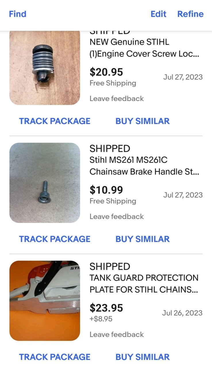

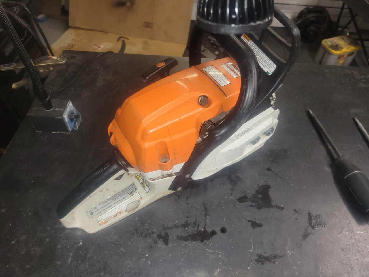

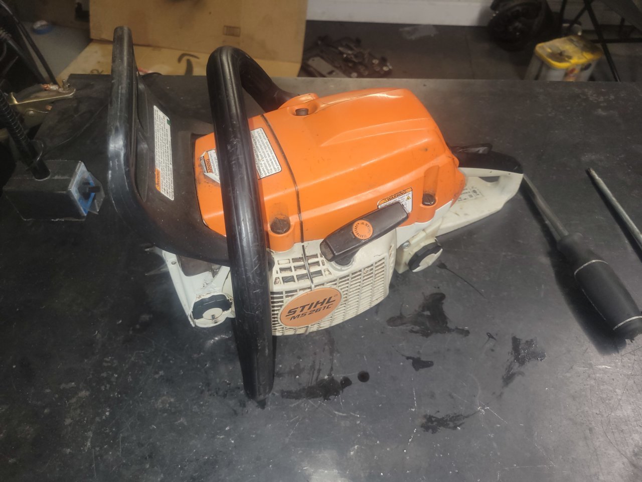

    In other news... I picked up another hobby...
    Gunna revive this little beast.
    MS261C
    Puts out right at 4 hp. Which is a full hp more than my MS250 at the same weight. Overall it's in used but good condition. Runs really good, no indications of any problems.
    There were a couple missing screws, that are already on order, and it came without a bar and chain. Which is fine, I'd rather just get them new anyway (also on order).
    Also ordered a skid plate to protect the bottom of the tank.

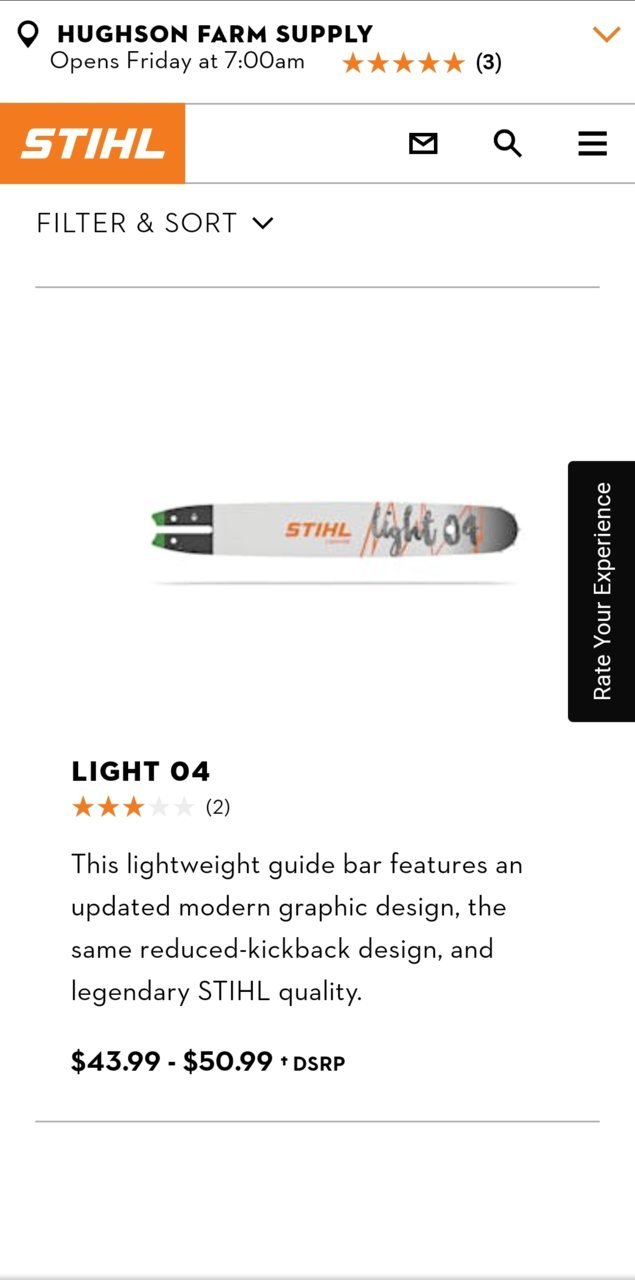

    Bar and chain

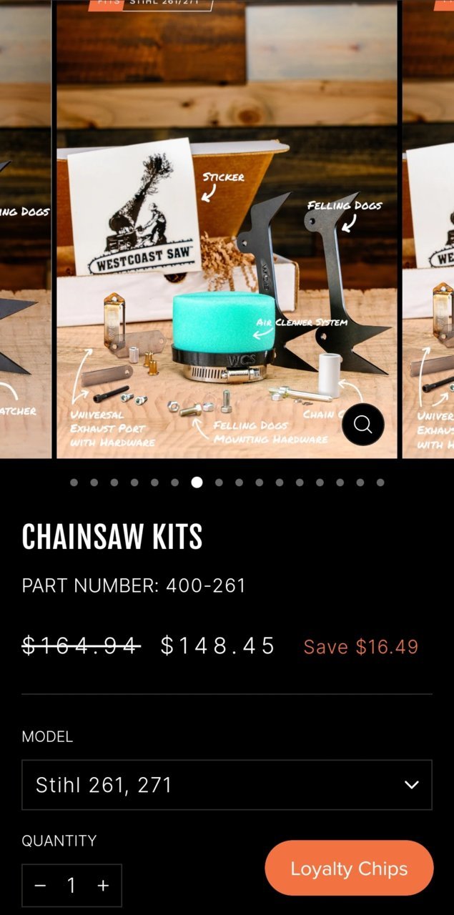

    Also ordered a saw kit from WestCoast Saw... should make it run a little harder and louder.
    The plan is to see how she runs, then pull the cylider/piston and port it for more power/torque... and by opening up the exhast it will help it run cooler.

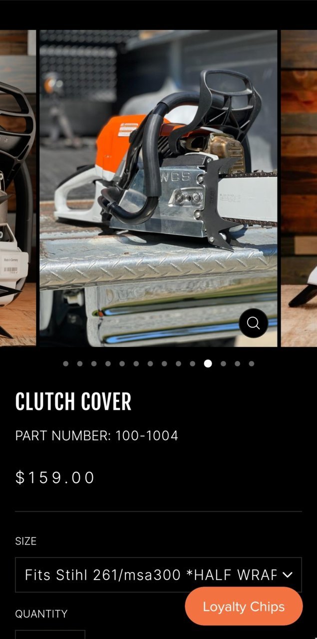

    Still debating a new clutch cover...
    It sure looks bad ass.
    And it does serve a purpose... It ejects the wood chips a lot better... and, it looks badder asser.

    Making some progress on the used (minor rehab) 261C.
    Replaced the missing top cover screw, and brake pivot screw. (they worked perfect, the holes weren't damaged)
    Installed the muffler port, and air cleaner (foam oil is on order). Installed the inner felling dog and put the chain roller on the outer dog. (waiting to install the outer felling dog till the West Coast Saw clutch cover gets here)
    And installed the aluminum bottom skid.
    Also replaced the spark plug. Old one was in decent shape, but could use a replacement.
    While the plug was out, and while the muffler was off, I inspected what I could inside. Definately no sign of anything terrible going on in there.
    So... still waiting on the clutch cover, bar and chain. And I also ordered the two bottom muffler bolts. I noticed they were missing when I removed the muffler. I used a bolt from another location on the saw and verified those threads are good.
    Kind of disappointed in Stihl. Ordered the bar and chain a week ago now... still no update... and I'm an impatient bastard when I'm waiting for parts
