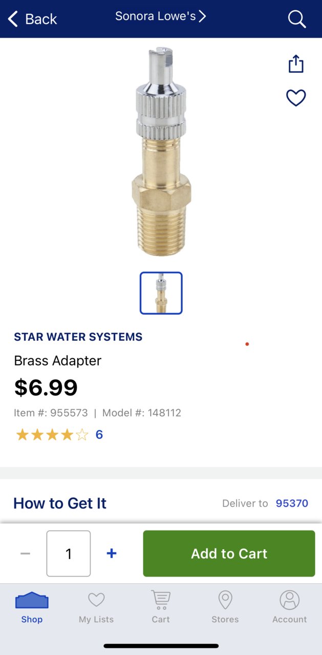

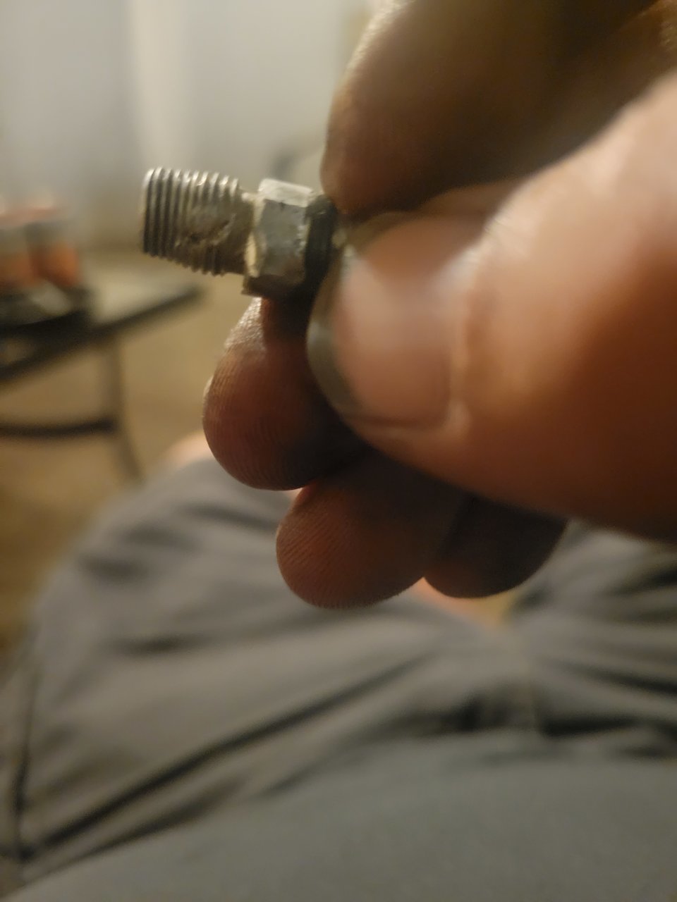

    Well that sucks.
    Rebuilding my shock. It was leaking past the O ring at the end plate of the resi... and the schrader valve.
    The f'n core was so tight in the valve I tried to drill it out and easy out the core... the sides of the core are still in there. Put so much force on the easy out it twisted the valve instead of breaking what's left of the core lose.

    Check a bike shop

    Maybe try a hardware store. It’s probably a common size but I dunno.
    Lowe’s shows this: (but not in stock apparently)

    I called Fox. They told me the thread pitch on the side that threads in to the plate is 5/16 - 32
    It looks like a Rock Shock schrader is the same. I'm going to call World of Wheels when they open (ugh... those guys are such assholes. I worked there for 3 years for my first job)

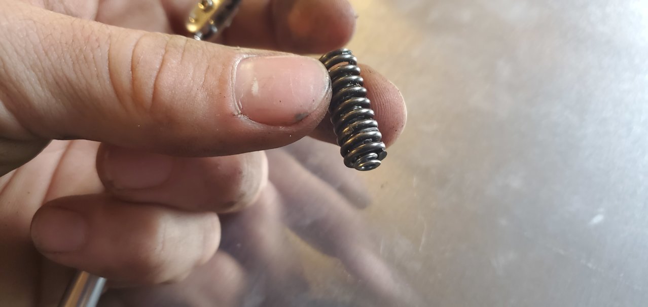

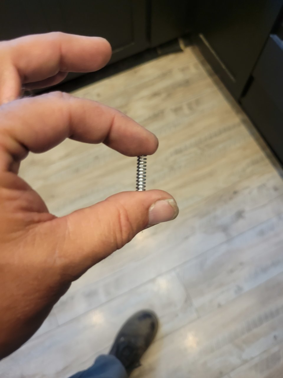

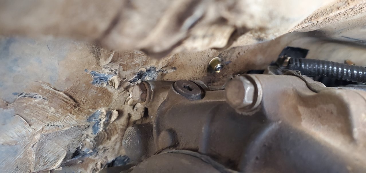

    Bought the Marlin spring for the Jshift case shifter. @betterbuckleup if you have a pic or description that will short cut my search for where it goes, it would be awesome. Glanced up in there quickly, didn't see it (but we have a bday party we're getting ready to go to).

    Goes inside the OEM spring like this.
    Goes behind that plug there with the hex socket.

    Right on... I saw that hex socket, but it didn't look like it was in the right place.
    Thank you... I'll probably try and get to that this evening, when I get the truck out of the shop... hopefully the A/C will be fixed today.

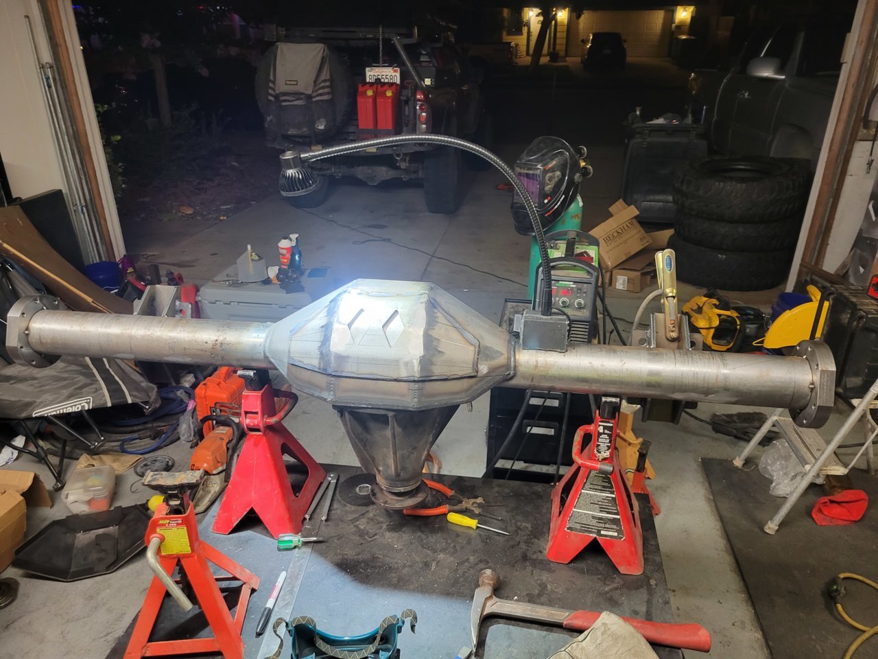

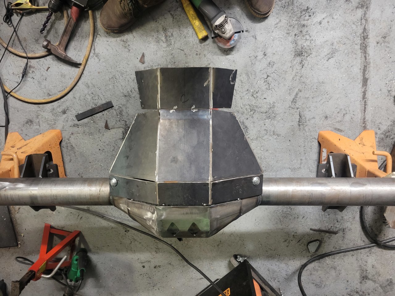

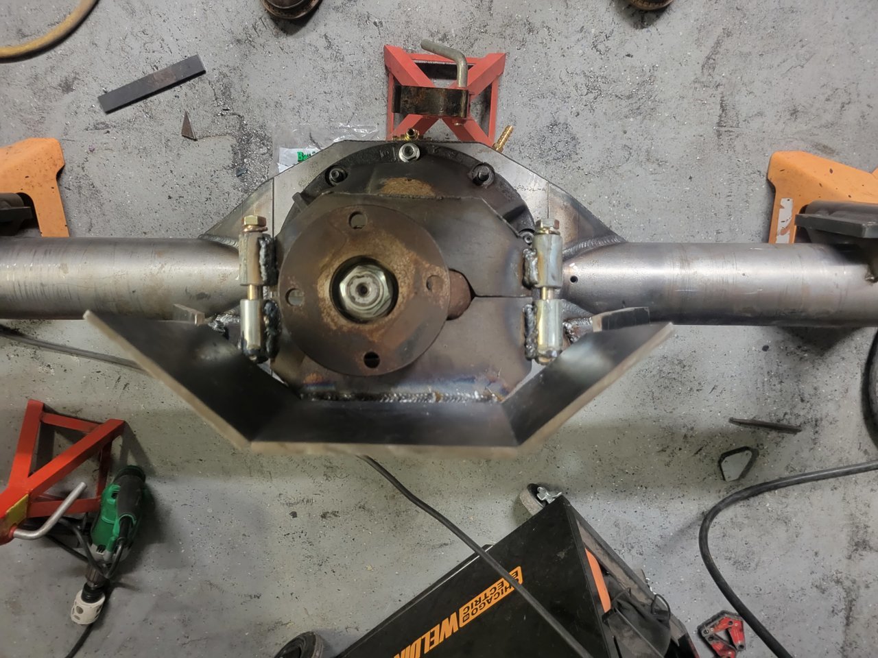

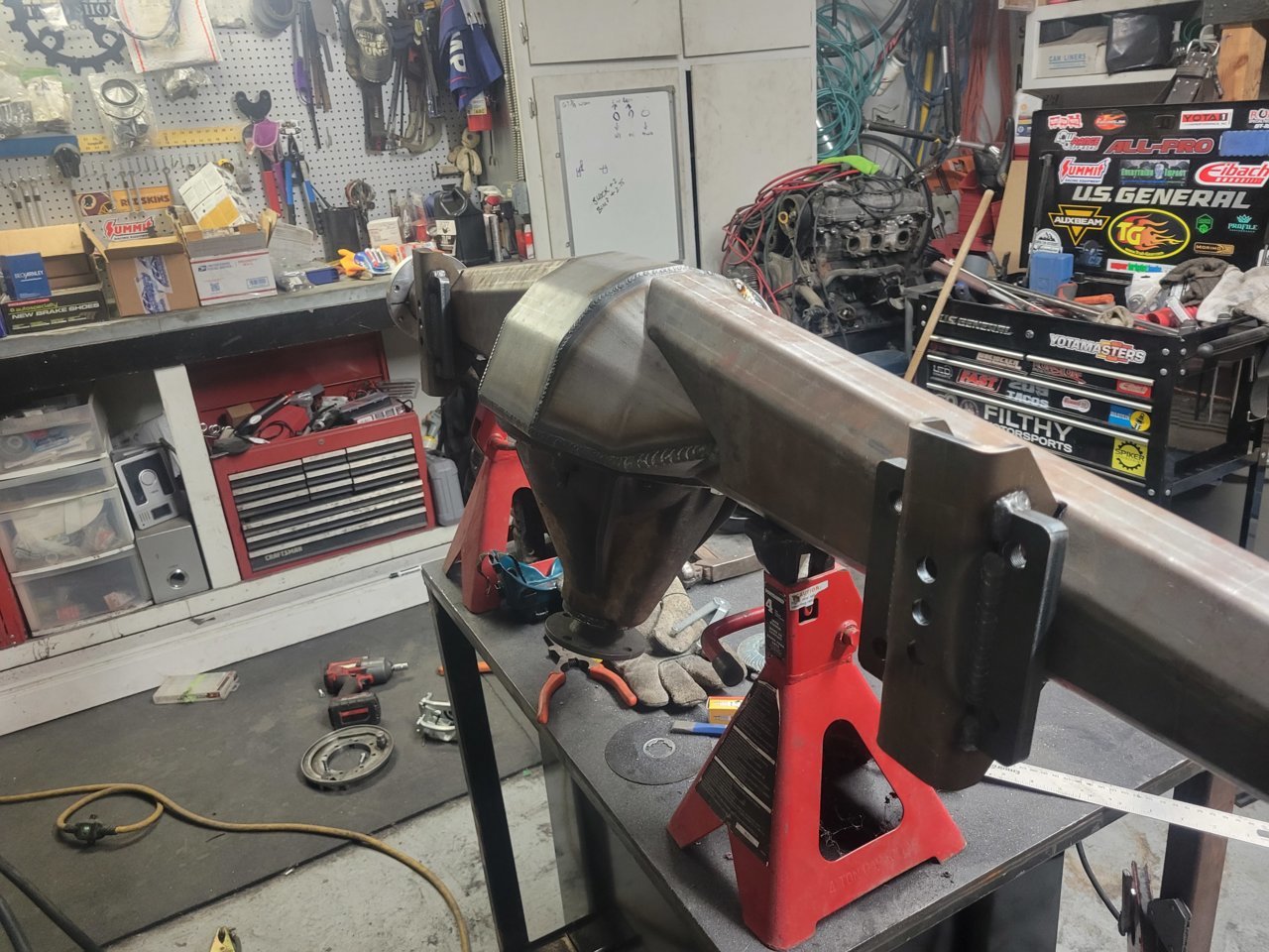

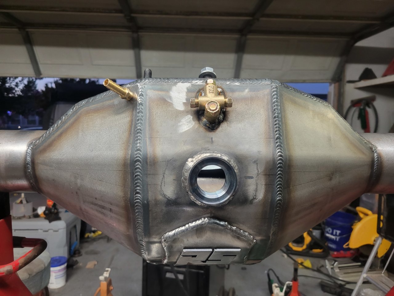

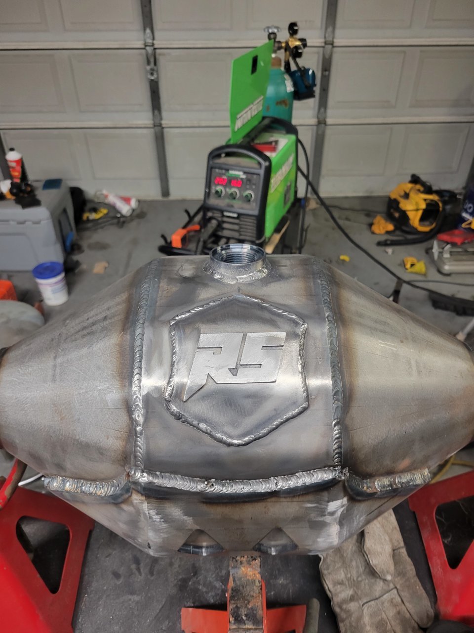

    Been awhile... figure I should update for posterity lol
    Tacked the flanges and perches in place, and welded the skid plate on the back of the diff.
    Fitted the truss.
    Welded the logo badge and Filler in.
    Welded the mounting bolt for the brake hardline splitter in. Drilled and tapped for the vent.
    Made up the mounts for the diff skid and pinion guard.
