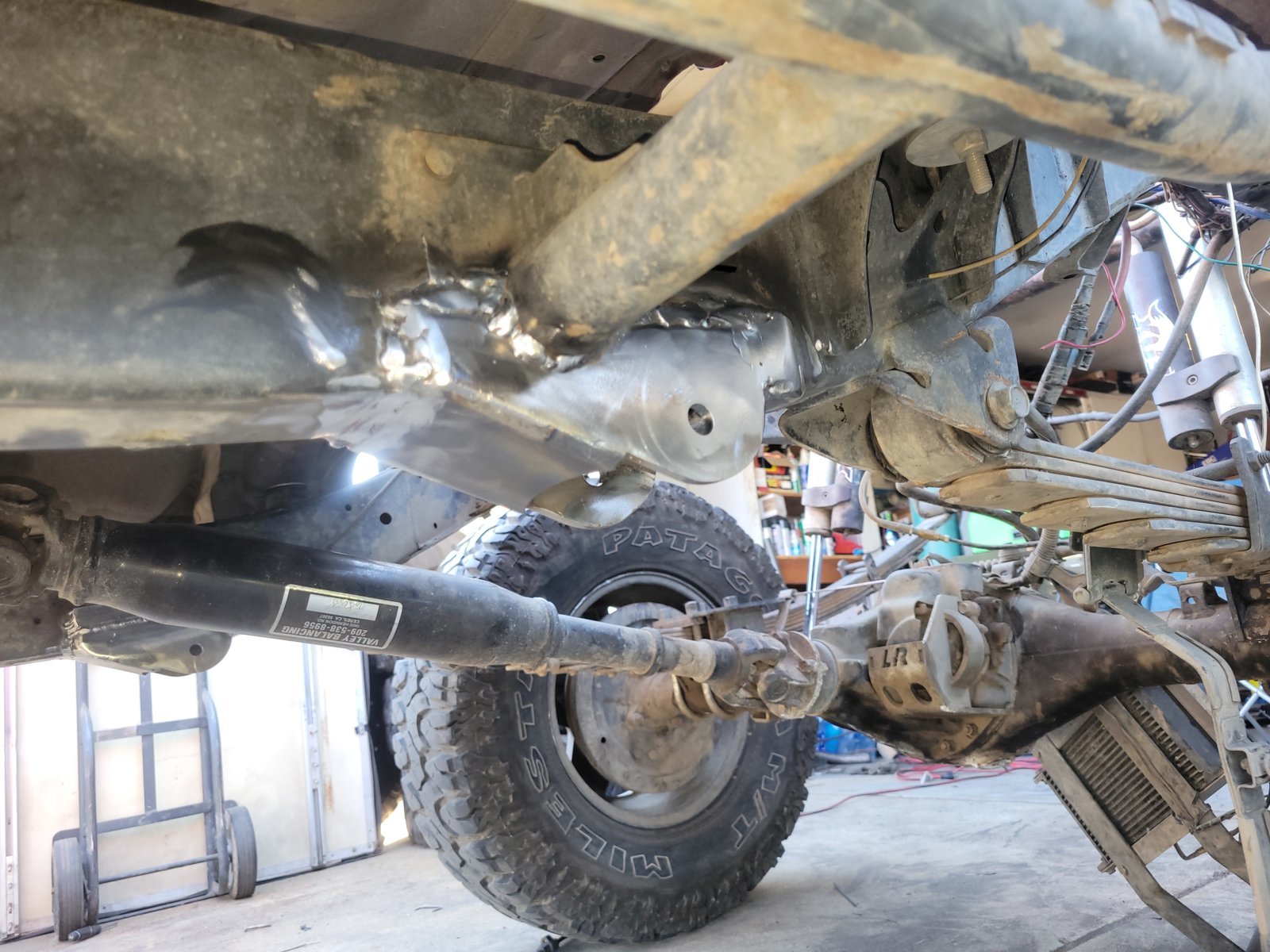

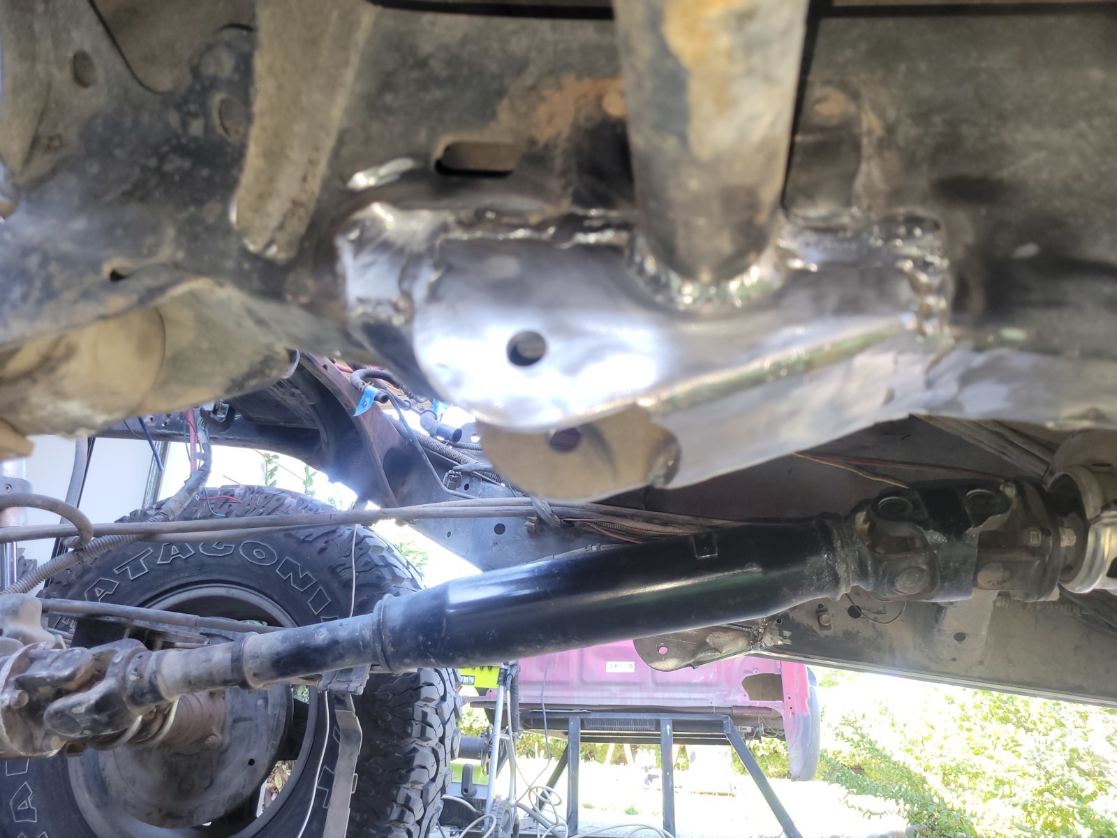

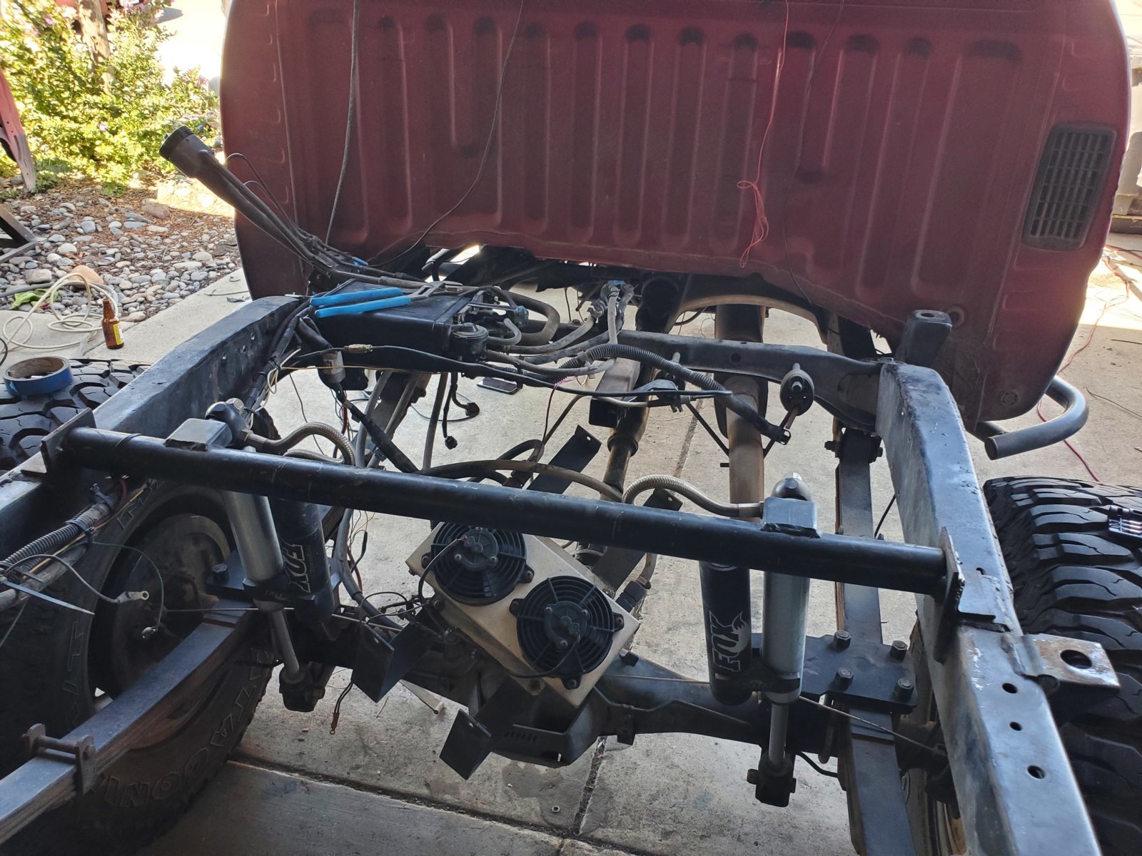

    Made progress on the fuel tank relocate from @eimkeith.
    Boy, that is a pain in the ass. Thank you to @foxrcing07 for stopping by and helping me make sense of it.

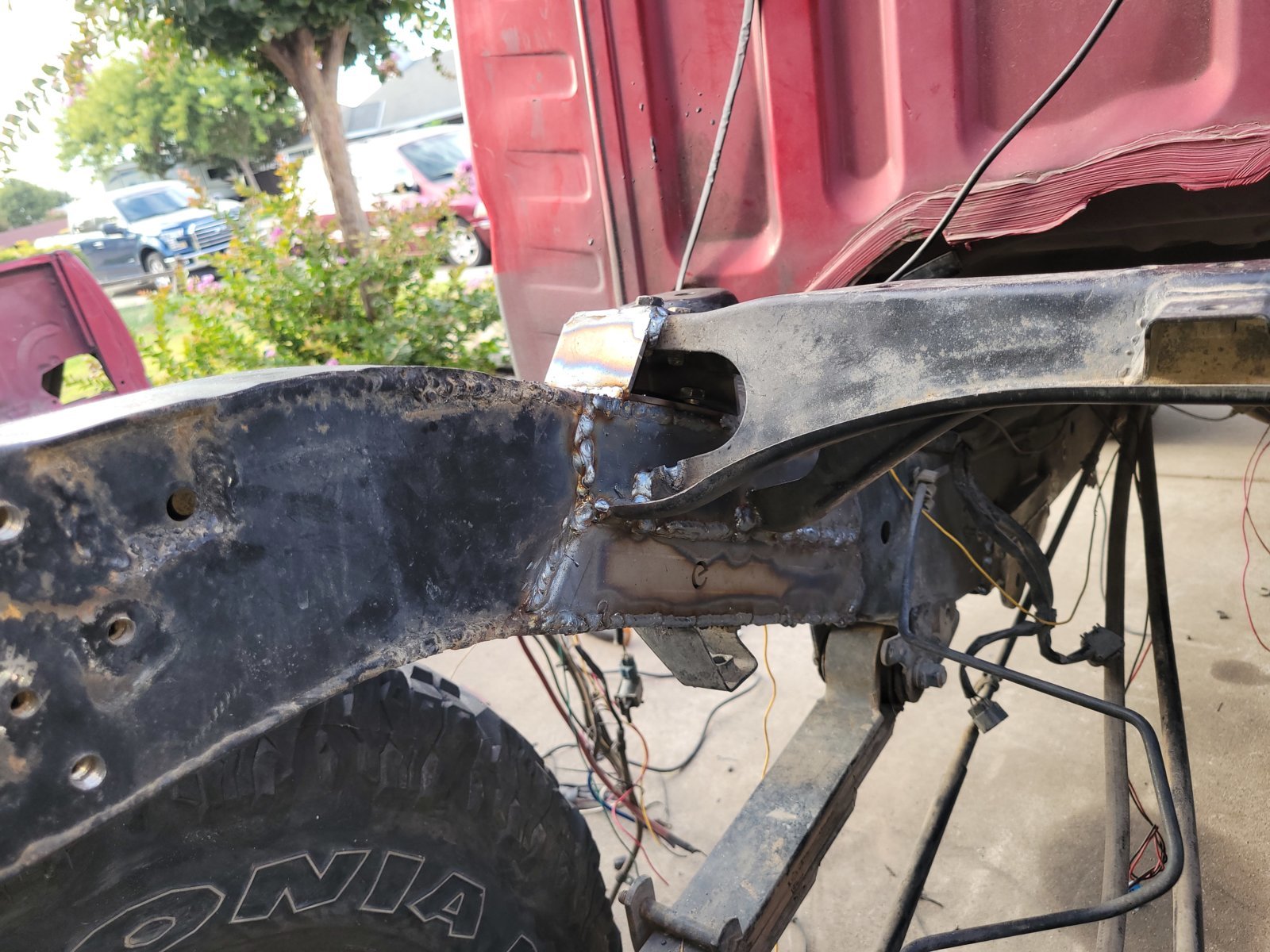

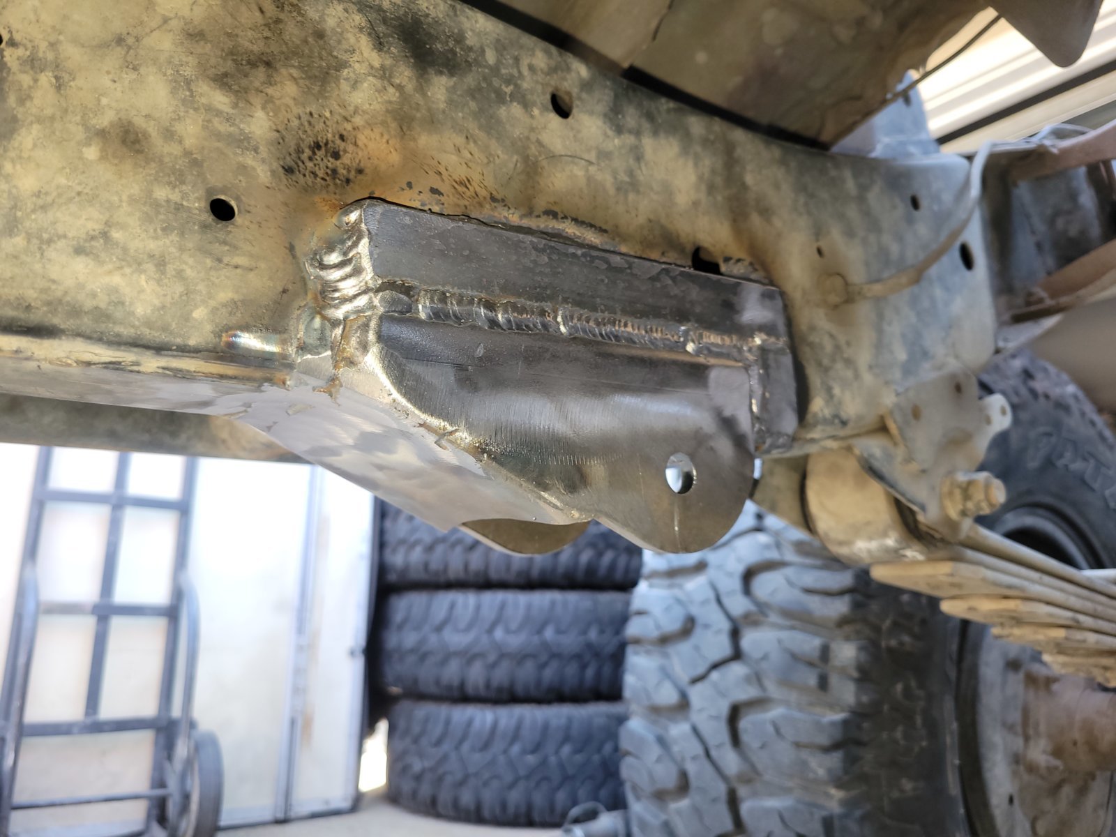

    Took the opportunity to finish boxing the frame out.
    Was way out of position, filling really big gaps, and I don't know shit about welding... so... I really don't give a shit what they look like.

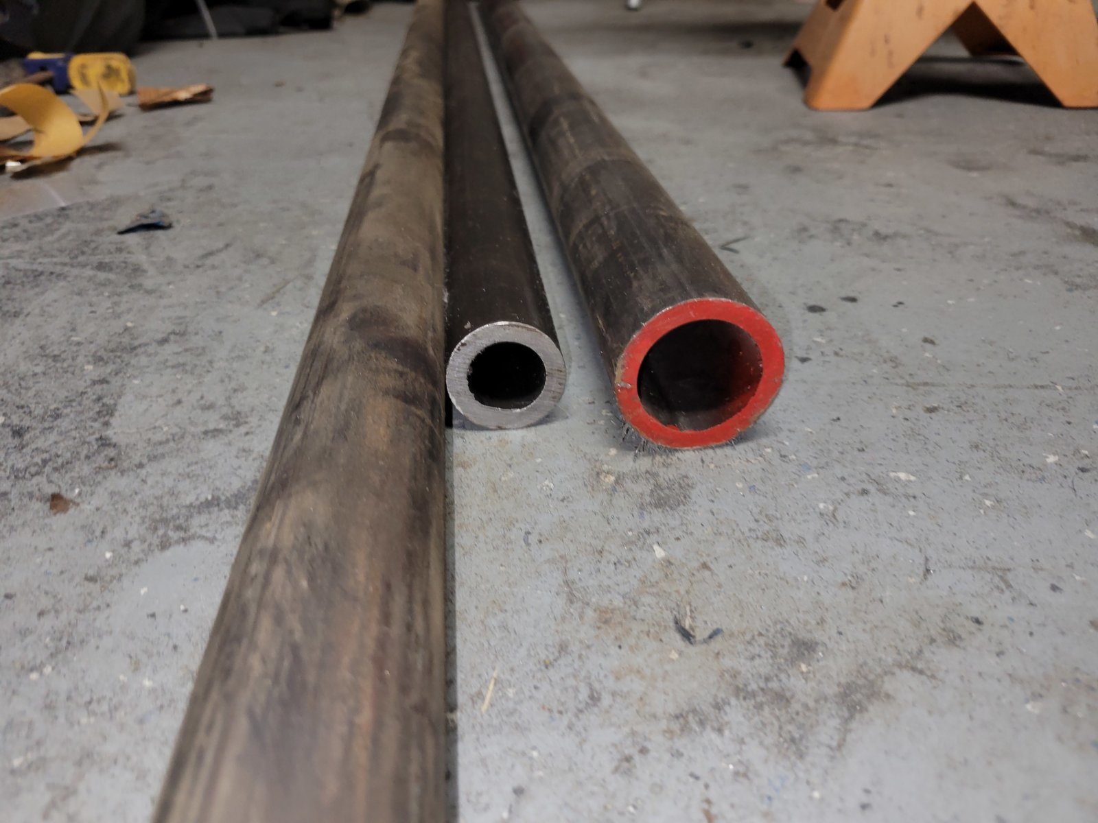

    Picked up the DOM tubes for the traction bar today. Shit is no joke. 2 inch, 1/4 wall, for the bottom (bash) tube. 1.5 inch, 1/4 wall, for the top (adjustment) tube.
    Also picked up a 1.75 stick for the rear shock hoops.

    Test fitted the fuel tank. The way it's going to sit is going to be awesome.
    I cut the pinch weld at the back of the cab to give me a bit more clearance. And I'll probably hammer the floor board up a little as well.
    I have to cut the front mounting plate back off the cross member, the way it located with my welds ended up putting the plate about 2 inches too far toward the center (driveline).
    Also, while I have the plate off I'll weld some nuts to the back of it. The stock mount has the nuts welded, the new mount doesn't. And trying to get a wrench up in there is not a game I want to play.

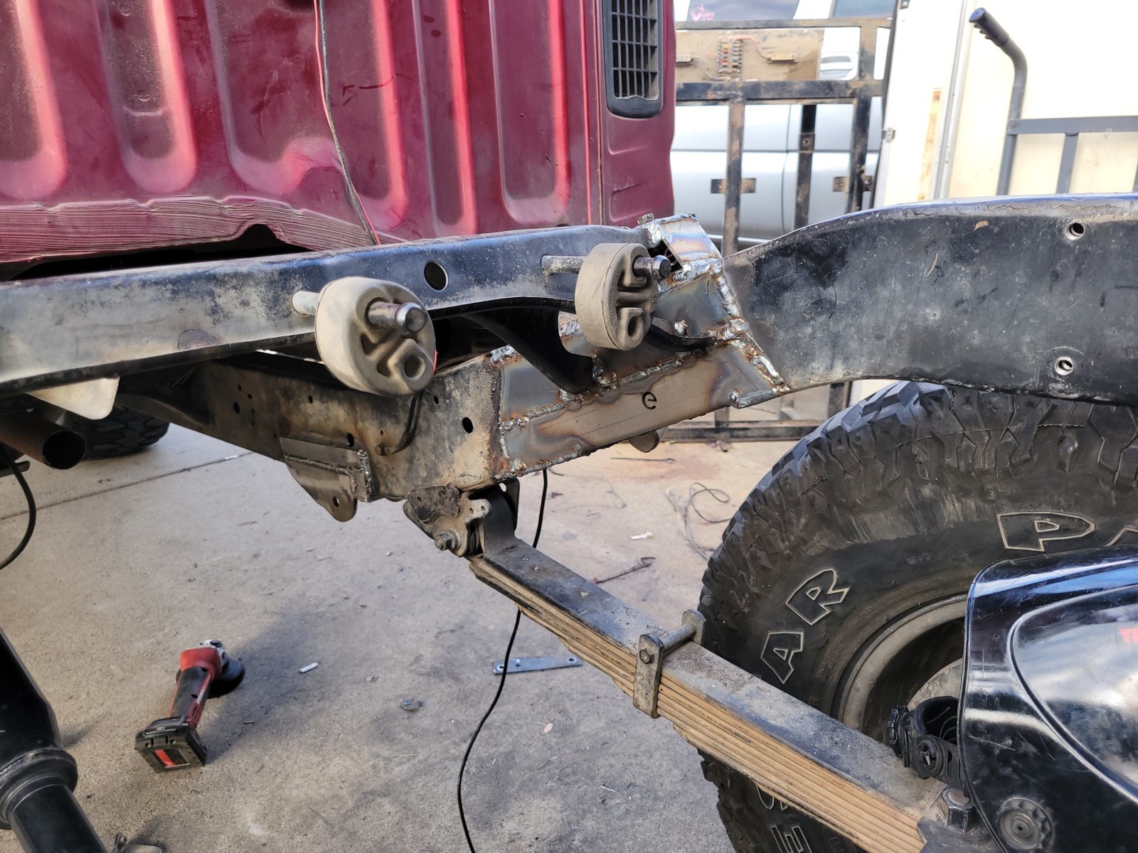

    @Speedytech7 gave me his measurements.
    They worked out almost perfect. @foxrcing07 and I verified them by measuring from front eye to center pin on the 63s, and front (63) shackle to center pin on the Toyota leaf. The measurement is actually the same.
    Initially Morgan and I thought we were an inch too forward. But that was because we were taking the measurement of the 63 leaf, front eye to center pin unsprung. It wasn't matching the measurement from the 63 perch to the Toyota center pin with weight. As soon as you account for the flattening of the leaf. It puts me right where it needs to be.

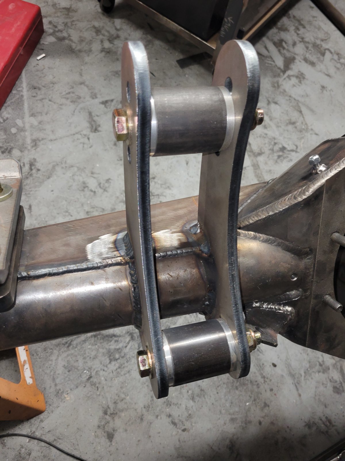

    Traction bar mount is mounted on the axle.
