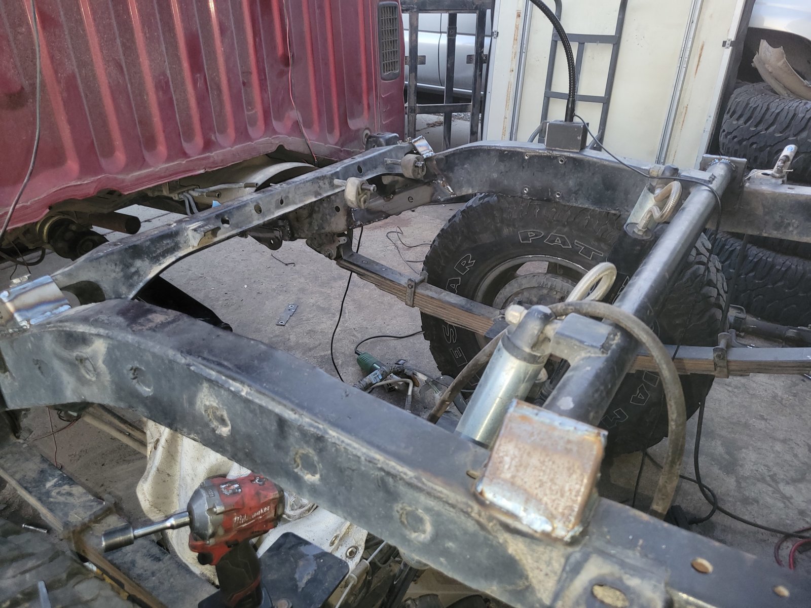

    Picked this up at Harbor Freight. Like I said, even if it just gets me done with the fenders, it's worth 30 bucks.
    Taking a break tonight. Only thing I did is empty the fuel tank with a cheap transfer pump that I bought while I was at HF. Was hanging at the register.
    Got 8 gallons out of the tank... :anonymous:
    Meaning I was trying to lift 50 extra pounds when I was trying to get the tank back in yesterday. Should be a little easier now.

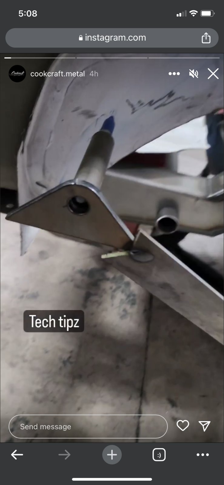

    Just saw this on Cookcraft Metal’s story - basically fabbed up a jig to hold a marker a fixed distance from the hub and rotate it so he could draw a concentric circle to cut body lines.

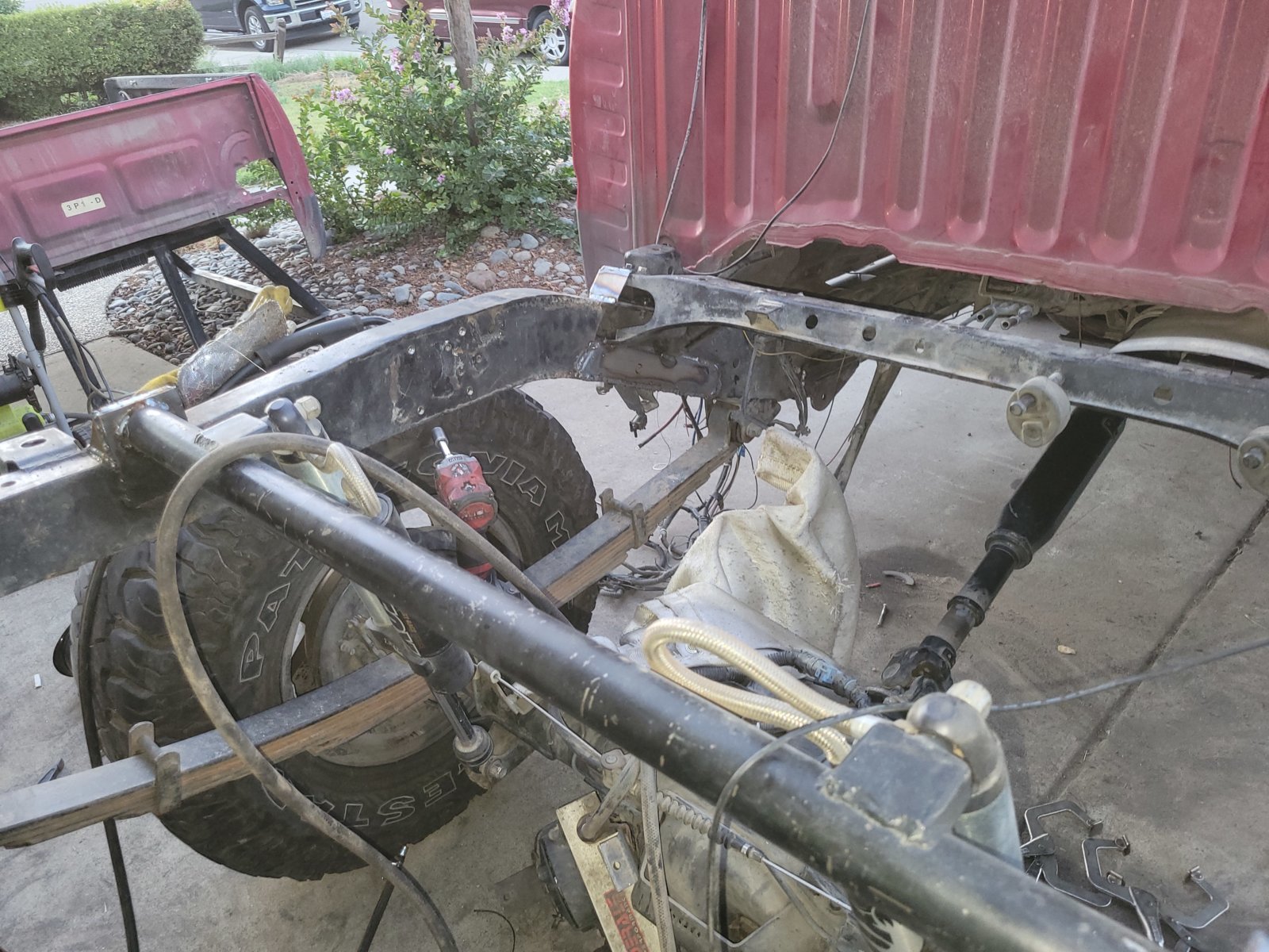

    So far the fuel tank part is going well. I test fit it up in there. It seems to fit without issue.
    I did have to move the front bracket out to the driver side from where I had it. It seemed like the tank was going to be too close to the driveline.
    I did cut the pinch weld at the bottom back corner of the cab, where the fuel tank is going to be, for some clearance. But aside from that, I think it's going to be good.
    With that being said, I do have a 1 inch body lift. I don't think this would being going so well if I did not have the body lift.
    I DO, however, need a bit of help on the evap box relocate. I know what the big main plate does and where it goes. I don't really know what the other small parts do or go to, and I haven't been able to find any info on them.
