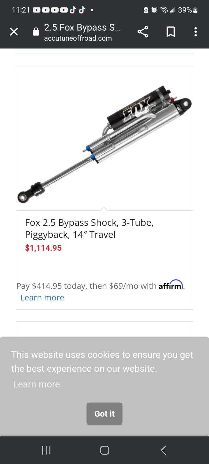

    I asked him if they are 2.0 or 2.5
    I can't tell from the picture.

    Sometimes it’s hard to tell with no reference in the picture. I’d say they are 2.5’s but $1650 is a lot especially if you’re unhappy with the color. That’s probably not too far off from new price.

    They are almost $1200 for one, new. (After tax)

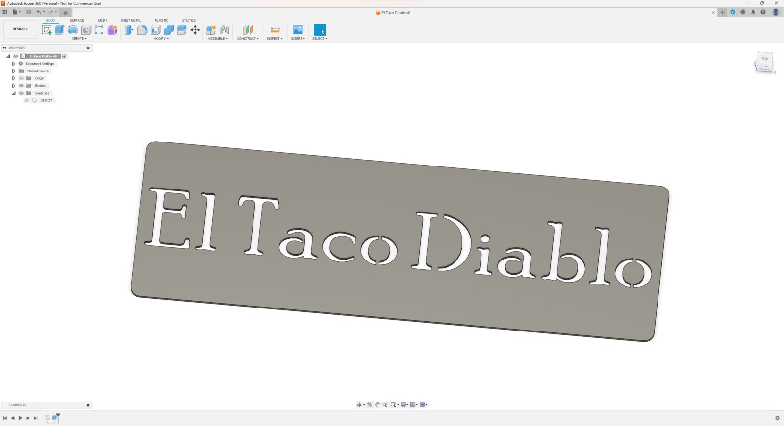

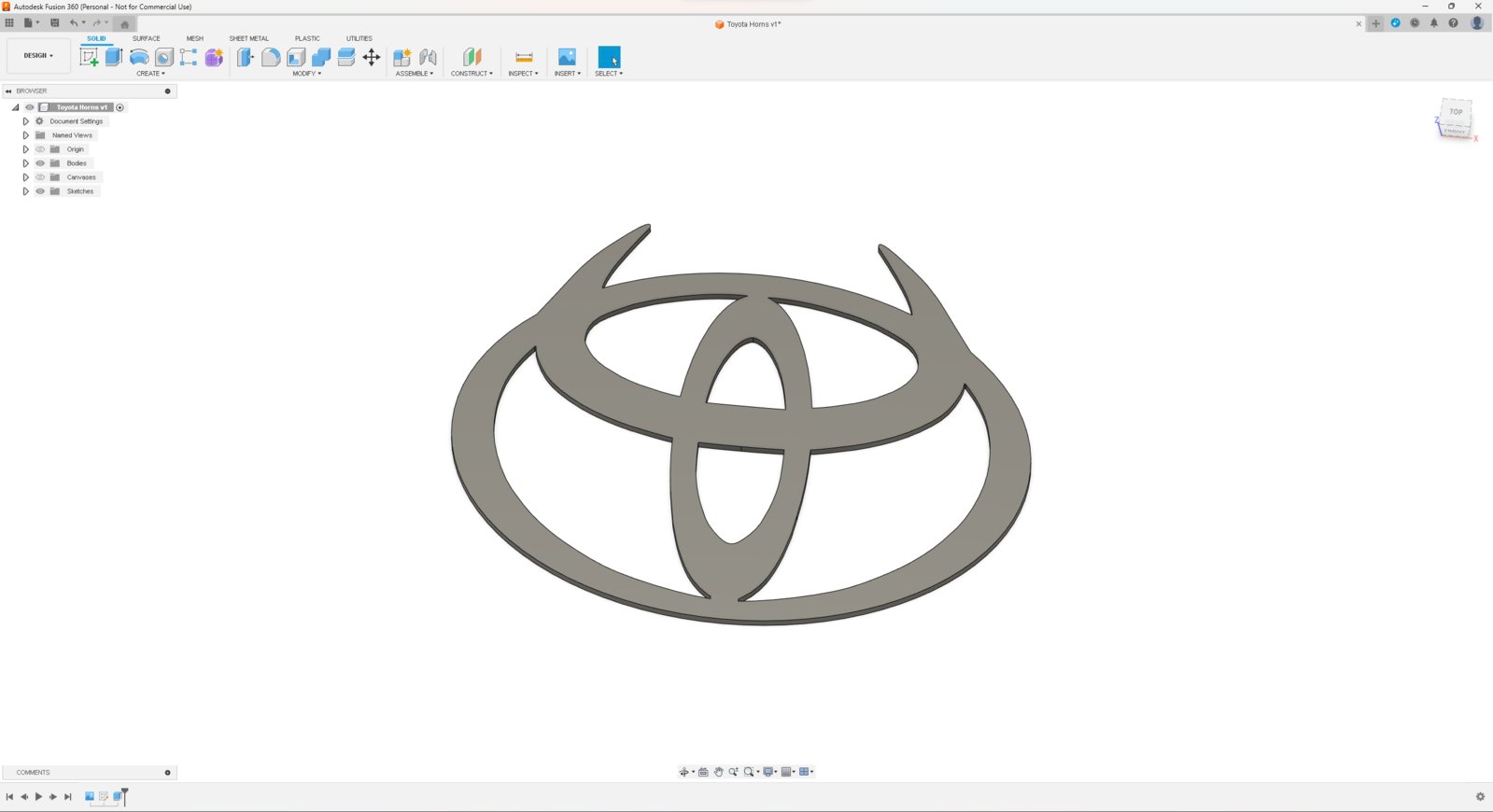

    Unless you just used this instead :laughing:
    Just sketched it right now

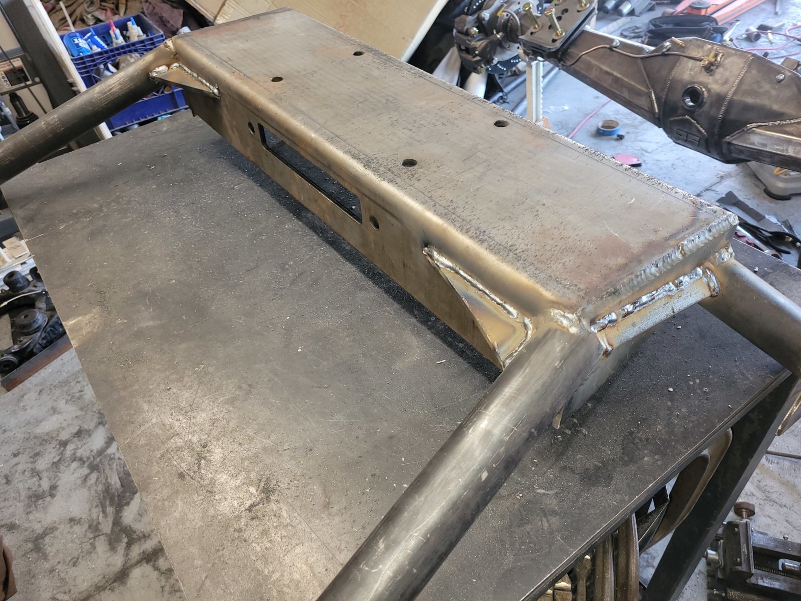

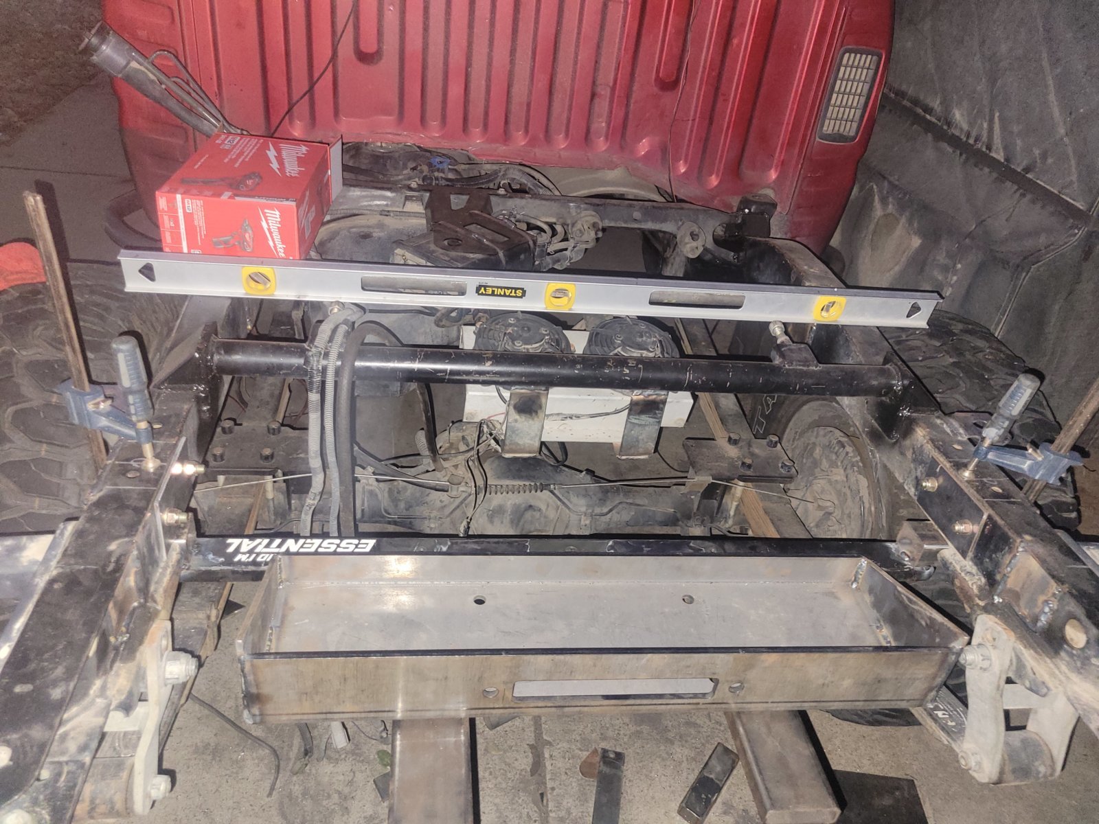

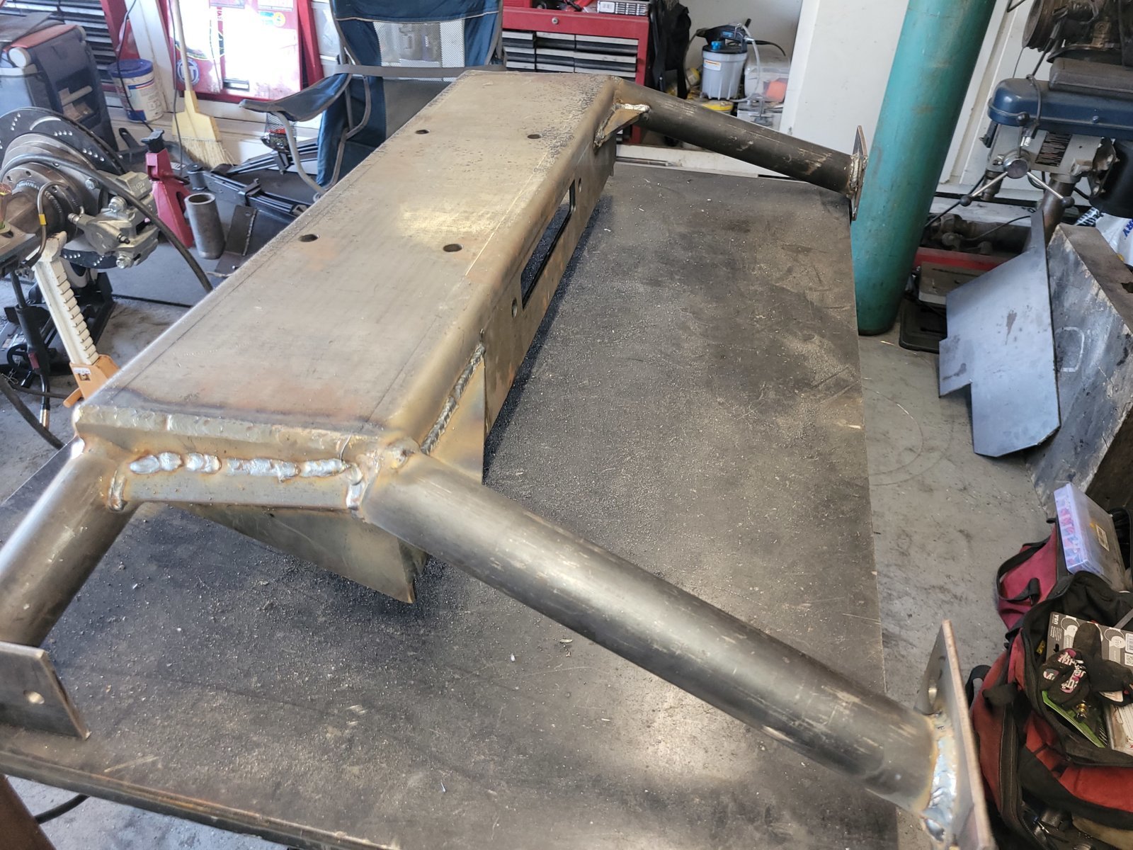

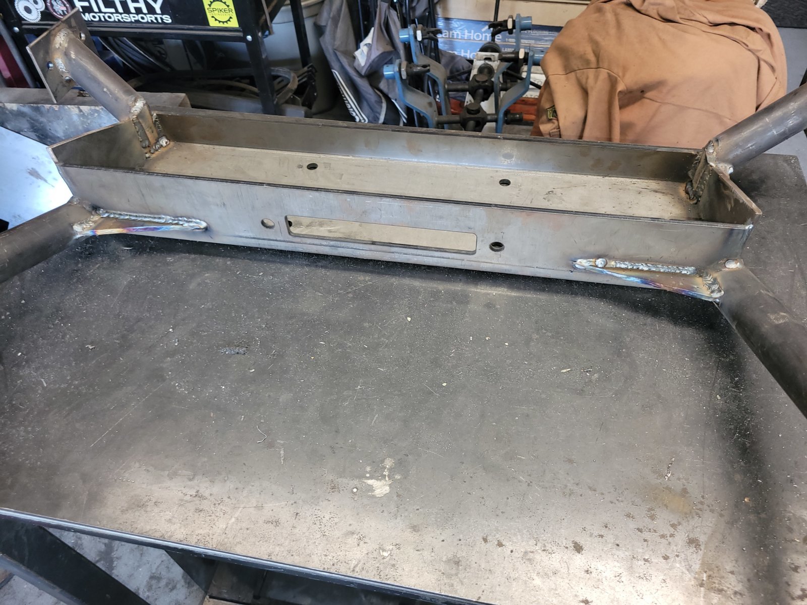

    Winch cradle mocked up.
    Winch cradle welded and ready for paint.

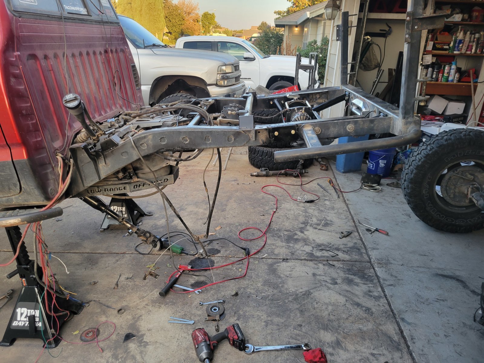

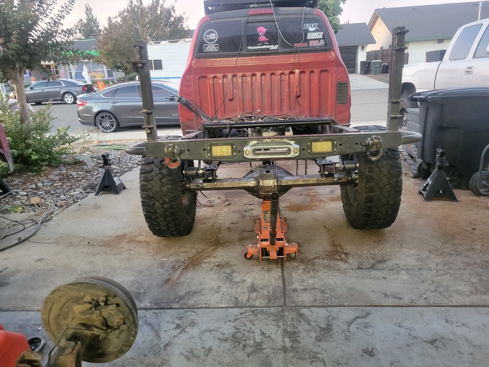

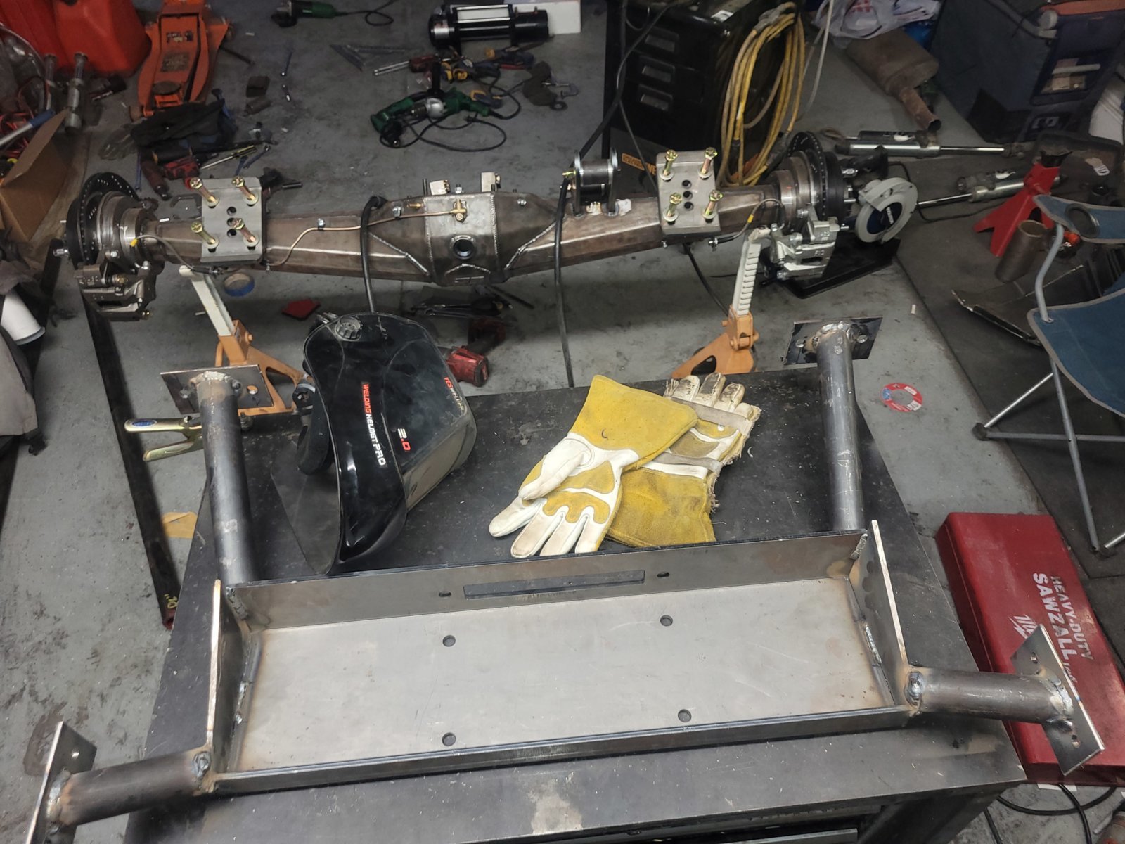

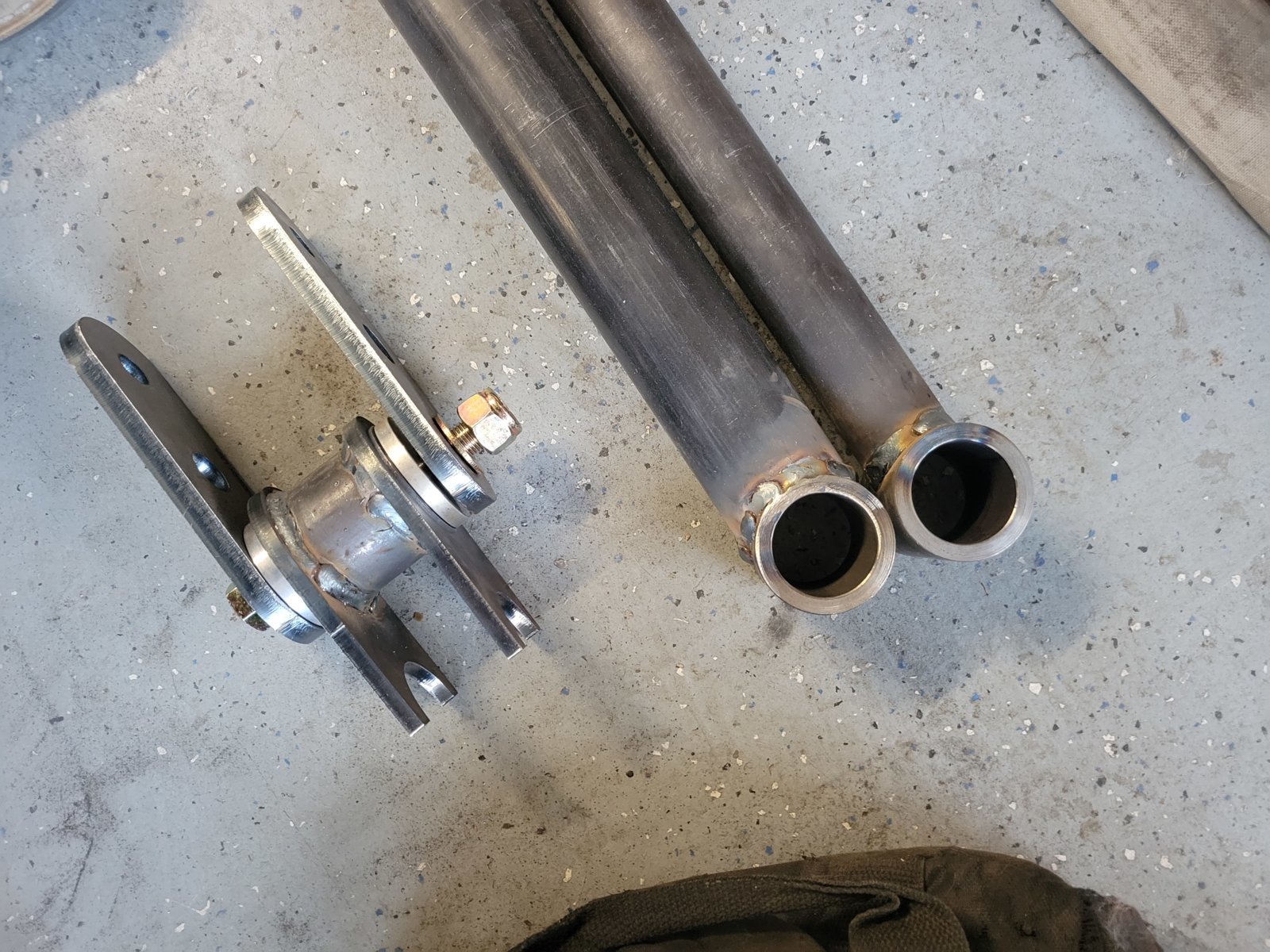

    Rear axle is out. Front (stock) leaf perches are gone. Tomorrow I'll size up the rear perches and tack them in.
    Did some assembly on some of the traction bar.
    Got the front traction bar mounts started.

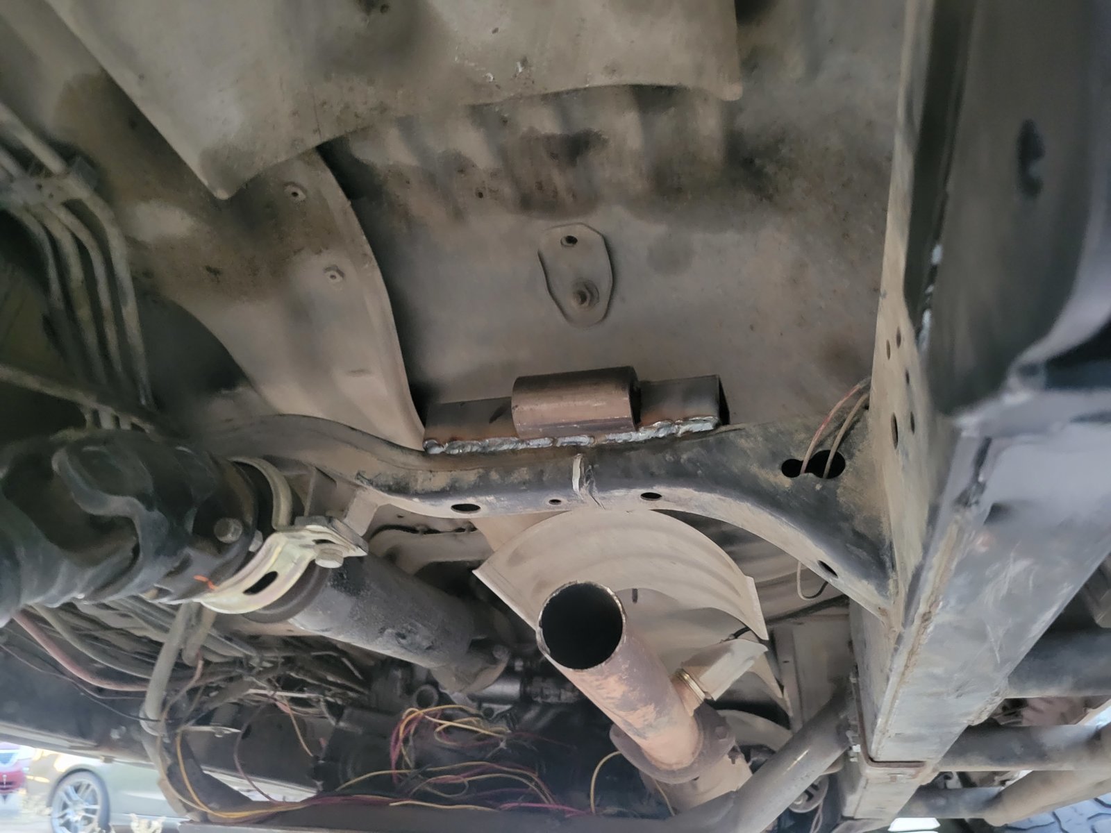

    Going to have to do some stuff with the exhaust. But it's all in the plan lol.

    Exhaust looks fine there
