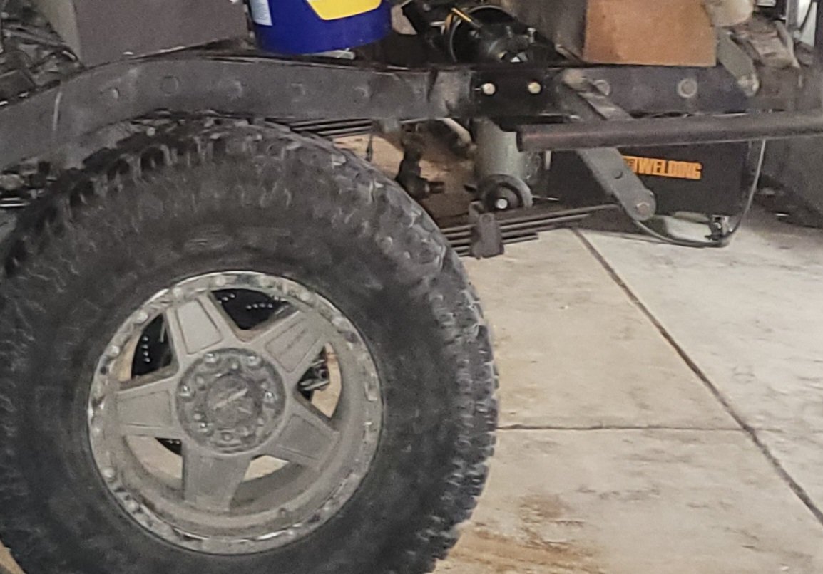

    So, they didn't sag at all. And with this "full load" on the truck I still have a little over 1/2 inch more between center of axle to bottom of frame. That says my ride height is really, pretty much where I want it.
    Now, for shackle angle. I'm reading in a bunch of places that with 63s you want around 30°.
    I thought my shackle angles looked good, but now that I have an angle finder on them it's saying I'm not close to 30°.
    I'd have to be at this angle to be at 30°
    Damn... that's a really shallow shackle angle.
    @Speedytech7 what angle are you running on your shackles? Are you happy with them?

    I'm at 45° I think, I measured it early on with just the bed on. It's a bit more when loaded down, nearing 38° I'd guess. They ride pretty damn decent. I'm on the 5" shackles though so the shackle movement for given amount of weight would be more extreme. And I prefer my truck at about 2.25-2.5" over stock lift wise

    Ya, I just moved it to 37° and it dropped the truck an inch. That ain't gunna work lol.
