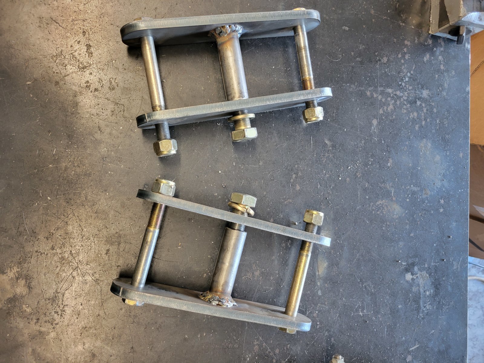

    Shackles are ready.
    Relocated the perches for the 7 inch shackles. Hitting 35° at (around) ride height. (Nothing is for sure about ride height until it's actually sitting at ride height)

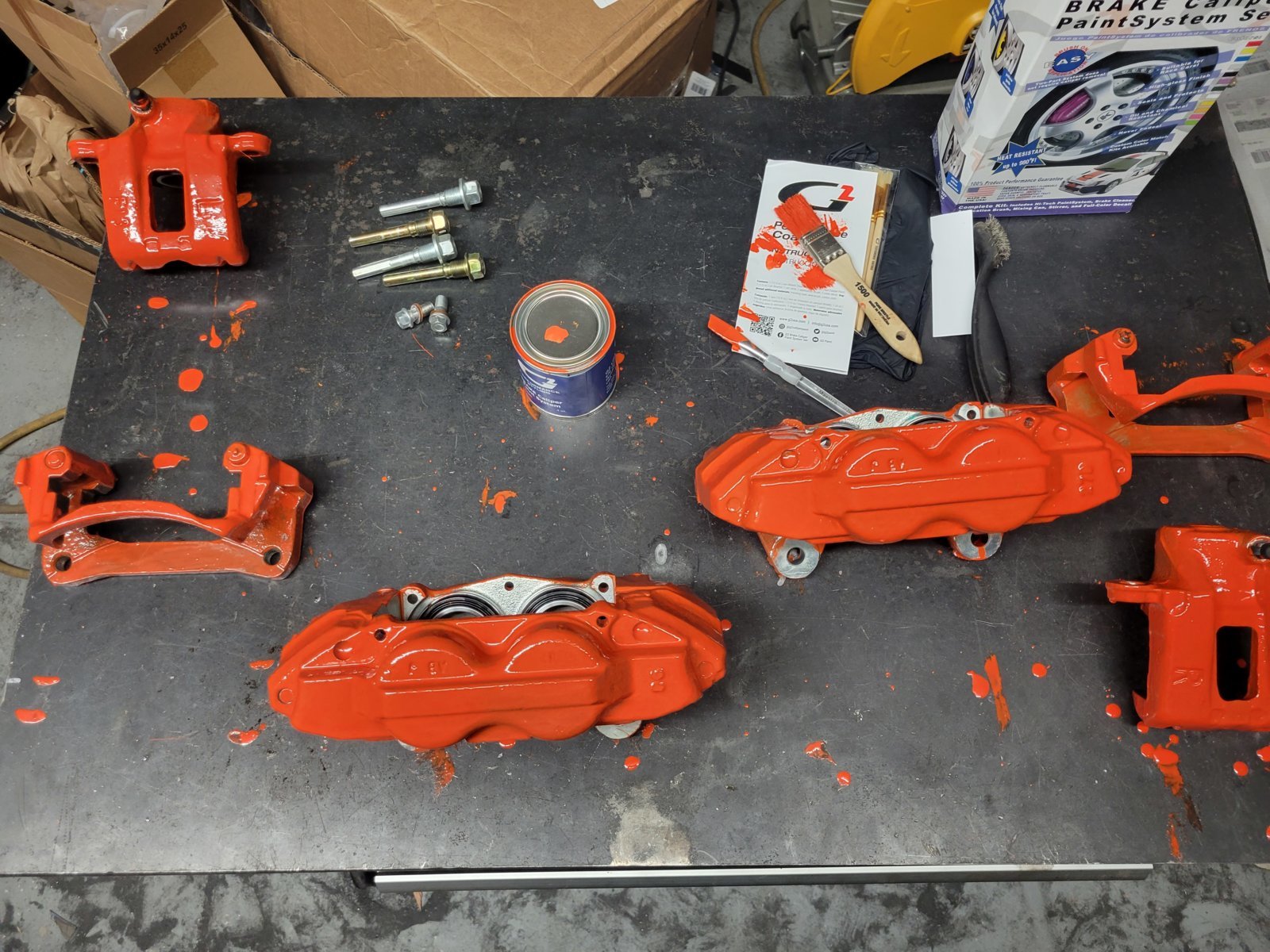

    Yesterday was arts and crafts.
    LX460 fronts, 4th Gen T4R rear.
    Will clean up the mounting surfaces, then they'll be good to go.

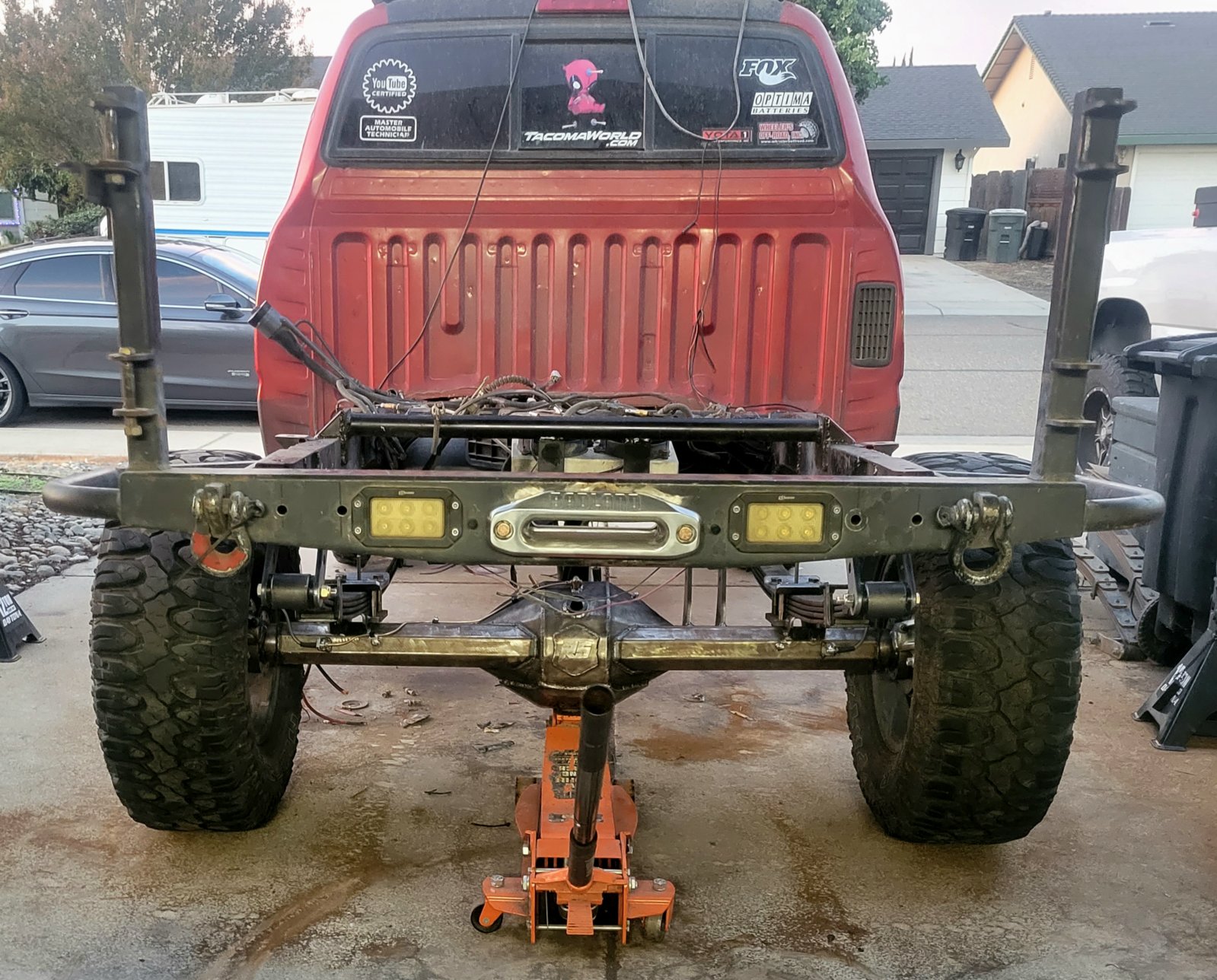

    you went to a sequoia axle in the rear?
    Did you measure the flex you are getting with the 63's yet?

    Definately not a Sequoia axle.
    Cycling with just the main spring, with no wheels/tires mounted, I'm getting right at 14 inches from full bump to full droop.

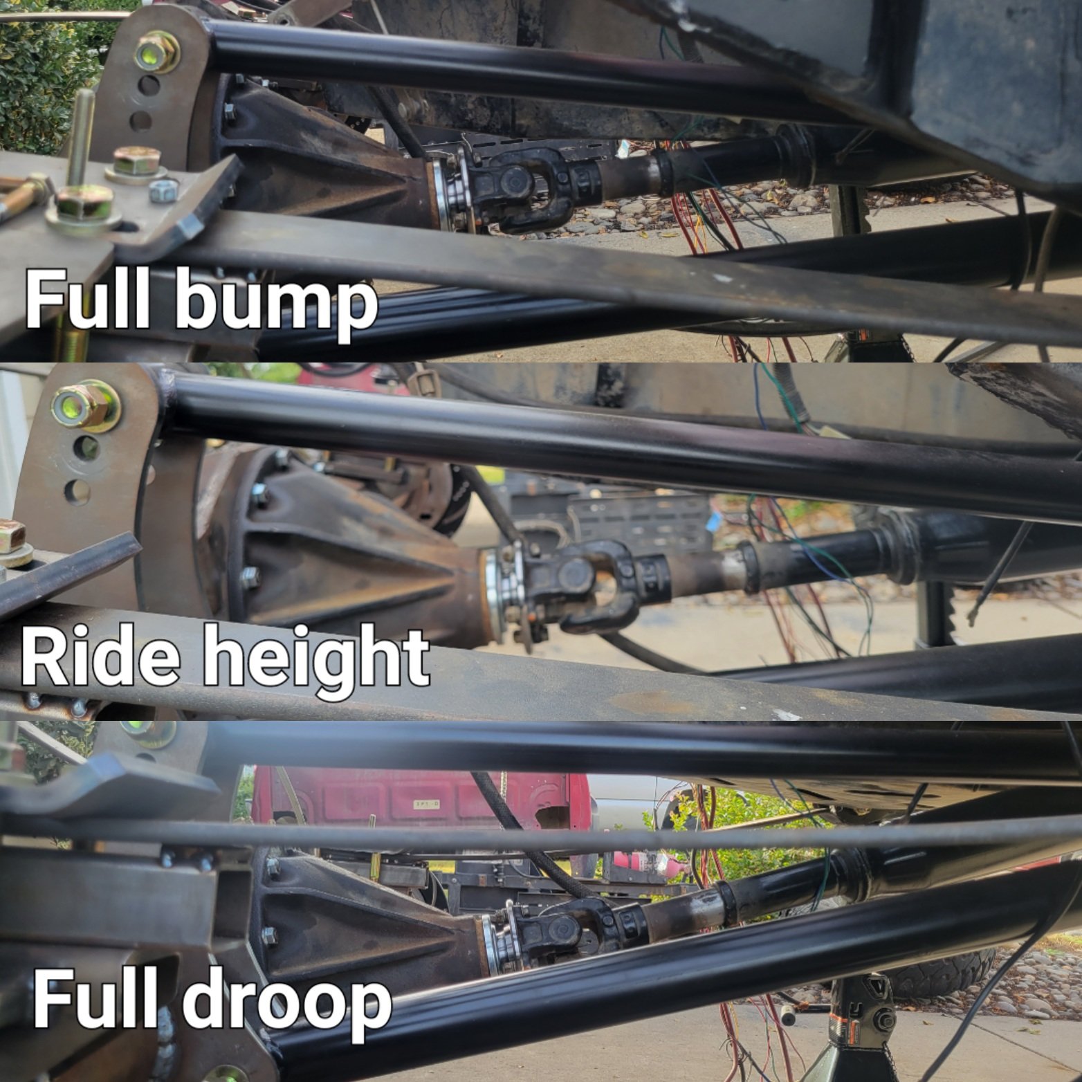

    have any pics of where its getting to at Bump?
    I was clicking thru pages, but too much mall talk :rofl:

    I have this one. I was mainly looking at pinion angle. Didn't take any pics from the back at full bump. I can try to get one tonight. But, I'm hoping to get my shocks spotted and tacked before it starts raining on me.

    yeah or from further away, your build has turned me on to the 63's since I don't want to go SUA, and 3/4link is a much bigger project than I have time for right now, but all the references I've seen don't have much bump and all kinds of "don't let the arch go negative" talk

    LOL... If you don't let the arch go negative, you wont have any up travel on 63s. Mine go about 2.5 inch negative.
    Jury is still out, for me, on the 63s. I'm hoping I didn't make a mistake by going away from the Alcans. Worst case is I'll get by with the set I have for a season, and then have Alcan build me a set of custom 63s next winter.
    I wasn't about to give away the clearance with SUA, and 3/4 link is a bigger project than I wanted as well. Also, in CA, I'd be pretty much limited to 3 link because you can't (legally) relocate the fuel tank. It wouldn't pass smog visual inspection.
