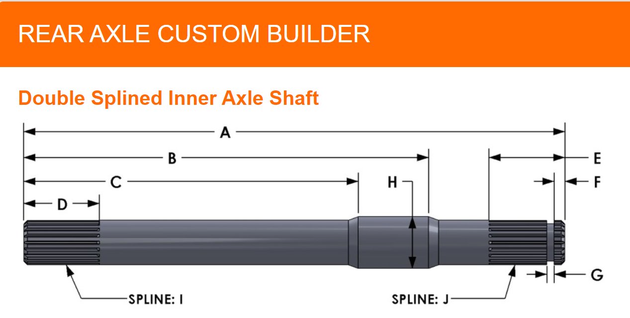

    Ya, I need the actual thickness of the c-clip because I have to put that in to the build sheet for RCV. I was hoping RCV would be able to fill that in for me (they should be able to look that spec up) But that was one of the things I asked when they told me to just order the axle shafts through Front Range.
    I'm trying to see if anyone, even on Pirate, or others, have said what the dimension of that clip is.
  8. Nov 29, 2023 at 10:34 AM
    #1788
    El Taco Diablo
    El Taco Diablo [OP] Professional Pinstriper
    Nov 6, 2017
    #235223
    13,979
    Matt - KN6DZP
    Hughson, CA
    Impulse Red DC, 5vz-fe, 4wd swap, LT, dual case, F/R locked
    Just 3 tons of fun!!!
    These are the dimensions I need
    I have everything except for "G"
    But if I don't have "G" I also don't have "A" or "F" or "E"
  9. Nov 29, 2023 at 10:34 AM

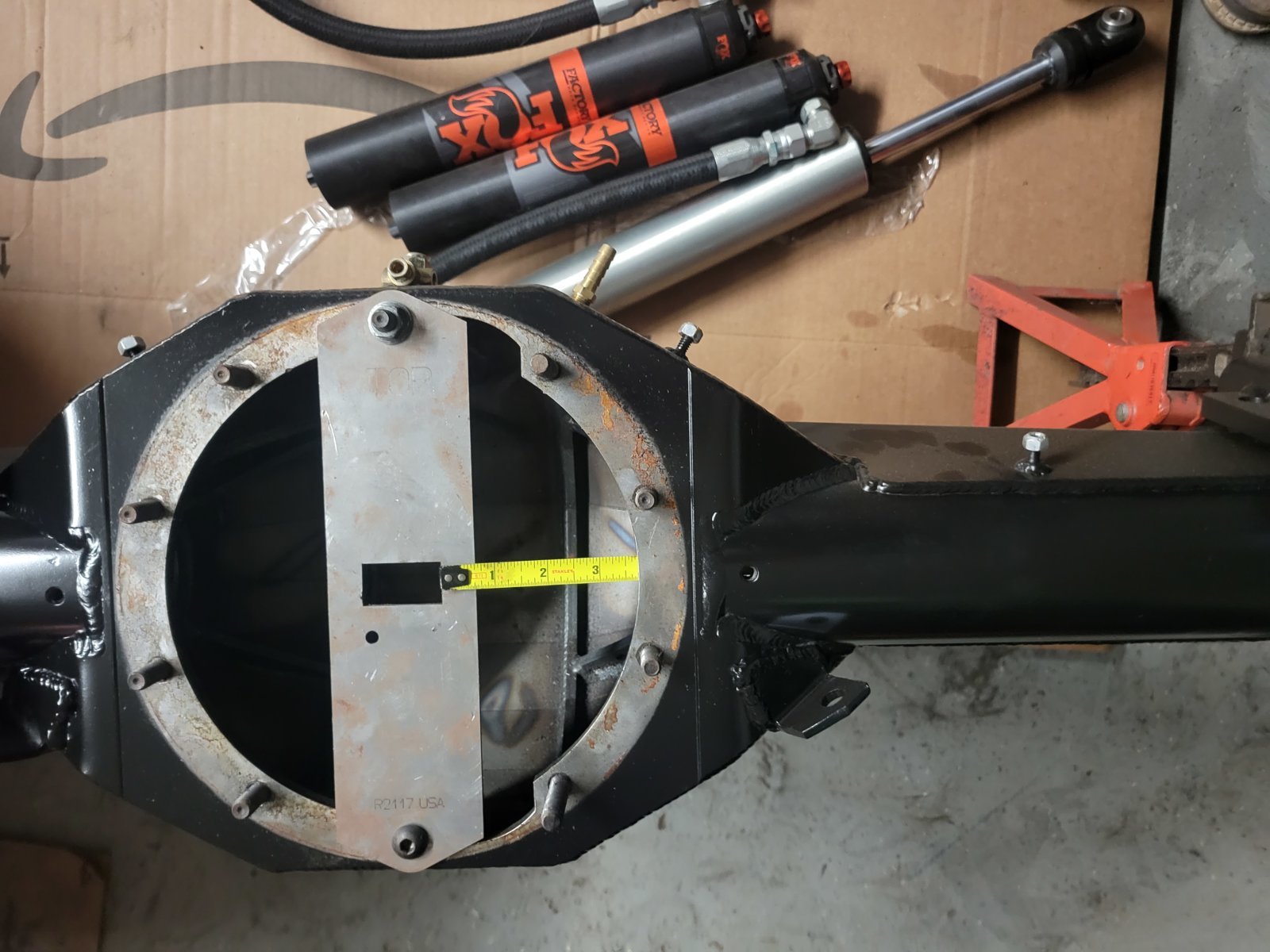

    Let's maybe check my work here.
    I'm measuring with Ruff Stuff's axle guage for a 9.5 housing/3rd member.
    My overall measure to the outside face of the drive flange body is 34 1/8 (34.125)
    Here is the RCV diagram.
    If I add 1/8 (.125) plus and 1/4 (.250) to the outside of the clip groove it makes my overall length 35
    A) 35
    B) 6
    C) 4.5
    D) 1.125 this makes the splines approx 1/8 (.125) longer than the splines in the 3rd member.
    E) 1.375 (1 3/8) body of the drive flange is 7/8 (.875) + .20 for clip groove + 3/16 (.188) outside of clip groove (+ an additional 1/8 on the inside of the drive flange)
    F) 1/4 (.25)
    G) .20
    H) 1.31 standard Toyota 30 spline seal surface
    I) 30 spline
    J) 30 spline

    I mathed wrong on E)
    .875 - 7/8 body of drive flange
    .20 - 1/8+ clip grove
    .188 - 3/16 outside of clip groove
    .125 - excess inside drive flange body
    E) 1.313
    Also fucked up on A) Should be 34.5 not 35
