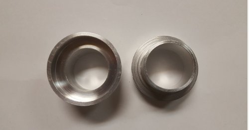

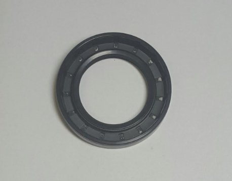

    What do you mean by spotting seal surface? Like where the axle seal rides?
    My shafts dont have that any machined surface for that, plus the diamond housings already come with a diff side internal axle seal. Does the RS housings?
    Did you buy these from FROR for the spindles?
    https://frontrangeoffroadfab.com/full-float-seal-holder/
    And these?
    https://frontrangeoffroadfab.com/full-float-inner-axle-seal/

    I dont know about the other FF guys but my shafts dont have a designated sealing surface. Just splines on each end and thats it. The rest of the shafts is already a machined surface and shafts do not taper in any area. SO you could have that seal placed as close or as far from the diff as you want.
