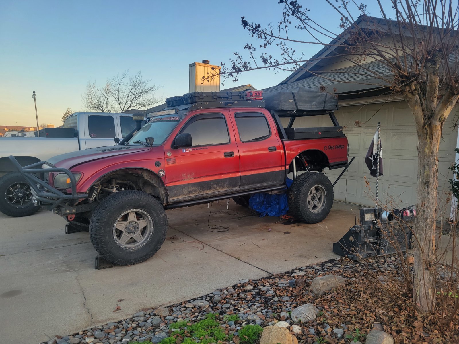

    Tent and boxes went back on. And More wiring got done.
    Aaand... I went and picked up a few things.

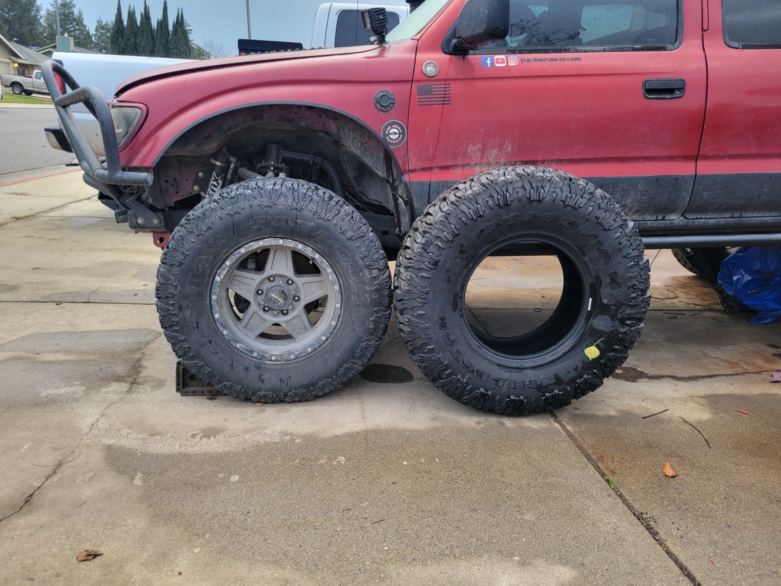

    At 33s I said "These are the biggest tires that will go on this truck."
    At 35s I said "These are the biggest tires that will go on this truck."
    At 37s... "These are the biggest tires that will go on this truck."
    ... :anonymous:

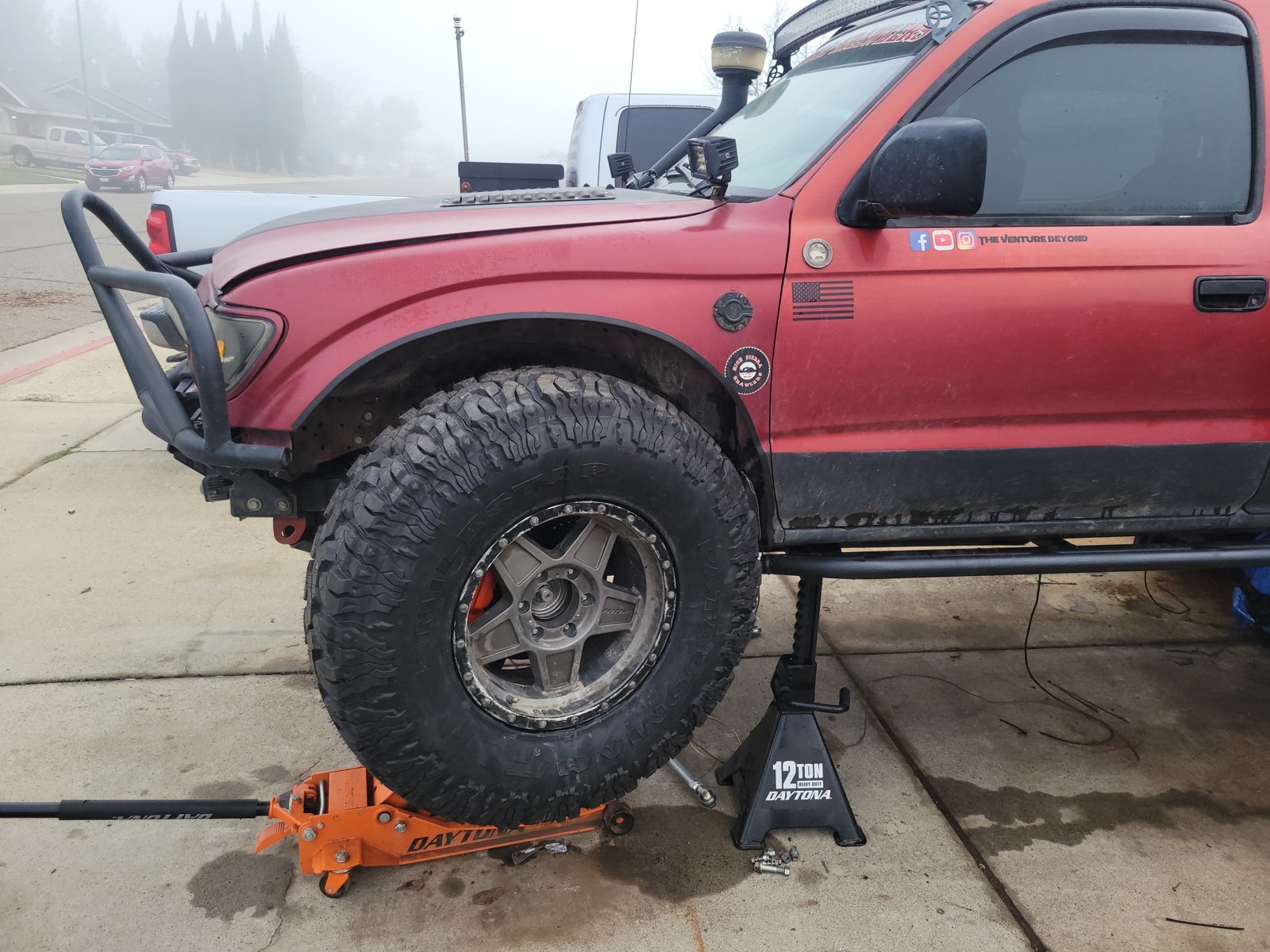

    Lexus brakes

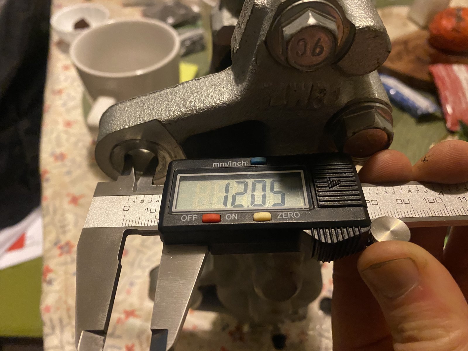

    14WB calipers?

    No, 14WA
    That way I didn't have to sleeve the mounting bolts.
    14WA take 12mm bolts. The 14WB went to 14mm mounting bolts.

    I have the WB and they use he stock bolt hole size if you order new oem (got them at my local brick and mortar ordered through their online site) - I was confused at first but Toyota updated the part number so that all new oem calipers are stamped WB with an M12 (?) hole. At some point I’ll take a pic since one of the calipers is sitting in my daily (lol) but don’t have a caliper bolt on me.
    Edit: here it is

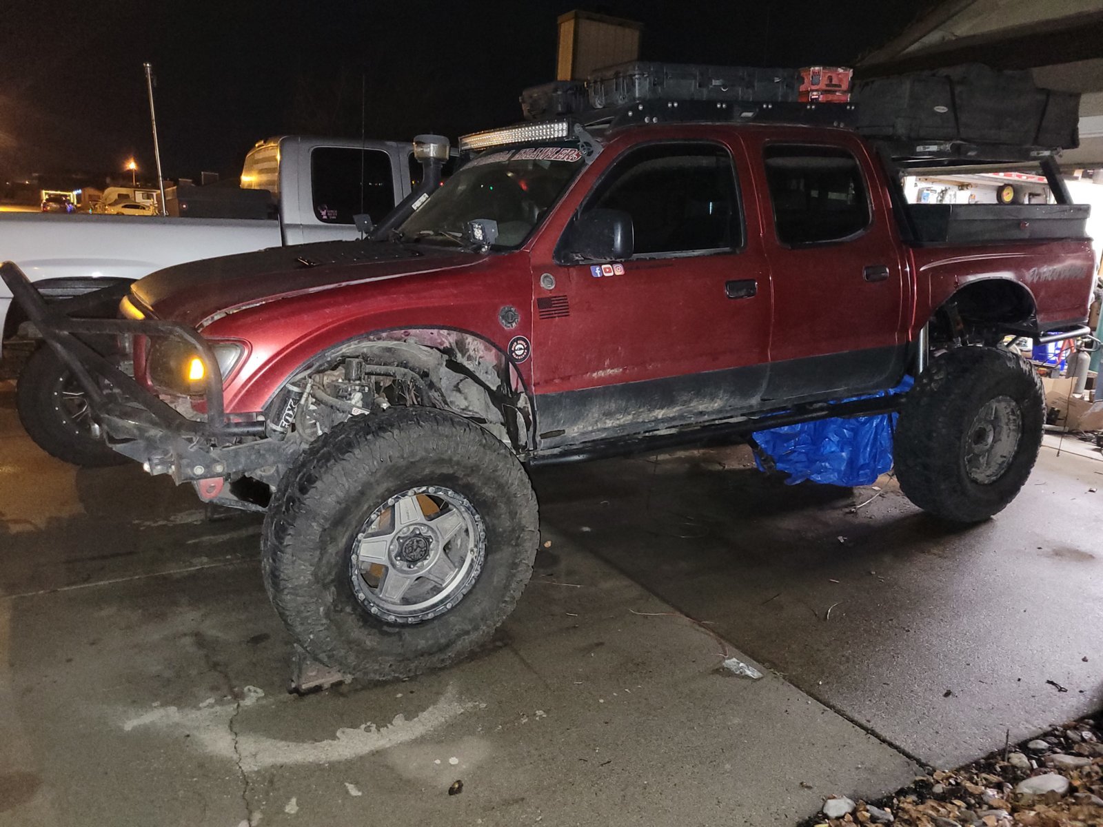

    I can smell this picture - not that bad for 37’s. I wonder if solo would do a trade in program with their new lowers that push the tire forward an inch. You’d run into a clearance issue in front maybe but would easily clear any 37 (if there are any taller ones than what you’re running now). Looking forward to feedback on how the front axles / diff do. Most guys on IG etc with 37’s on a 1st Gen are rwd with beefier hubs or not really wheeling that hard.

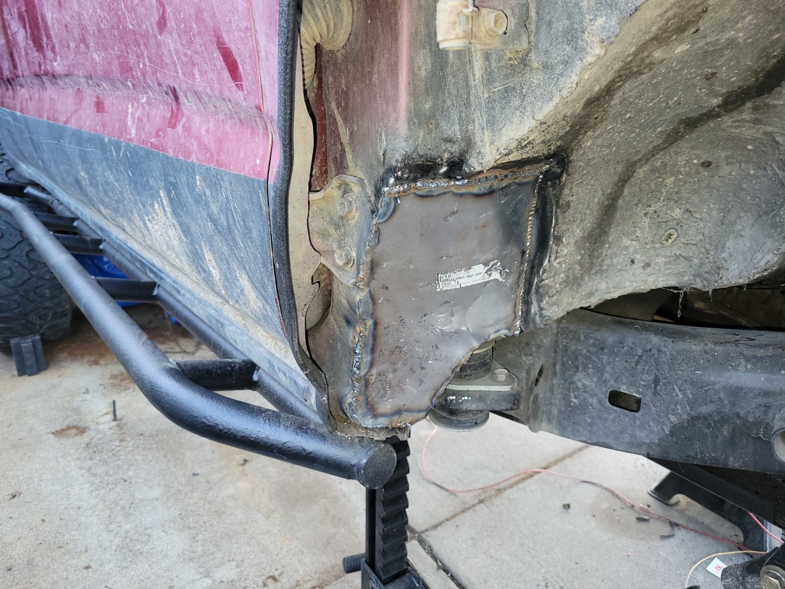

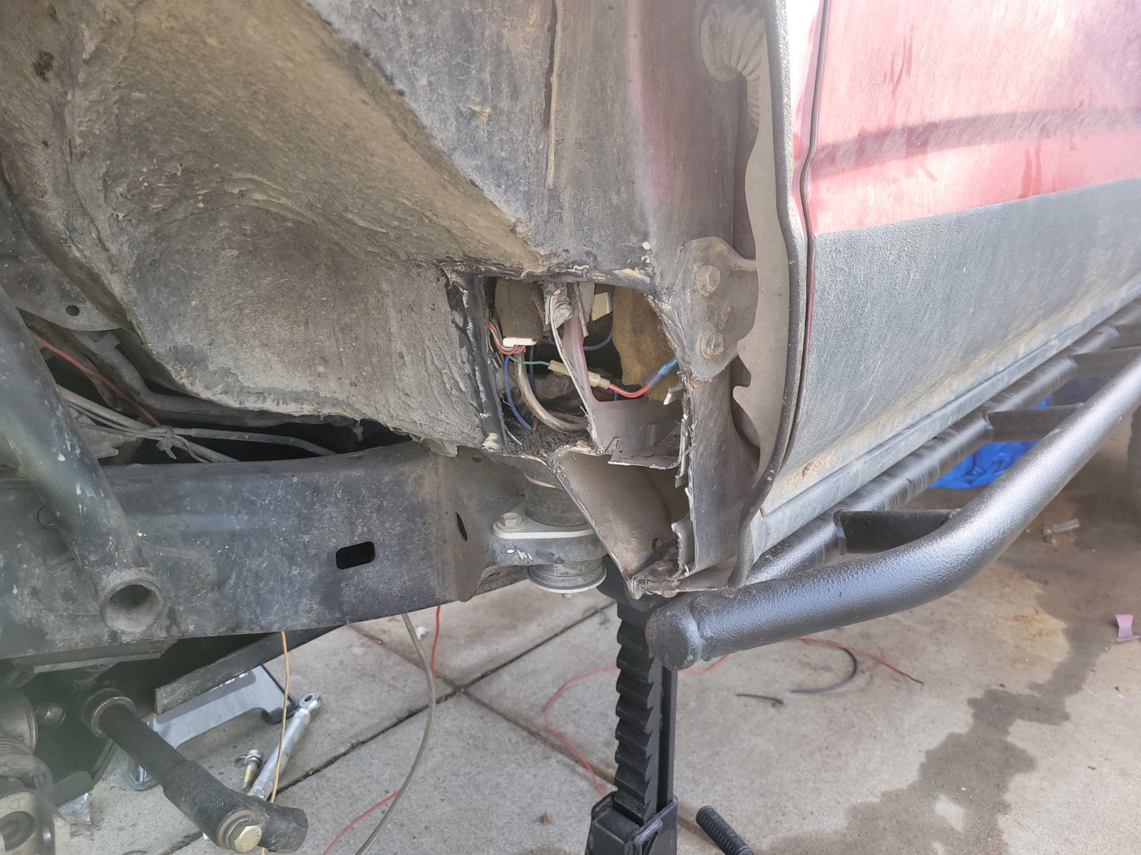

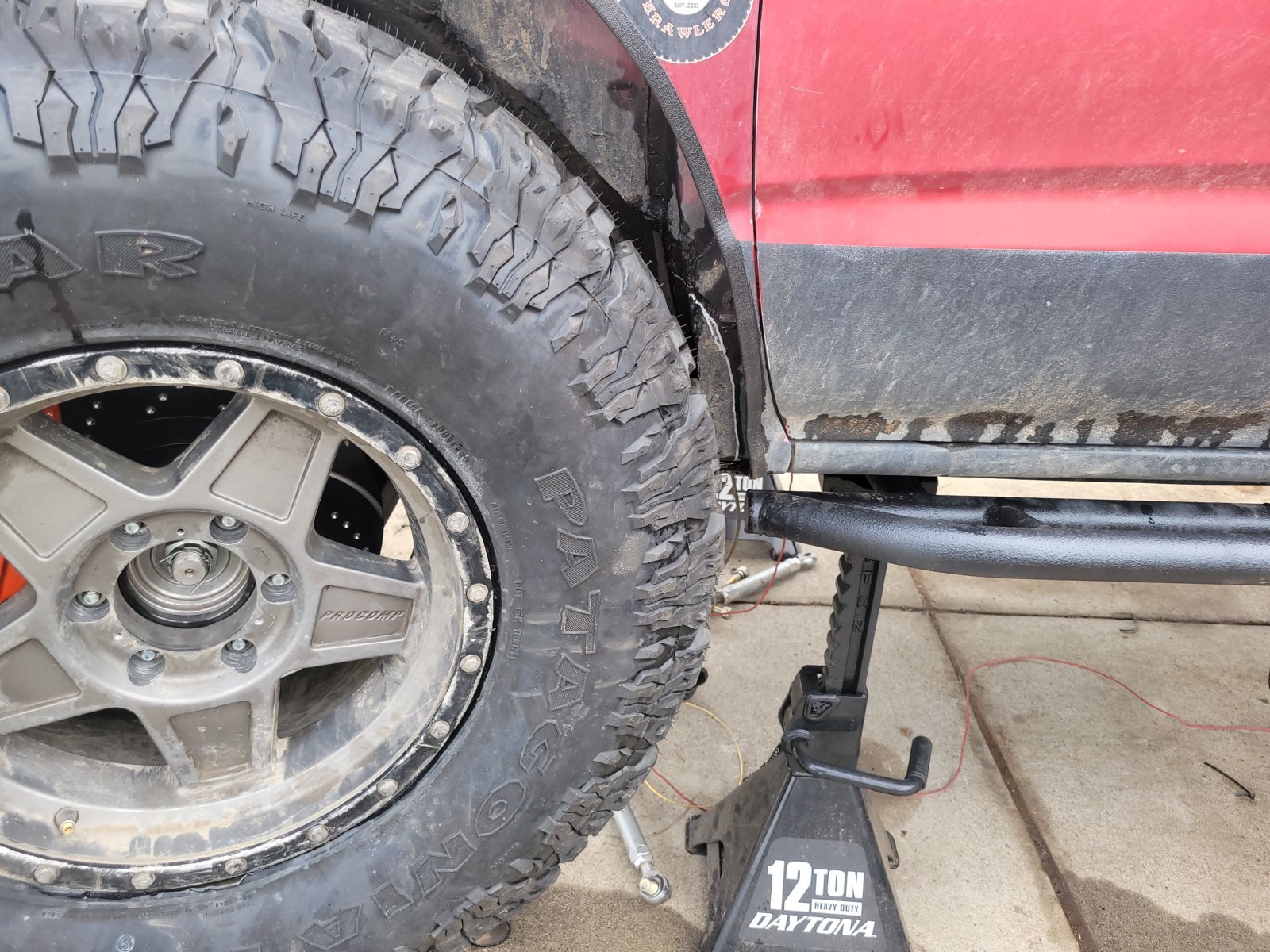

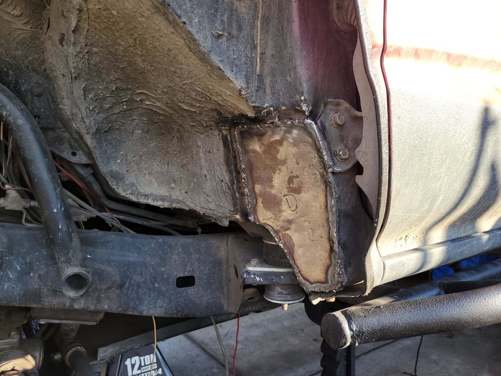

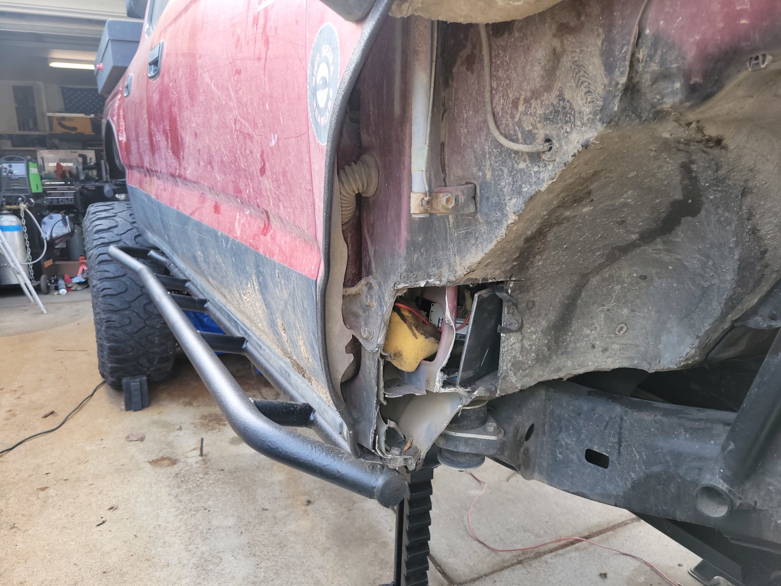

    The amount of cutting I did today was on top of the cuts I made last year.
    It takes A LOT of cutting to fit 37s.
