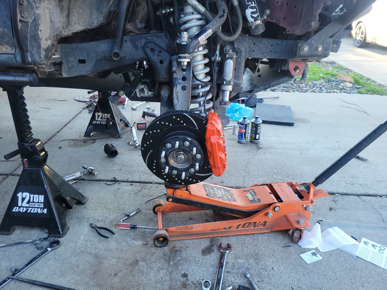

    Looks a lot better than mine if it makes you feel better haha. And +1 on all that cutting…
    I would be interested if you can get a dropped and compressed measurement from hub to body line or something similar that could be compared. I would be interested to know if RCVs allow the same droop as modified tundra axles you are using or no.
    You could also probably gain some uptravel depending when your coilover bottoms out but it puts the skid in the ground a lot and takes a lot of clearance.
    cbechtold likes this.

    There is a little bit of up travel left if I took off the rubber emergency bumps on the coilovers. My hydro bumps are set at full squish at the rubber bumps. But, with the 37s, I'd have to clearance above the tire if I go up any more. That's something I'll eventually do, but right now it's a battle for another day... I need to get this shit together before Hammers lol
    Right now, I'm just running Vatozone "extended travel" CVs. I'm pretty sure the RCVs give better droop than modified Tundra, which should definately give better droop than these.
    The plan has always been to upgrade to the fully fabricated spindles and RCV CVs because I want the Dana 44 manual hubs so I can throw these f'n unit bearings in the garbage where they belong. (That's why I just went with Vatozone CVs)

    I called Solo when they came out with the new Lower Arms. They aren't offering any kind of trade in. It's 1400 bucks if you want the new arms... and then you end up with a set of boat anchors taking up room in your garage, because no one is going to buy just a set of LT arms.
    (I did not talk to Bobby)

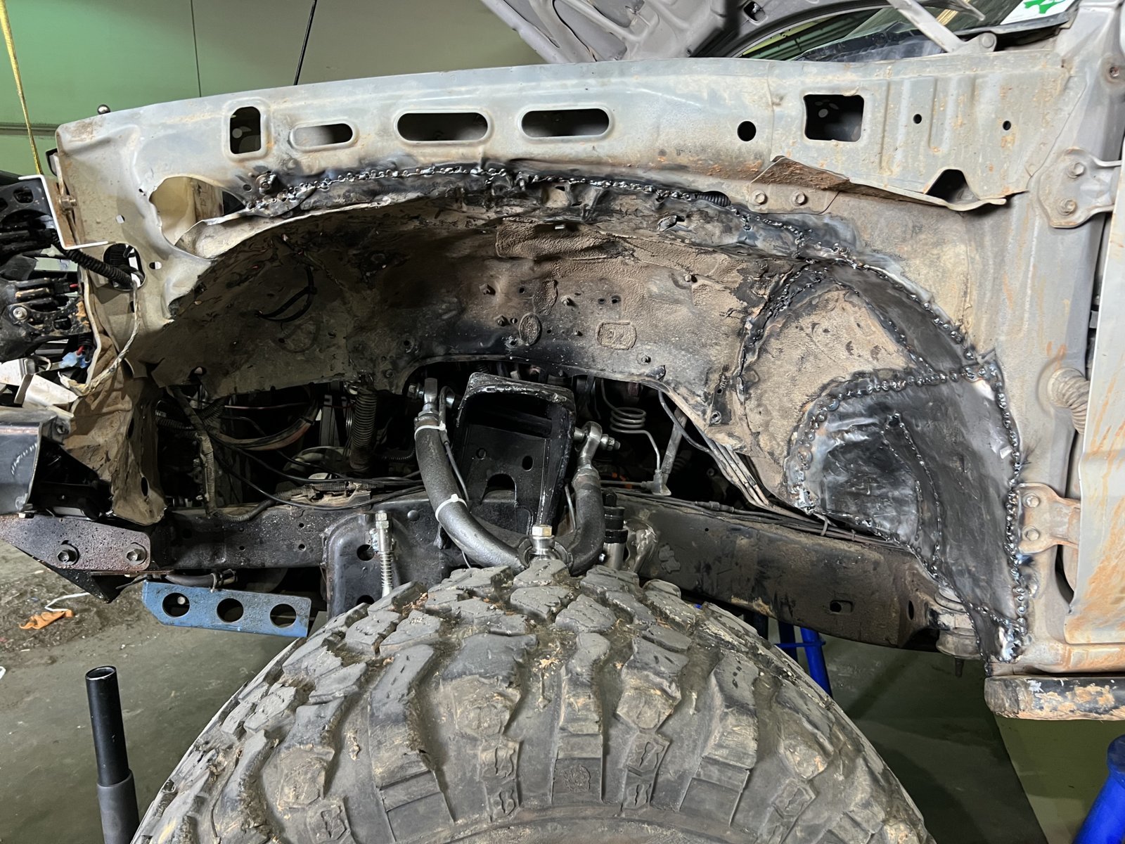

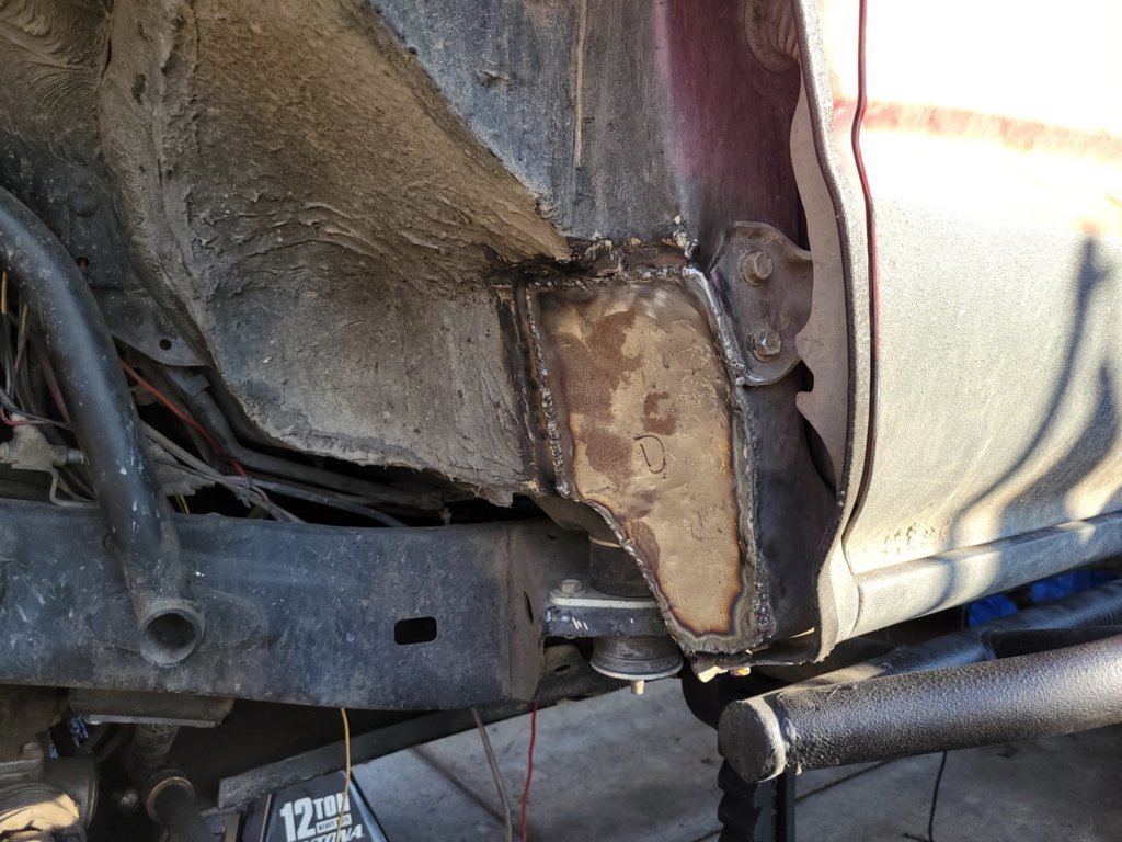

    FYI...
    I did clearance above the tire, but it was by wailing on it with a hammer. If I want additional clearance with the 37s, it will probably need to involve more cutting.

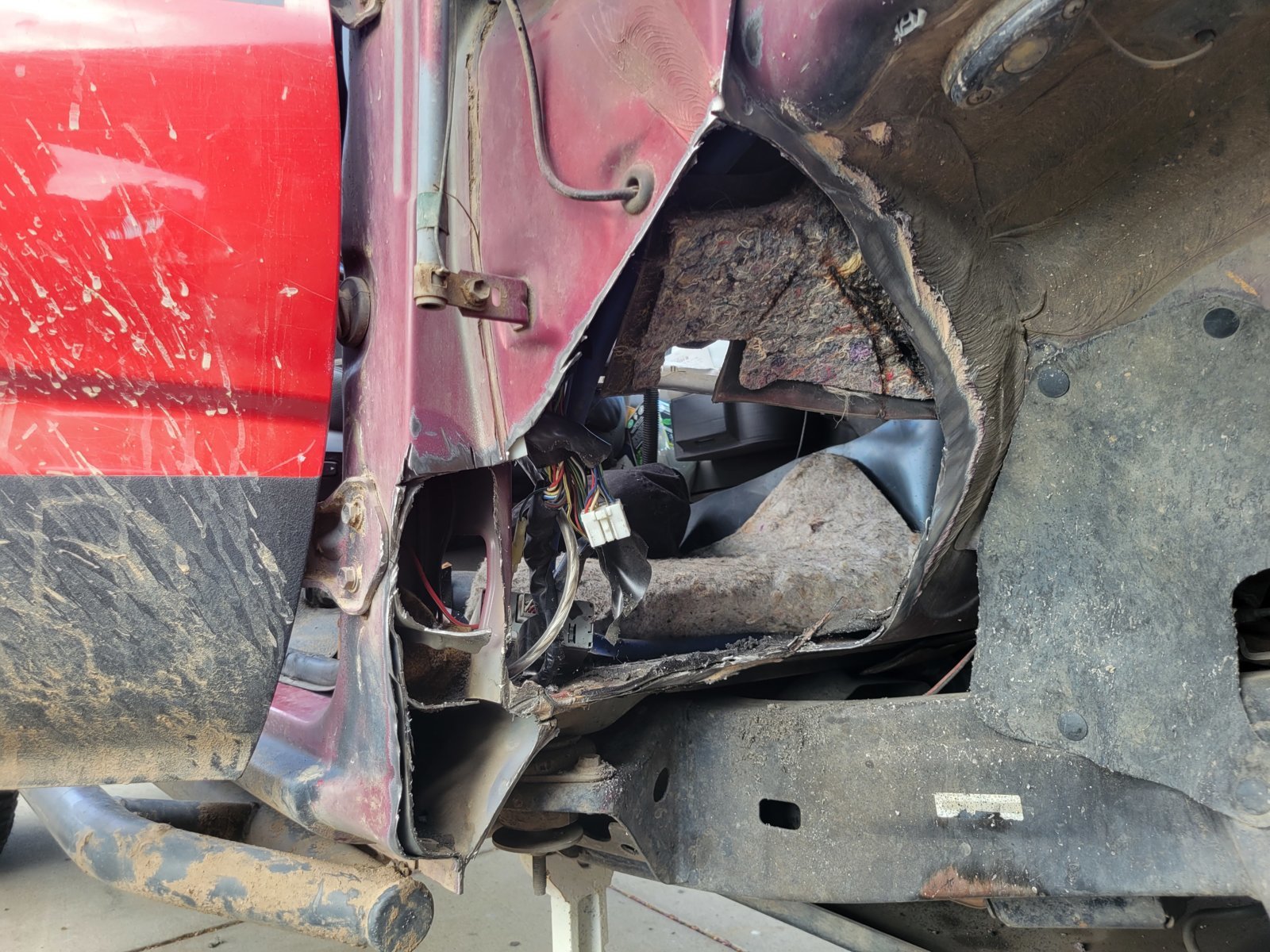

    Heads up when you do cut and set bumps all that body compresses down a ton a lot in my case. I pushed it all up a couple inches and can clear my 37s on jack stands with room to spare. It still will rub 35s when I jump it because everything flexes so much.
    Everything in front of my firewall is cracked and it has worn body mount bushings though so I’m sure that doesn’t help.

    I think that may be one thing that's helping me with clearance. My body mount bushings aren't worn and they are 1 inch taller than stock.

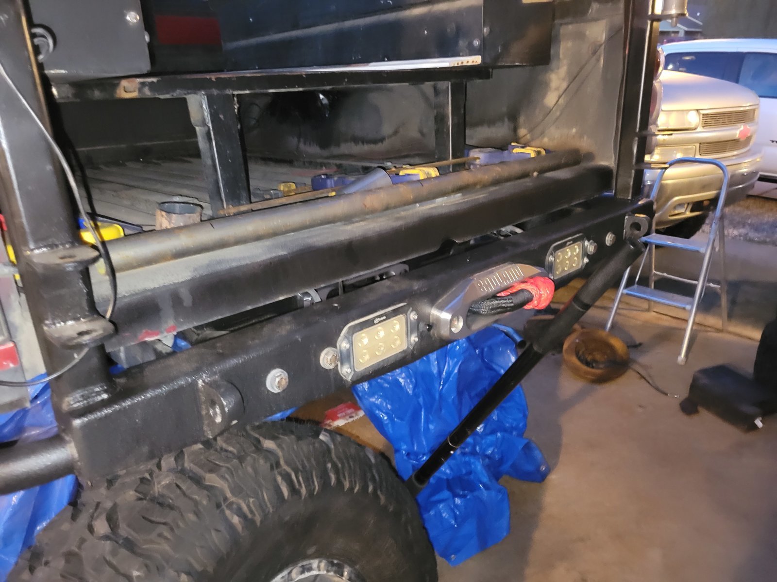

    Had to order more wire to finish the win h wiring. But, I wanted to see if it worked and would spool right. So, I jumped it with battery cables lol.
    Winch is spooled.
