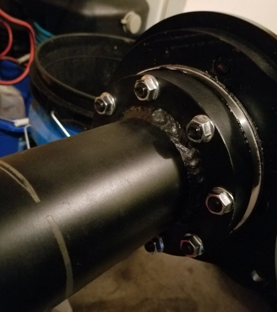

    Haven't seen or heard anyone breaking the 8.8 on the drotor.
  4. Jan 6, 2024 at 11:46 AM
    #1904
    El Taco Diablo
    El Taco Diablo [OP] Professional Pinstriper
    Nov 6, 2017
    #235223
    13,979
    Matt - KN6DZP
    Hughson, CA
    Impulse Red DC, 5vz-fe, 4wd swap, LT, dual case, F/R locked
    Just 3 tons of fun!!!
    LOL... you have now.
    Put 50 pounds of torque on one of them and it twisted in half.
    Max torque for a 8.8 M10 should be 57.3 pounds.
    If one of them twisted like that. They are all stretched to the point I don't trust them.

    Didn't like the bolts that came with it. Went with 12.9 Allen head socket caps with matching flange nuts on the opposite side. Way over kill but piece of mind.

    Did you seal the Drotor to the flange?

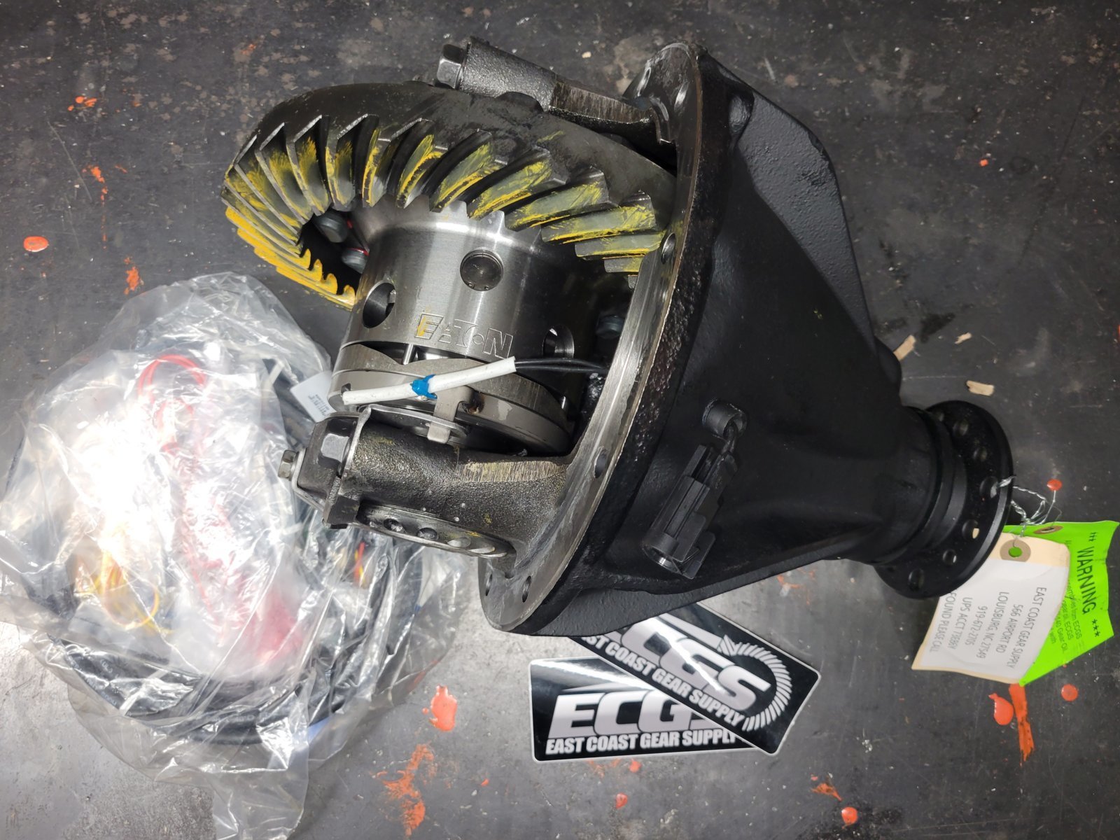

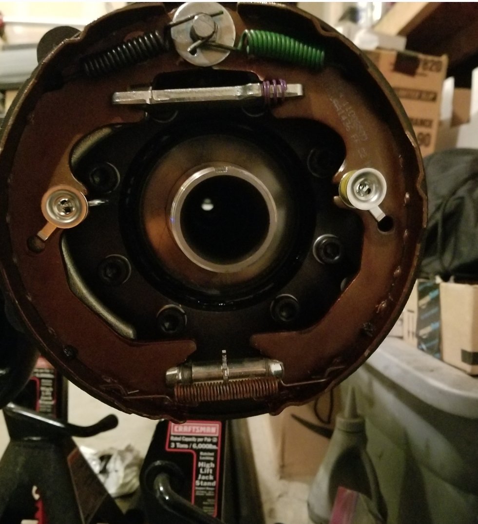

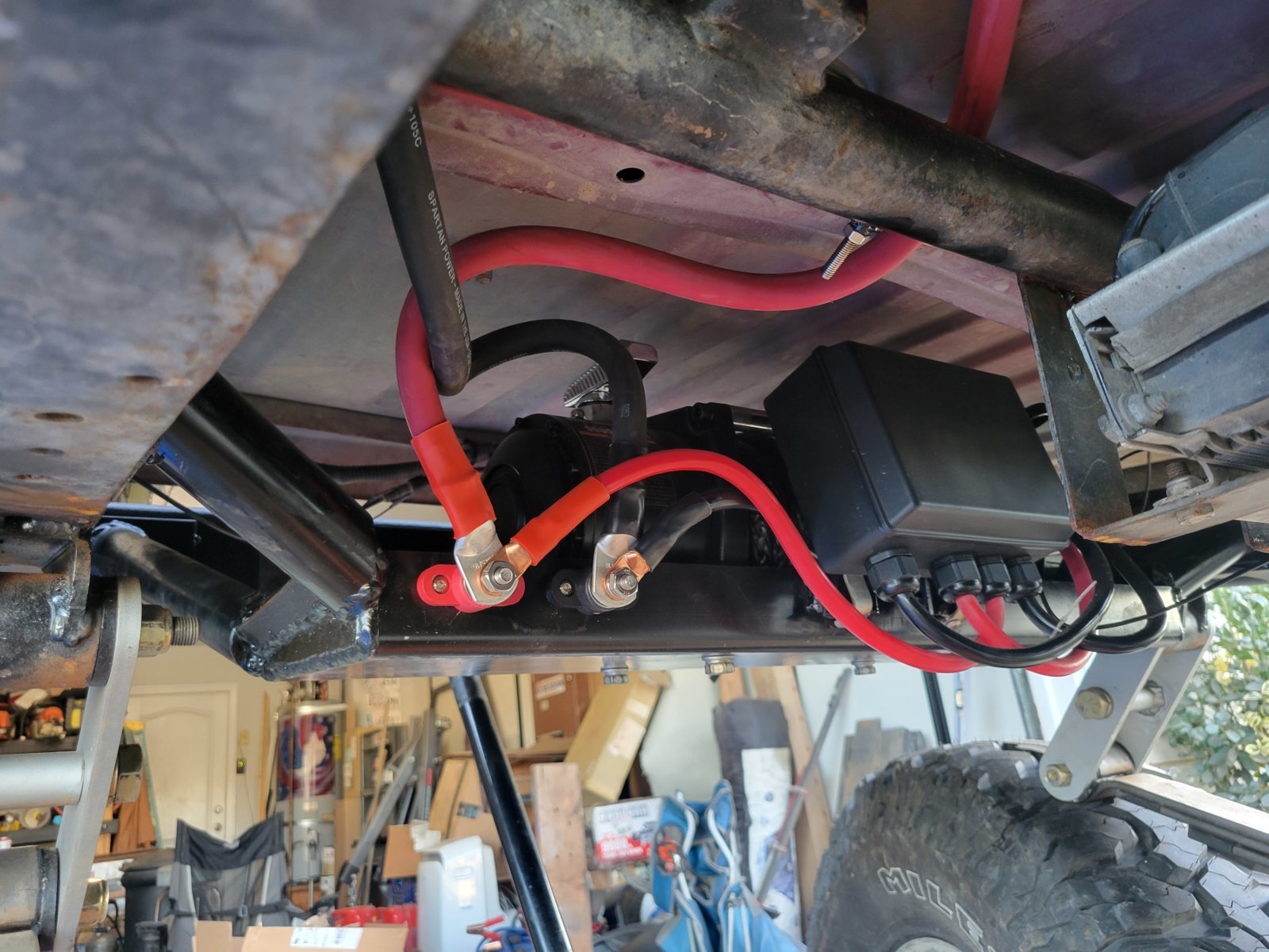

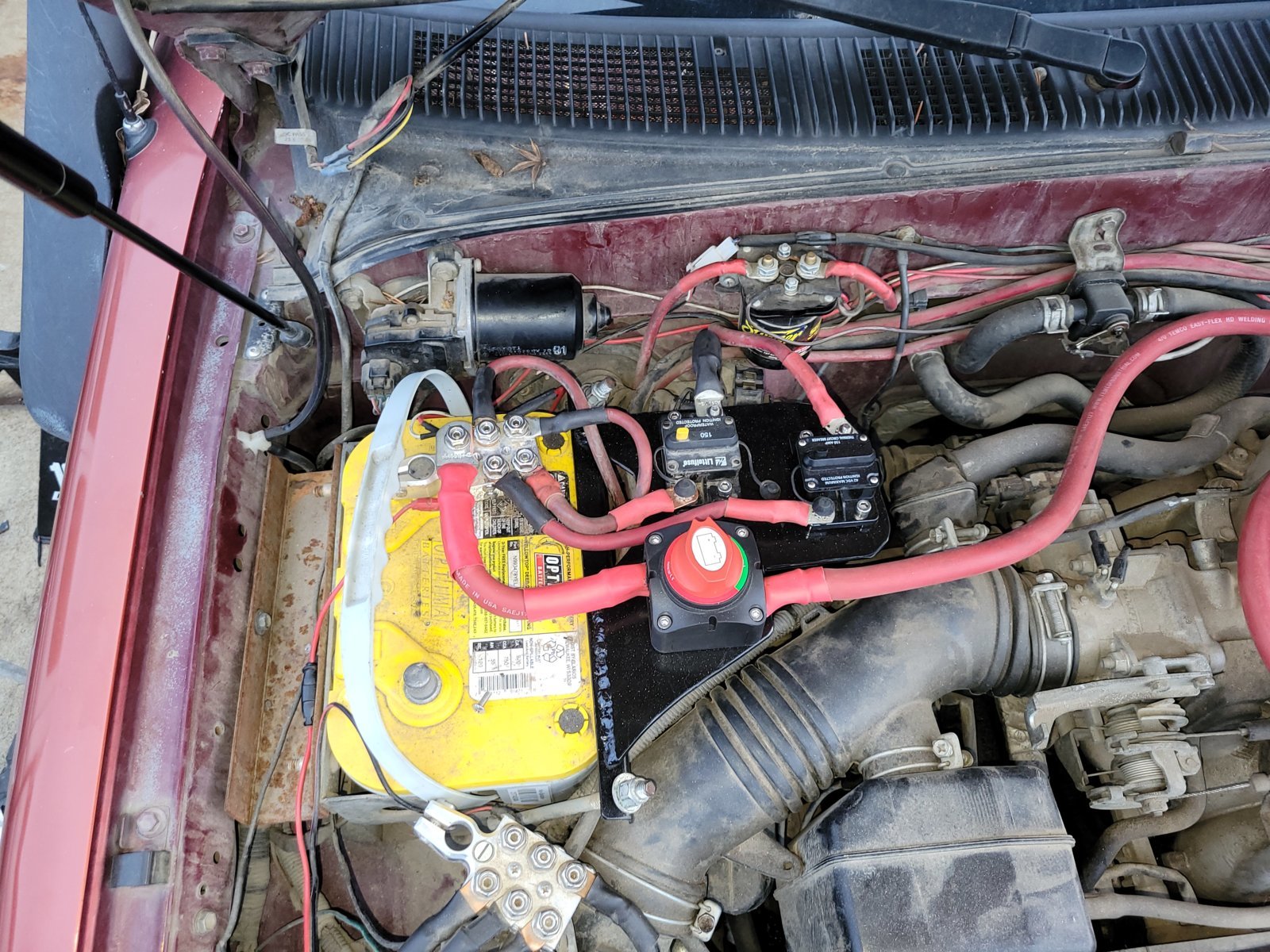

    Big thanks to @Blue Canary and @essjay
    We got a lot of stuff done today. Here's where the list is now. (FedEx failed us, the 3rd member didn't arrive, but lots of other stuff got completed)
    Need to
    - Install 3rd member
    - Install axles
    - I think I'm going to pull the 5th leaf out of the pack
    which means I have to figure out how to press the
    bracket out of the 5th leaf and put it in the 4th leaf
    DONE (we just pulled he 4th leaf)
    - Properly pack and set preload on rear hubs DONE
    - Install Emergency brake shoes DONE
    - Install rear brake calipers DONE
    - Bleed entire brake system (Will need to bleed again)
    - Figure out how to run Emergency brake line to the brakes (Ran the cables from the rear brakes up towards the front, will need to order a splitter and figure out how to finish them)
    - Make mounting plate for winch disconnect,
    and 2 unrelated breakers, at the Aux battery
    DONE
    - Wire rear winch DONE
    - Spool rear winch DONE
    - Install new Catalytic converter
    - Re-route exhaust around traction bar front mount
    - Undercoat front wheel wells DONE
    - Bleed coilovers (oil) DONE
    - Re-install coilovers DONE
    - Replace back lower control arm nuts/bolts (too long, ripping rack bellows) DONE
    - Replace rack bellows
    - At this point, pour stop leak in rack (battle for another day)
    - Would like to also re-build the tailgate/swing out/ tire carrier,
    but don't know if I'll have time.
    Also neeed to add:
    - Safety wire leaf spring bolts (drilled the heads for the safety wire and installed the bolts)
    - Adjust travel on rear bumpstops
    - Re-install and re-fill rear bumpstops
    - Re-fill front bumpstops

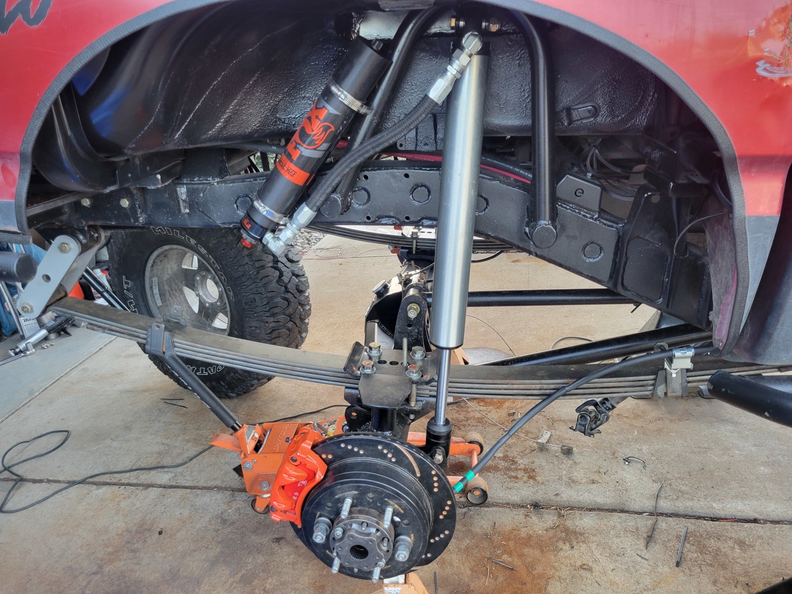

    From this weekend
