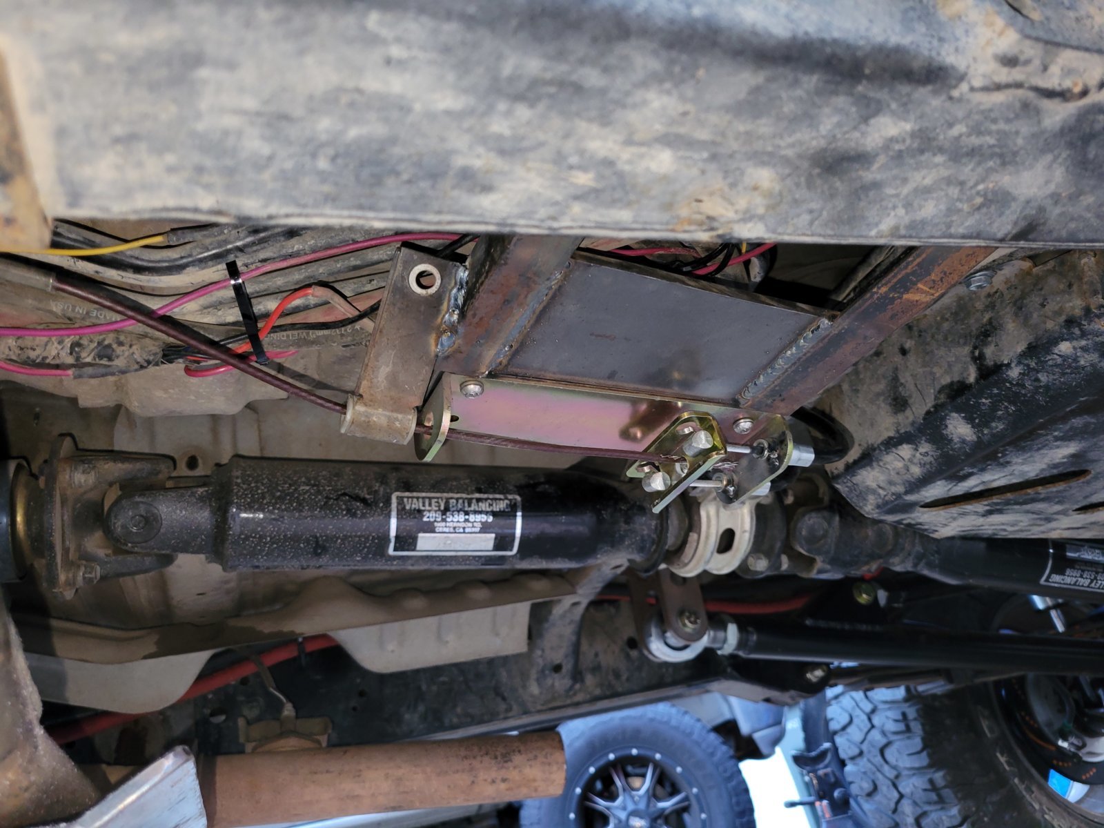

    Parking brake checked off the list.

    How well does it engage the wheels, no movement when pushing the vehicle or on an incline?

    It stops the wheels. Truck still isn't drivable, so not fully tested.
    I don't like how they return. But it's a work in progress.

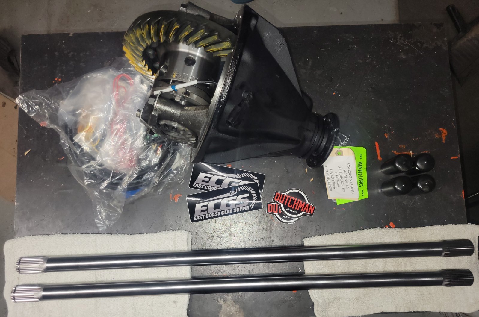

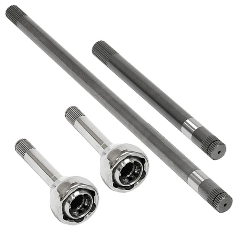

    I bet those shafts are weaker than stock Toyota shafts with the neck down Dutchman put into them. That's normal on stock style Dana shafts but not Toyota's.
    Most chromo Toyota axles have the splines cut into the same OD shaft as the OD of the splines like this picture.

    LOL... I guess we're going to find out, aren't we.

    Only one way to find out :)
