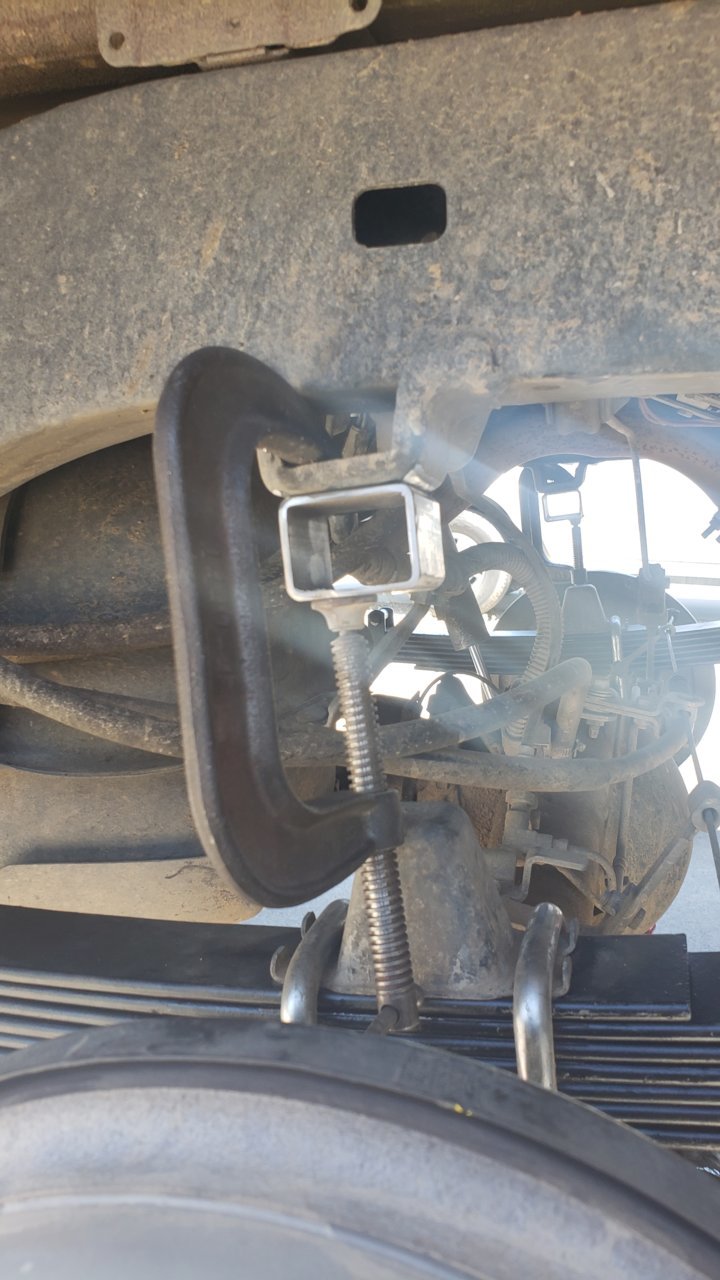

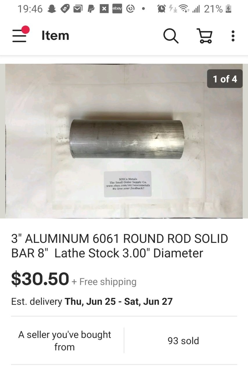

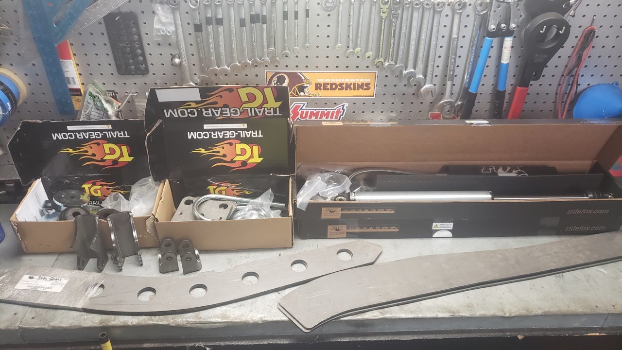

    I also ordered this... to cut to size and make custom inserts to set my bump stops where I want them... it will be here before the shocks get here.

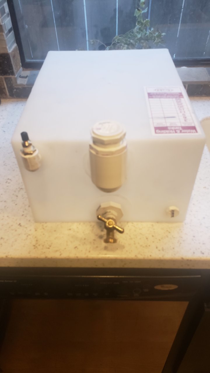

    Added a schrader valve to the water storage container. Should help having a bit of pressure behind it.

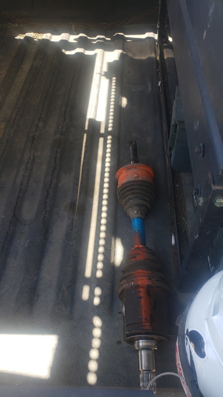

    Got a Manual hub CV today, for a spare.
    Thanks @souvang :thumbsup:

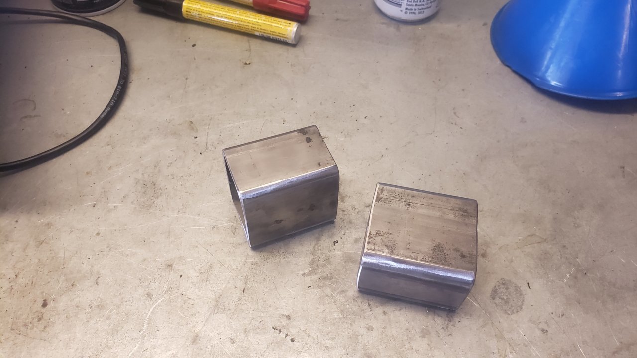

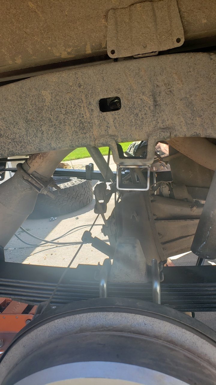

    Fabricated some temporary bump pads to close the distance, so I wouldn't be using my shocks as the bump stops.
    These will change once my new rear shocks arrive, and I do some remodeling.

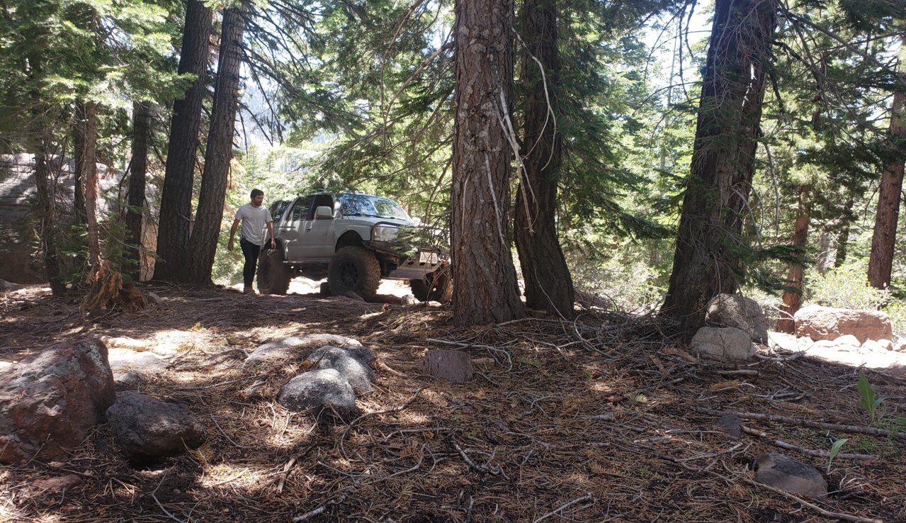

    Did a little trail run for Father's Day.

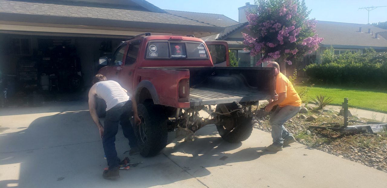

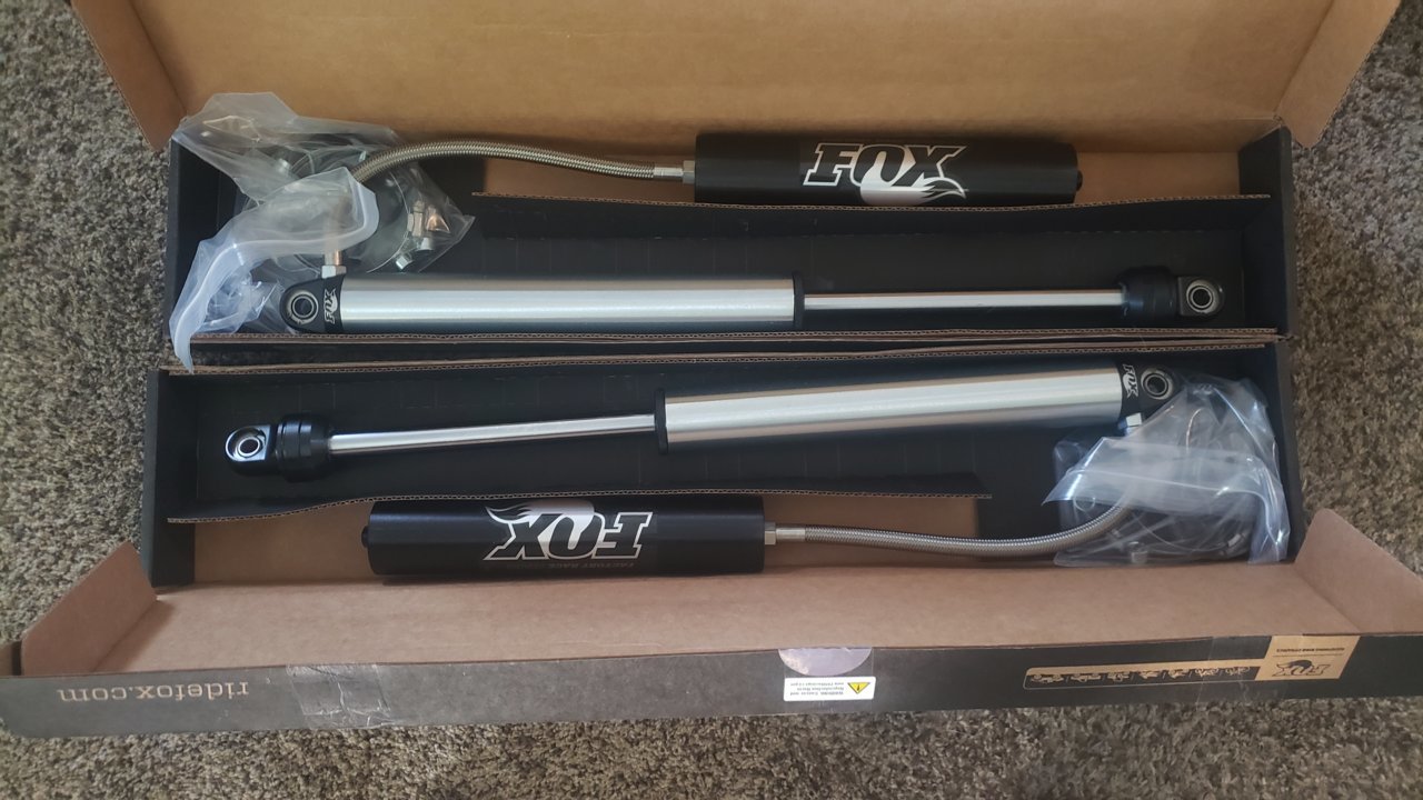

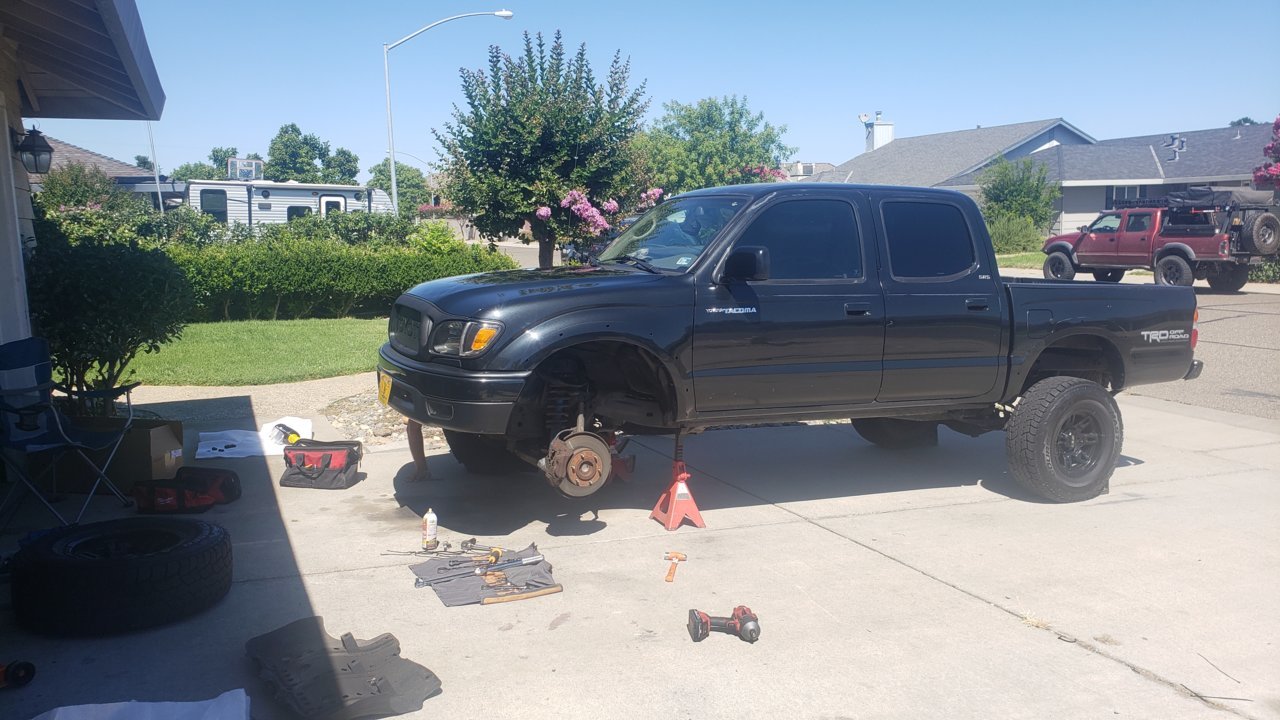

    Did a little mini mod day last weekend. Helped @Reyes87 with his lift and brakes.
    Was able to pick up my rear shocks as well.
    Still waiting for the coilovers to arrive :pout:

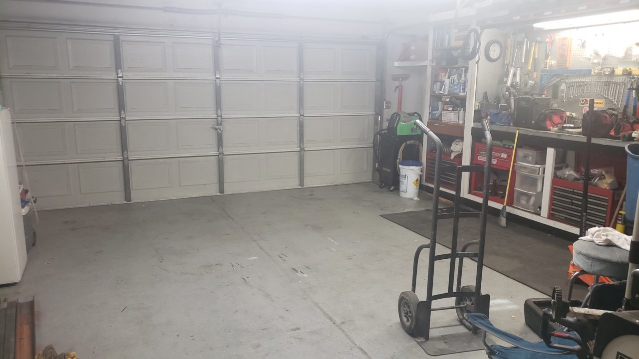

    Made some progress on the garage. Got it cleaned out... again... so maybe I can get some work done.
    Debating on whether to start the rear end project this weekend. Pretty much everything is here. Just don't know if I'd rather go to the woods lol.

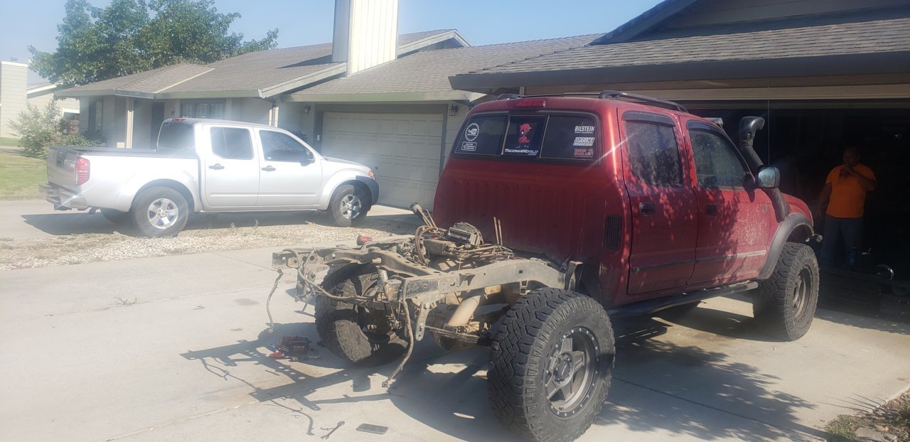

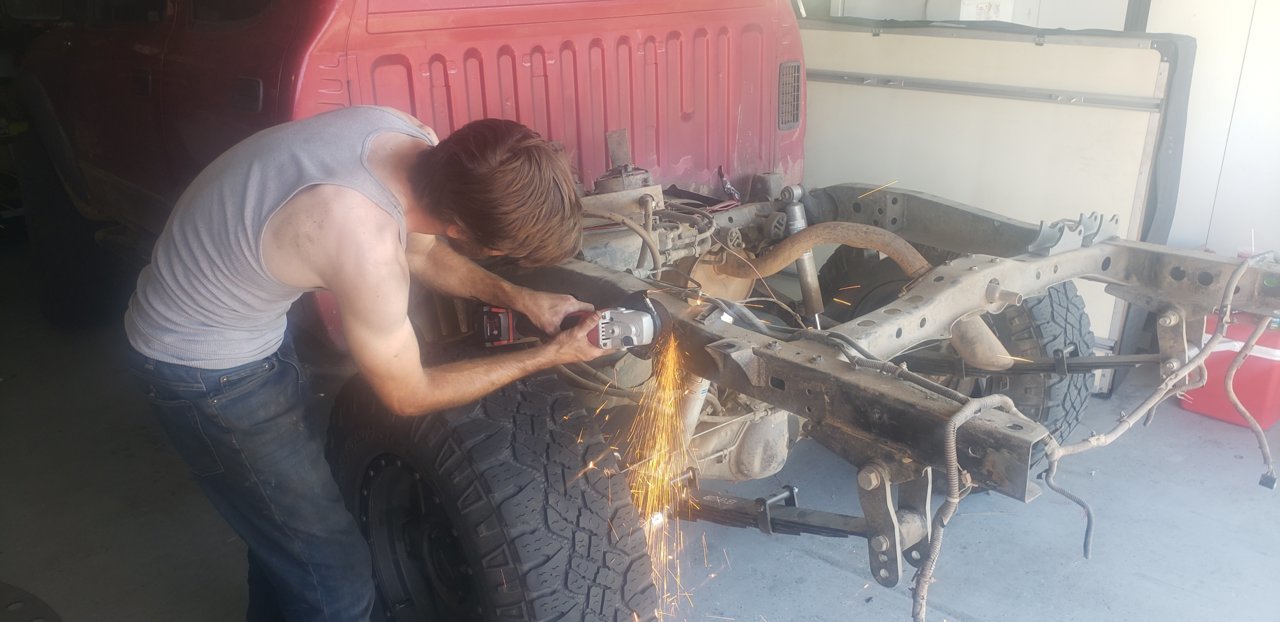

    Started the shock relocate project this weekend.
    Removed all the gear on Thursday, after work... then removed the bumper and bed yesterday.
    unstpible and rob1208 like this.

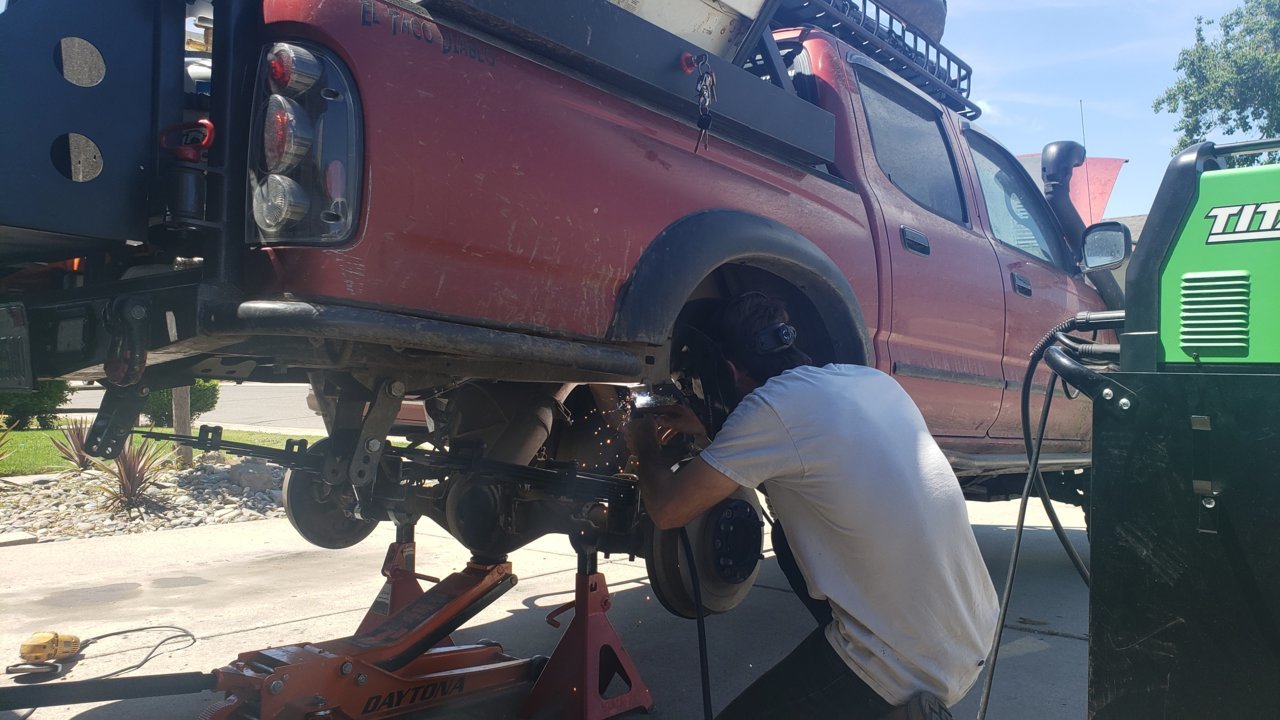

    Decided to jump right in last night.
    Got the frame cleaned up for the reinforcement plates. I also beveled the plates so we made sure to get all the penetration we could. Got the plates all tacked up.

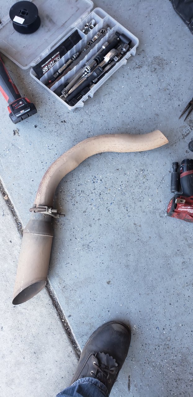

    Removed the tire carrier/cross member then tacked in the passenger box plate this morning.
    Got rid of more tile pipe. Was going to be in the way for the passenger shock.
