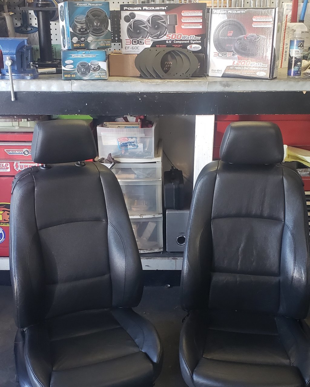

    Picked up some >FREE< seats from a BMW 128i
    Along with some more of the parts for the sound system.

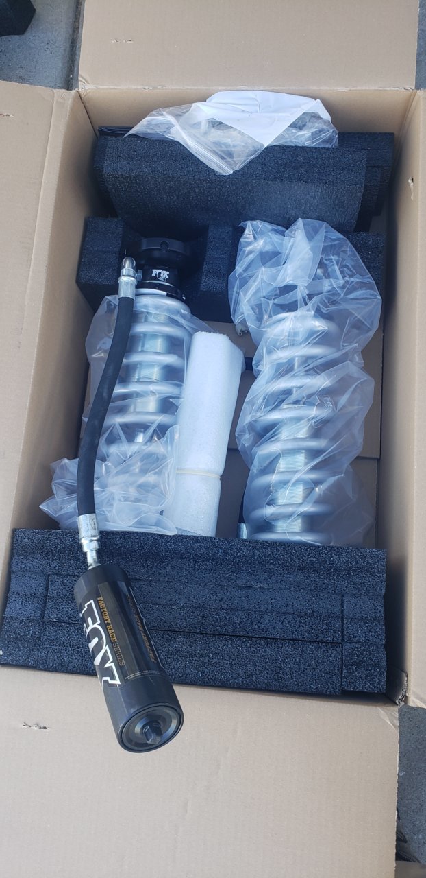

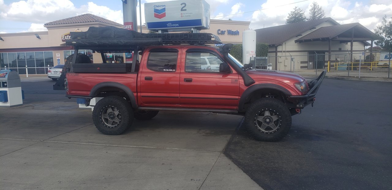

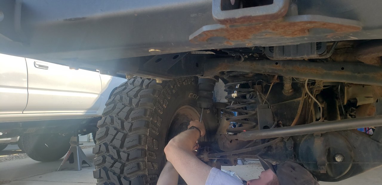

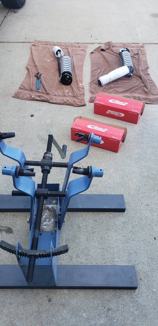

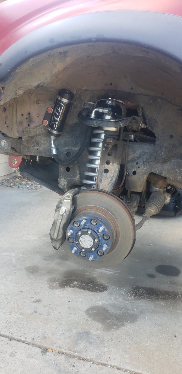

    Finally got my coilovers (after 22 weeks of waiting)
    And got them installed today. :thumbsup:

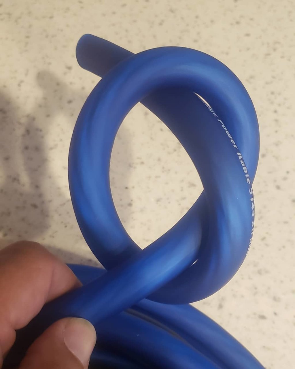

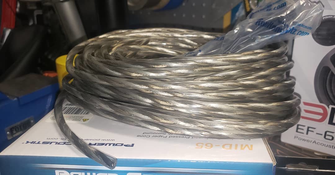

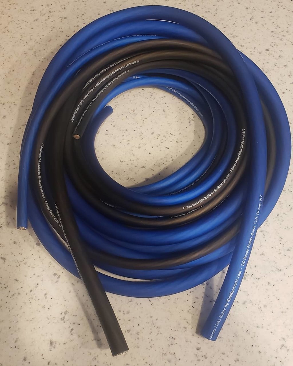

    That knupconceptz wire is great. I used it to remake my entire engine wire harness no. 2 with thicker gage.

    That stuff looks like it's some bad ass shit. I can't believe how flexible the 1 gauge is. That's what is tied in a knot.

    I went with it because it was OFC. Best electron flow or something. Its bendability was a big plus.
