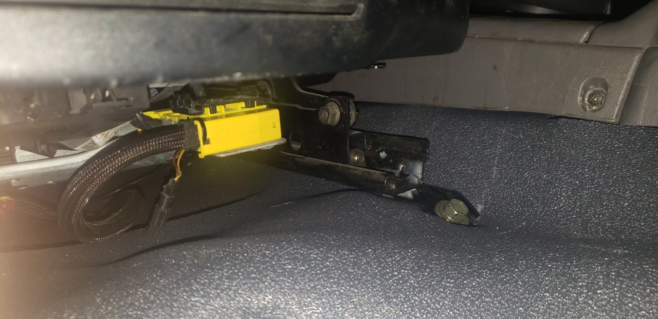

    Recieved the vinyl (to replace the carpet) yesterday.
    Will probably install after Christmas.

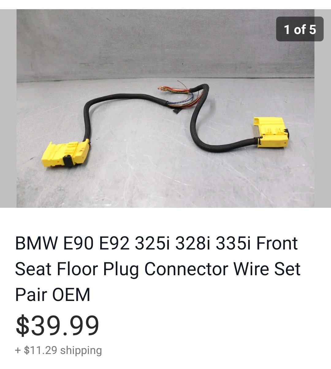

    I needed the vehicle side of the wiring harness for the BMW seats. (for power/ground) Just found a set on eBay yesterday, and ordered them.

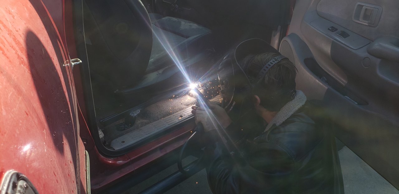

    When I install the seats, I'll need to do some tack welding to the brackets inside the truck. I don't want to burn the new vinyl, so the vinyl install with have to wait till the seat install. The harnesses are tracking to arrive after Christmas.

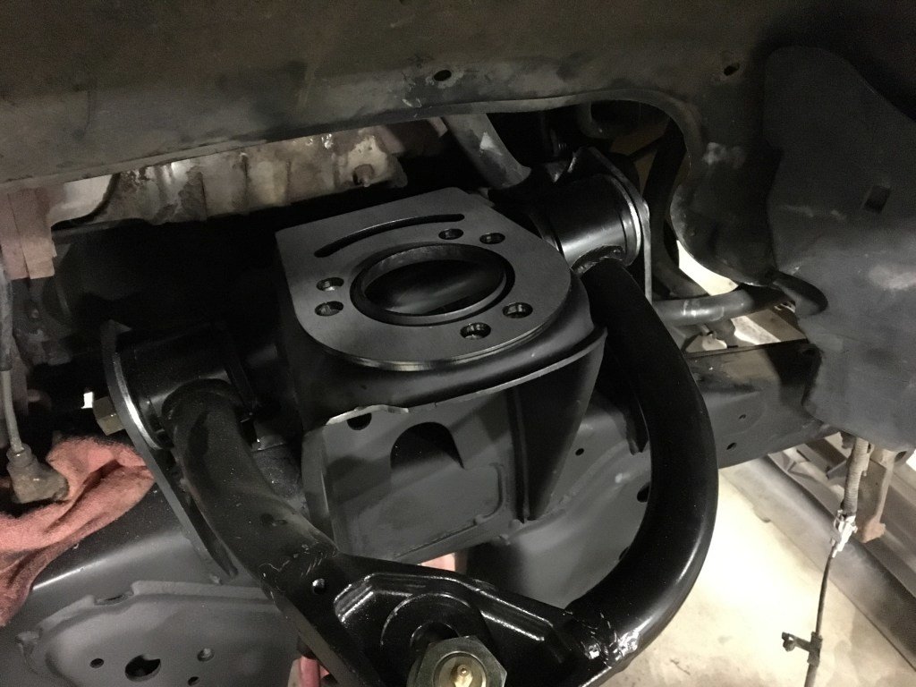

    Ordered the strut tower reinforcement plates from @eimkeith.
    https://eimkeith.com/buystuff/stk/
    Pics = From his page
    Ordered this:IMG_9328.jpg

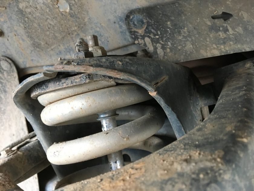

    To hopefully avoid this:
    He's also rumored to be working on reinforcements for the sides of the strut towers as well...
    :spy:
    I hope that is true, and I hope he let's me know as soon as he has something worked up. I'd even offer up my services as the guinea pig, if needed.
    :stirthepot:
    Dude is a stud btw... just ordered the plates last night and I've already recieved a shipping notification :thumbsup:

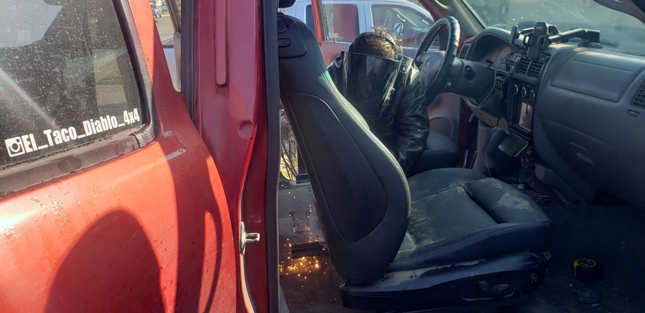

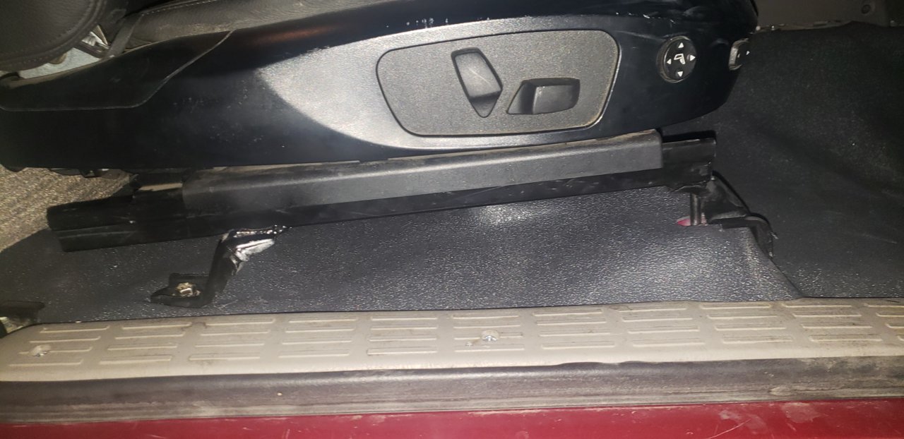

    Well... Didn't get to everything I wanted to this weekend. But, I got quite a bit done.
    Did some maintenance:
    Did a pretty thorough inspection on the rear half of the truck and re-torqued all the main stuff (leafs, Ubolts, etc)
    Checked fluid level in the tcase
    Regreased all the ujoints and both drivelines

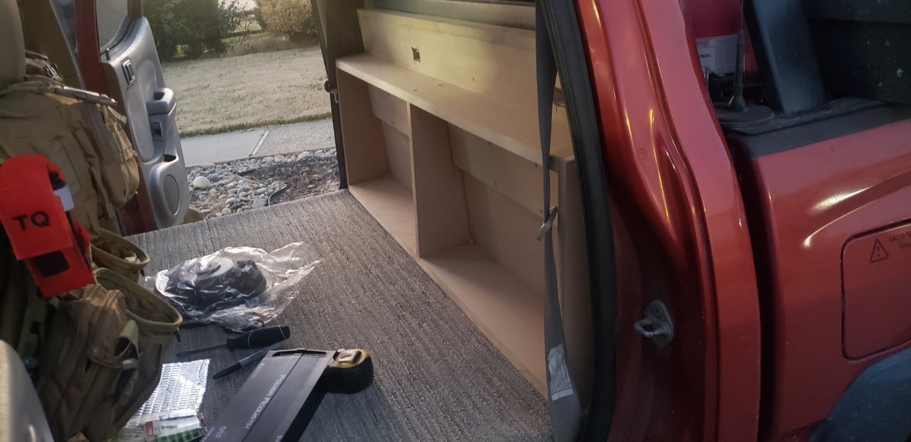

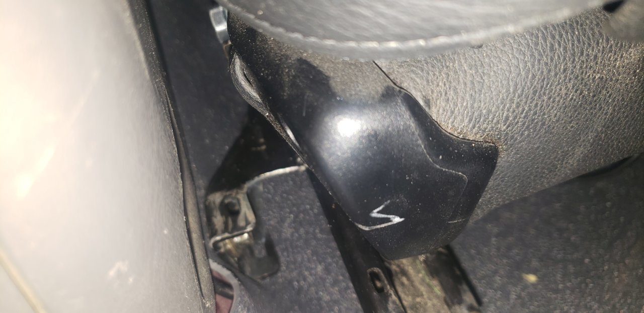

    Then I was also able to get the BMW seats installed
    And While I was at it, we went ahead and installed the vinyl

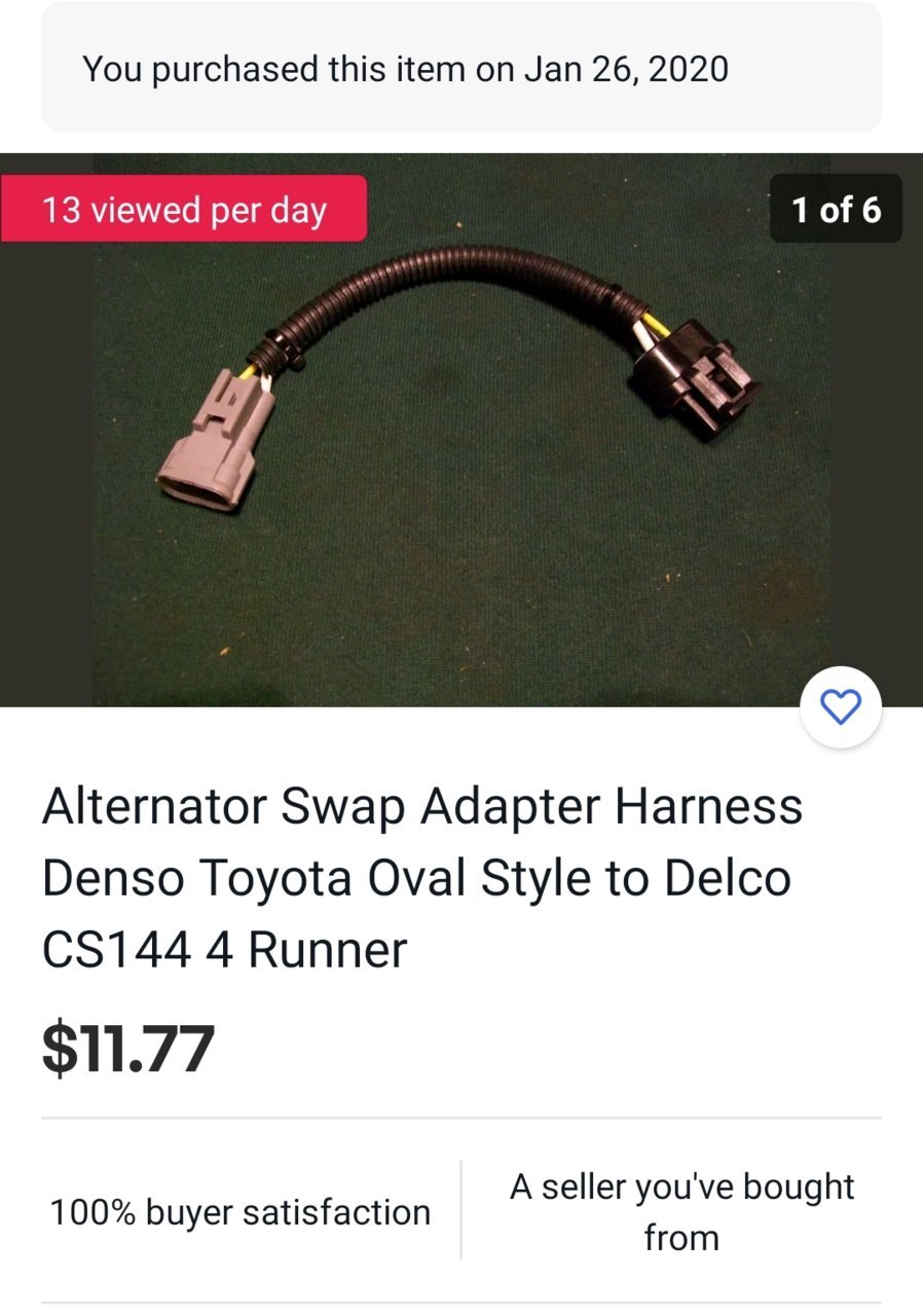

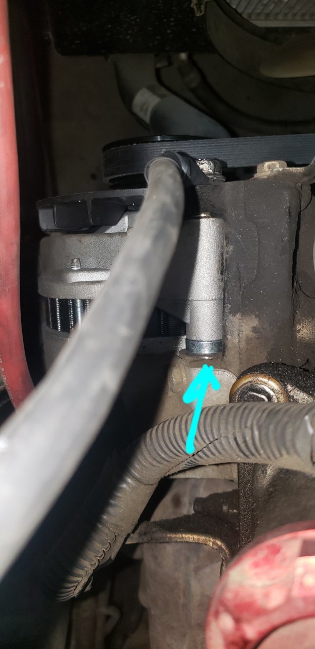

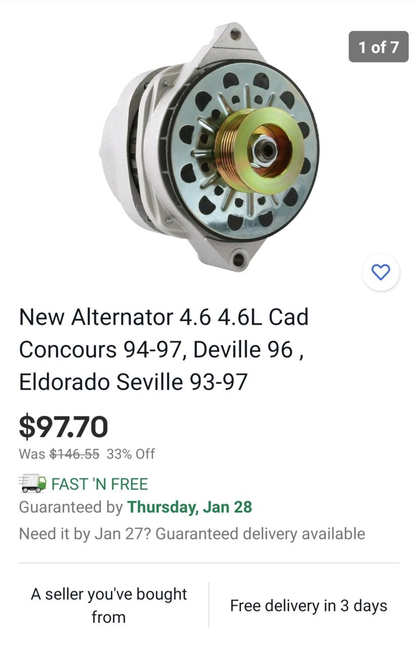

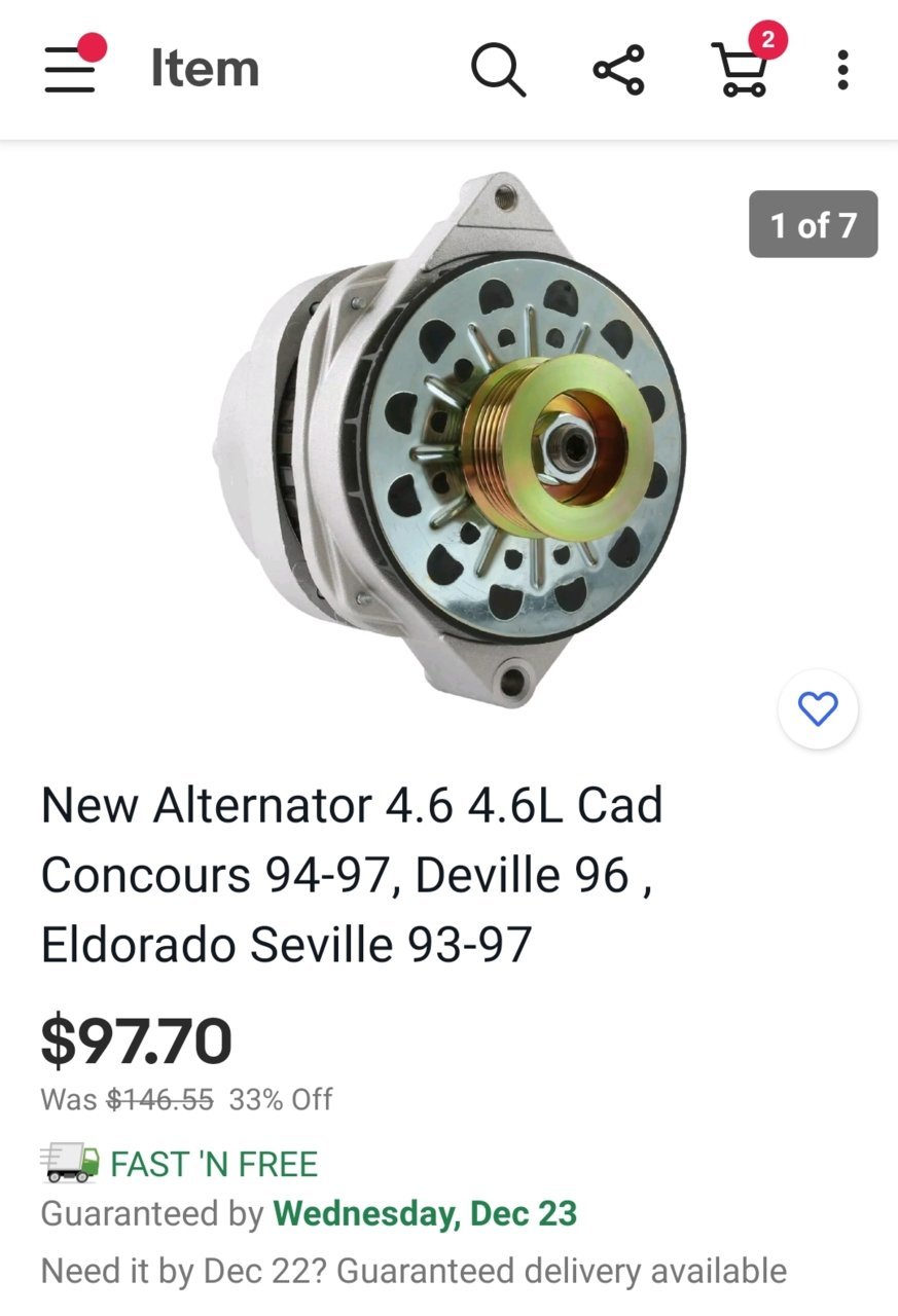

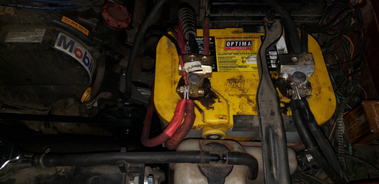

    CS 144 (Cadillac) alternator and Big 3 wire upgrade complete. :thumbsup:
    Also, did an oil change and replaced the A/C idler bearing.
  19. Jan 25, 2021 at 8:17 PM
    #539
    El Taco Diablo
    El Taco Diablo [OP] Professional Pinstriper
    Nov 6, 2017
    #235223
    13,311
    Matt - KN6DZP
    Hughson, CA
    Impulse Red DC, 5vz-fe, 4wd swap, LT, dual case, F/R locked
    Just 3 tons of fun!!!
    Here's the alternator I went with (eBay)
    Here is the wiring harness adapter (eBay)
    Here are the dimensions of the spacer I used. I got this at Napa, but other hardware stores probably have them.
    Here is where the spacer goes.
