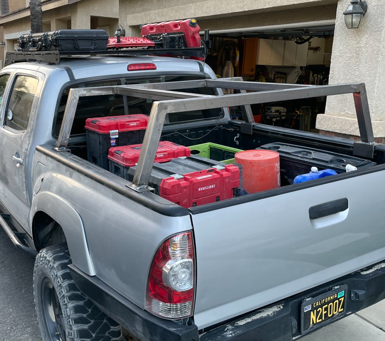

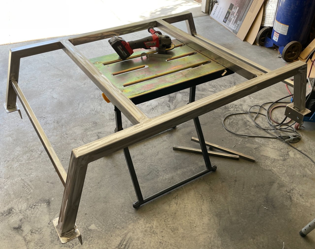

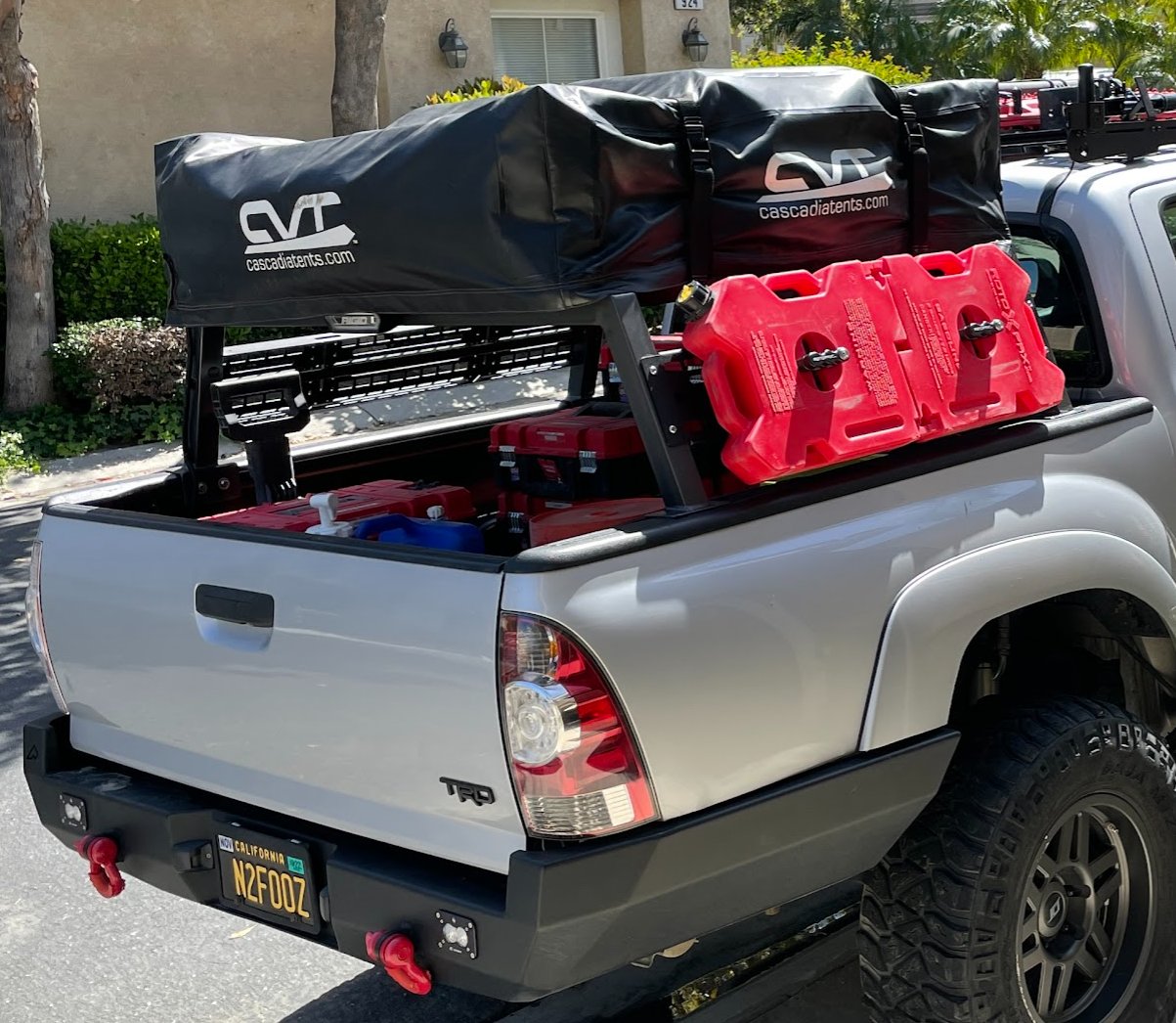

    Wanted a taller rack so I made a 12in tall one:
    Added 79in CVT Awning

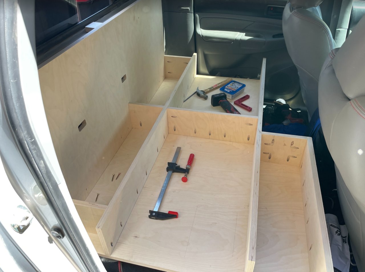

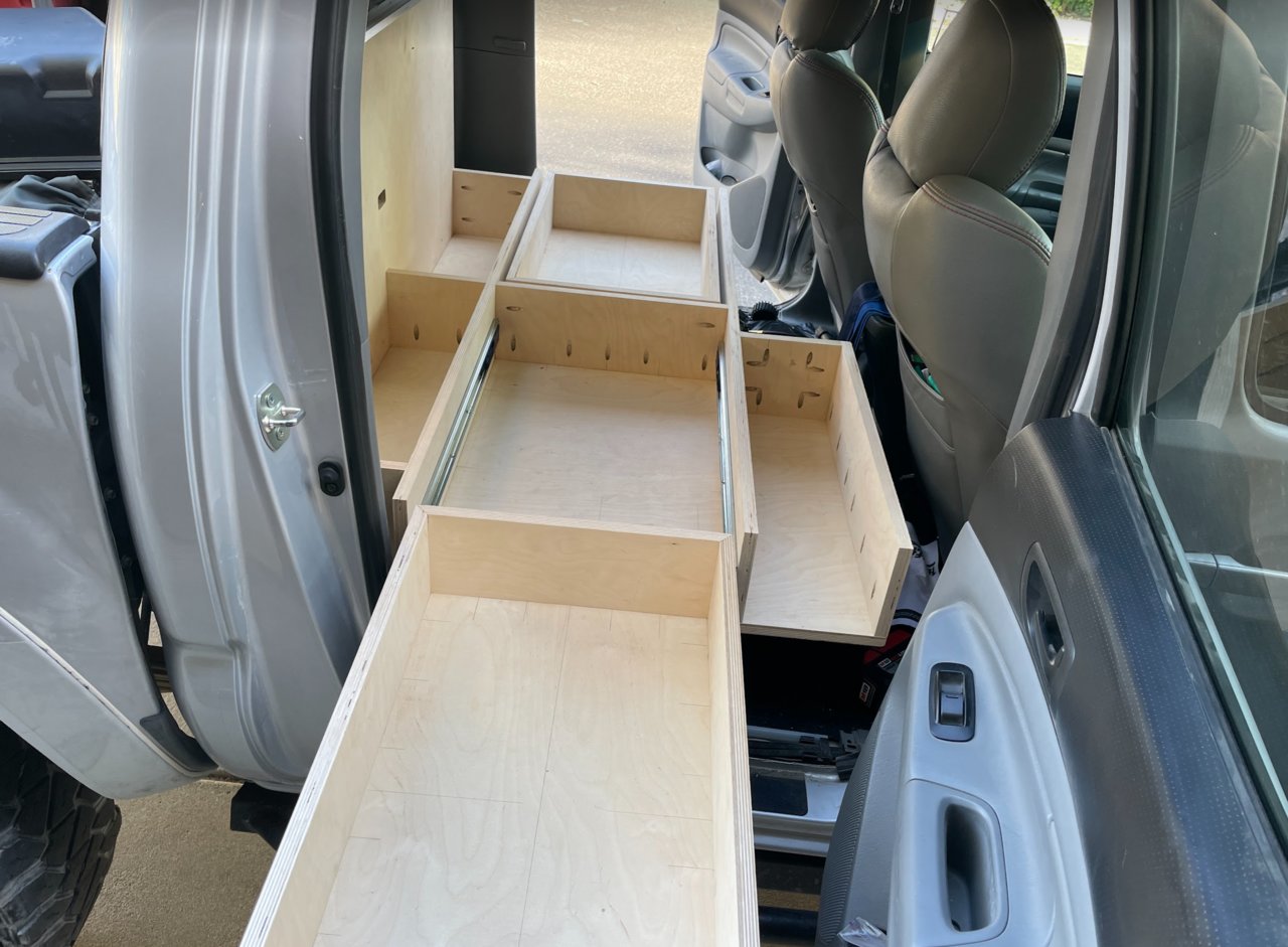

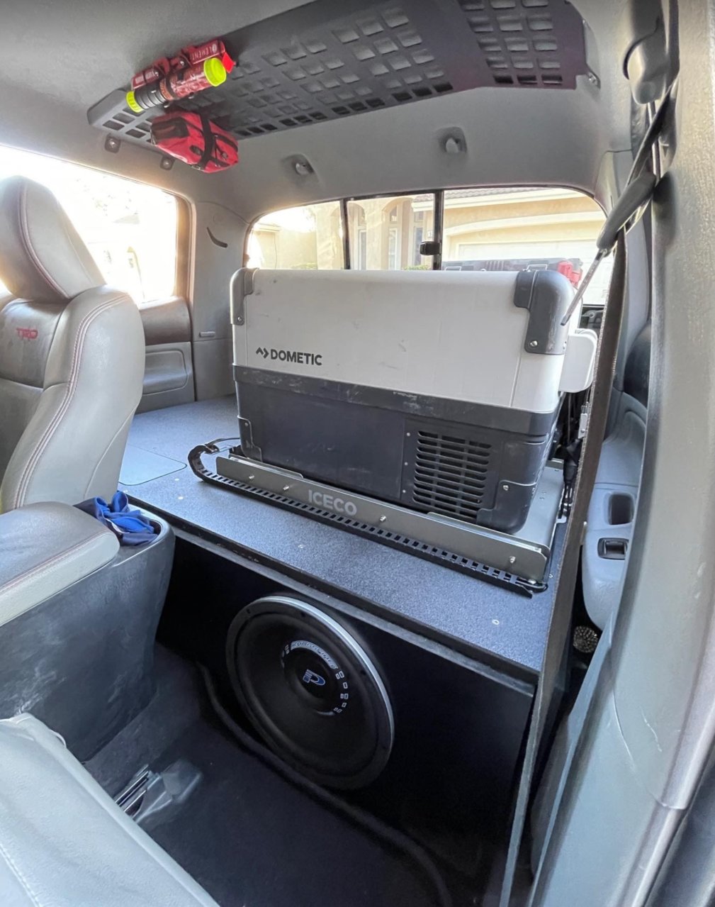

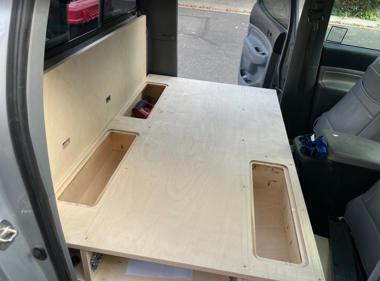

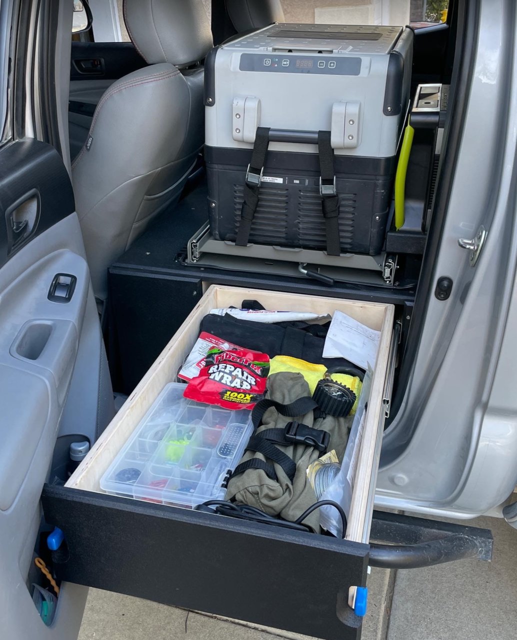

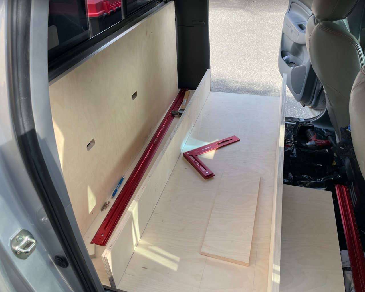

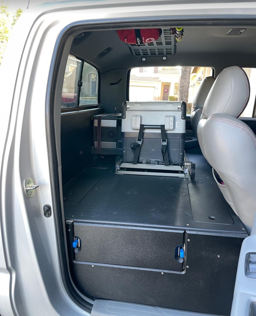

    Rear Seat delete:
    Squirt and Ricardo13x like this.

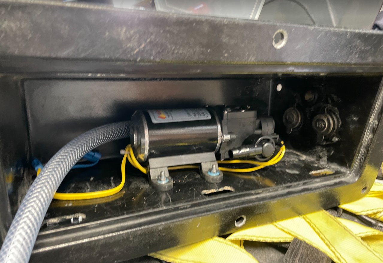

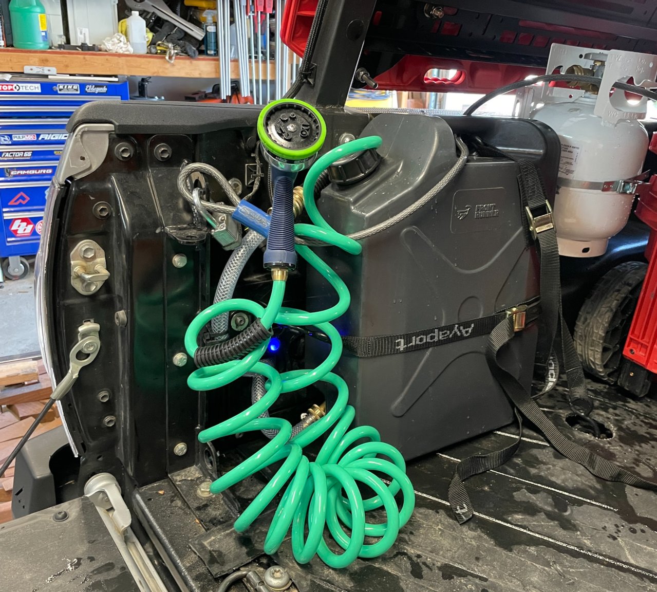

    on board water:
    Road_Warrior and Ricardo13x like this.

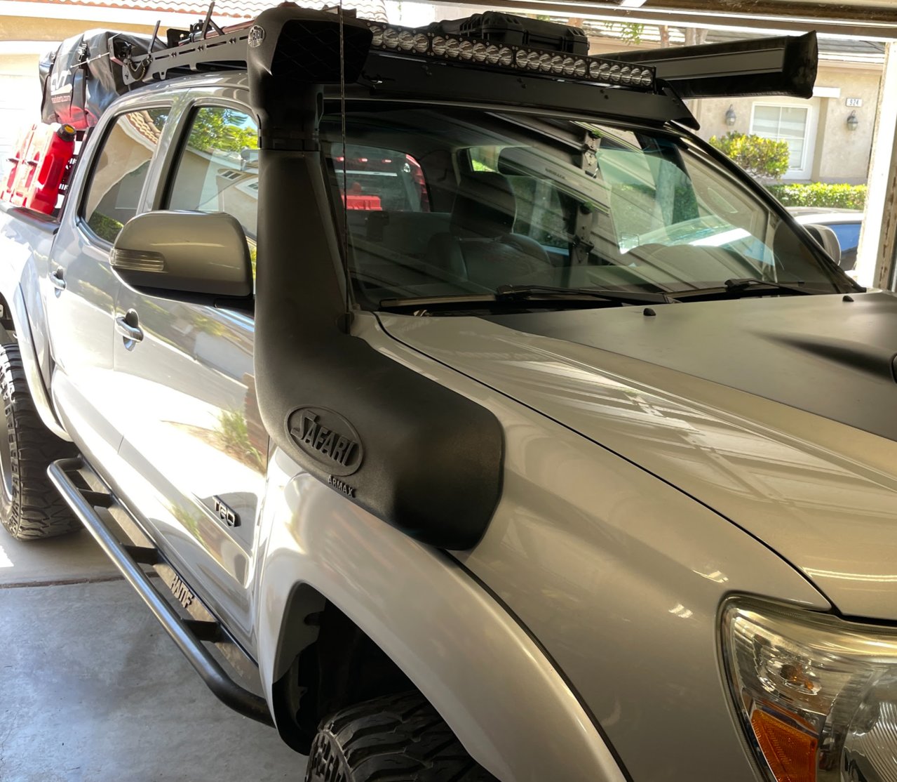

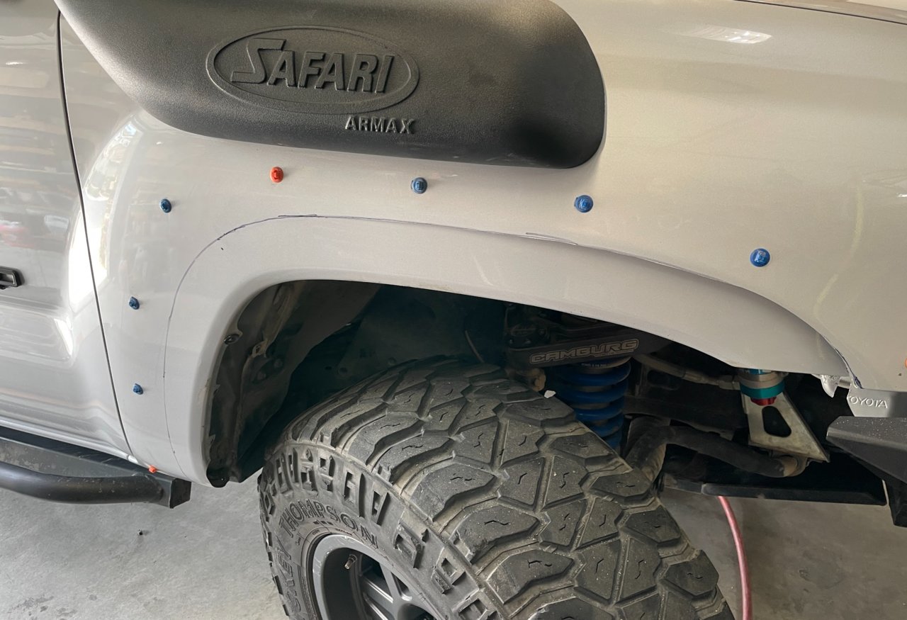

    ARB Snorkel: so I can clearance the front fenders
    Ricardo13x likes this.

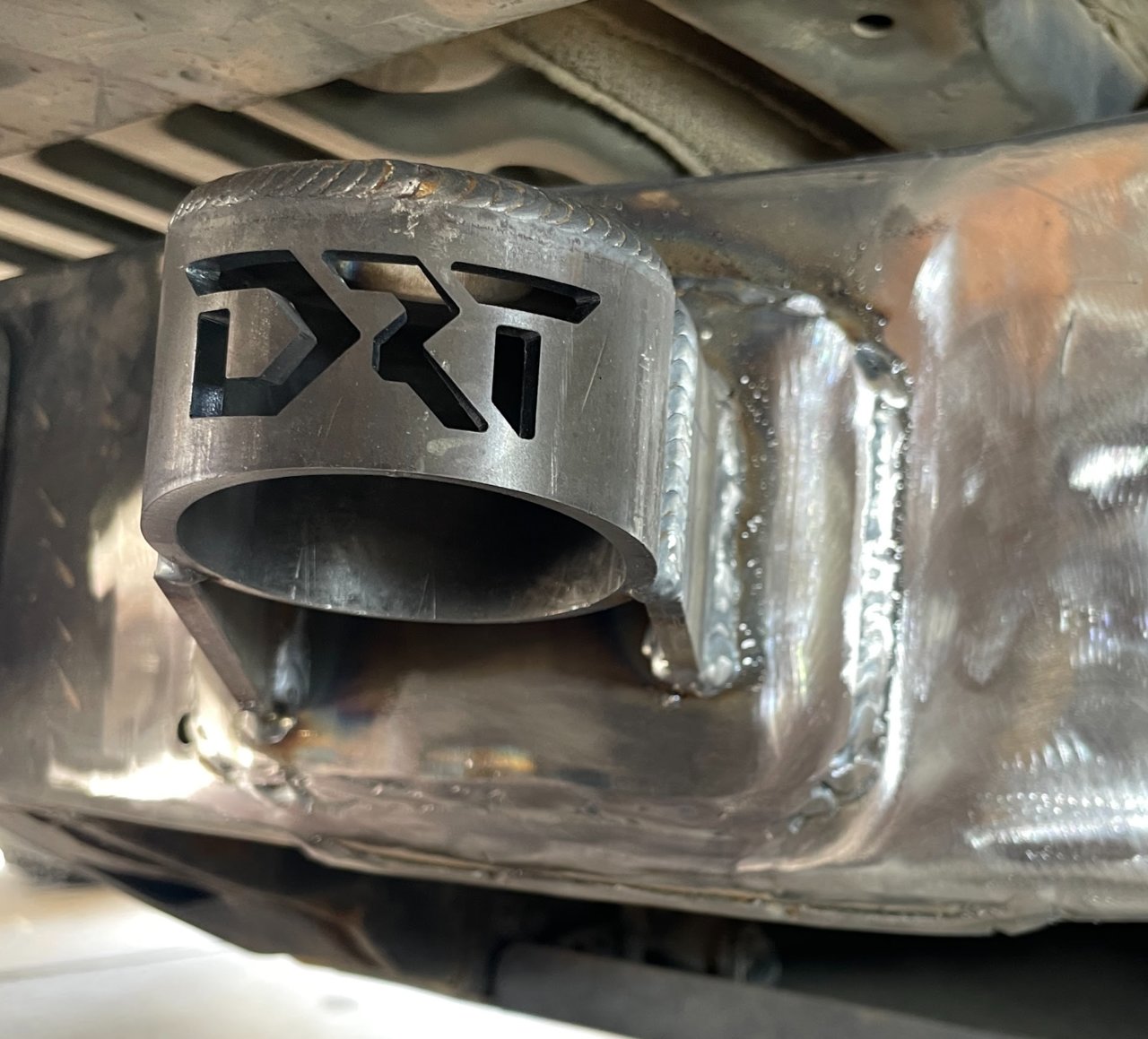

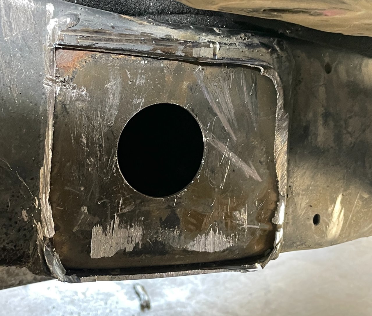

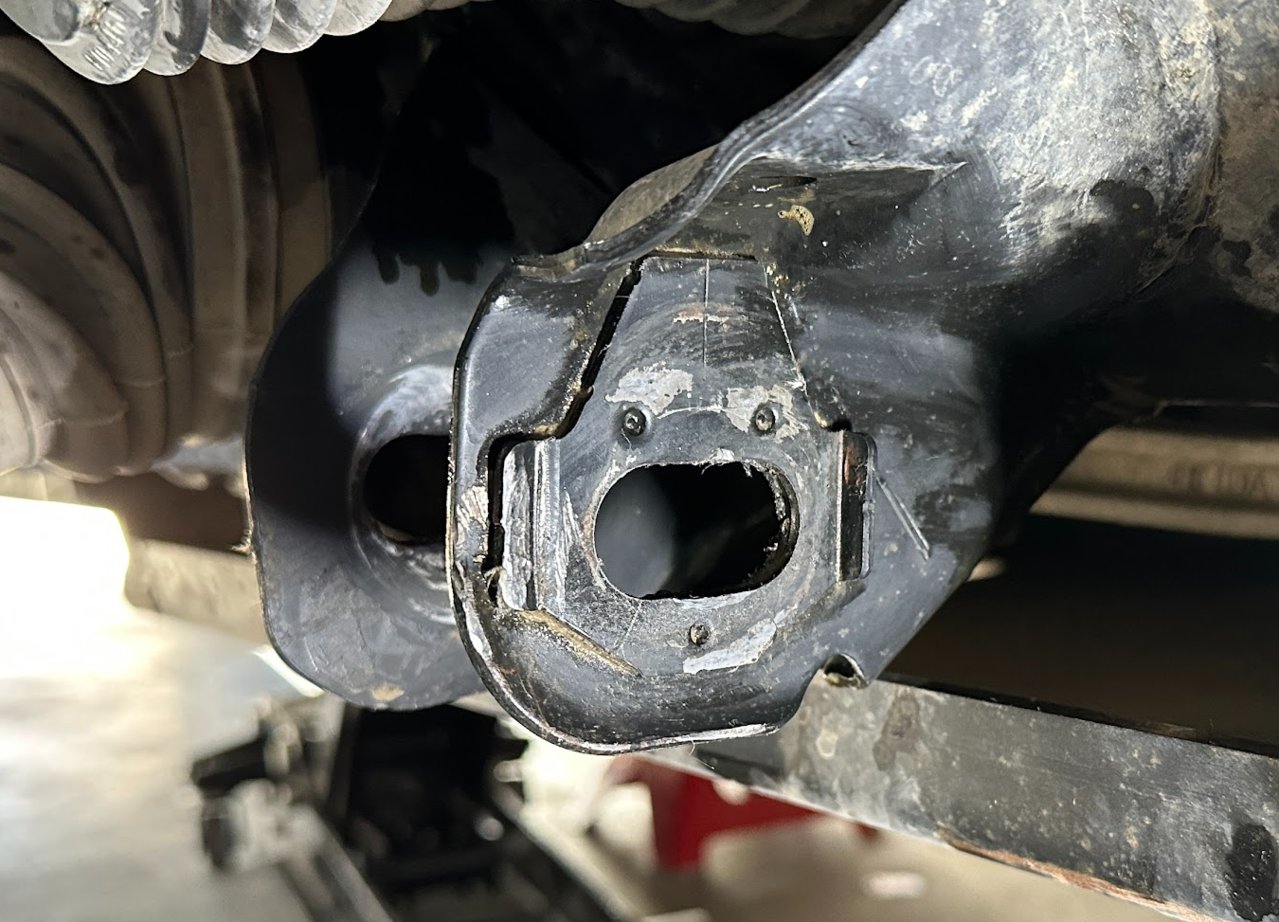

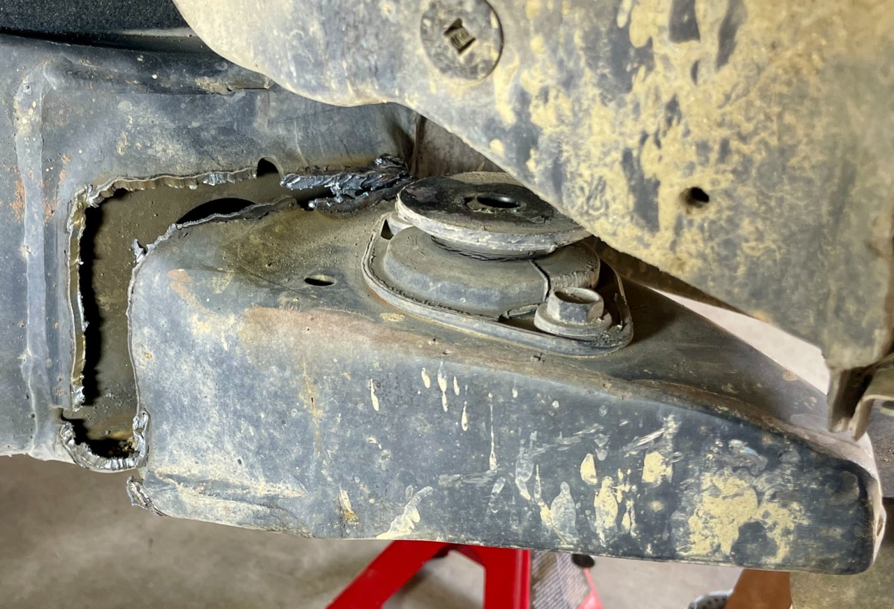

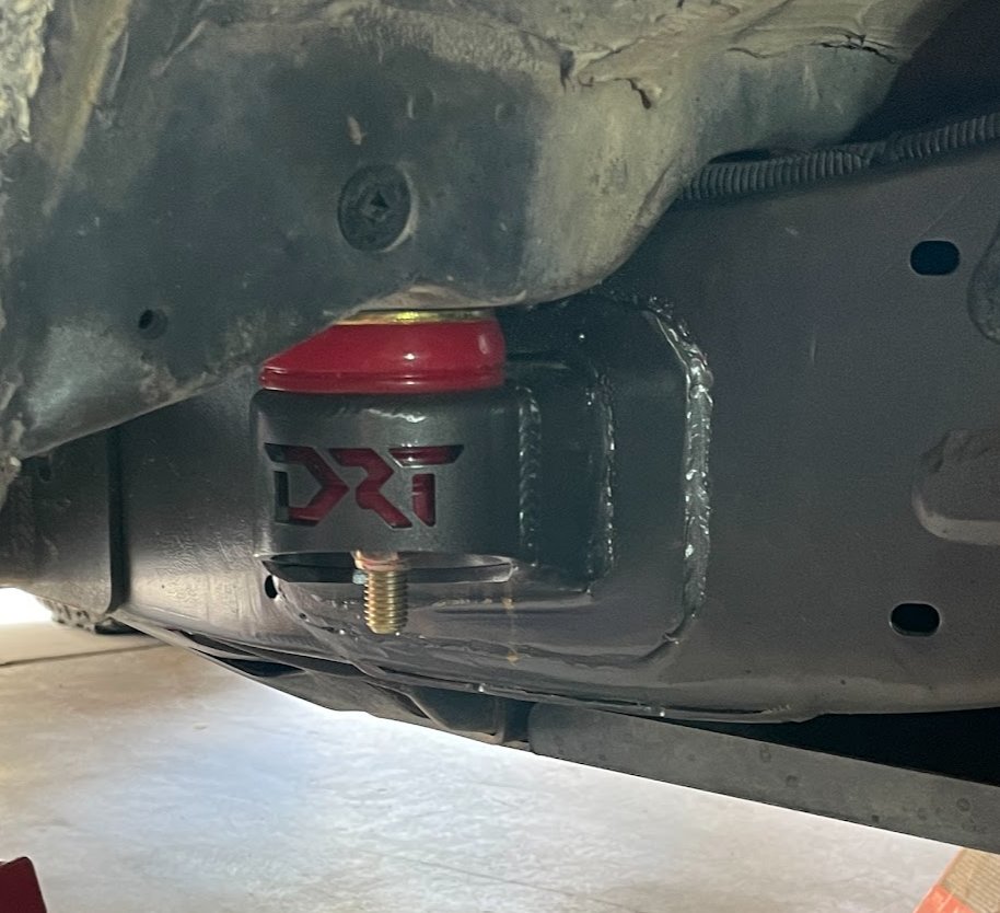

    Body mount relocation (DRT):

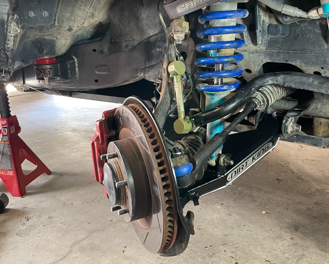

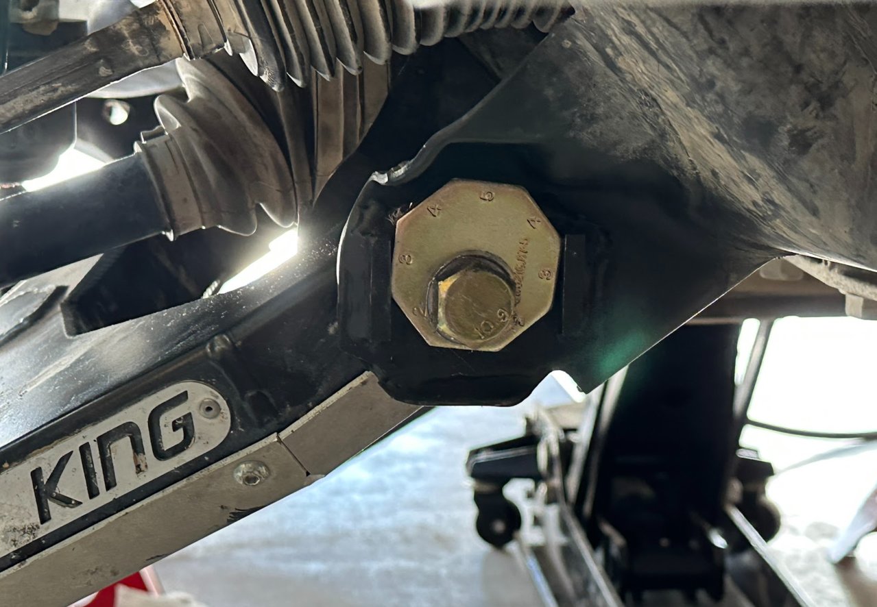

    Dirt King LCA's:

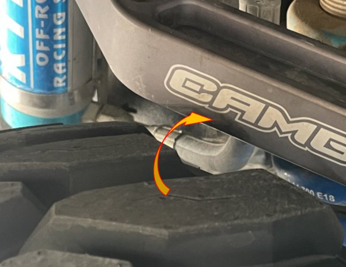

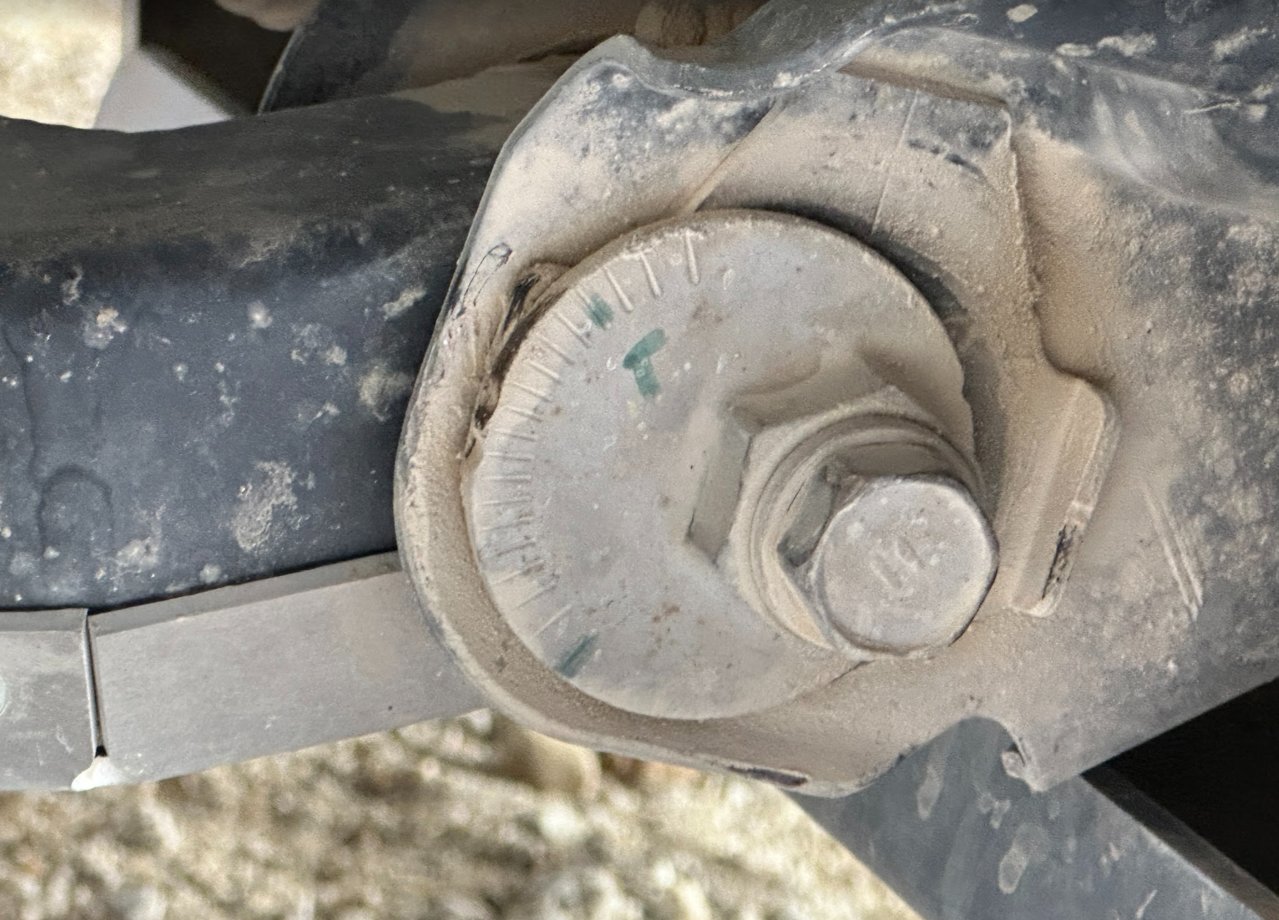

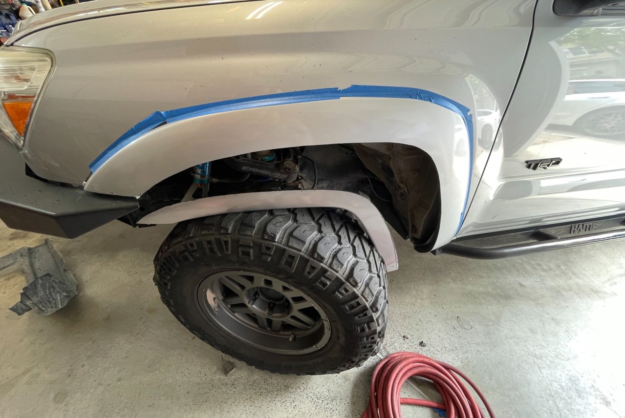

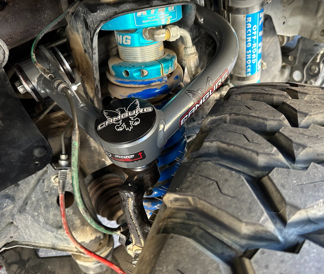

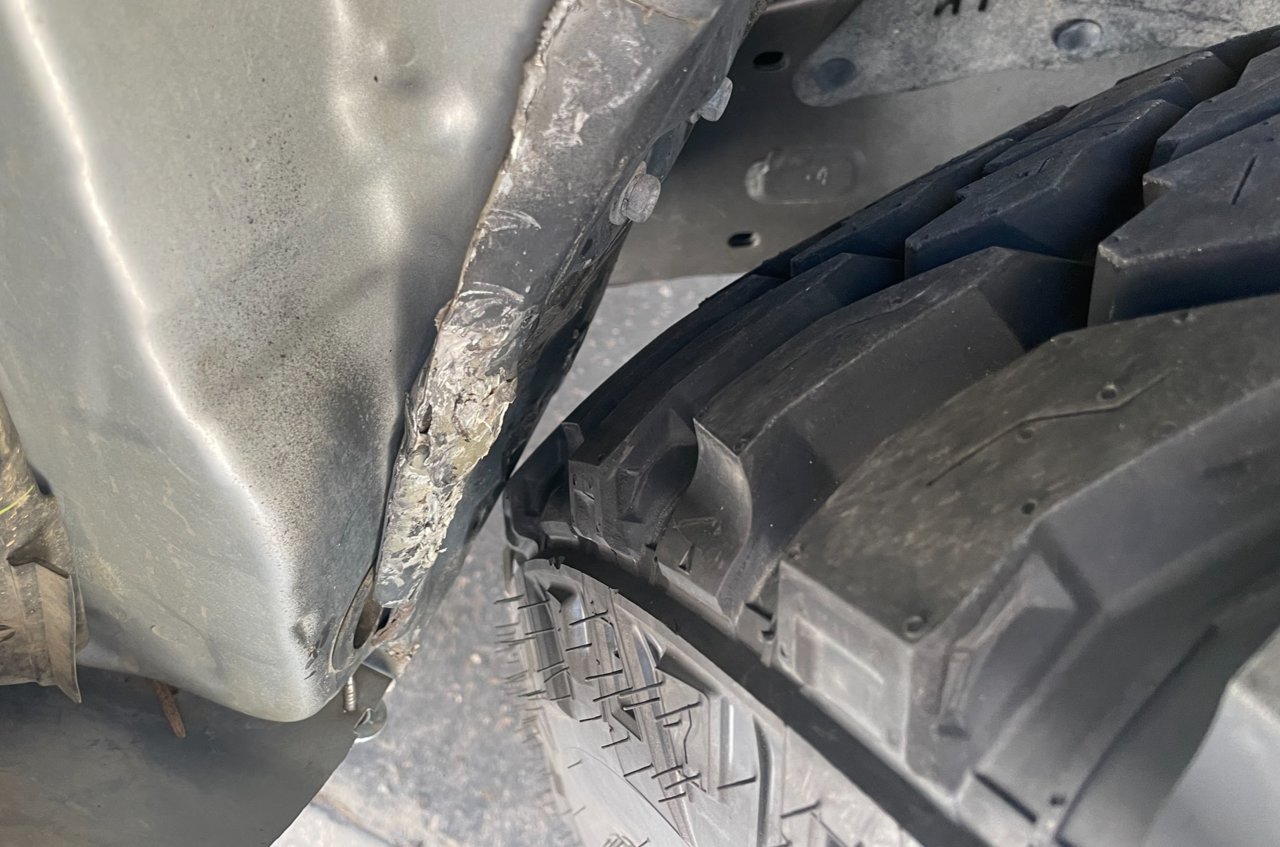

    35s! 315/70-17 on 17x8.5 SCS with 4.3 Backspacing. (Currently hits the Kenitik UCAs if I don't run spacers)
    But they hit the UCA:
    I temporarily added 1in spacers causing the tires to rub the back of the well.
    Currently waiting for new non-billet UCA's that will hopefully clear without needing to switch out wheels.
    Ricardo13x and Road_Warrior like this.

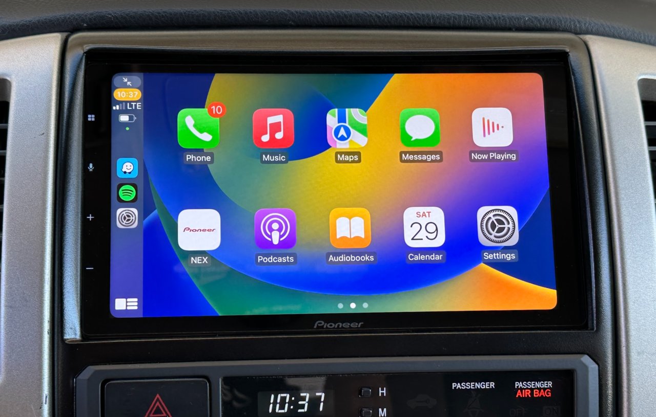

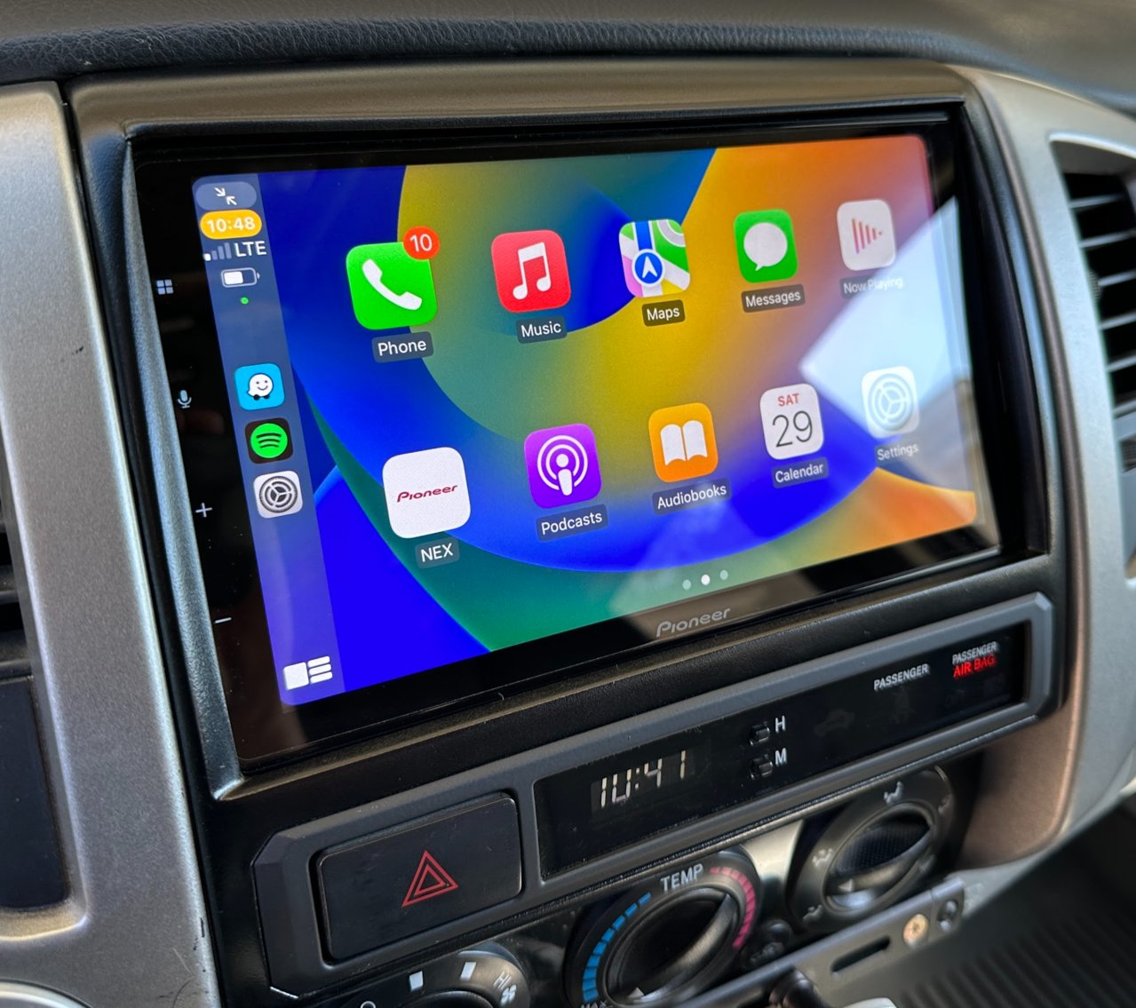

    Flush mounted the Pioneer DMH-6600NEX 9in head unit. There is no kit to do this so I had to take the 5500 8in kit, cut/sand/file it as well as cut out some of the bezel plastic behind the screen. I had to lower the radio placement slightly (about 1/8in)
    I also added it iDatalink Maestro so I can now see my tire pressures, instead of just a TPMS light.

    • Spacers added
    • Upper control arms switched back to tube style for tire clearance

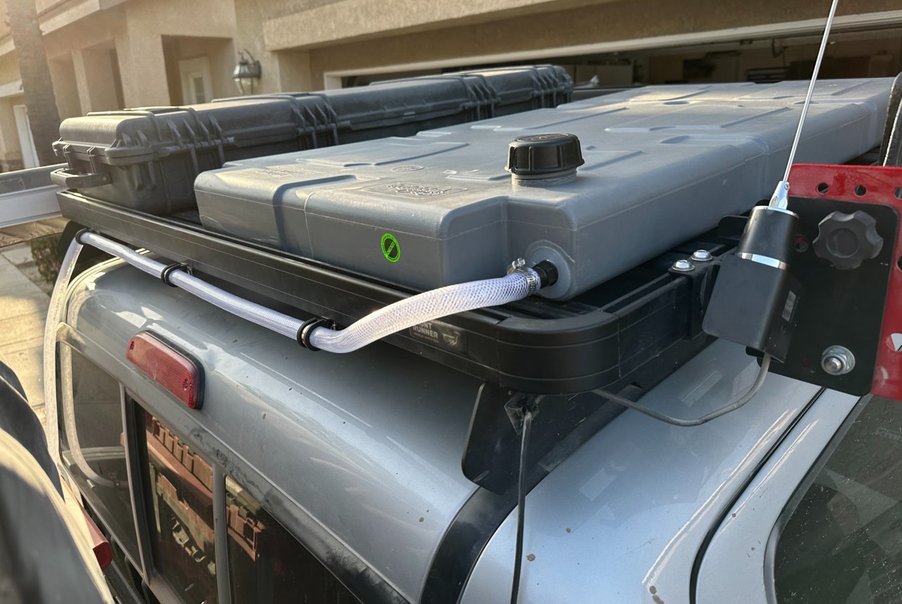

    Switched from Prinsu to Frontrunner Roof Rack and added a 50L water tank:

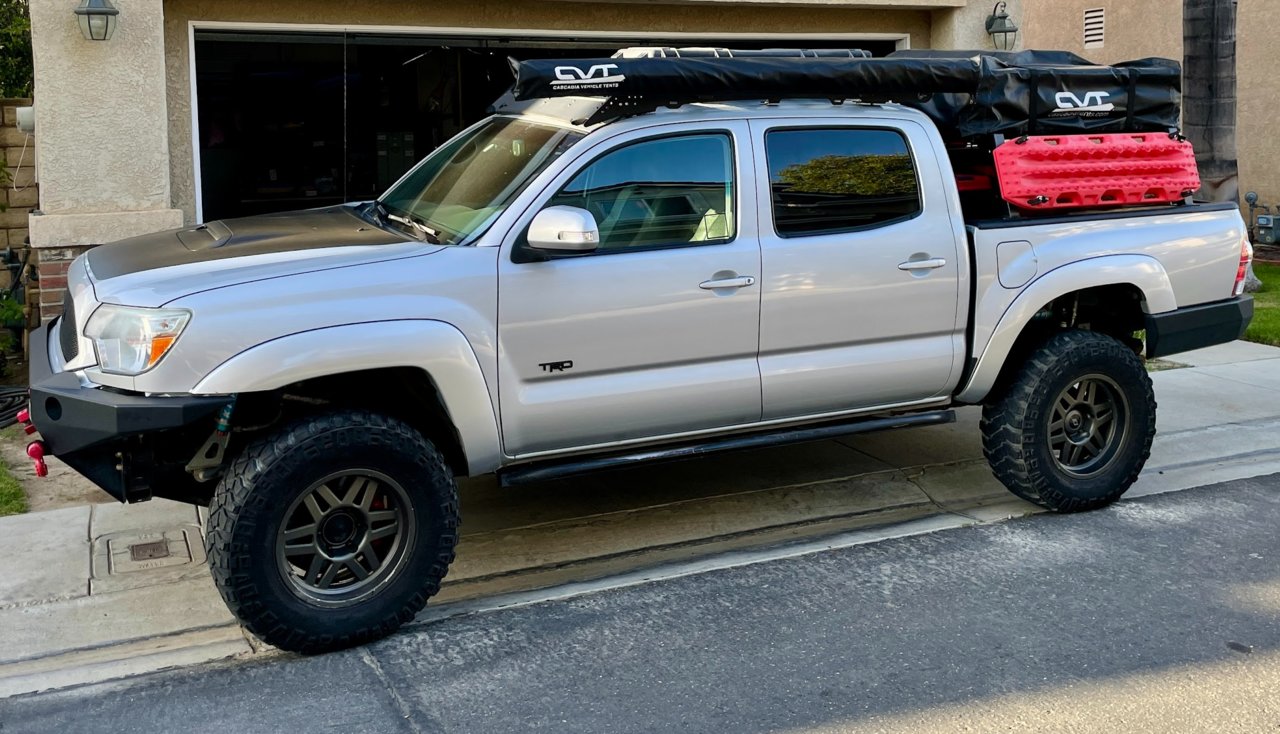

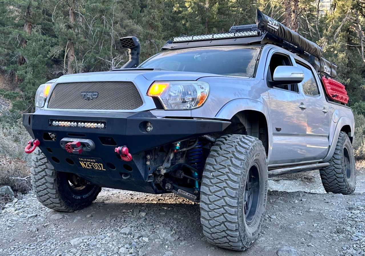

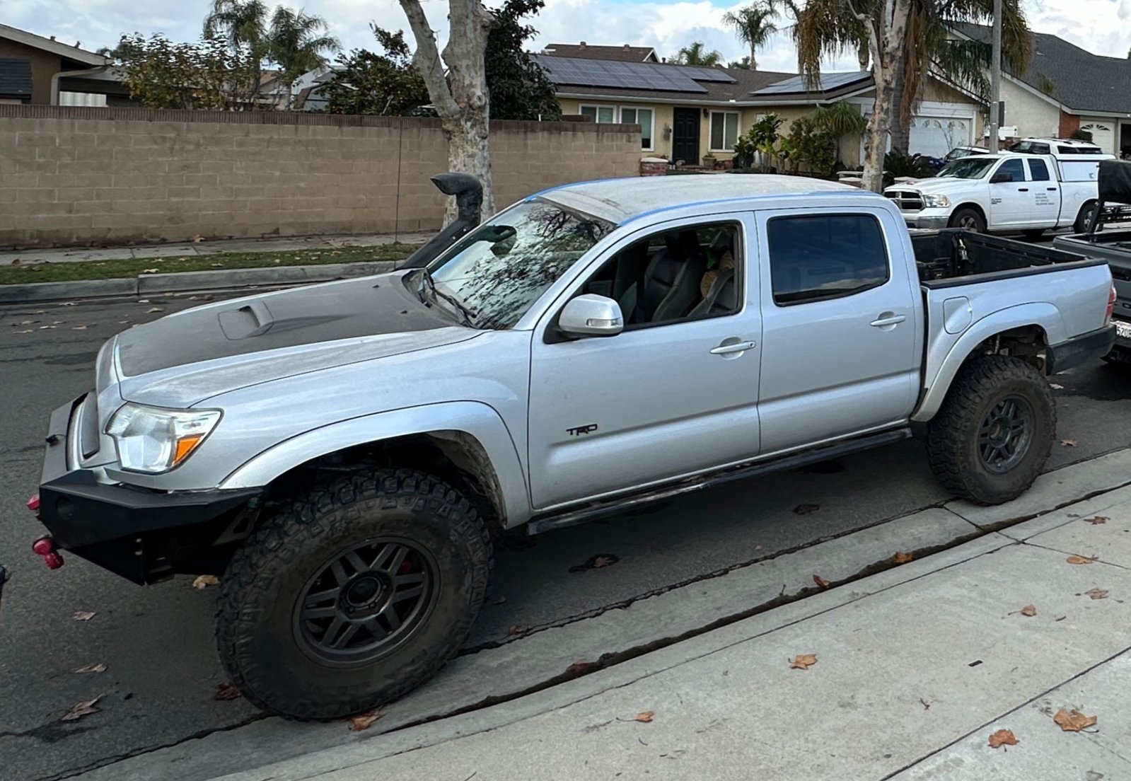

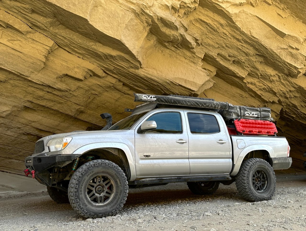

    Latest Pics:

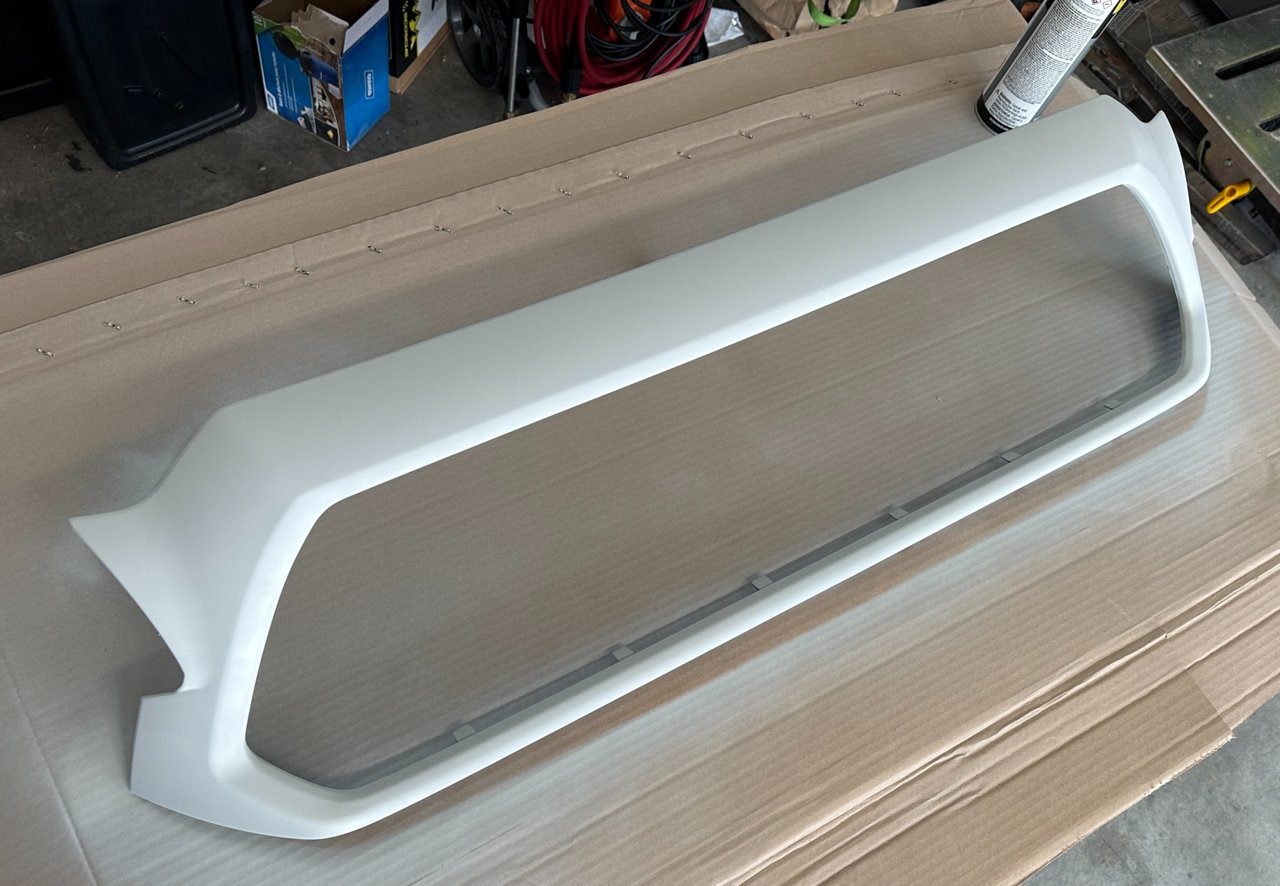

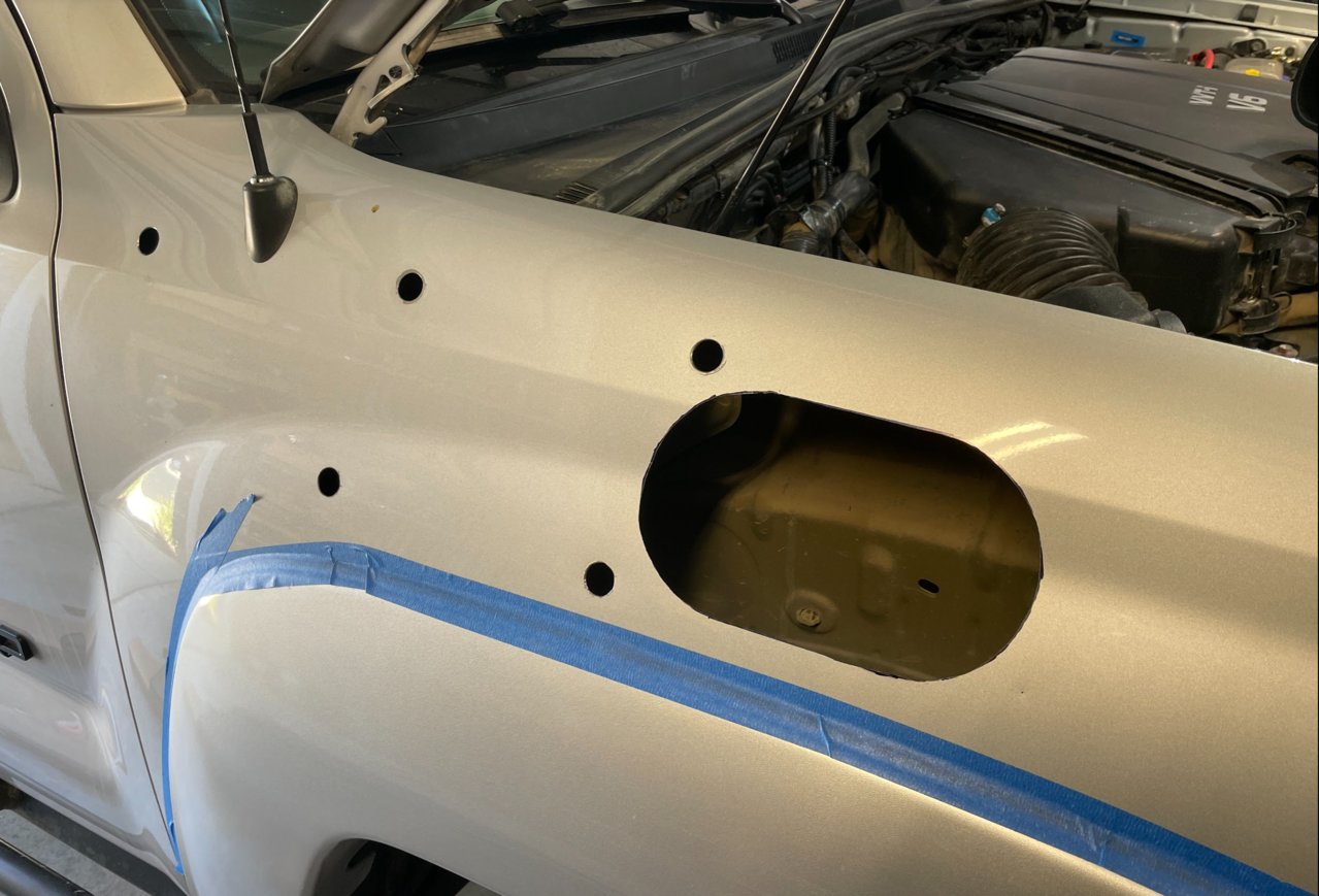

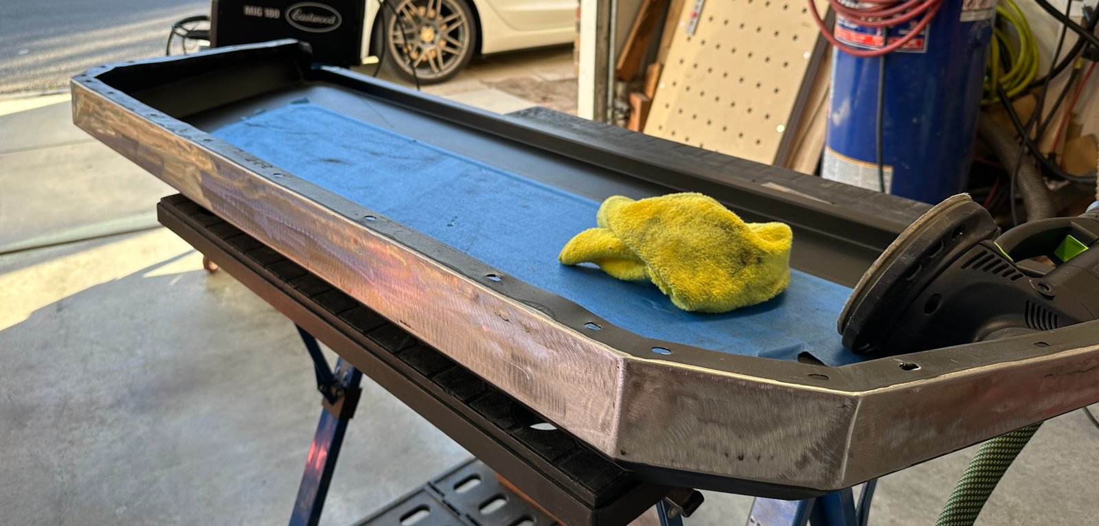

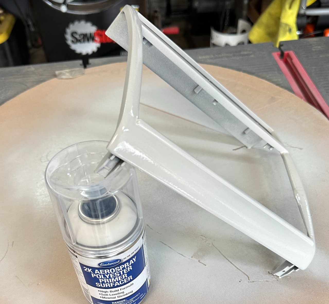

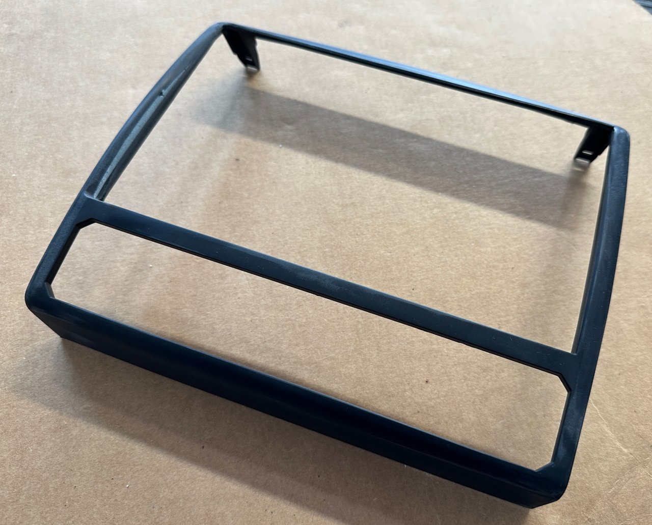

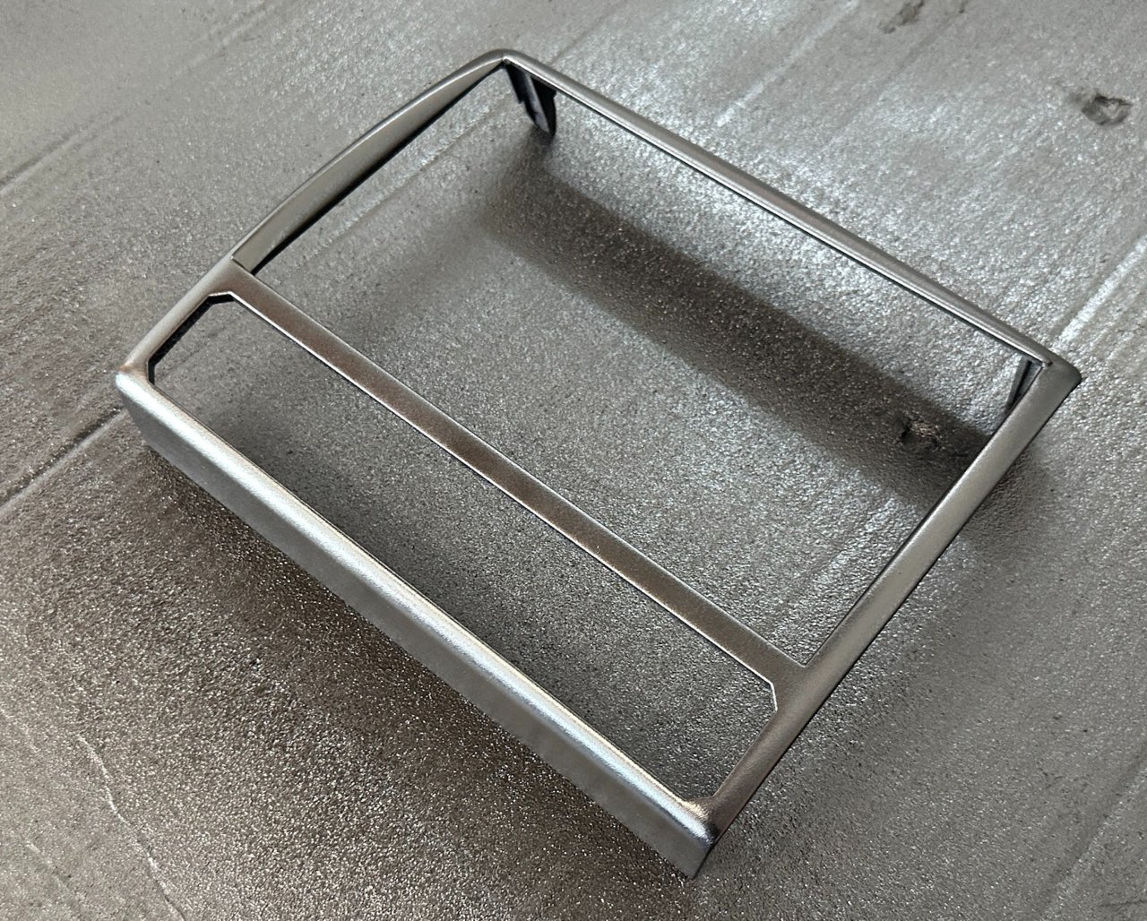

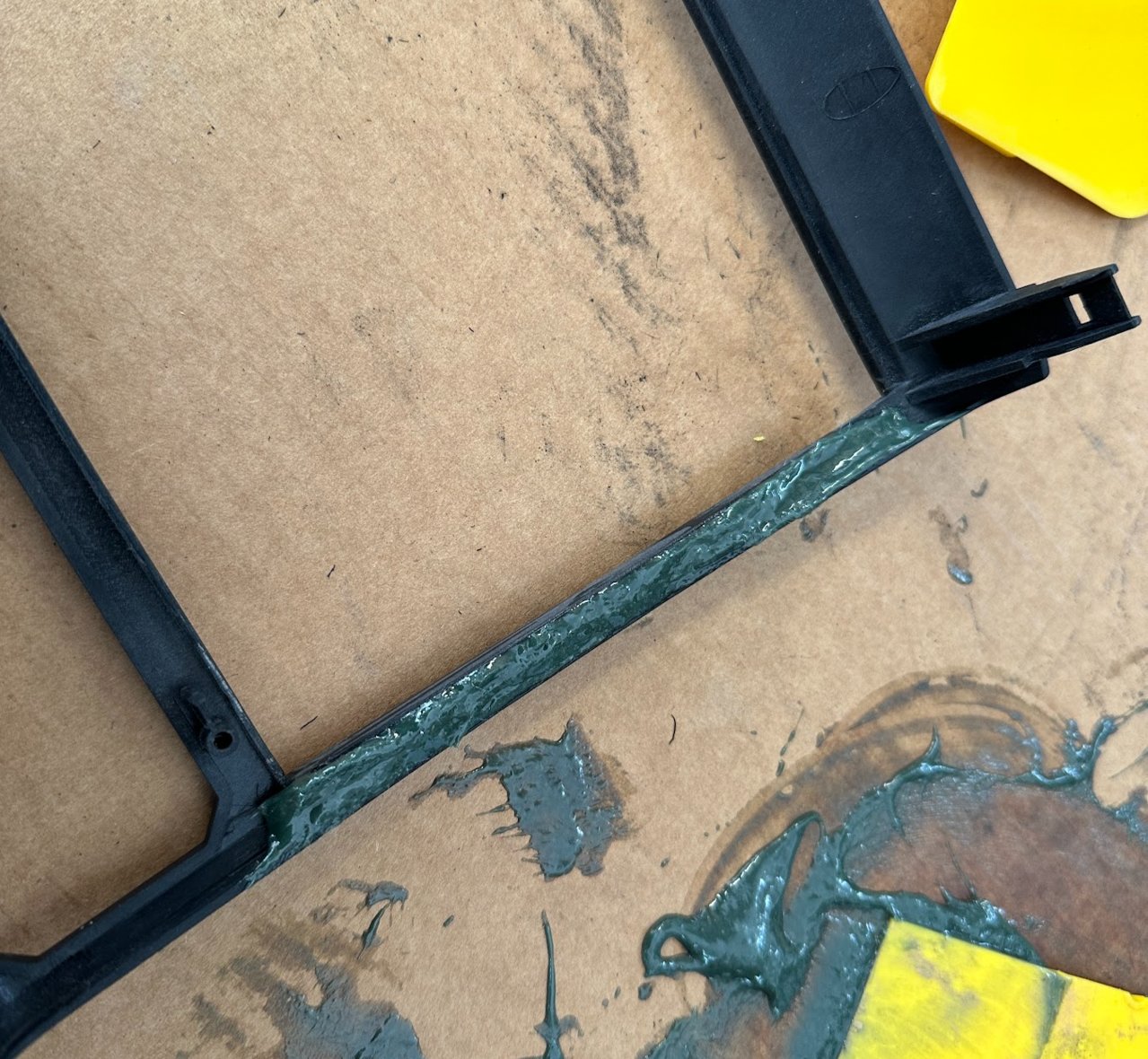

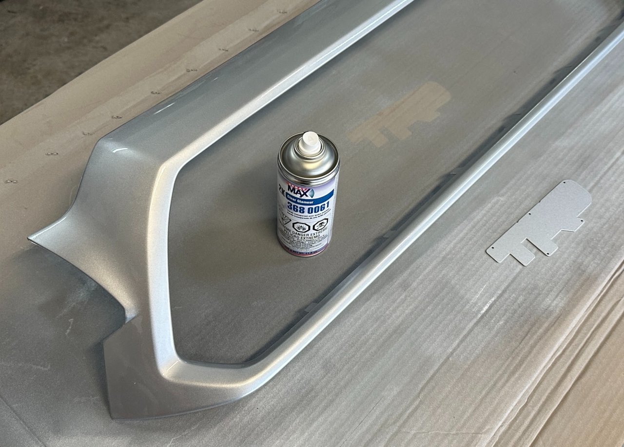

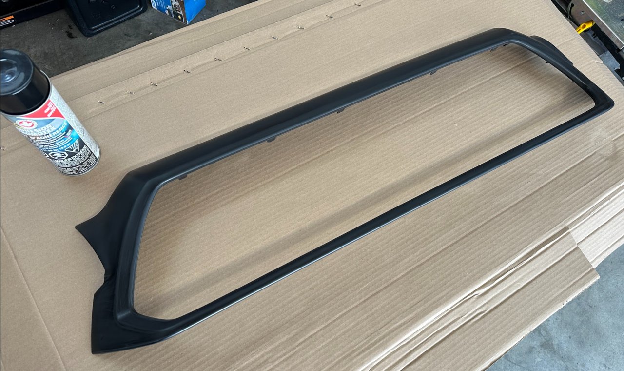

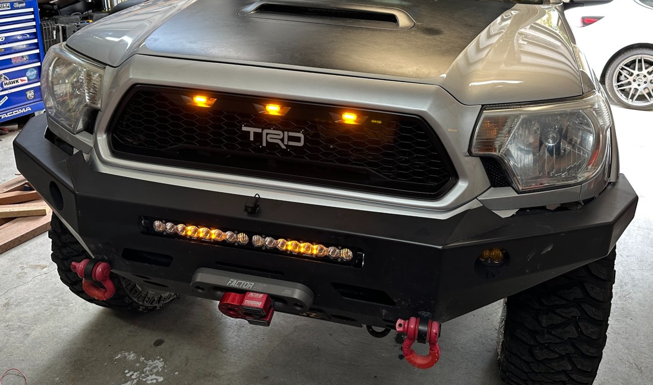

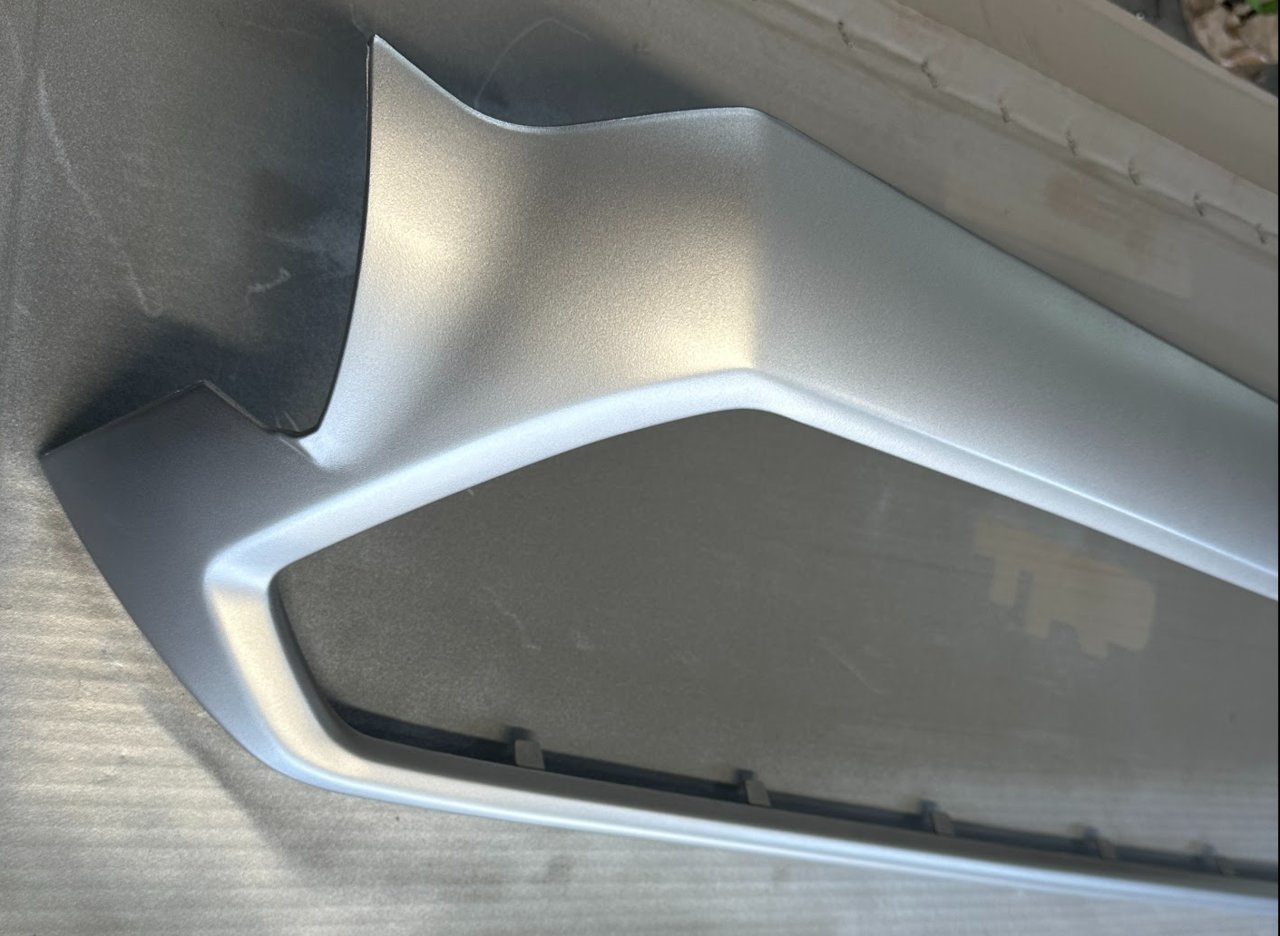

    New Amazon "Raptor" style grill for better airflow.
    Adhesion promoter applied to ABS surround:
    SEM High build sandable primer"
    1E7 Silver Streak Metallic base coat:
    2K 2 part "Glamour" clear coat
    Installed:

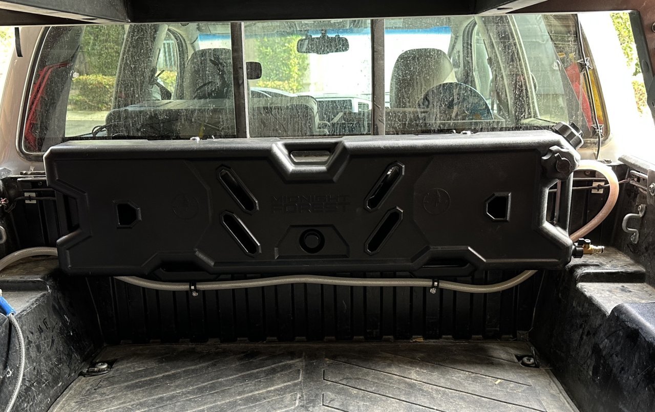

    Switched out my water tank to an 8gal Midnight Forest Rain Basin

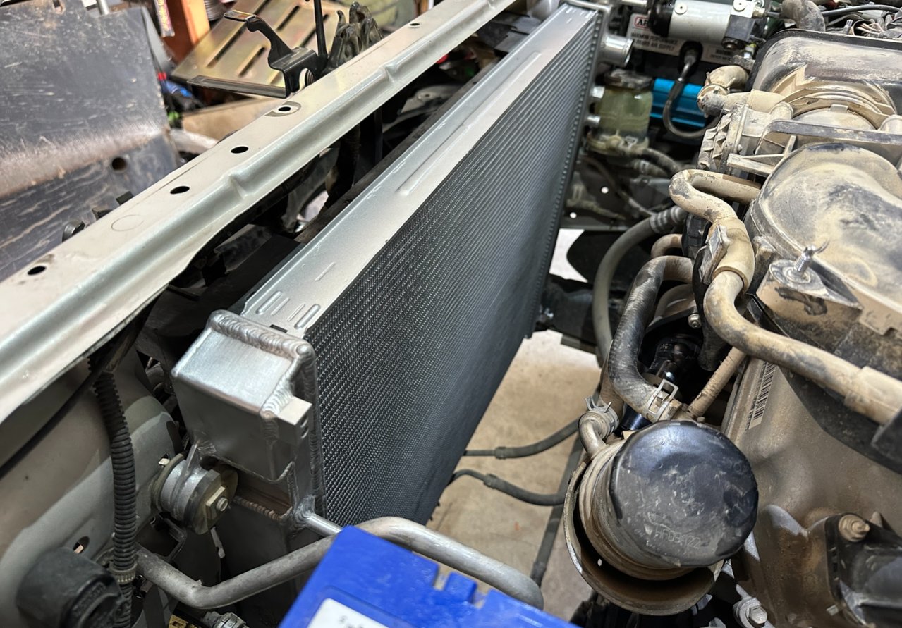

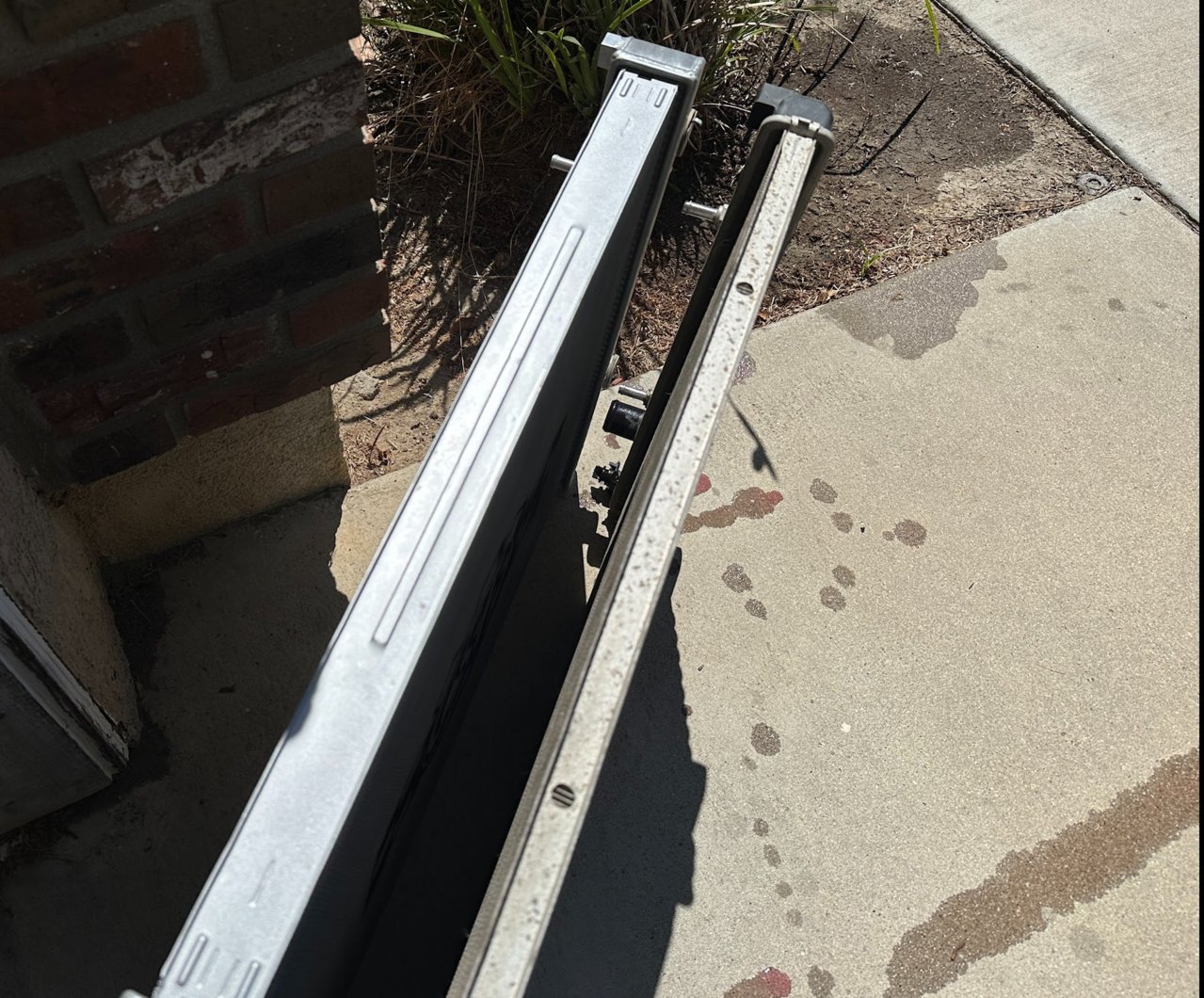

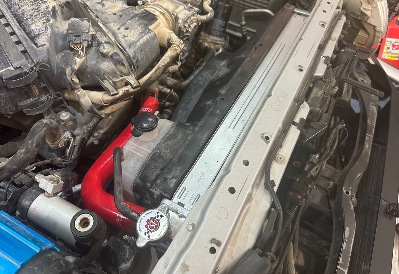

    CSF Radiator with HPS silicone hoses:

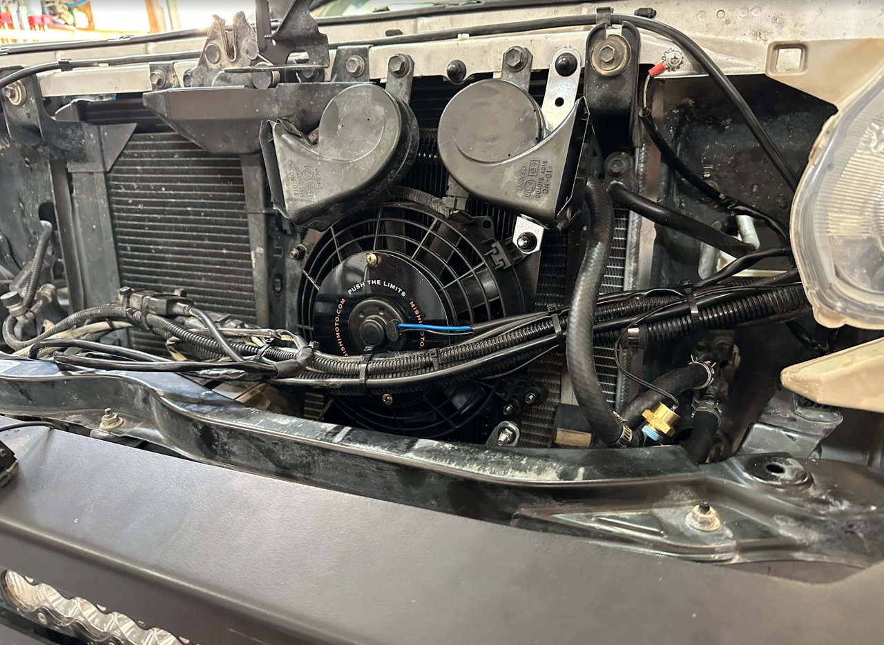

    B&M Trans cooler with Mishimoto "pusher" fan.

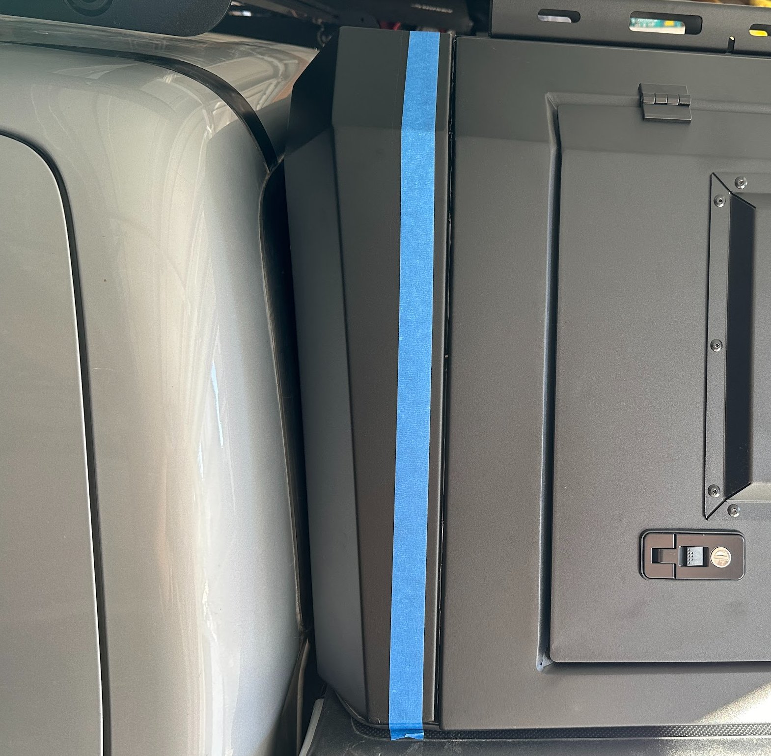

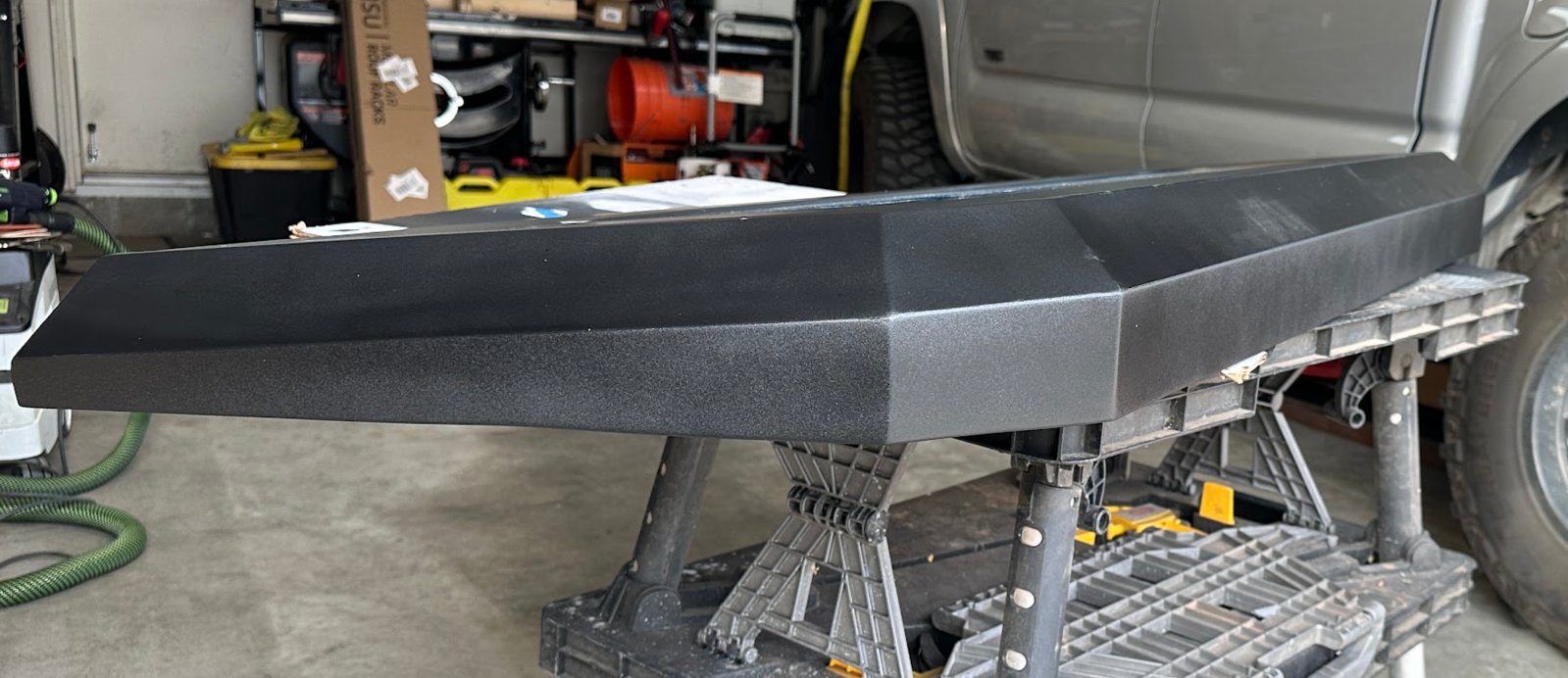

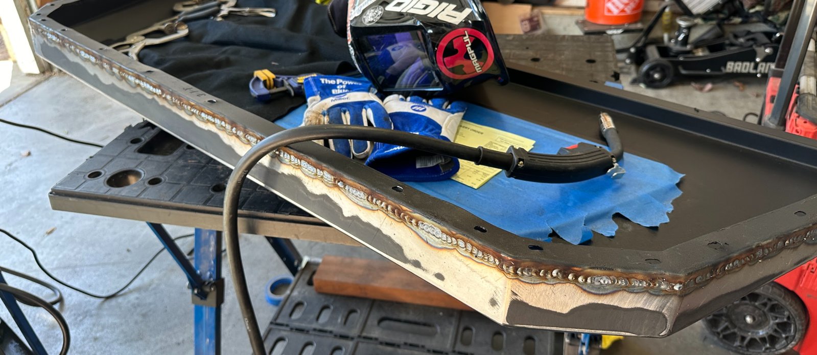

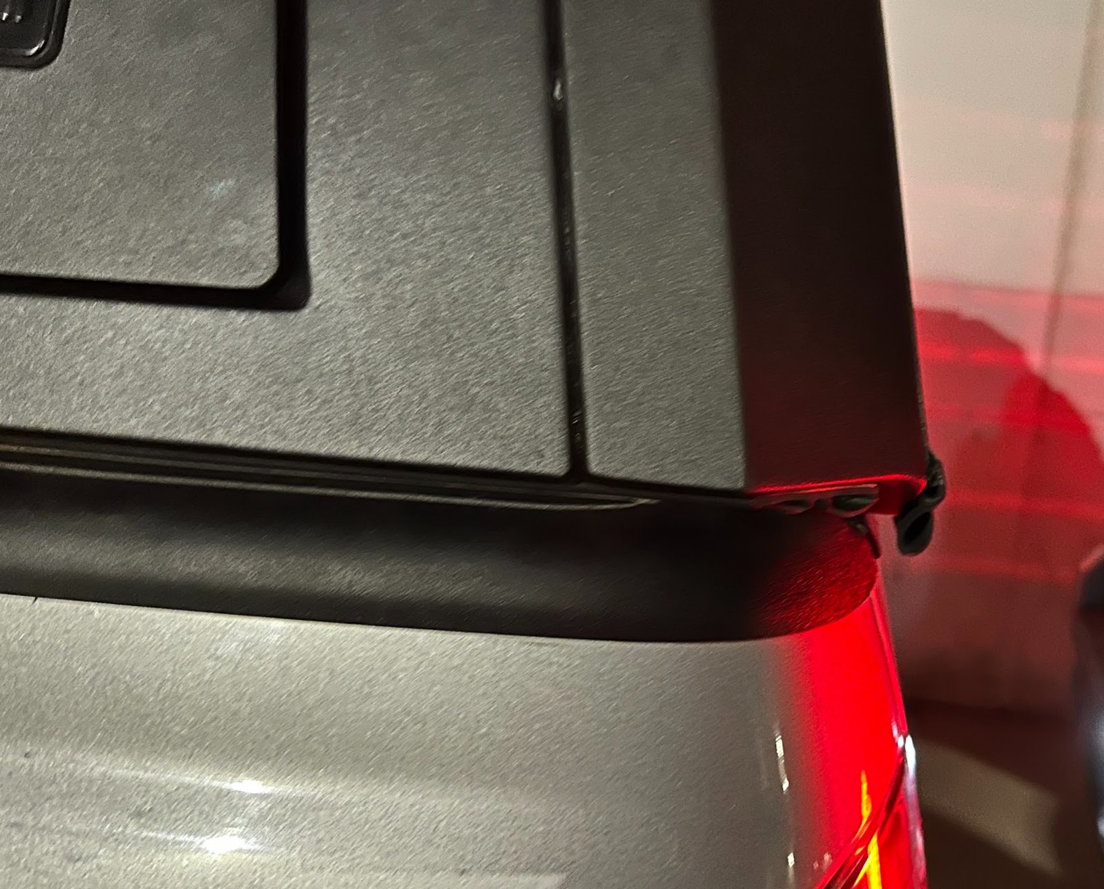

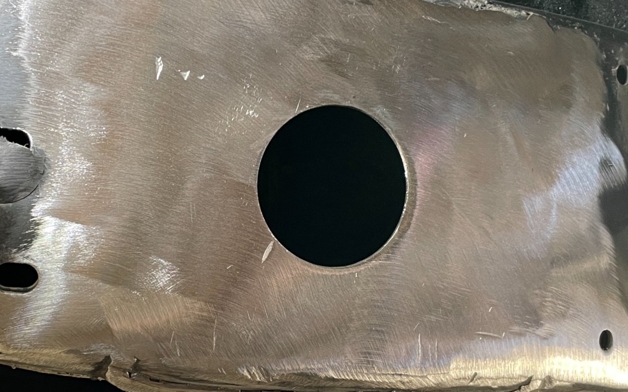

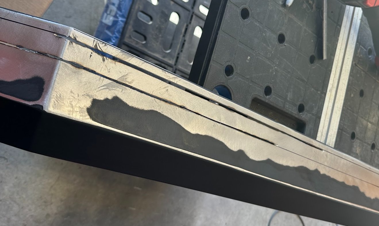

    I got in on the holiday buy for the BYND 4x4 cap. I went into it with full knowledge that it's a Chinese cap that I could buy direct for less but I was hoping that BYND having a US entity would help with any warranty issues. It took a few months to actually get the cap and when I did, it was about an inch too long :eek:. I contacted BYND fully expecting to get ghosted, but to his credit, he got right back to me and offered to give me a full refund and take the cap back. Instead I decided to keep the cap and fix it myself for a discount that I was happy with. I took it as sort of a personal challenge and knew I could do it. I ended up "channeling" 1" out of the front section, re-welded it, and painted it.
    The cap stuck out and was too close to the cab.
    I realized I could cut an inch out of this section to make it fit
    Cut with a cutoff wheel
    Ran out of gas while stitch welding the thin sheet metal but it worked
    Cleaned up

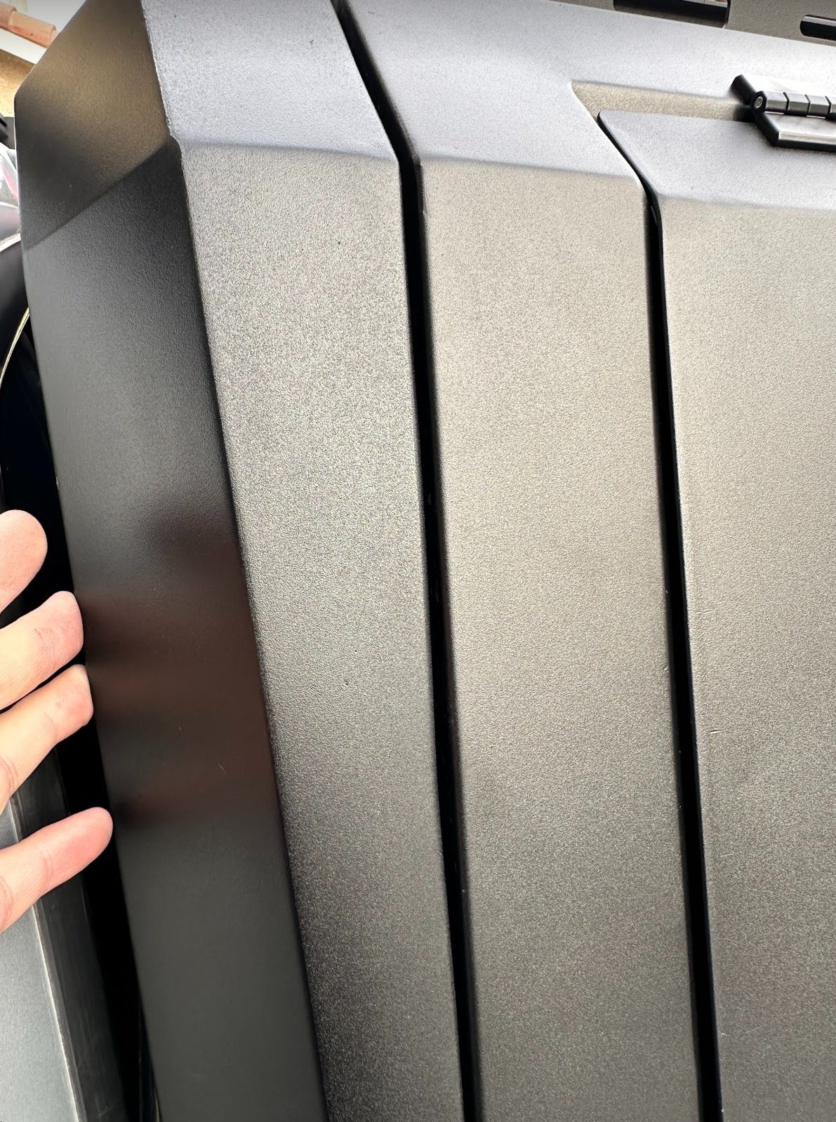

    Painted with texture paint and satin black to approximate the powder coat texture
    Not mad at the paint match
