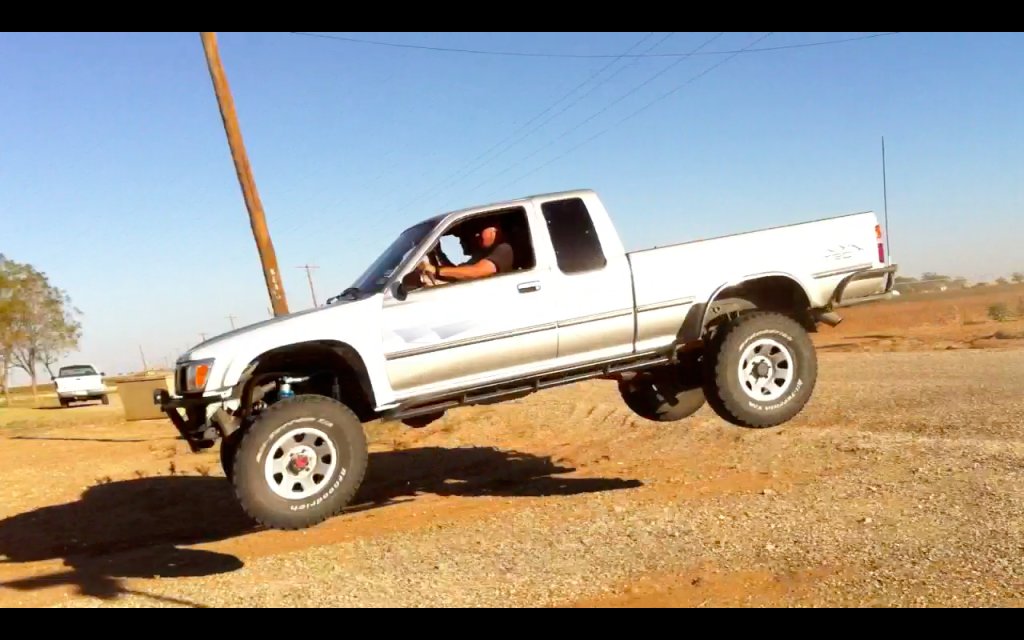

    and for spring under it works great crawling, u get a clean 18" of travel back there, i really really doubt the hangers would get cought up, if so it would be minor. If u have alot of weight out back use the deaver F67 pack, people race that pack and its what i use. otherwise u the F55 pack that doesnt arch as much and is softer. I would run 12" shackles with it and almost anyshop can build u them, i got mine from Richer Racing and i love em. and u will need front hangers which u can make or buy, Total Chaos makes a badass set and u will need the new u-bolt plates witch TC also makes.
    truck my buddy built, i dont think u can have a truck more ready for anything then this set up, 4x4 long travel front and rear with locker:
    http://www.youtube.com/watch?v=ykXxgMBZvZc&feature=channel_video_title

    Thanks blackhawk for that video. Thats mostly the stuff I'll be doing with occasional high speed runs. I did the math for the giant motorsports longtravel kit and it would end up running me 3200 all said in done with the t-100 axle. The deaver leaf pack and shackles approach would run me half that amount (1500) and judging by the video would work perfect for my needs. A couple of questions, you said i need the following
    -Deaver leaf pack
    -TC rear shackles mounted over frame (12 inch)
    -Shocks (16 or 18 inch)
    -Bed cage
    -Fiberglass fenders
    -spring under axle mount kit.
    Here's where you lost me. You said i need a new hanger for the front of the spring? I thought that the deaver's springs bolted on to the Original front hanger location and all you needed was the rear 12 inch shackles mounted over the frame and a spring under axle mount kit for it to work.

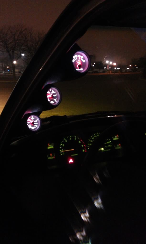

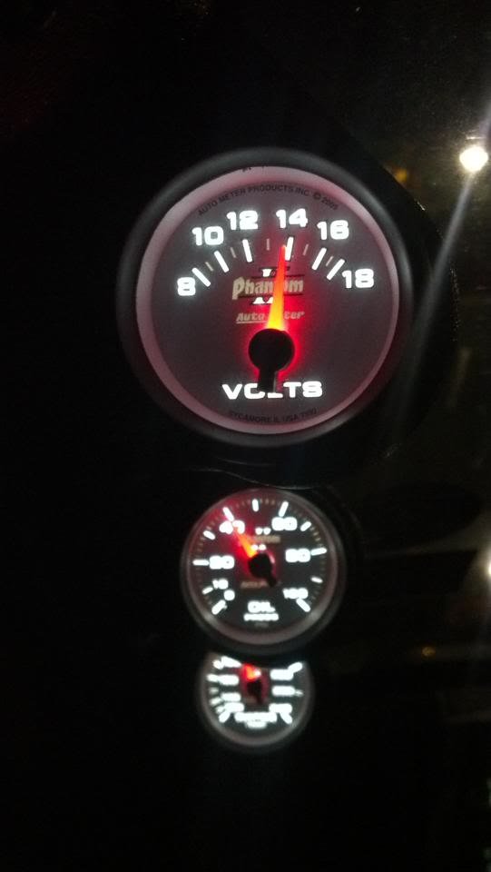

    Autometer Phantom II gauges

    For sure man, Cant wait to see your truck and do a little wheelin! We definitely need to get together, do a little wheelin, and shoot the shit. Just tell Tyler to give me a call when you're in town.
    And im diggin the new gauges:cool:
