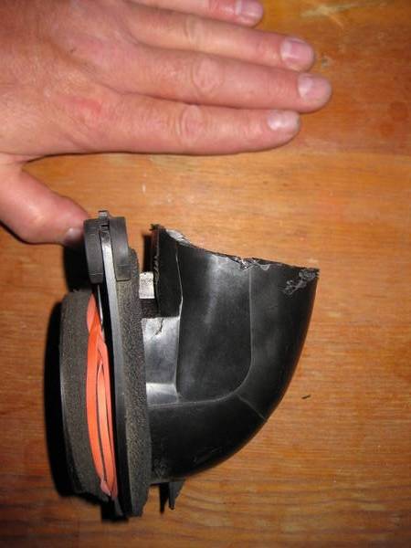

    This is the elbow-the original length of the snorkel came to where my index finger is

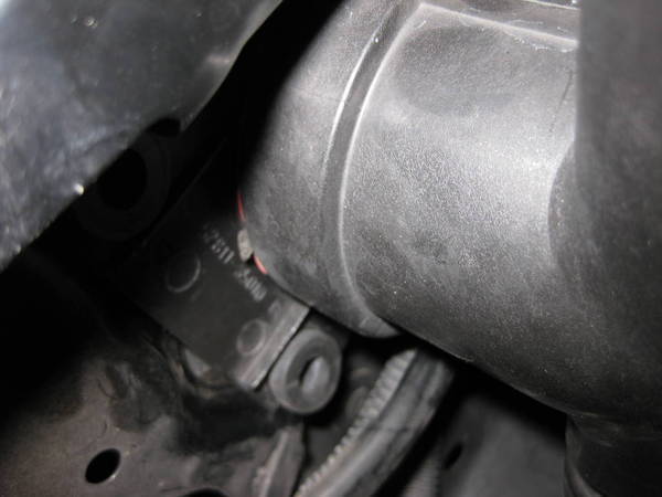

    This is how it will set inside the fender with the opening facing the front of the truck
    as you can see it sits now opposite from original

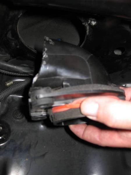

    sets very nicely that way

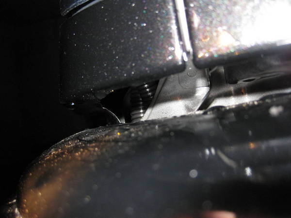

    It now gets fresh air thru the gap here (and ambient in fender)

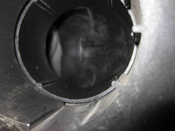

    This is looking at intake from inside the airbox-as you can see it now gets a better dose of air
    and the ECU learned this very quickly- my truck feels happier.
