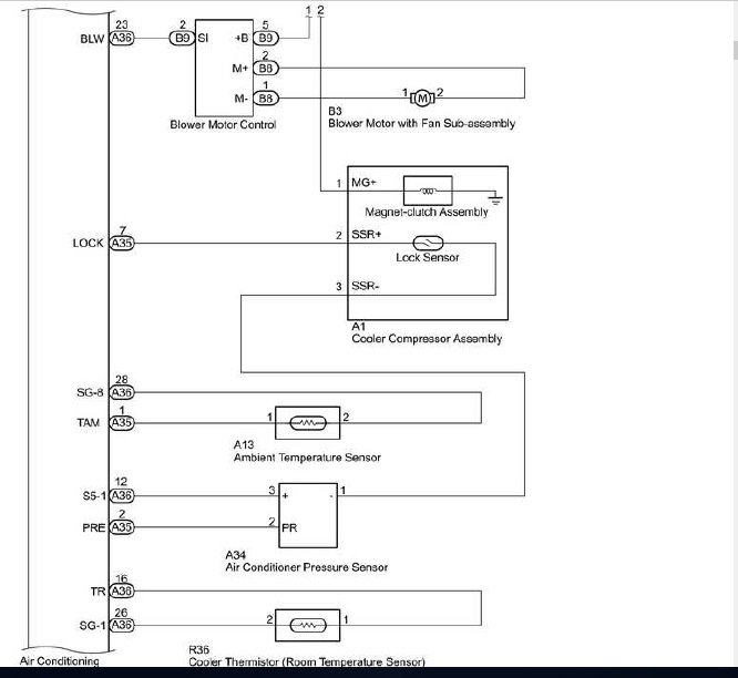

    My heater starts heating in less than a minute after a cold srart. Some time ago, I read that there is an electric heating element somewhere in the system for cold starts when you want heat.
    Is this true?

    If I am not mistaken someone posting a diagram that had a small electric heating element over towards the passenger side of the dash, again not sure what circumstances it comes on though.

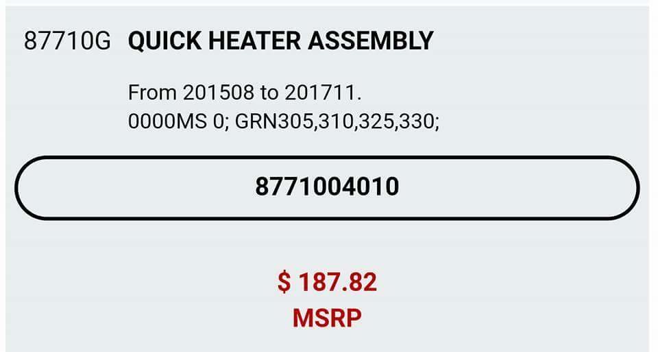

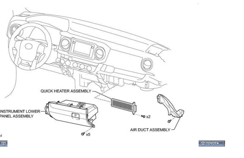

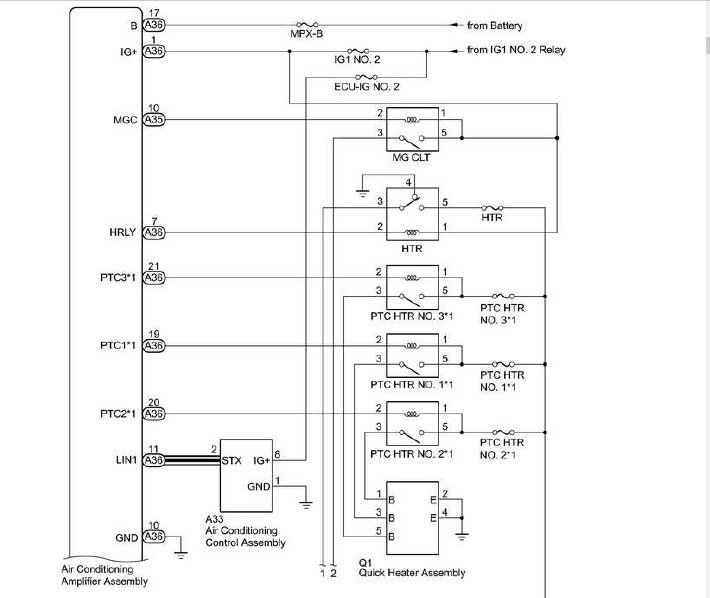

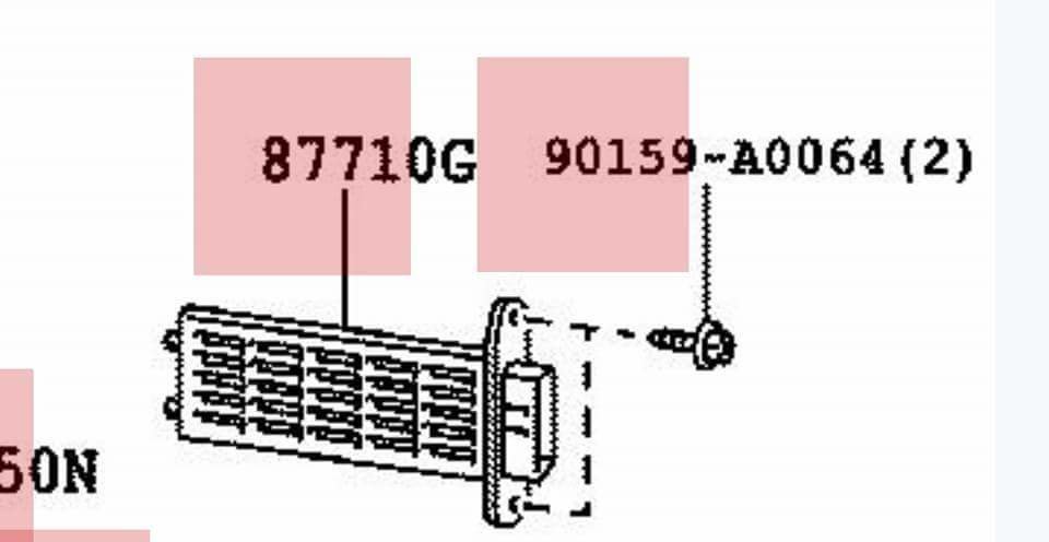

    Yes.
    Service manual calls it the "quick heater" or "PTC heater"; located behind dash on passenger side.
    -Engine running
    -Blower switch on
    -Temperature settings: MAX HOT
    -Engine coolant temperature 65°C or lower
    -Ambient temperature 10°C or lower

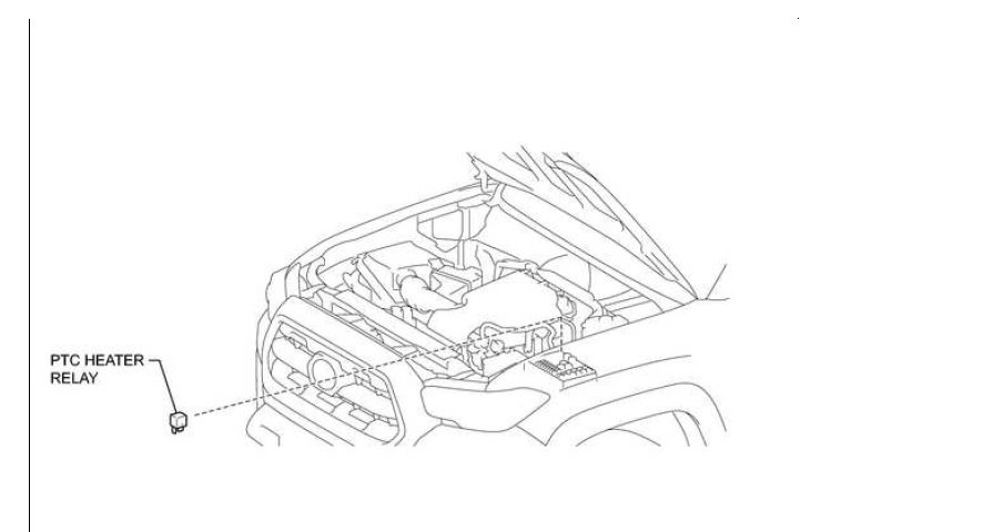

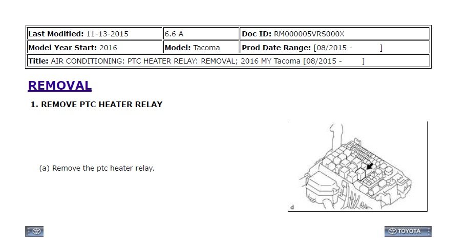

    Supposedly all V6s have it.
    Look for the PTC relay in the fuse panel under the hood.

    Thanks guys. I think I found it
