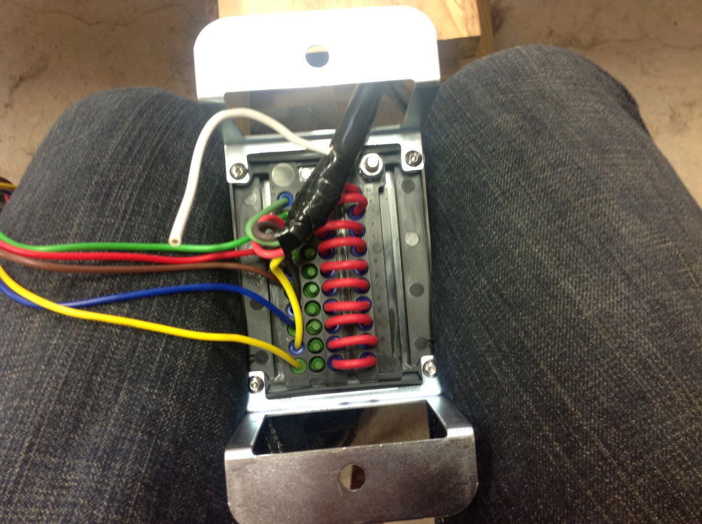

    i Built my own custom relay box from a Bussman box. Cost WAY less. And i built it :D
    Yea..too much money for me..haha

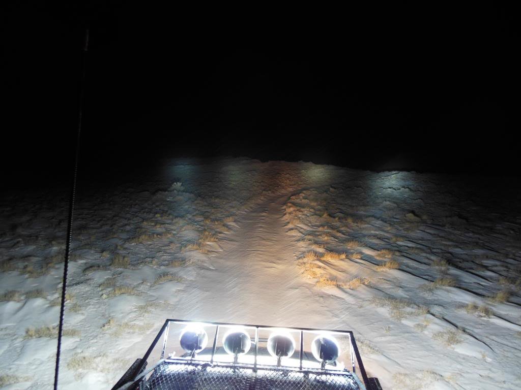

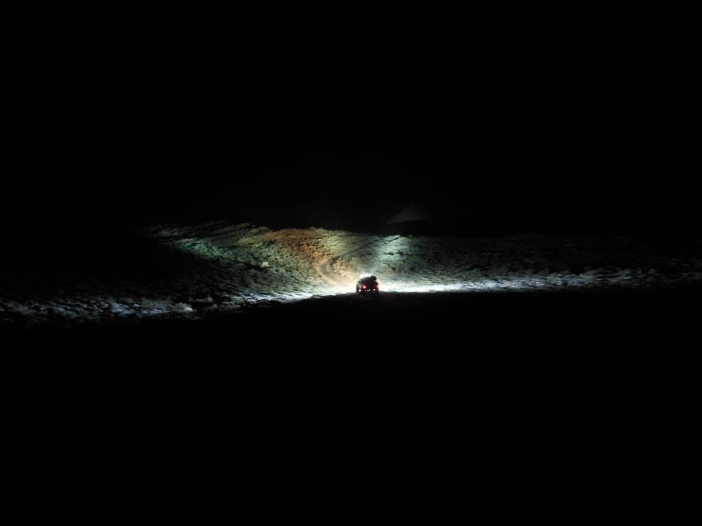

    OP: here is my setup
    Technology is your friend. Use HIDs for long distance lights. They draw less power and are brighter then halogens.
    LEDs for fill lights. Draw even less power but can't compete with a big lens light...yet. Give them another few years.

    I disagree. Offroad LEDS are ridiculously over priced. I can get some hella 500s and HID them and it'll be way way cheaper.
    I do believe LEDs will catch up in performance and cost. But now..no way. To get the same output of my HID Hellas I'd have t get a 40"+ LED bar..very expensive. Paid like 150 for my 4 Hellas already HIDed..

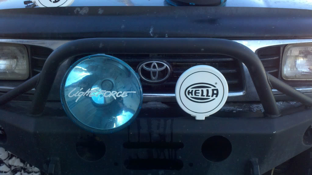

    Here is a comparison
    The Hellas are n my roof now.
    The 240s would cause sooooooooooo much drag. And are so big that even if they folded back they would stick up super high.
