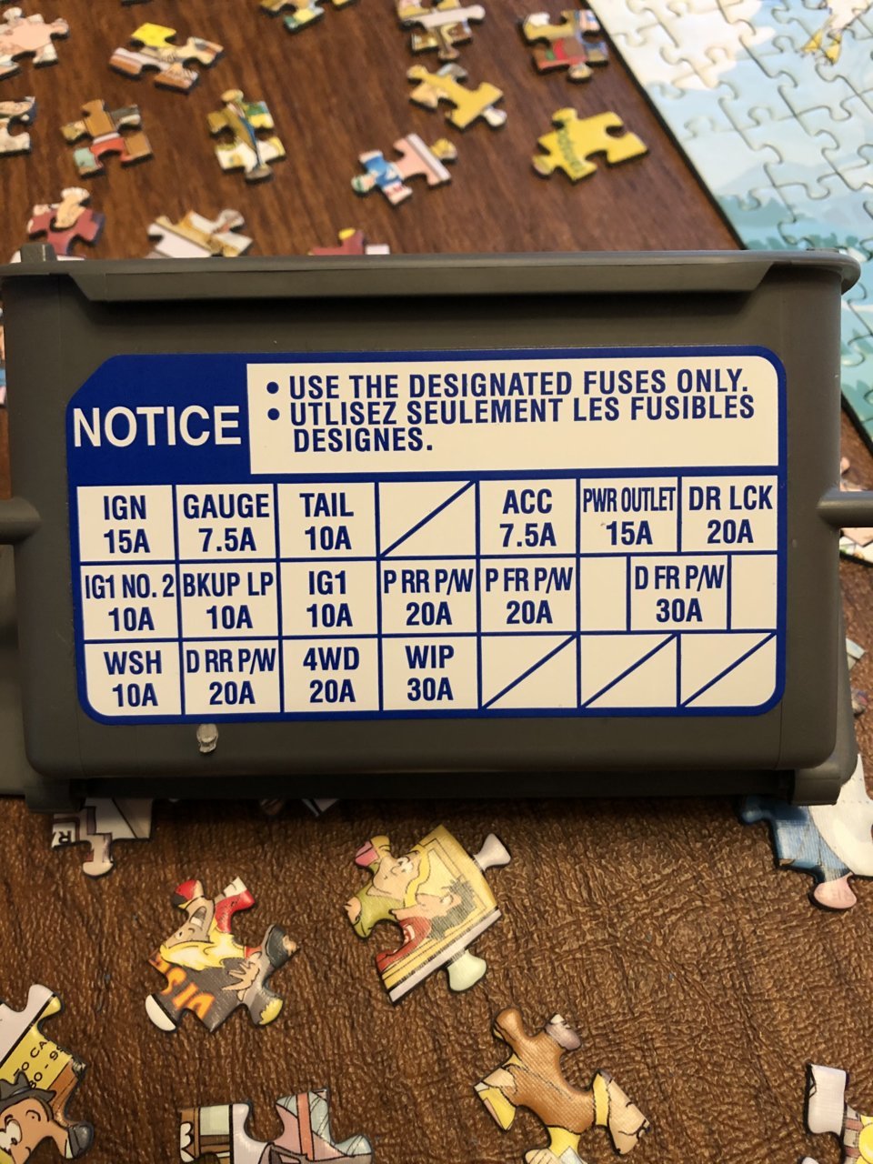

    What about 35? Is the cigarette lighter switched or constant in the 2015s?

    This is what I have available.
