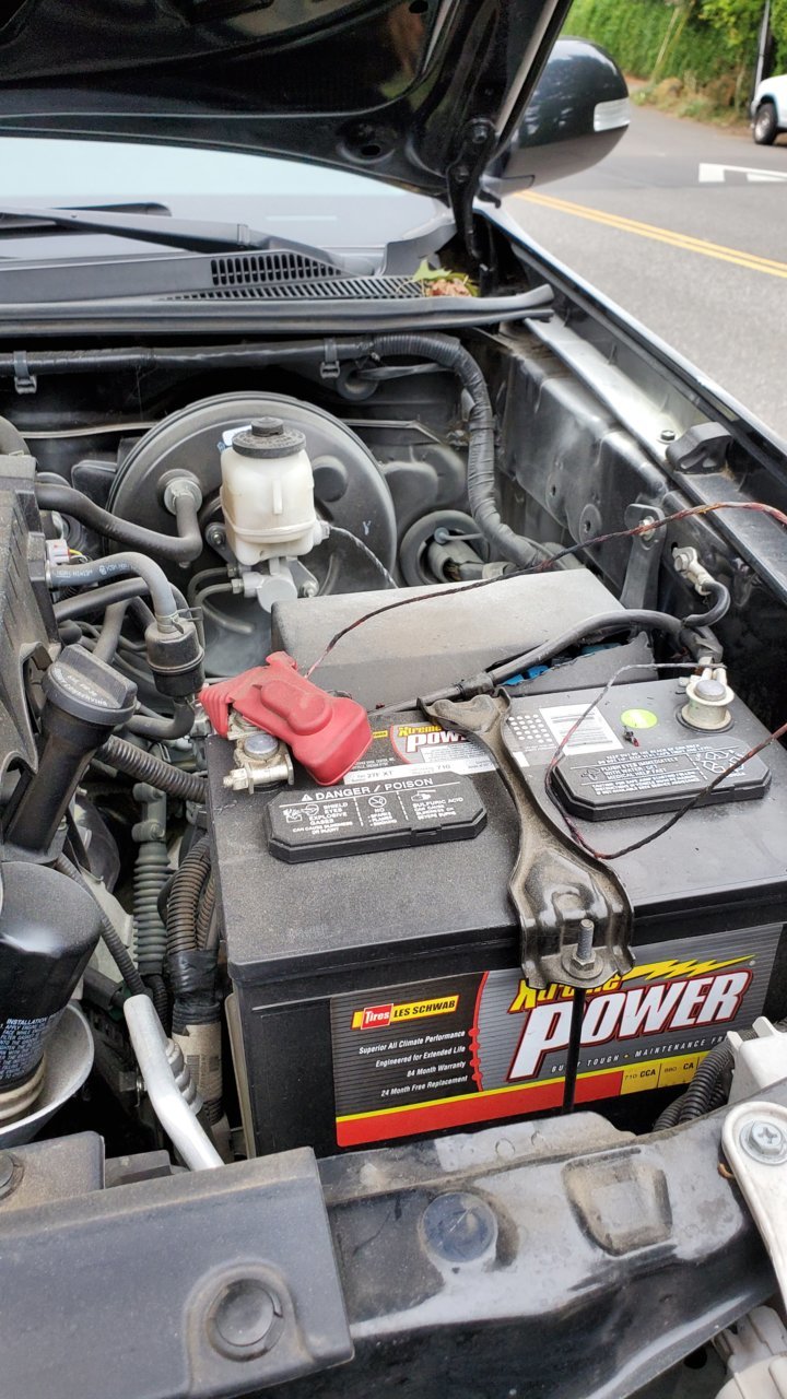

    Hi all,
    I had an electrical fire this morning and it started on the small wire that came off my positive battery terminal. What is this wire connected to?20190902_094818.jpg

    7,489
    That's something that somebody added without a fuse.

    12,025
    Just cut it and shorten it as far as it goes. It's no longer live.
    Get it off the negative terminal first though haha.

    2014 Tacoma TRD Sport
    Thanks for the reply. It ran down along my fender and underneath. Not sure what it would go to... is it a factory deal? Would that be for my canopy light?

    Fox/Dakar with Relentless goodies and stuff
    Aftermarket lights, alarm, or powered sub? It's not factory.

    12,025
    Do you have a brake controller?
    Most canopys tap into the brake lights.
    The only aftermarket electrical I have are trailer lights and canopy light. Figured trailer lights would be connected at the rear.

    7,489
    As I mentioned, someone added that wire for whatever purpose they needed power. It was stupid and irresponsible for them to not put in a fuse near the battery. You're lucky your truck didn't burn to the ground.
    Could be either. If you had a aftermarket 7 pin trailer harness installed they could have run the power from there. Does the canopy light still work?
    As mentioned, a properly sized fuse near the battery would have prevented this.

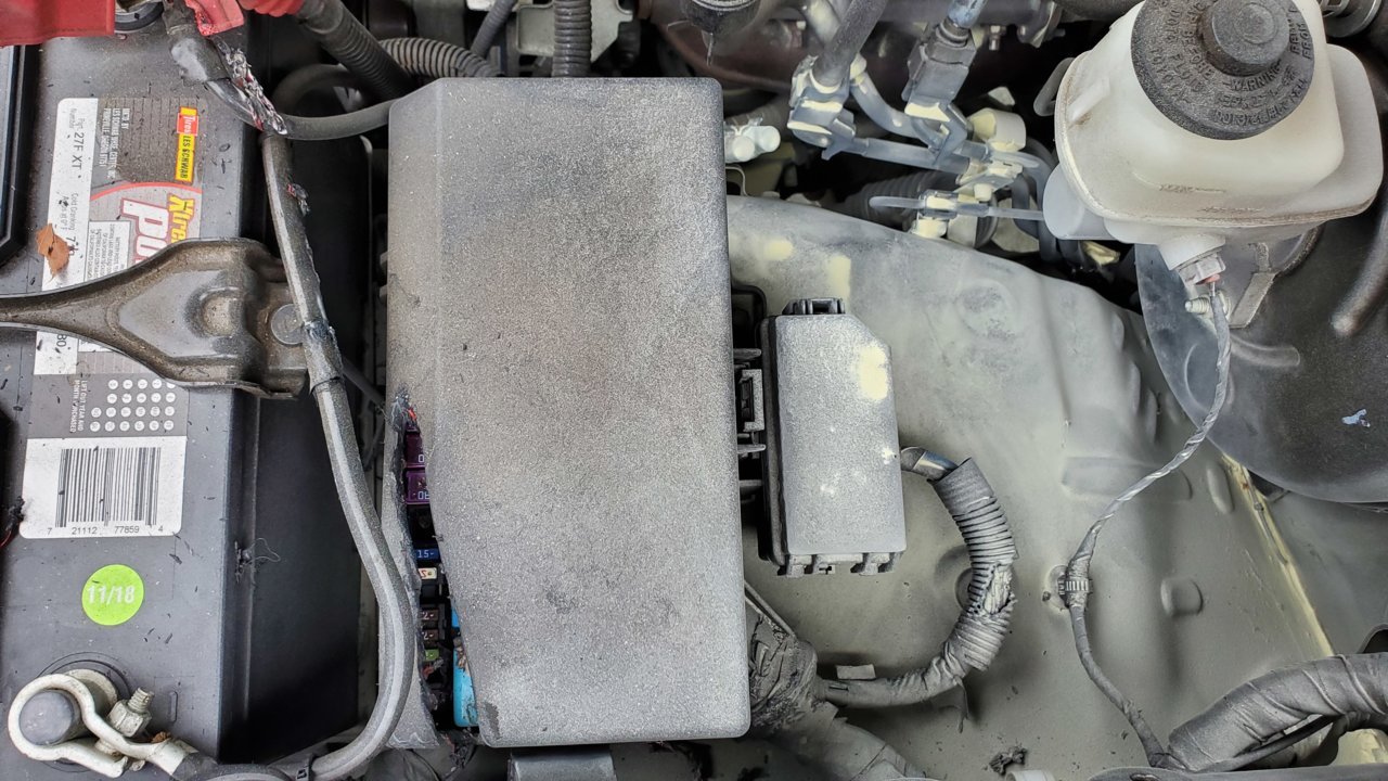

    7,489
    Looking closer at that 2nd pic, I see there's a lot more damage than just that 1 melted wire. This may end up being something you want to turn in on your comprehensive insurance. Depending on what your deductible is, it may be worth it in the end.

    7,489
    Having it at a dealership, this is concerning. It wouldn't surprise me if they say, "we need to replace the whole wiring harness for $2900".
    A competent repair shop could cut out each damaged wire and solder/heat shrink short sections of new wire in.

    5100s, Wheelers AAL, Leer 100R
    That wire could have been for a remote starter too, previous owner of my wife’s CRV had one of those wired straight to the battery like that. Maybe in your case they wired it in and removed the hardware before they sold it. Who knows.

    2024 GMC Sierra
    Probably goes to the powered converter for your trailer lights. Even if it’s a 4 pin, some will still use a converter box.
