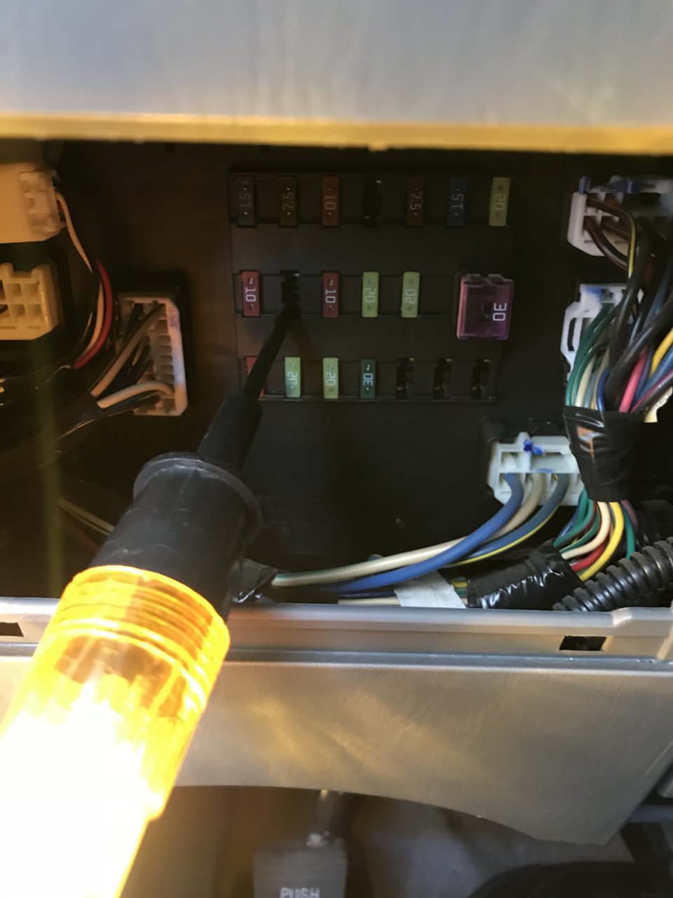

    while installing my USB charger I tested this blank fuse which is powered with the ignition on. Can anyone tell me if it can be used?

    Yeah you can use. Just get to the back of the panel and find the wires for that fuse and use them

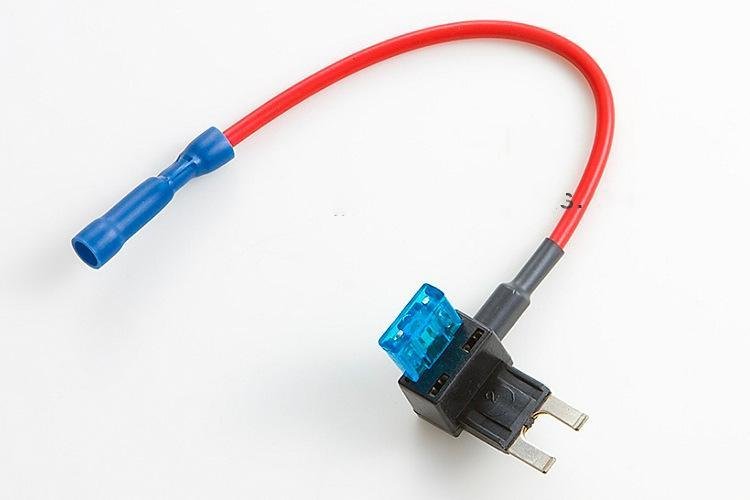

    Could always use a fuse tap
    b_r_o likes this.

    There is no pin hence no wire either to use (connector 1H behind the fuse/juntion box)...add-a-circuit would be the way.

    This particular one is on when the ignition is on only. Which is fine because I’ll use it for lights or CB radio.
