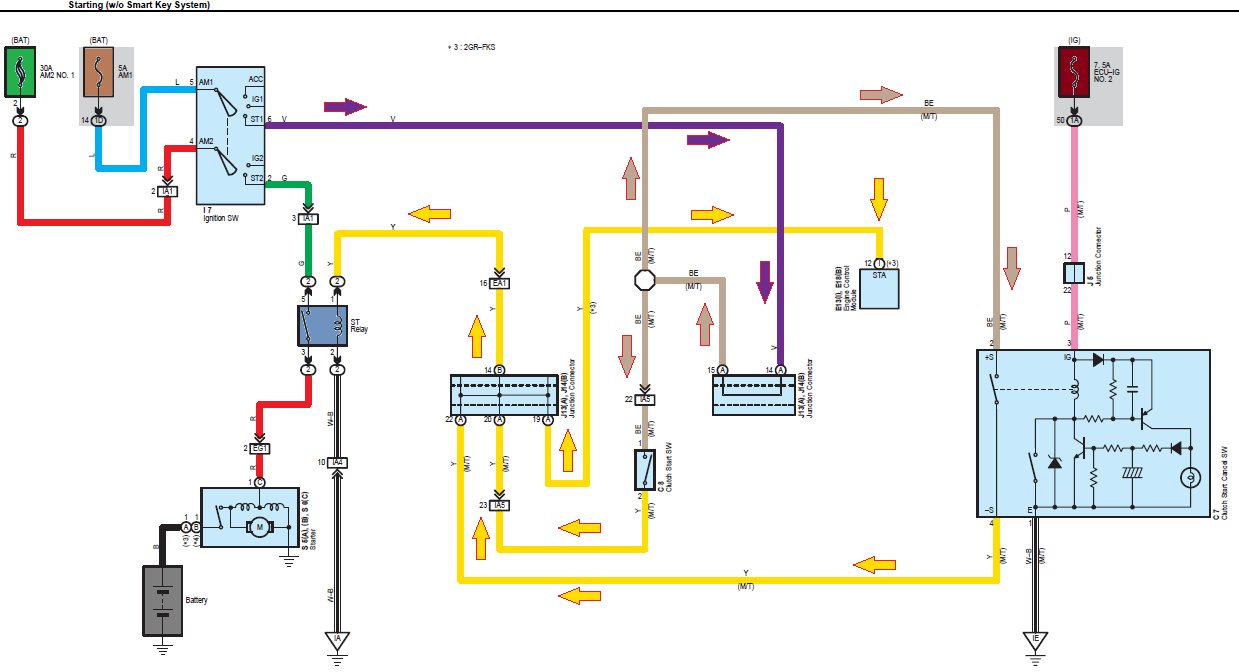

    I totally agree with you on the safety aspect. I meant more about the computer. I wouldn’t run it with a normal on off switch. And a momentary by it self it totally annoying haha. I’d go relay...
    I drew up a crude sketch of the circuit I think would work in paint :anonymous: if anyone wanted to visualize what I was thinking haha

    What I'm not clear on is how you all seem to mention using the beige (+S) and the yellow (-S) to get this working, but no mention of what to do with the pink wire that links into the ignition. Isn't that the wire that sends the signal to the ignition and allows the vehicle to start? What is the purpose of the IG wire in this schematic?

    I’m thinking the ecm is looking for the beige and yellow to be connected, prob some kind of pull up or pull down circuit. The ign wire only provides power for the circuits in the switch that are lighting the light and holding a “relay” closed until the power is removed. Instead of stuffing a mechanical relay inside the switch their using transistors for that, prob why it’s only 1amp fuse. And then the B/W is just ground for the light and circuitry.

    I could be way off with all this but that’s what it looks like. The beige wire is prob a 5v ref from the ecm and the yellow is basically ground. So when you put that reference voltage to ground it tells the ecm that switch is pressed and bypasses the clutch switch.

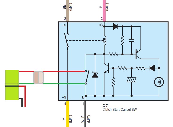

    that would be awesome to find something that doesn't require me to hack apart the OEM connector. I made a custom ch4x4 button that clearly indicates the function, so no problem there. The rest seems like a lot of work for someone to produce for minimal demand, I mean I think I might be the only one lol. I did not find any threads in my searches that indicate someone else was trying to do this. But as usual, you don't know you need it until someone says they make it lol.

    Your diagram indicates part 90980-12113 which might be this
    https://www.toyotapartsdeal.com/oem/toyota~housing~connector~f~90980-12113.html
    But I'm not sure if that's the wire harness side or the switch side. It'd be ideal to have both M and F connectors so you could build and test a T harness. You can accomplish the same right now with T taps and then try out your momentary switch. If connecting yellow and beige produces the desired effect on the OEM switch and behavior then you can keep the OEM switch hidden in the dash and use your momentary to get the job done. Possibly even tapping into the pink and ground for illumination if that works too? But I think the OEM switch has some special smarts on the illumination side and that might be more work than you'd want to deal with.

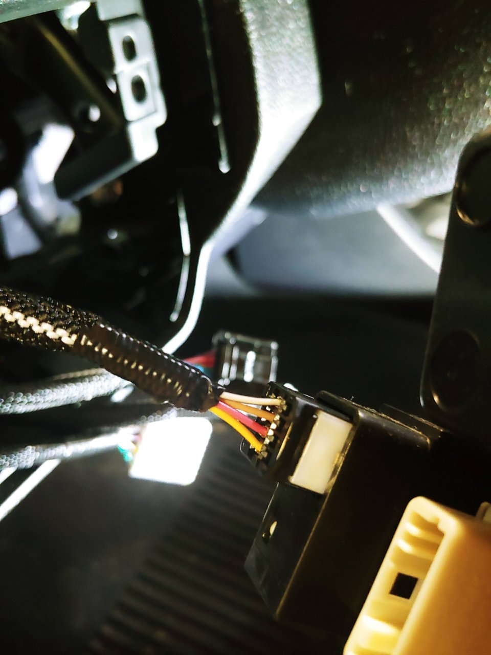

    Could you post a larger photo of your switch? Kinda looks like a gargoyle to me in your original post.

    yep I think this is going to be my plan - I'm going to tap the factory wiring in the least invasive way possible to see if I can get the ch4x4 switch to work. You all have helped me immensely here. :muscleflexing:
    Here a picture I took of the connector, it probably doesn't help a whole lot to get the answer you were looking for.

    Unless you can come up with a way to tap the solder pin of the board...

    LOL just when I thought I had figured out that switch diagram, you throw this in here and I realize I will never understand electrical in modern vehicles.
    This is very helpful though, thanks. I am going to try t-taps on the beige/yellow later today and see what I end up with.

    Look closer, you need to bypass the physical switch, to get the original switch to function correctly. Remove beige wire, connect to added switch. From added switch solder wire to OEM switch (internal board). In essence you'd be placing the physical switch as a remote one.

    So similar to the garage door opener mod. Extract circuit board. Solder two leads. Connect connectors. Install.
    would be ideal to attempt surgery on a 2nd switch or have a source for a replacement ready in case of failure.

    Sorry I'm slow on the uptake here. If the yellow cable ties directly into that pin on the board, why can't I tap the yellow and get the same behavior? This is probably just a gap in my technical knowledge. I can solder but yeah, I'd want to do it on a spare switch.
    It might help to mention that I don't really care about retaining use of the original switch. I'm hoping to bypass it if possible, but retain raw functionality. While also keeping the possibility of going back to the stock switch some day lol. :laugh: Is that asking too much? :laugh:

    You have him bypassing the dry contacts. In essence, he will still need to hit the OEM clutch cancel button and then the aftermarket button.
    The physical switch is next to the zenner diode on the diagram.

    OP, since I had to look this one up, seems that a zenner diode allows current to flow backwards “sometimes” and is used for voltage regulation. I assume it’s the triangle facing a squiggle line rather than the regular diodes represented as triangles to flat lines.
    So the OEM switch seems to be acting as two switches (DPST) and that may be where we do need a relay to make this happen? The switch near the zenner relay closes to ground while the other switch between the two wires closes to what I assume is +12v?
    OP, see if you can find one of these switches somewhere as a first step? Might be possible to order from a dealer and maybe not even insanely priced but who knows.

    What about the switch at the top left? Not needed?

    It's an internal one. I haven't disassembled one...The drawing makes it as an internal relay.

    It's not a switch. It's a set of dry contacts that is closed by the coil when you press the switch (push the button in).
    Technically, the OP can just hook up to the beige and yellow and it will work as long as his aftermarket switch is ON/OFF and not momentary.
