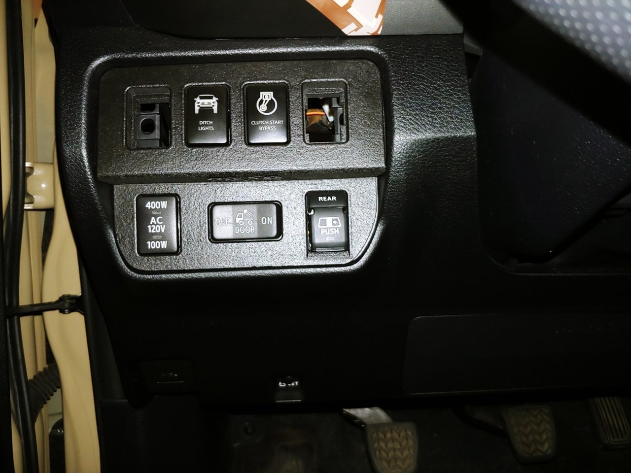

    Just to tie this thread up for anyone else looking to do this, I tapped the cargo light switch for illumination and it works great.
    Ch4x4 red 2 to green on cargo light
    Ch4x4 ground to tan on cargo light
    The switches were a little loose in the meso panel so I dabbed each with some hot glue and all is great now.
    Now I can finally hook up my ditch lights and have two extra slots for fun things. :cool:

    2021 Tacoma OffRoad DCSB 6SPD BRM
    dumb question but is there any kind of plug and play solution for this? im having a hell of a time trying to figure out how to get this bypassed for my remote starter to work without me having to press the C/S/C button manually
