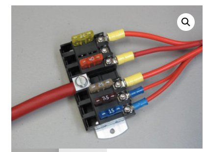

    Does anyone have a central hub for all their light bar wires and such? I’m sick of disconnecting my battery and stacking another wire onto it. If I could just have one going to it and have a hub for all of them that would be great, let me know!

    Yes, you're looking for a spade fuse block:
    This one has a larger than necessary input line, but you get the point.
    I have mine mounted under the dash, so that only one line passes through the firewall.

    The Bussmann RTMR is quite popular. I had one on my Tacoma and just ordered one or my Tundra.

    I installed a 6 relay and fuse sub panel that is only powered when the truck is ON so that even if I leave the off road lights, winch etc toggle switches ON when I shut the truck off all relays open so that the battery doesn’t get drained.
