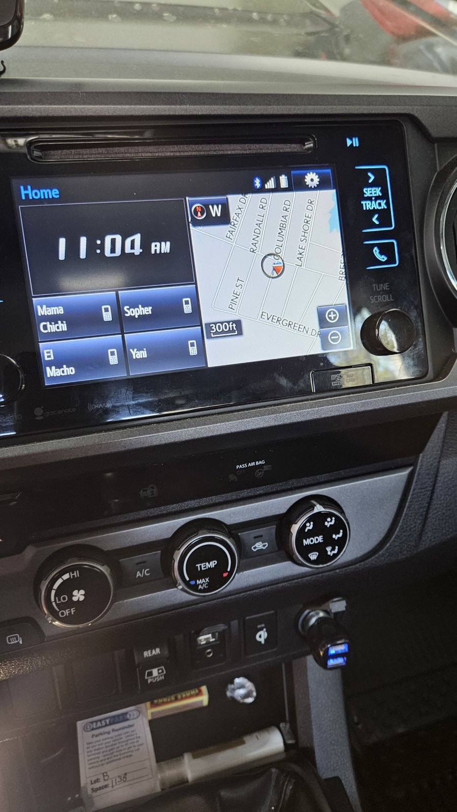

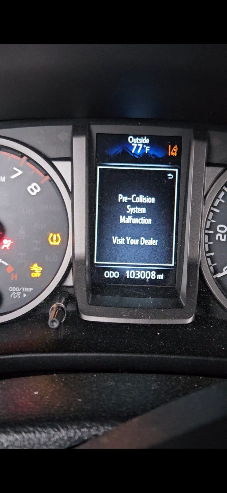

    Advice! I installed a new radio on my truck. Radio didnt powered. Now few messages are displaying; departure lane, collisions, tire pressure not working, AC panel control, lighter plu, usb not working. I have check fuses with not luck. I am not a tech savvy but thought it was going to be plug n play easy process. Any advice on how can I fix my mess are welcome. Thanks

    Aftermarket or OEM radio?
    I'd suspect your ECU-IG No2 (7.5A) fuse in the interior fuse box is blown.

    First and most, Thank you so much. It did fix the problem.

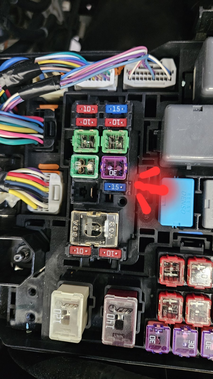

    Now any advice on how fix radio, usb not powering. Which I am guessing there all connected. I checked fuses under the dash it seems to be working. Under the hood they dont seem blowed but when i test them there isnt light coming from the fuse test. Again, thank you

    #15 it seems the one working

    Just the std radio. I appreciate your time and help.

    That's the fuse for the reverse lights.

    Good morning, thank you for the message checked the fuse....that didn't solve the problem. Thank you for ALL your good advice.

    Are you sure it got plugged back in? Those wires have a tendency to fall back into the dash when removed. Also, which USB ports aren't working? The media port under the climate control or the charging ports in the center console? Just want to clarify.

    Since the radio is not that bad to remove, I would pull it back out and make sure the plug clicked into place. And did you get the maestro RR to keep the majority of the factory settings?

    Stevie, I got the radio working. It was the fuse was hidden on me. Thank you for looking at my post. Have a good Sunday.
