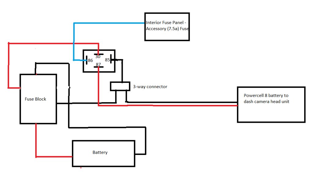

    The dash cam battery pack is wired from a 4-pin relay with a power coming off the BS fuse box, going out to the power, signal coming off an ignition powered add-a-fuse, and a ground. The power and ground coming back from the relay to the battery pack are tied in directly and from there, an accessory, power, and ground go to the camera box which powers all three cameras. I noted that when I removed the add-a-fuse and signal source from the dash cam battery, the other accessories appeared to work. I figure there's a short in the system and start pulling things out so I can look for loose wires and whatnot but didn't really find anything. After checking all fuses, wiring, and switches, I start with the dash cam battery pack and test just that through the fuse box with nothing else connected to it and sure enough, as soon as the signal gets power from the key being turned the ground was lighting up again. I decide to replace with a new relay of the same kind, since they came in a pack, and again the ground bar is showing a current but this time when I run the meter over several of the ground points, I hear a sound from the relay and the battery starts actually pulling a charge, dash camera starts up like it's working fine, and the current is gone from the ground bar.

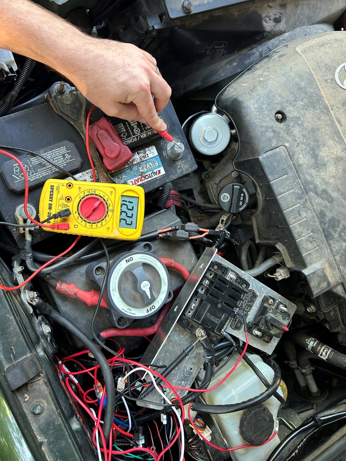

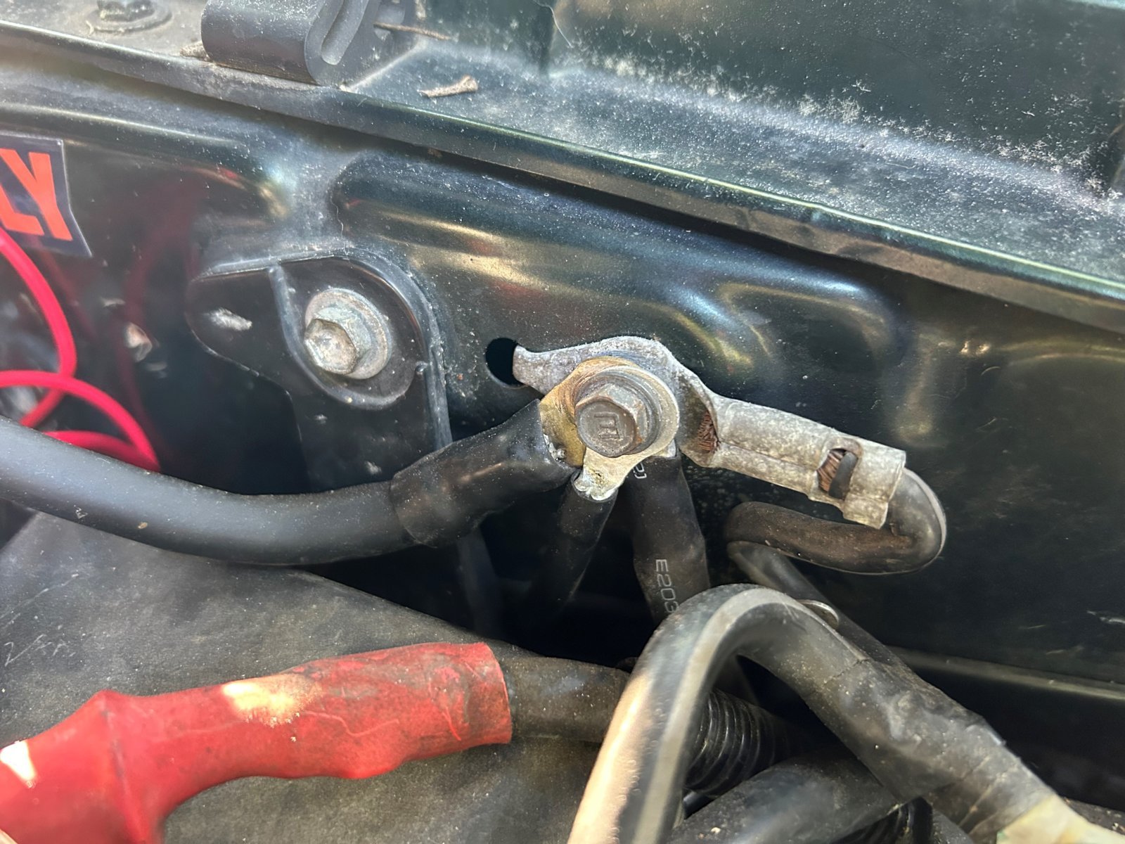

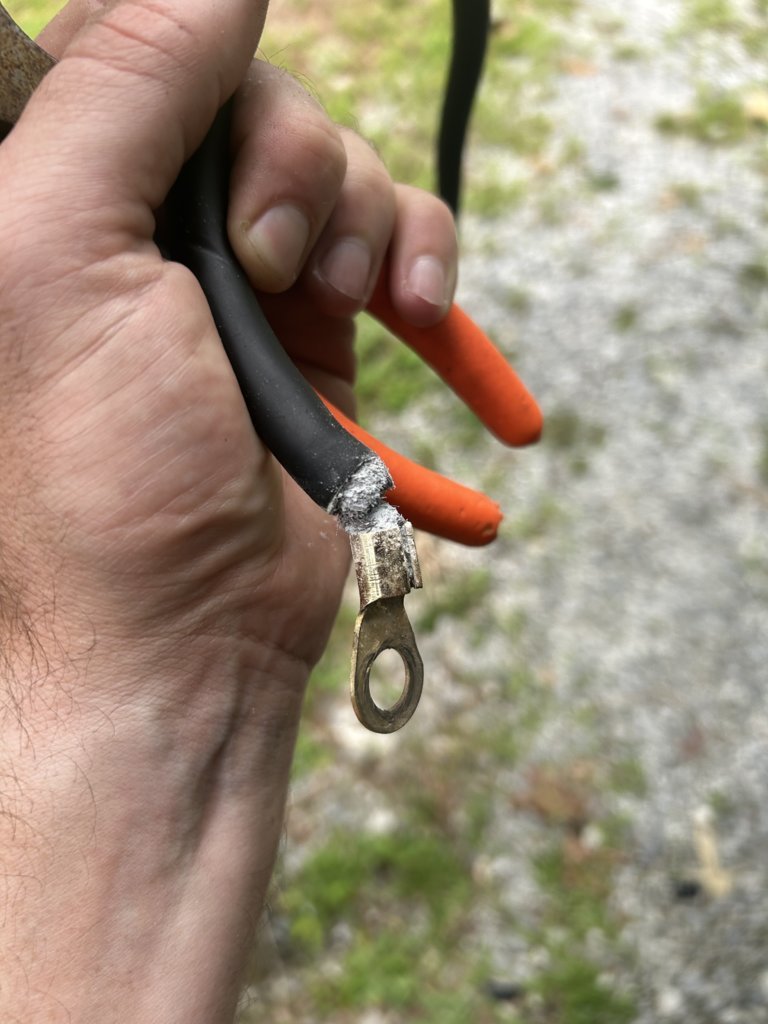

    This is great stuff, I do have a volt meter. I didn't see a reading while touching the leads together under 20v DC unless I'm misinterpreting what you mean there.
    I'll throw a photo in here as well but I checked the battery and got 12.23 volts when set on 20v DC. Then checking the ground point on the chassis next to the battery, I got the same voltage on the bolt but did see a drop to around 9.5v on several of wires that connect there. I don't have the BS fuse box fully connected right now but I attached the ground, which comes off that chassis point and the battery, and got 12.22 volts on both the lug on the fuse box and the ground connectors for the accessories.

    The 12.2 volts measured on the BS fuse box was measured to the battery + ?
    The 9.5 volts on the other wires indicates a poor connection. I’d take the screw out of the ground to fender and clean all surfaces that contact each other (except for the painted inner fender surface… we don’t want that to rust). Both sides of terminals connecting to fender, and just the part of the bolt that faces the fender. I like to use green scotch bright for cleaning connections, but sand paper, emory, etc works. Then recheck where you measured the reduced voltage. If still 9.5 V you might have a bad contact elsewhere or a bad crimp on a wire end.

    Yes, measured to battery +. I'll definitely scrub the connections when I get back from work and check again.
    I'll also stop by and see if I can find another 4-pin relay from advance auto just to have on hand. Once I get things cleaned up, my plan was to wire up each accessory individually to see if any issues arise with vehicle off, in accessory, and with ignition on. I read that it's also good to test with the vehicle running in case the extra load from the alternator is causing an issue on each circuit but that will be touch with the birds nest of wiring that I have everywhere currently.

    The issues with other accessories would depend on if you have them riding on the same circuit or if each one is on its own isolated circuit. TBH, it's hard for me to help without seeing a circuit diagram of how you have your connections. I'm a visual learner. I'm sure someone with more electrical knowledge could help you. I typically run each accessory on its own circuit so I don't run into this kind of problem.
    This is how I run my accessories:
    Fuse tap for IGN +12v --> Trigger (pin 85 or 86) 12V SPDT relay --> pin 87 goes to Fuse box power source --> accessory power input
    Depending on power draw, I have a secondary wire from that fuse box that goes to another relay for another acessory.
    Current is drawn, so accessories don't "send power", but draw power. So, think of it like a tree. The trunk is your power source of power. The leaves are your accessories. If one branch is broken (short), then that accessory no longer works. However, the other accessories should still function if they're on their own branch. If you have accesories tied to the same branch, then you could experience issues because of that branch.
