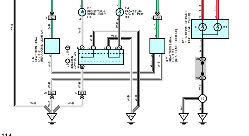

    The Green/Yellow wire is the power wire for the Passenger Turn Signal.
    The White/Black is Ground.
    You will have 2 White/Black wires on the Passenger side.
    One comes from the Left tail light. It will not have a ground with the Right side unplugged.
    You'll be check Pin #1 for power, and #3 for Ground.
    You can't use amps to check the circuit.
    You need to set the meter to DC V.
    Better yet, I'd use a test light. If you have one?
