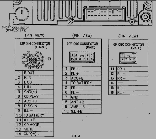

    My hypothesis is a bad crimp/connection either on the ground or the constant power. It could be at the stereo's plug (truck side), at the fuse box, and anywhere along its path where there's a electrical plug. The pins would need to be removed from their plugs to be able to inspect them.

    You could rig up a temporary wire for the ground, grab a wire and go from the head unit's case to ground, if the problem persists then you know there's probably nothing wrong with the ground wire in the plug or at the location where that wire gets its ground at.

    You can do the same test with the constant power (labeled TO BATTERY on schematic) as well, use a fuse. I would do the ground first.

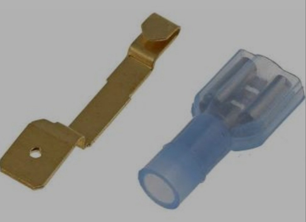

    I don't know if you bought your truck new or not but some fuse taps are thicker than fuses, a previous owner might have used one, removed it when they sold the truck, and reinstalled a thinner fuse. Just telling what I've seen in the past is all.

    It was bought new... and I have a couple fuse taps in use up under the hood for the trigger wire used by the switch pro. Hmmm.

    I've never seen a problem with this style.
    I have seen problems a few times with this style but only if the fuse tap was removed. The fuse tap spreads out the terminals and when they're removed and a fuse put in their place they can have connection problems.
    It sounds like yours are still installed. I've never seen a problem with either style fuse tap when they remain installed.
