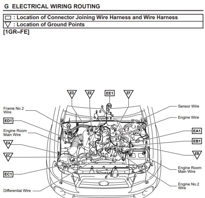

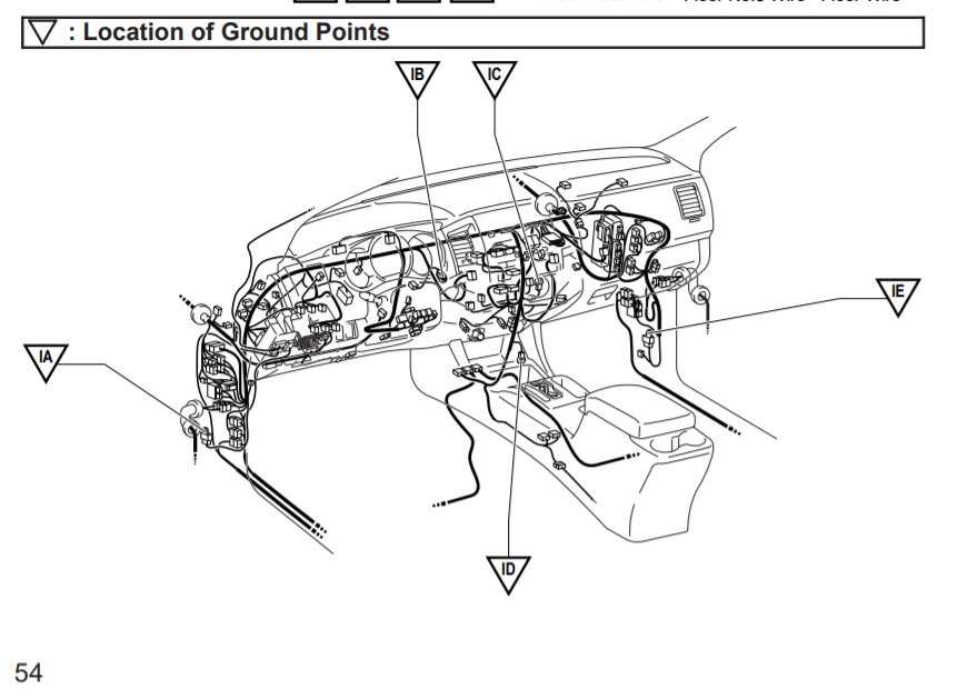

    These may help you pinpoint where the grounds are located:

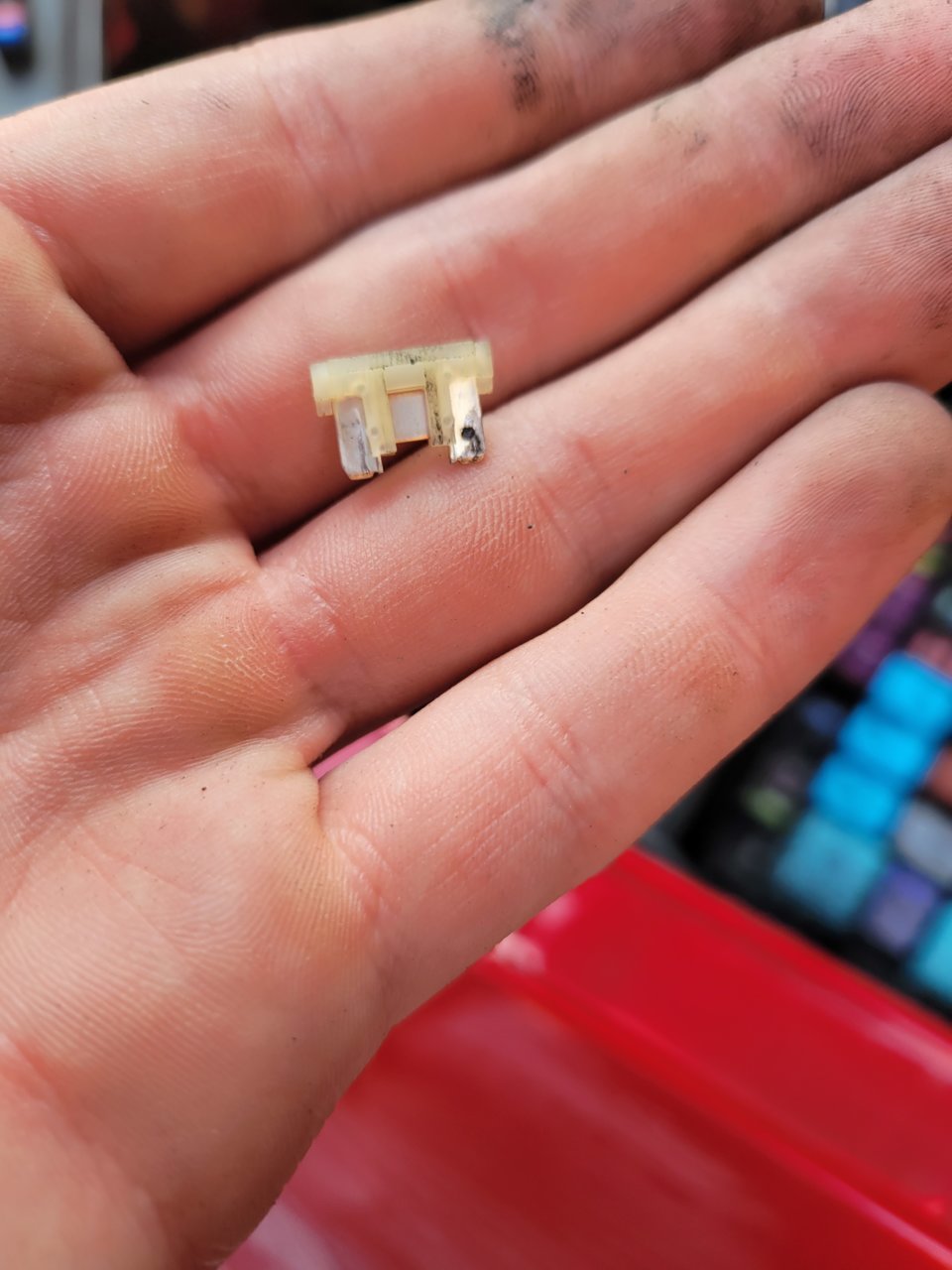

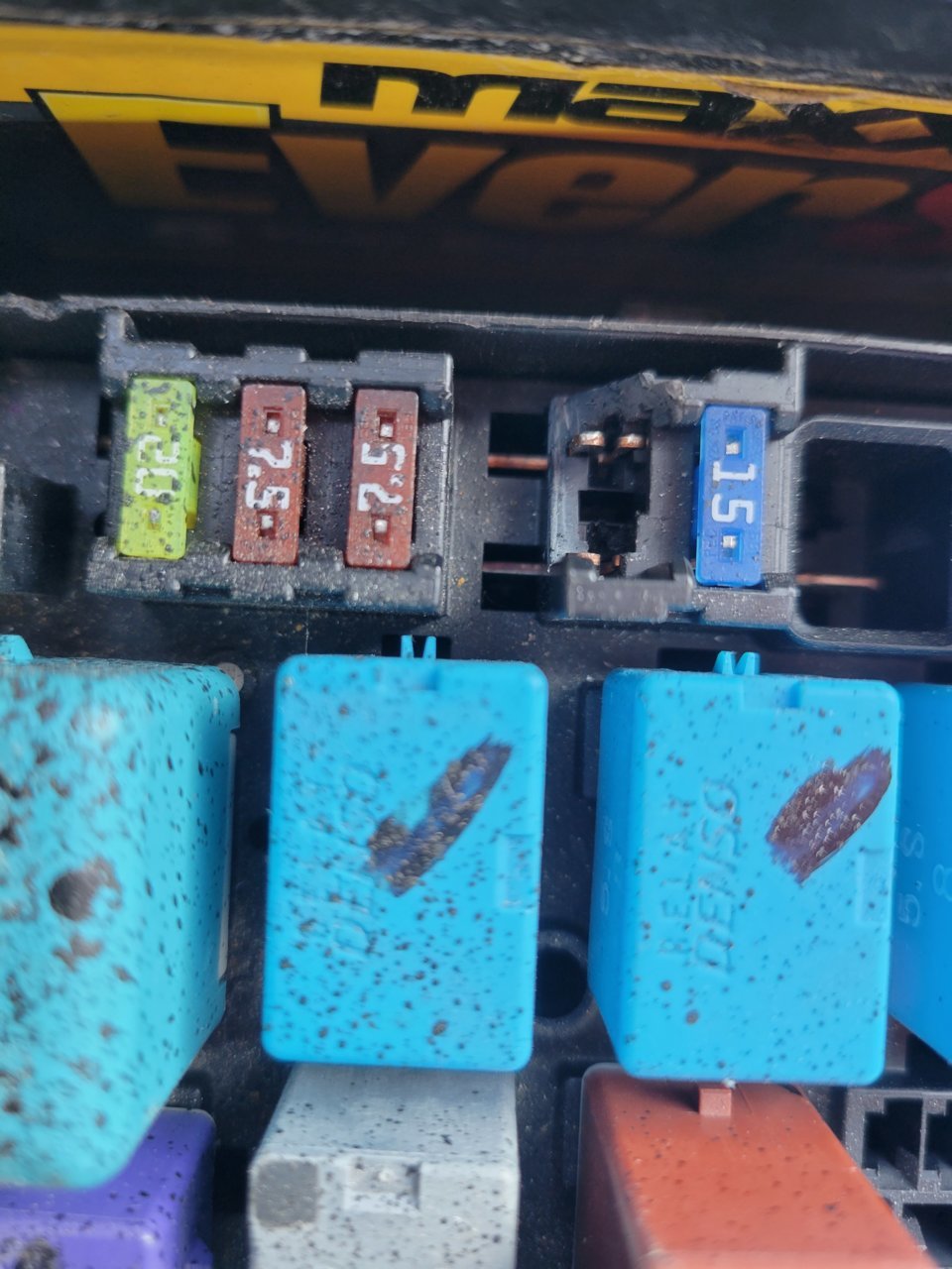

    I was able to replicate the issue by removing the short pin fuse:20210722_181909.jpg 20210722_181922.jpg

    Nice find, file and tighten up the contacts a bit, new fuse and you should be good to go:thumbsup:

    That is not a fuse. It is just a shorting bar to connect the Radio, ECU-B and the Dome Lights to the power circuit.
    Looks like a burn mark on the right side terminal.
    It is removed during storage, transport and delivery to the dealer to prevent battery drainage during this time. It is installed at the dealer during delivery inspection.
    People have had issues with this being loose and causing problems when hitting bumps. Try and tighten the female connections in the fuse box. If nothing else you can locate or make shorting wire from a couple of spade terminals and a piece of wire.

    Thanks for clearing that up, looked like a fuse in the picture.
    Looking at the picture more closely it looks like a piece broken out of the fuse box where it belongs.

    Yes that is a piece missing / broken off and probably why it doesn't fit properly.
