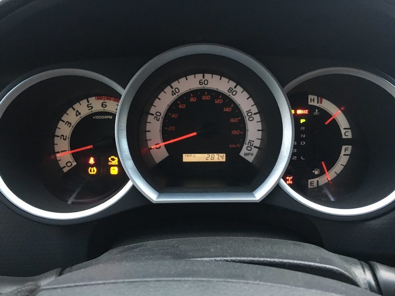

    So I was driving this morning and all of a sudden, all these dash lights go on, along with the speedo becoming none reactive. No noise or other jolts.
    I have the rpm, fuel, and temp.
    All fuses I checked seemed to be fine.
    Ideas?

    Abs, e brake, "4wd" icon in the lower right, check engine, trac, tpms light. I didn't not have the seat belt on at the moment of the picture, so that is ok.
    EDIT: power windows, backup camera and A/C don`t work either.

    Obd2 scanner read an error code P0500.
    It's either a wheel speed sensor failure or some part of the wire etc, or at worst case a faulty ecm.

    would a bad abs sensor, harness, ecm, blown ignition fuse, and/or some other problem cause my
    (abs, trac, ans speedo) and (a/c, heater, fan, and power windows)
    to go out all at once?
    i dont see how those two groups would be connected?

    Check the fuse with a meter. Every single one of those items you mentioned are tied to the IGN1 No. 2 fuse....
