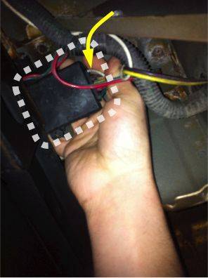

    The wiring between the frame and the bed of my truck is all original, and I think it's gone bad. Or crazy. I have no tail lights while driving, my console lights flash with the turn signal, and the turn signal cuts the cruise control. Braking stops the turn signal, but turns all rear lights on.
    I think the problem might be the corroded hitch plug (original) or this fuse/relay box:
    If it is, how do I replace it?

    Pull the fuse and relay for the trailer plug and see if the problem cuts out. Its under the hood fuse box btw
