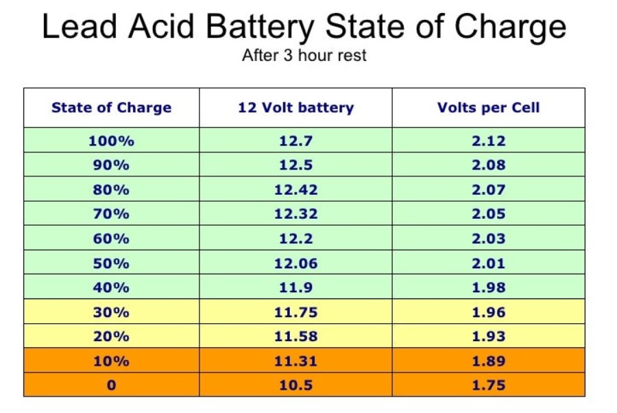

  5. Apr 8, 2024 at 9:20 AM
    RustyGreen
    Aug 12, 2020
    #337468
    14,515
    sleeping in a chair
    2017 AC 4x4 Sport 6M Inferno
    Pavement Princess
  6. Apr 8, 2024 at 9:26 AM
