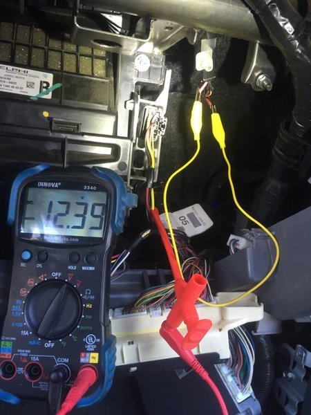

    Thanks guys, now I can continue my troubleshooting. So far I have finished testing and repairing the park/neutral switch and the PRNDL switch. Both were found to be faulty but I was able to bring them within spec with a through clean and grease. I made a spread sheet with the data I've collected so far and I will be updating it as I go.
    https://docs.google.com/spreadsheets/d/1s9eQcrGb9Pq6ePvd9Ev9uHsys6tmm8rMopJ9E6LmKlk/edit?usp=sharing
    Again I am following the procedure outlined in the link jimmyh provided here
    http://www.customtacos.com/tech.old...06toyrm/06toypdf/06rmsrc/rm2006ta/0280013.pdf
    As of now I have started testing the voltage on the ECM connectors and so far things are not looking good. P and N are constantly energized and R is getting no power. I still need to finish testing all positions but I will need to remove the ECM to get better access to the pins. That will have to be for another day. Any and all input is greatly appreciated.

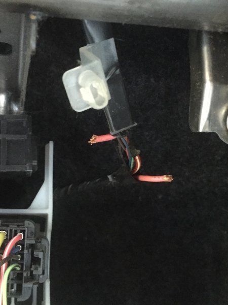

    I found the cause of my problem. It didnt take me long since this open circuit is near where I started. On the last pic of the diagram I marked the open with an X. I had good power up until the IH1 connector located behind the glove box. The open was a few inches down from the connector. Thanks for the help guys.
