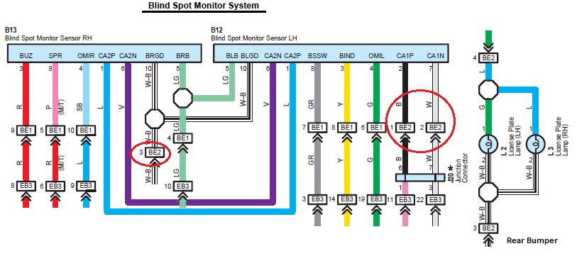

    Try this wiring diagram.

    @caribe makaira is the electrical guru here but I’ve attached the big file that I found here previously.

    Seems you might have a big issue on connector BE2, since it handles the CanBus circuit and shares ground with license plate lamps.
