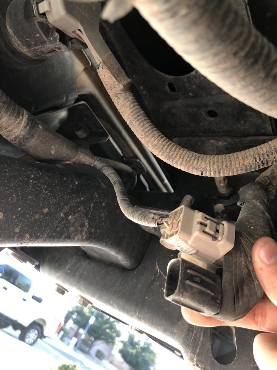

    Been having an electrical issue come up lately, when I get into choppy bumps the truck will shut off for half a second.. whole dash goes dark and no response from the peddle. Quick look at wires and connectors and everything looks fine except for the one in this picture. I have no idea what this plug is for or if it even relates to my problem. Any help would be appreciated!

    Could it be a loose battery cable?

    Have you installed anything involving electrical? Have you checked the fuse, it may be loose or going bad..

    Wiring that small (as in your picture) would likely blow a fuse before taking out the whole truck. Sounds like something loose or chafing elsewhere.

    With the engine running tap on the EFI relay with your fingers if the engine stalls replace it.

    Thanks for the responses! All of these things check out unfortunately.. these all would be easy fixes. I thought it was for sure the battery cable but there good and tight and all my fuses including accessory ones are good to go.
