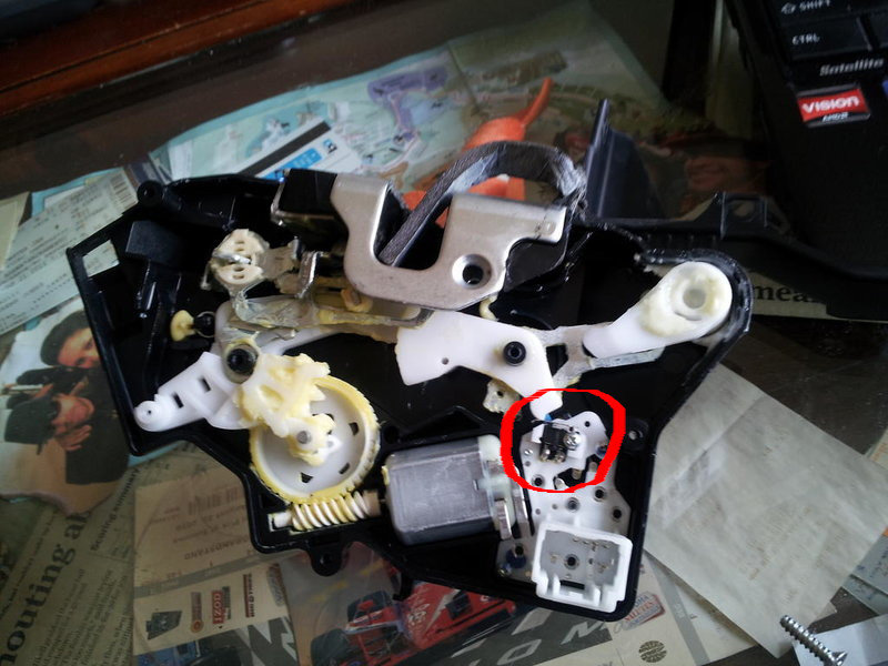

    It will do this If you have a key in the ignition, the ignition switch is worn out and it signals that you have a key in the ignition and if one of the door locked feedback switches is not signaling that the door lock is locked.
    Here is the locked feedback switch in the door lock actuator assembly:
