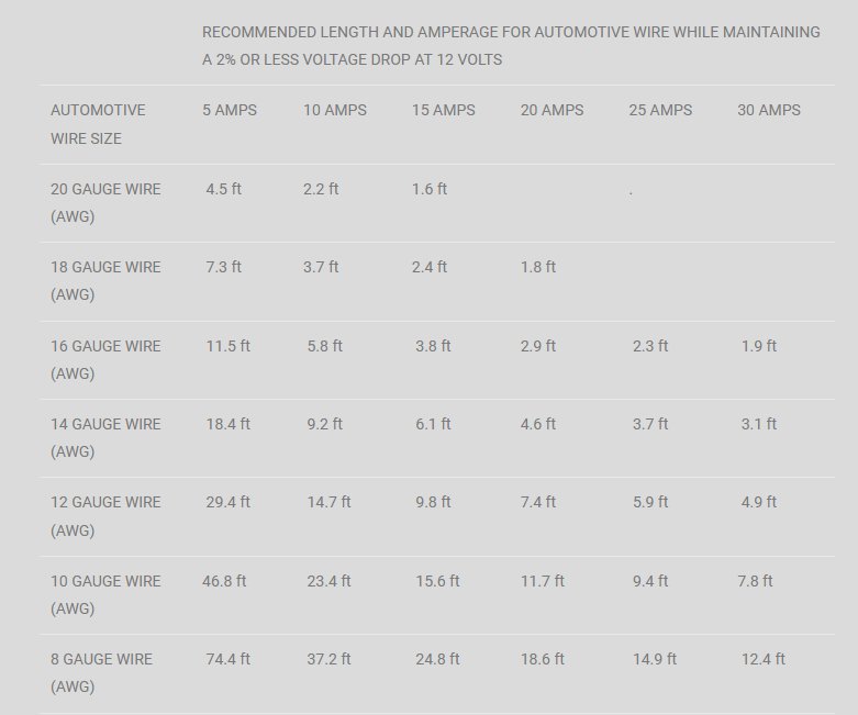

    I have a dumb question regarding adding 5 lights to my roof rack. I have 5 50W lights to add and each light has 3 16Ga wires (Light Power, Backlight Power and Ground) I plan to run them in series. What gauge should the feed wire be and what amp fuse should I be using? Any help would be appreciated.
    Thanks

    wattage = 50 * 5 = 250
    250 = A * V
    250 = A * 14.5
    17.24 = A
    Amperage draw = 17.24 Amps
    So we can tell from the following chart that - assuming 20 amps, and 12' of wire, you should use 10 gauge wire. Less distance, you can go with 12 gauge...etc etc.
