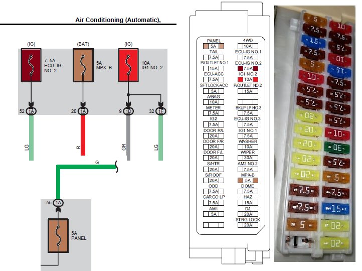

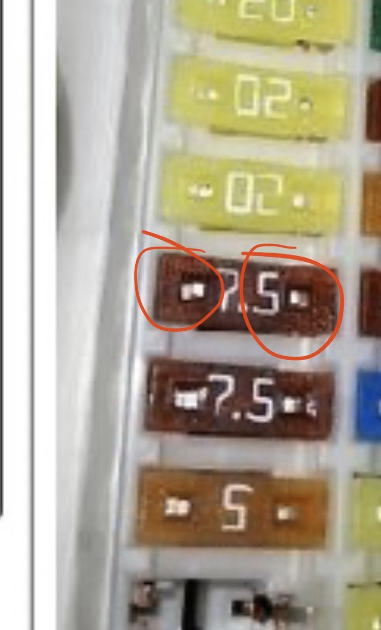

  6. Jul 11, 2020 at 1:57 PM
    Ronzio
    Ronzio Well-Known Member
    Feb 20, 2018
    #245114
    2,719
    Pennsylvania
    17 DCSB TRDOR
    Check the 5a fuse under the dash labeled “panel” top left if your looking at it. Or probe the top of the fuses with a test light both sides of the fuse should be hot with key on. See photo for clarity on where to probe.
