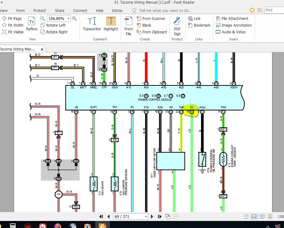

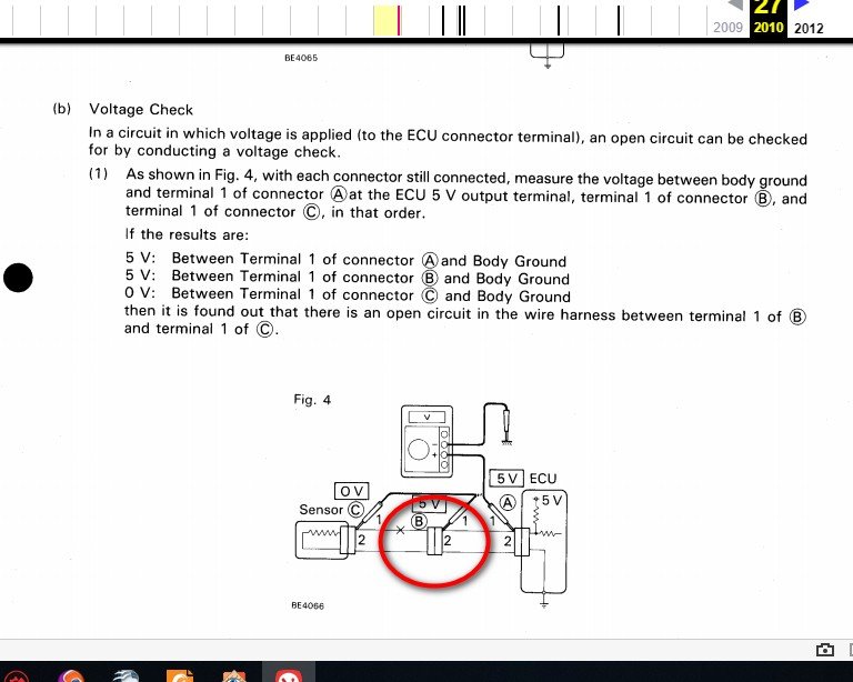

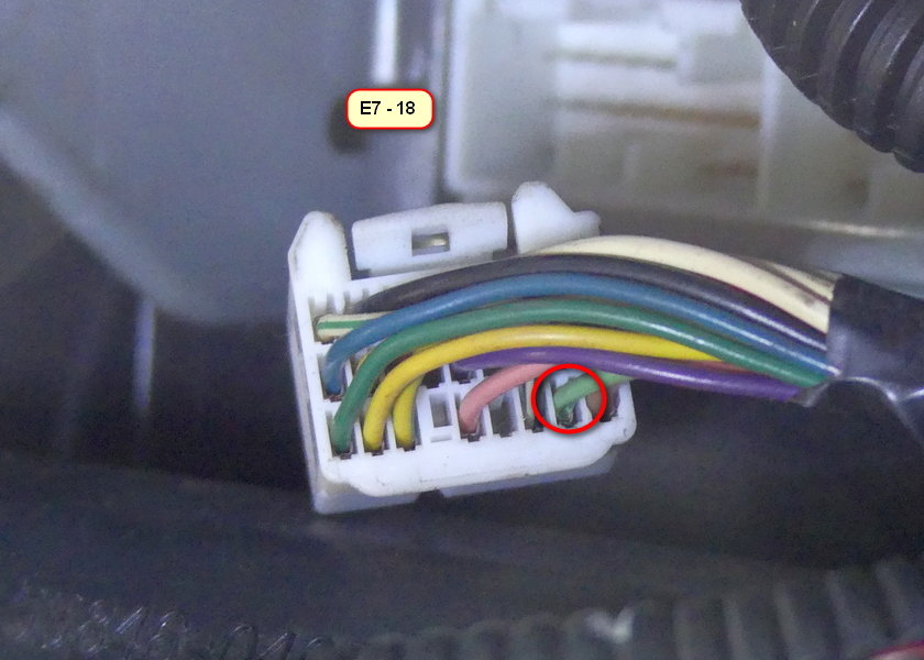

    This is part of the FSM's general guide to testing for short or open circuits. What is B referring to? I have a sensor & the ECU. That's it. B?

    The diagram is not a specific circuit/harness.
    "B" represents a potential connector between two harnesses, or more accurately two harness "halves".

    5,000
    voltage check output at the ECU connector, voltage check before the harness split to see if the wire between the ECU and that connector is good and voltage check at the input to the sensor. If there is any other voltage other than +5 volts that indicates an issue. If there is less than +5 volts at the sensor the sensor readings will not be accurate.

    There are no instructions on how one is supposed to connect two harness halves. It started with testing each harness & then went into testing both & all of a sudden B shows up.

    The biggest reason they are testing the connector and wiring as a whole (connected) is,
    When you back prob the connectors, you know there is voltage to the connector and out of the connector.
    If you disconnect the connectors and test at the pins, you may show voltage. But this doesn’t mean that the connection in the connector is good. As in “it’s a bad connector”.

    By “before the harness split" you mean disconnecting it so as to isolate.
    Takes me forever to do this.... Getting access at the ECU is frustrating.... The voltage from the ECU to the sensor is supposed to be 3-3.6. Then when I apply vacuum to the sensor the voltage is supposed to drop to 1.5-2? can't quite recall, but no lower than 1.5. The initial check actually started at 2.97. I applied vacuum & got .04. Then when I released the vacuum it read 3.6.
    I just checked the sensor again. I was pretty sure it came in at 5, however had not tested it both before & after the connection. Both are good. Ground is .03. The middle one, VAC? changes with & without harness. Is this significant?

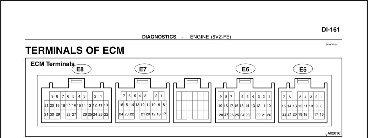

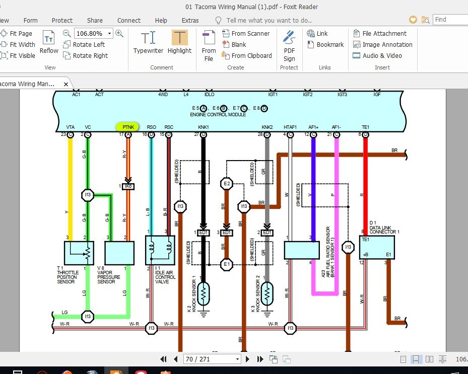

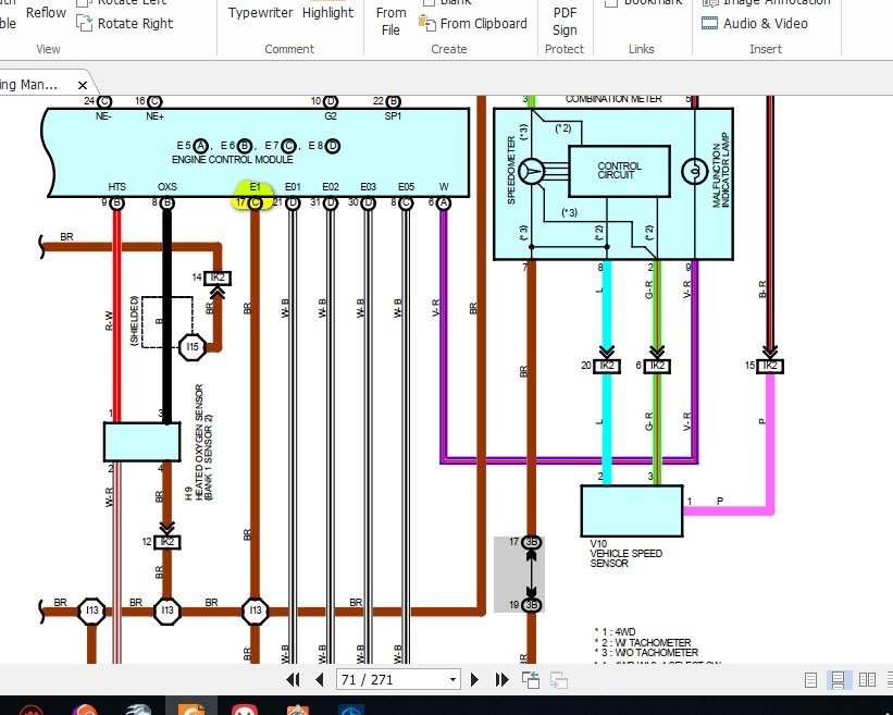

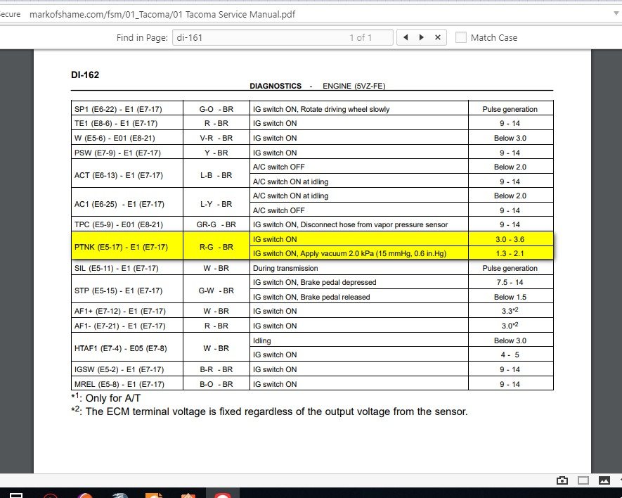

    I am troubleshoting the vapor pressure sensor -
    These are the instructions - below pic are my results.
    Sensor unplugged - 5.2 v
    Ground - .03 v
    VAC? - 3.43 v (correct abreviation?)
    Sensor plugged in - 5.2 v
    Ground - .03 v
    VAC? - 4.34 v
    ECM - E1 - VC - 5.2 v
    ECM - E1 - PTNK - 2.97 v
    ECM - E1 - PTNK - .04 v vacuum applied to the sensor
    ECM - E1 - PTNK - 3.06 v vacuum released
    Sensor continuity passed - I did that last week

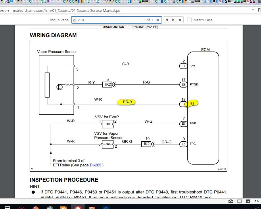

    On page # 478 or DI-218 of the manual you are using.
    You’ll probably find best way to check the VPS.
    Try this test, then report back.
    Because it calls for different readings.
    Make sure to look at the connector diagram to be sure you are checking the correct wires.

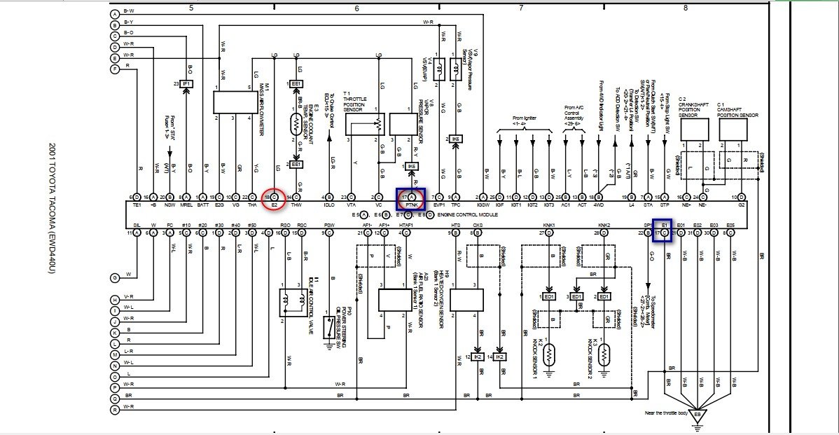

    Ok. Took me a minute. This not having a solid grip on this stuff is not being helped by also needing to decipher which wiring I have.
    This is me - (1st three pics)
    Also, I see there are two tests? One with E1 (my previous post) & one with E2? The one @TnShooter was referring to (last pic in this post). Doesn't really make sense to me, However, I will attempt this with E2 tomorrow. Doesn't really change the results I got with E1 though, does it? Interesting on that last pic how the ECM has all 5 slots filled or is that typical when the diagram is from the back?
    Oh, & this post feels like a mess. I don't know how else to post my wiring though.
    This is not me
    Different test @TnShooter was referring to

    Fact of life Old Toyota`s get parts that might come from anything that will work.I have worked on vehicles that needed three different EWD`s from 3 different vehicles to all be correct .
    Can you see the part # of Your ECM and post that .The part #`s of your EVAP parts if possible .
    That is the simple way to get an idea just what your dealing with at least to me.
    Example not to be confused with your case.Interesting How a 2001 Tacoma has an engine from a 98 4Runner with the Newer Style Maf Sensor about 2 owners back it was swapped if anything was documented it was lost and not passed along. Talk about nothing making sense .
    Trying to use a FSM from the wrong year can drive you nuts in the diagnostics of things.

    If I were doing the test.
    I’d use these diagrams to test it.

    I did the test that @TnShooter pointed me to. -
    Measure the voltage between terminals PTNK and E2 of the ECM connector.
    (1) Disconnect the vacuum hose from the vapor pressure sensor.
    (2) Using the MITYVAC (Hand-Held Vacuum Pump), apply a vacuum of 4.0 kPa (30 mmHg, 1.18 in.Hg) to the vapor pressure sensor.
    NOTICE: The vacuum applied to the vapor pressure sensor must be less than 66.7 kPa (500 mmHg, 19.7 in.Hg).
    OK: (1) Voltage: 3.0 - 3.6 V (2) Voltage: 0.5 V or less
    I must apologize as I did not pay attention to the sensor harness wire colors & it is E2, not E1, that goes to it. I am still baffled as to the differing tests within the same manual though.
    Measure the voltage between terminals PTNK & E1
    IG switch ON 3.0 - 3.6 V
    Apply vacuum 2.0 kPa (15 mmHg, 0.6 in.Hg) 1.3 - 2.1 V
    Anyway, I got the same results as I did with E1 as I did with E2
