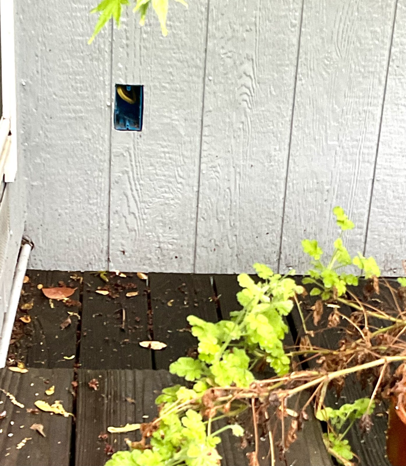

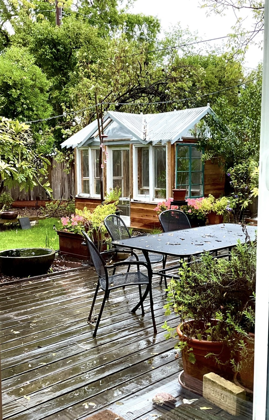

    I was going to put in an exterior receptacle, but plans changed. I now want to run power from this box to a greenhouse. There is a deck running from just below the box all the way to the side of the greenhouse, with a 12 inch gap between the Deck and the GH. I've searched Google, and let me tell you, there are so many opinions I'm not sure of the correct way to do it. The line is 20 amp 12/3 and protected by a GFCI receptacle in the garage (I'll add one in the GH as well). What would you do to get power into the GH?

    I would run the wire through a conduit from the garage to the gh. That should protect the wire fro weather and critters.

    How long is the run is first question?
    Judging from first pic it doesnt look like there would be a significant drop in current. I really dont remember all the math about it, but doesnt look like a real concern at all in this situation.

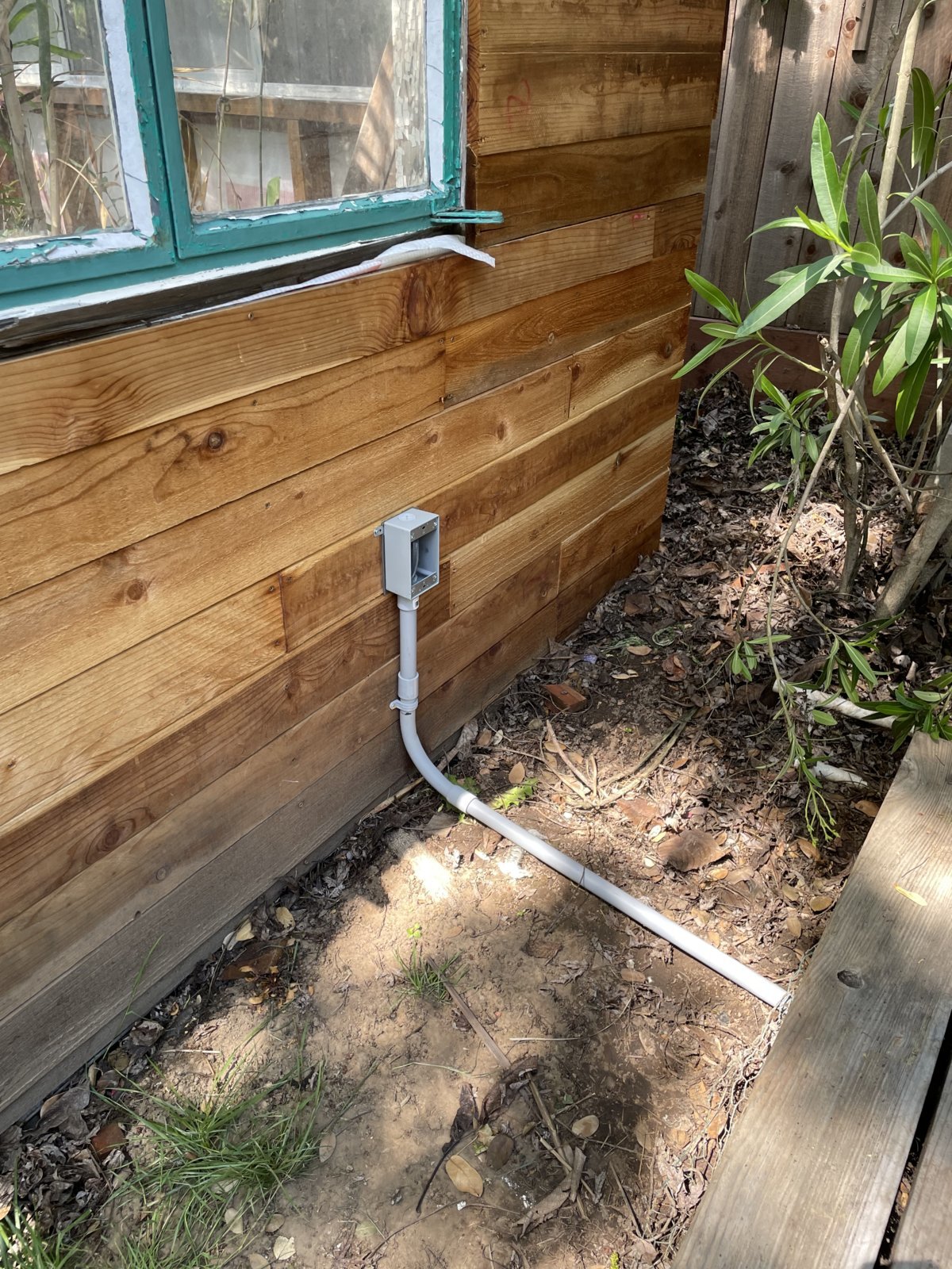

    Made some progress today. Ran wire under the deck, boxes attached and conduit in place (not glued yet). Need to turn off power to connect but there is a giant pile of laundry being processed that's on that circuit. The deck will be extended to the greenhouse, so most of that will be covered. I'll be able to energize the line tomorrow.
