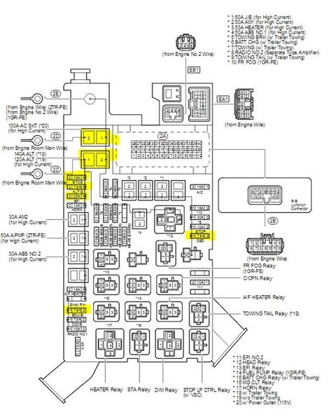

    Start with checking the 120/140A ALT fusible link. Bet it's blown. ;)
    Zollars likes this.
  17. Jun 22, 2015 at 11:24 AM
    #17
    1MK
    1MK Desert Explorer
    Jan 8, 2015
    #145870
    857
    Southern California
    SunDevil[OP] and Zollars like this.

    ^^^Boom!^^^

    Status update: 140a at fuse was blown, and a hand full of others. Replaced all and the battery, and it fired right up!
    The only remaining issue is the E brake sensor and ABS light are illuminated. Is that an open circuit I missed or something else?
    Thanks again, saved me a tow!
