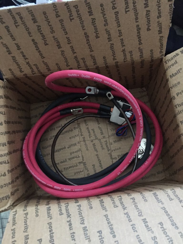

    2000 SR5 4WD Lunar Mist
    Check Out My Builds
    Got mine today!
    Installing 2 weeks from now hopefully. Seems pretty easy to install just by looking at it
