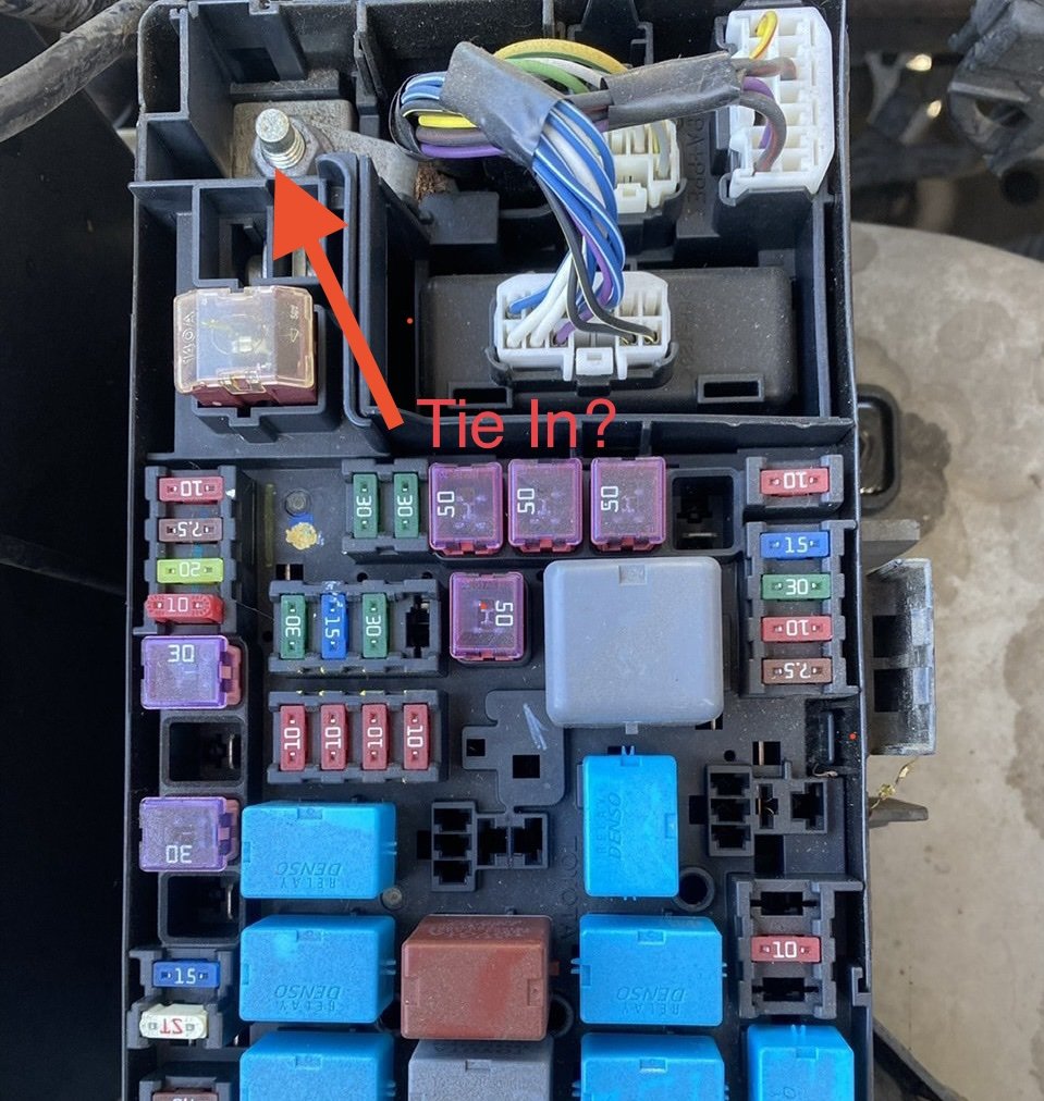

    I would like to know if I can tie into the engine bay fuse boxes main positive instead of the battery terminals, as I would like to keep it looking clean.
    If I were to tie into the box, would that cause an issue down or upstream somewhere? IE cable not thick enough etc?
    Im It does feel like this cable goes directly to the battery terminal.

    I sure wouldn't - electrical capacity aside, you're going to have to chop up the fusebox body to fit another wire in there. You also absolutely do not want to run a winch from that location - the draw, for example, on a Warn Evo 10 is ~350A peak which is almost double what that wire is meant to carry - note the 180A fuse directly below that lug.
    Consider switching to e.g. military style terminals and running a clean pair for your aux panel and a dedicated, appropriately sized run for the winch.

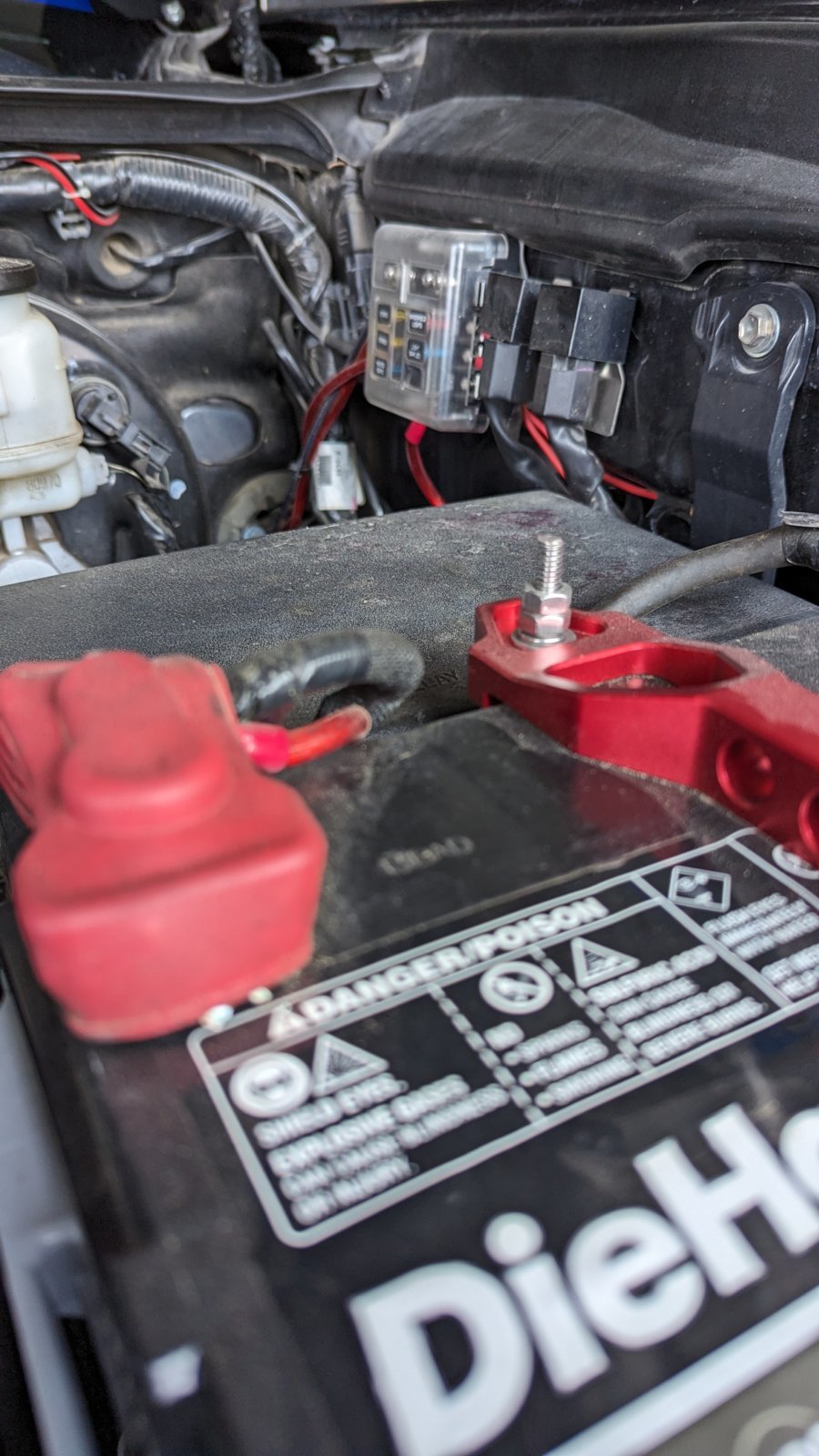

    I wouldn't. Any cable that ties directly to terminal is going to tuck neatly between the battery and fuse box. Id argue that it's a cleaner way of doing things than trying to booger up the box.

    @Rock Lobster That is actually a wonderful idea of running the aux distro on that wall. Cleaner than having a giant metal plate as i have seen from vendors. Makes working in the engine bay easier.

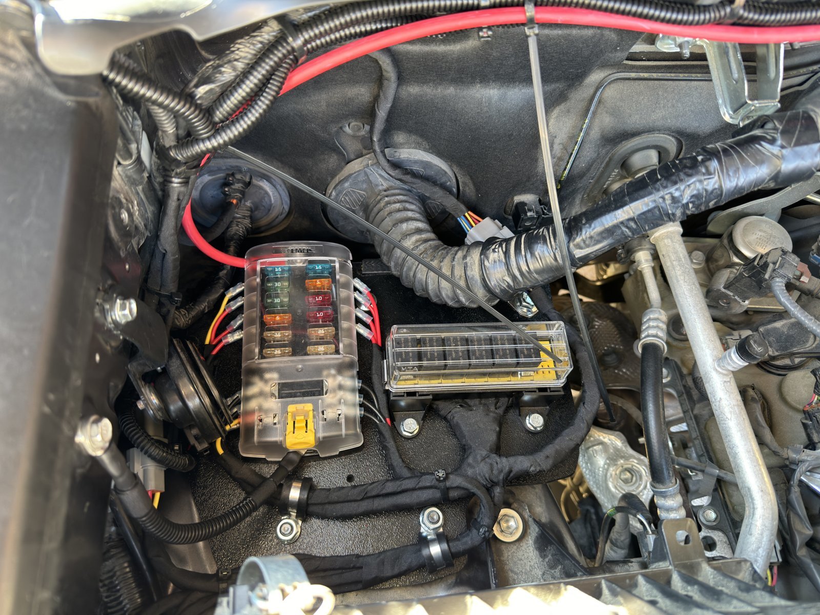

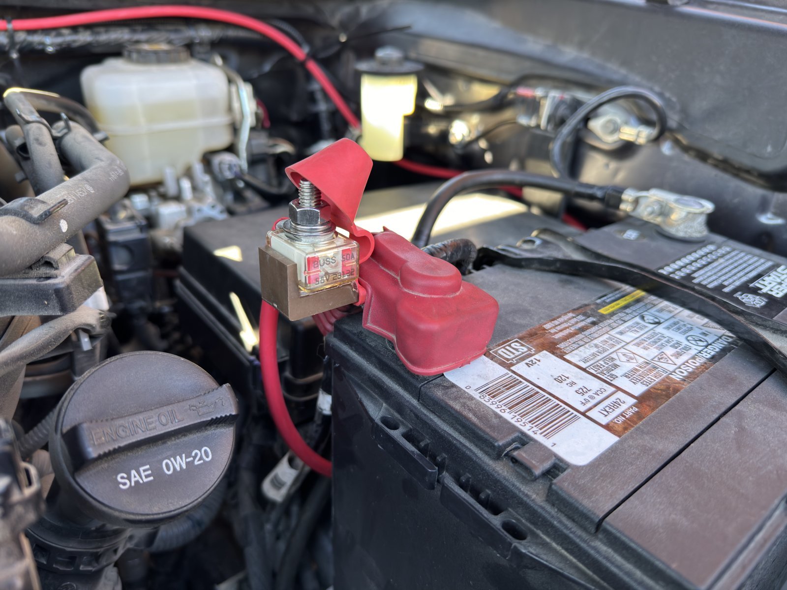

    If all the power is going to be grabbed from one source, I would (and did) go straight to the battery and use an MRBF fuse. It’s clean enough, sturdy, and does exactly what it’s supposed to.
    Ignore the terrible red cable showing in the photo, that was preliminary and I was waiting on loom. It’s all done and perfectly clean now but I don’t have a new photo.

    ....and then, one last important thing to consider. The wire from your battery to the trucks relay/fuse box was designed for the trucks specific load. If you go and add what could be a bunch of new load at that point and do not change out the factory wire accordingly, you have just turned the factory lead into a fuse and when that fuse goes you are dead in the water.
