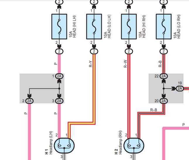

    So the HEAD (LO LH) and the HEAD (LO RH) fuses have power on both sides but no power at Pin 1 (Red/Black) on the right and Pin 1 (Red/Yellow) on the left connector?

    Correct

    Okay I may have mistaken you lol I tested the 3 connectors that plug directly to the bulb. Where do I find the yellow/red and red/black wires?

    The wire for the left (Red/Yellow) goes directly from the fuse to the bulb connector, the wire for the right (Red/Black) goes through the underhood junction connector (2A) then to the headlight connector.

    Pin #1 on the left side head light would be the easiest to "test".
    And give us more info.

    Also, use the battery negative post for testing.
    Since it's right there. Nothing beats the battery for a reference.

    Okay I’m getting 12v to the pin you pictured without my headlight harness. Plugged in an old bulb and it worked. Plugged my harness back in with 2 new relays and I’m still not getting power to that pin. So the problem is somewhere in the harness.
