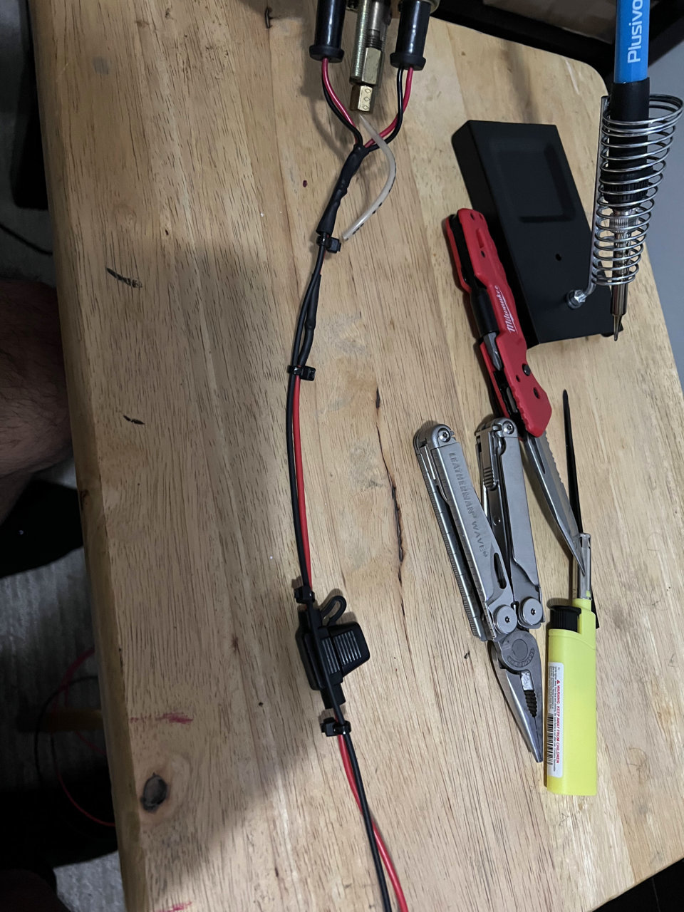

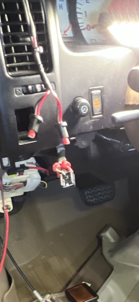

    Hello peeps, ran into an issue trying to wire a TRD boost gauge electrically. So I used some T-Tap wire connectors to tap into the ECT button wiring harness. I have attached two pictures just for reference. I connected -Negative black wire from the boost gauge to the White/Green wire on the harness. I connected the +Positive wire to the Green/Red strip wire on the harness. When I turned on the parking lights the gauge lit up. I used the dimmer switch to dim the interior dash lights and it worked. Shortly after, the 10A fuse under the hood for the TAIL blew out. I replaced the fuse with another 10A and said what the heck maybe its the -Negative wire I connected to the White/Green wire on the harness. I connected the -Negative wire from the gauge to a good ground under the dash. I kept the +Positive wire from the boost gauge connected to the Green/Red wire from the harness which has 12v when I turning on the parking lights. The lights on the gauge turned on shortly and the 10A fuse blew again. What am I doing wrong? Could it be because I changed the normal bulbs on the gauge to LEDs? How have you guys wired your gauges? Thank you all for your help :thumbsup:

    The EWD agrees that green with red stripe is the power, and the white with green stripe is the ground. Changing from incandescent to LED should lower the power draw, not increase it. I'd be looking for a short either in the new section of wiring you've added, or around the taps you added to the existing wiring. Do you have a picture of the taps you added as installed?

    You can see them here. Wish I had a better picture. They are meant for 22-18AWG wire.

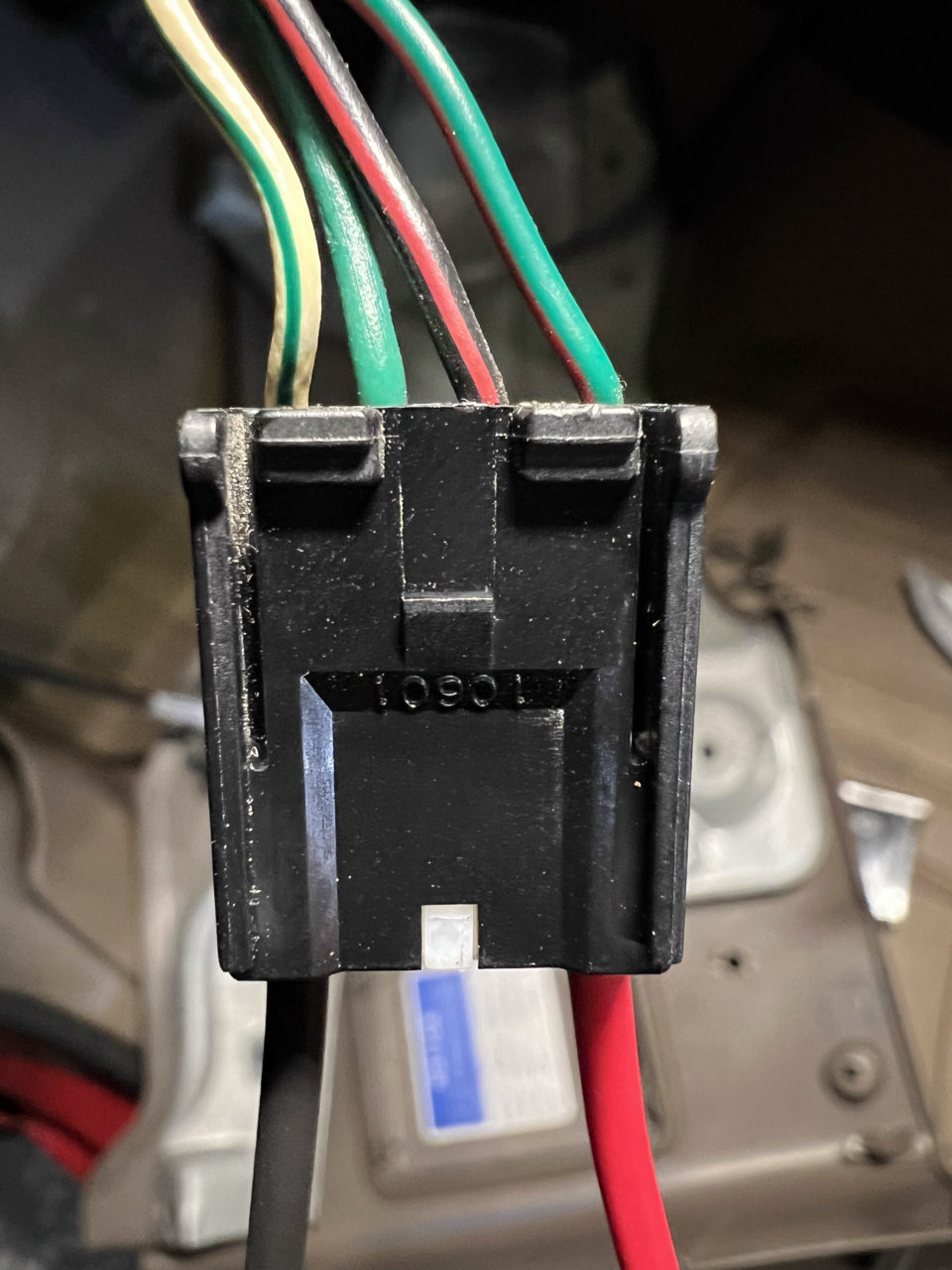

    Do you have anything showing the wire that connects to the taps? And possibly a picture of everything connected at the ECT switch plug?

    I don't. I wish I would have taken pictures of it. It didn't cross my mind. I will duplicate my work Thursday and post pics/updates. Thank you very much. Hopefully your available to help. Thanks :thumbsup:
